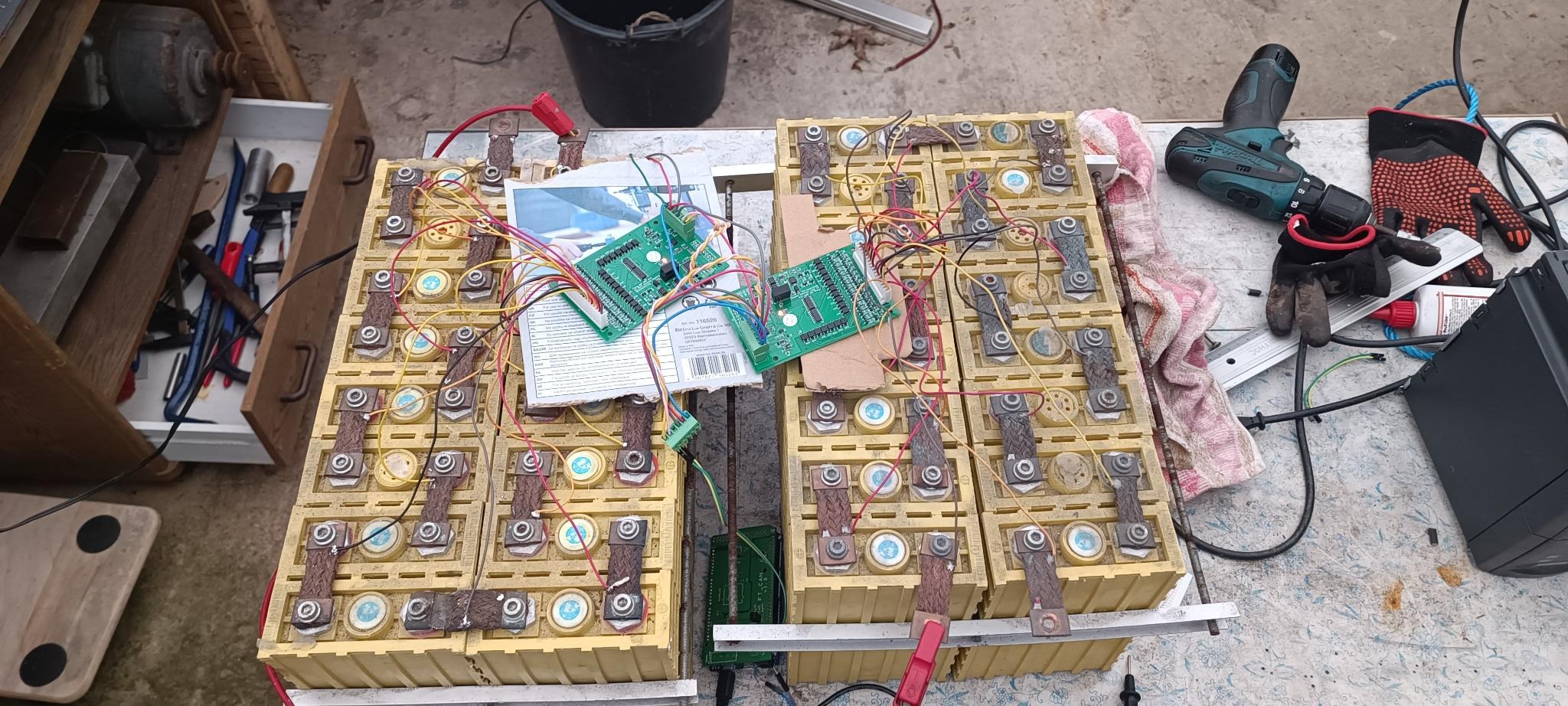

Finally got around to some more BMS testing, now with two modules, i.e. the configuration that kept blowing up back in London. With the opto coupler armada the problem seems solved. Restarted around 20 times and it never smoked.
I did hook up one module completely the wrong way around. It seems this killed the upper two channels, they show too low readings. Will replace the mosfets and see. Apart from that no damage.
