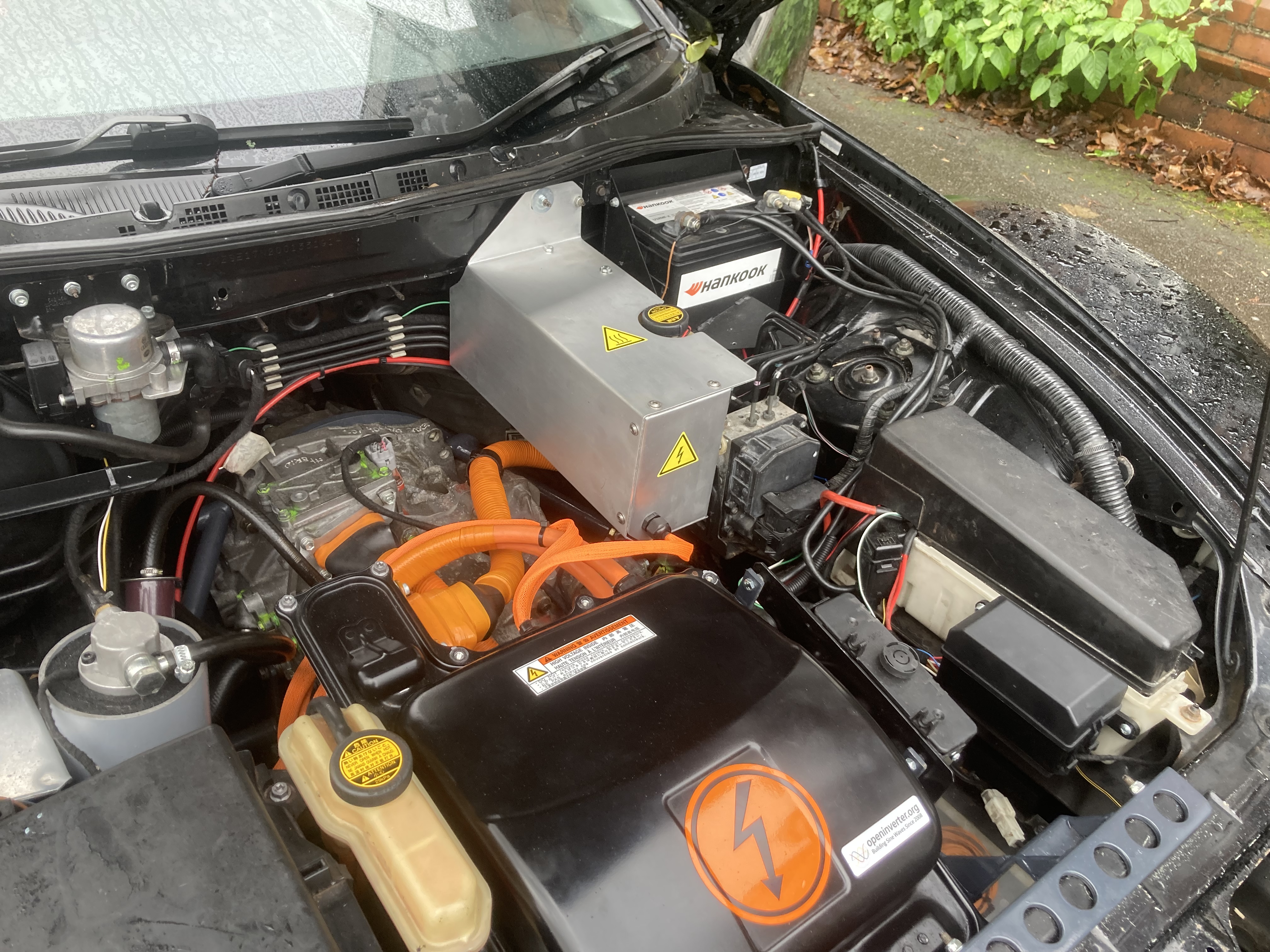

Re: Project RX8 , Prius gen2, Lexus transaxle to rwd
Finally made a cover up for my makeshift bargain bucket heater, it’ll do for now but I’m not really happy with the amount of space it takes up and the inefficiency of powering a pump and moving water around, so long term I want to put a ptc air element in the heater box but that’s a dashboard out job!
