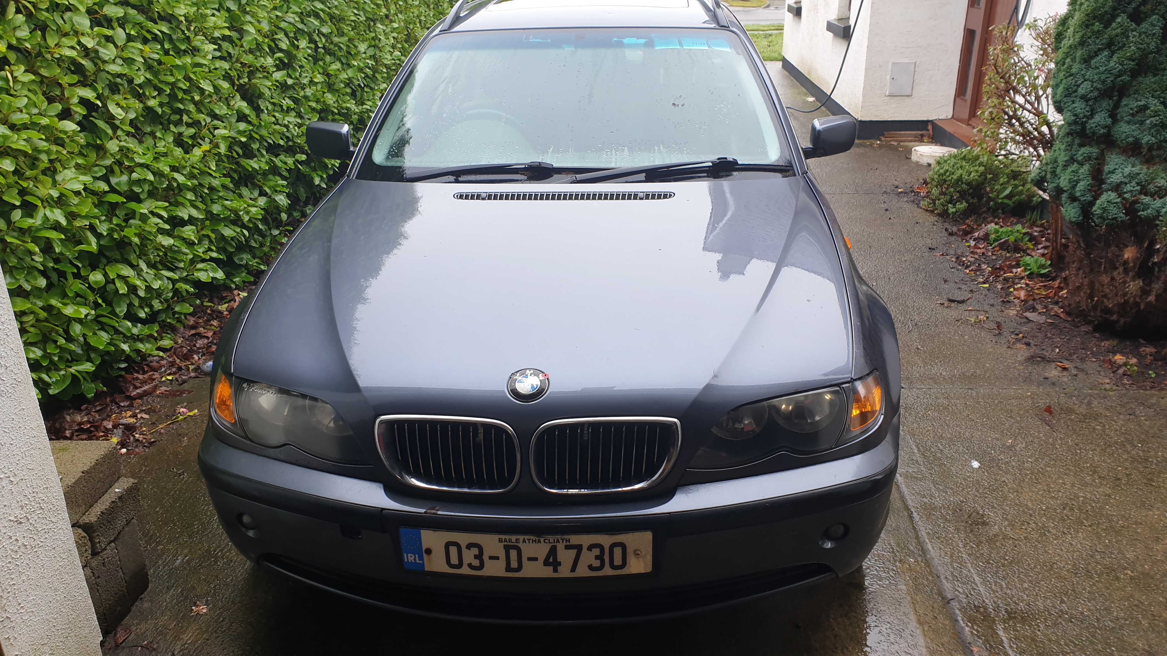

Think I have sent you an invite on github Matt. In other news the Grey Goose arrived home today so E46 and Nissan Leaf testing on the vcu is next:) The Goose also has the M3 pcs fitted so will see about finally waking that up and integrating into the vcu.
