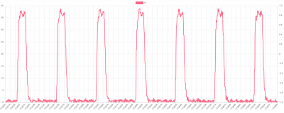

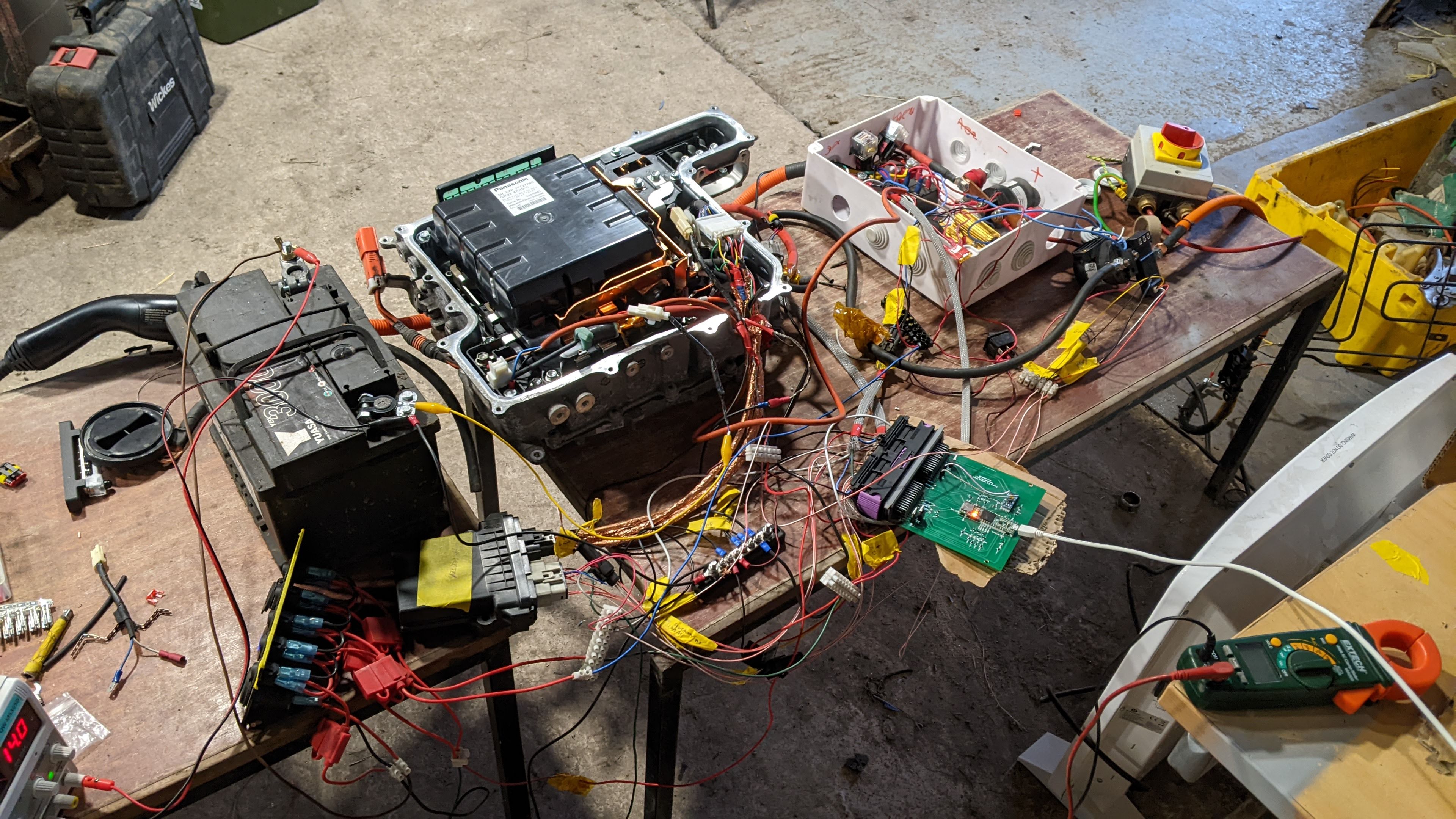

So I have finally caught up on the practical front. Currently bench testing all the HV stuff before I put it into the car.
Running this through a teensy 3.6 with a pcb I made up. It should be sending the relevant 12v signals to Inverter control board, which it seems to do just fine. I wanted to check, if I send fwd and reverse signals to the control board does this automatically put it into buck mode? It doesn't seem to want to go into buck mode even when I set it to buck on the web interface.
I currently have a simulated battery on the DC line in the form of a light bulb on the precharge and a cooker heater element acting as the battery. What I am finding is that with CSDN and CPWM pulled high, there is current following through the DC lines. I thought this couldn't happen with CSDN pulled high.
I think I have the inverter powered, it's pulled 1.4Amps ish and I have the safety lid switch grounded(which oddly I didn't need to do last year when I was testing the motor or running it in the car at low voltage). This time around I have the positive battery wire bypassing the boost converter and going straight to the main DC bus. Although I can't hear the inverter whine when it gets power, so I feel like something in there isn't happy.
Edit: Done some more testing, it only pulls 1 amp. Also compared it to the inverter in the car, this one is definitely missing it's inverter whine on startup. Time to start digging around the inverter?

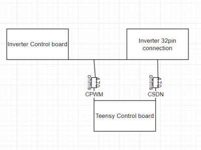

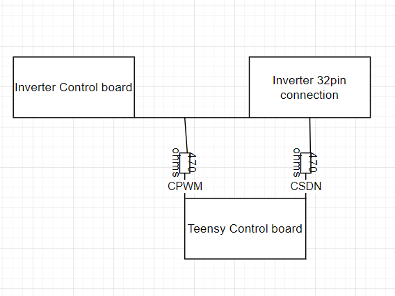

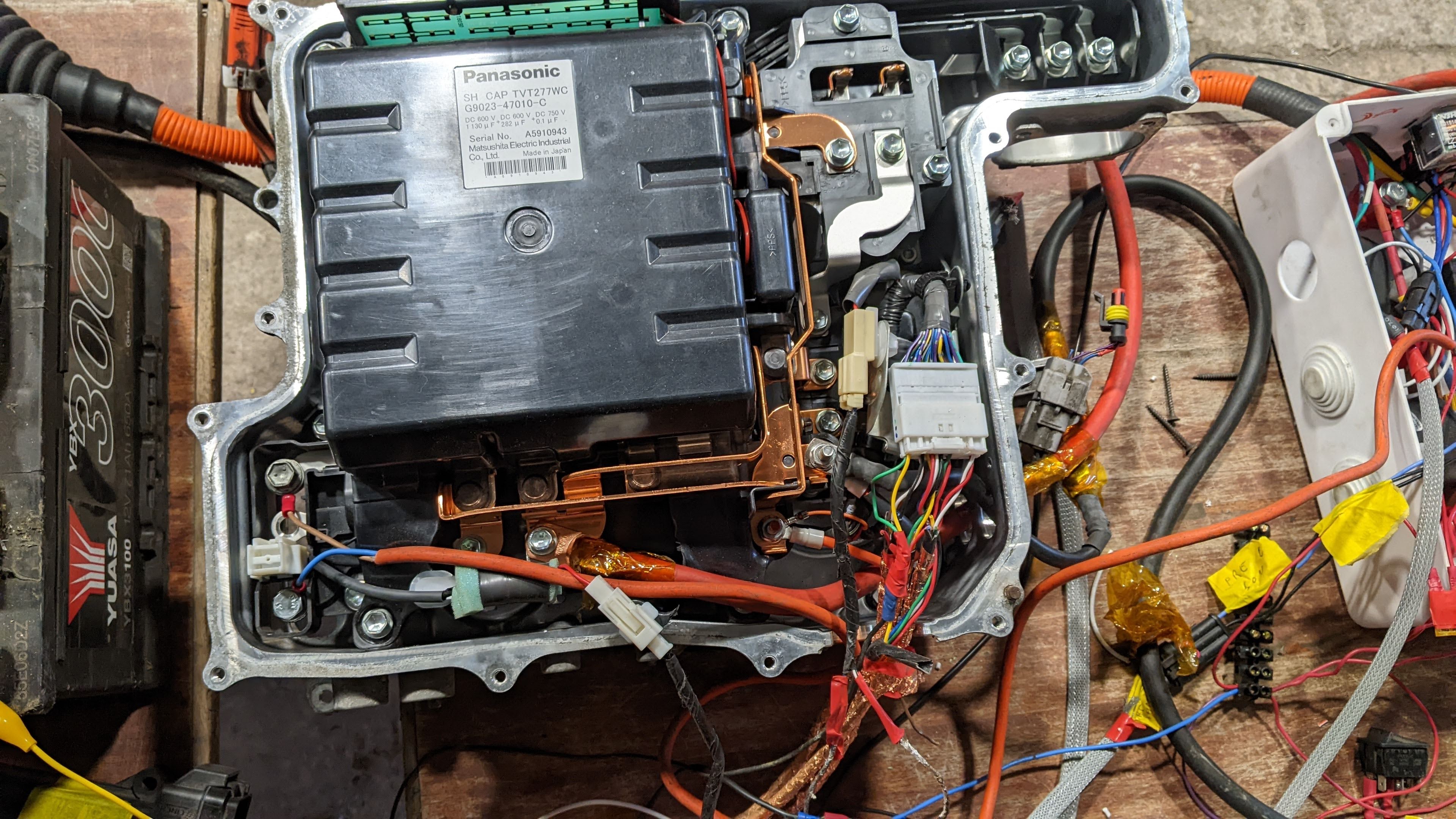

Ok I pulled the inverter from the car and got it on the bench. This time it makes the plesently high pitch squeal on start up.
I have my arduino running this on start up
The idea is that if the charge port is sensed via the proxy pin output from SIMP charge, then it goes into charge mode by sending fwd and rev signals to the inverter controller and pulling CSDN and CPWM high via 470ohm resistor on each line.
Then my loop calls different functions depending on the charge mode. In the case of charging it runs this
What happens is that the charge port is recognised, then the inverter makes a louder whine until the main contactor closes, which then gives 315v on the battery outputs and about 350v on the DC bus. However changing chargepwmin or chargepwmax doesn't change the voltage. If I close the precharge contactor on the charge during the precharge process then I get the light shining and the voltage on the DC bus stays at 240v, which makes sense if it hasn't closed the AC contactor and is running through the AC precharge resistor.
Feels like buck mode isn't activating when fwd and reverse are both selected. Is there another way to activate buck mode through CANBUS or IO signals I can send the the control board? Without having to manually select buck in the web interface. Running firmware version 5.14 FOC.

Re: Prius Gen2 Adapter Board for CHARGING
Thanks for that. I got the contactors working as they should, as with the precharge.
I am still having the initial problem of the VCU not going into buck mode with the fwd and rev signals being sent to it.
As a work around I have disabled pulling CSDN pin to low and then I can manually set the inverter to buck mode through the web interface, once the precharge is complete. This then does show as being in buck mode. I can then manually pull CDSN to ground with a jumper wire, when I do this the inverter whine shuts off, then comes back if I pull it back to 12v.
What I am finding is that voltage is going onto the DC inputs almost immediately, pulling CSDN low or high doesn't affect this at all. chargepwmin/max also has no effect. Which doesn't make sense, since I thought with CSDN to high there should be no connection between the HV bus and the battery connections. Or at least no connection somewhere between the battery connection and MG1.
I think I am going to double check all the wiring, make sure the right signal is going to the right pin.
I think my battery connections might have something to do with it. I was bypassing the original stock battery inputs on the positive side and going straight to the HV bus. This makes sense in terms of driving a motor of course, it also makes sense that I am always seeing current and voltage since I was connected to the HV bus, so of course I would.
But it all the videos I have seen on charging the battery connections being used were the stock inputs. So I moved my battery connector back to the stock input. I'm thinking the boost converter I am by passing is kind of important for charging? Or do I have that confused?
This time I get no voltage at all on the stock battery inputs. So this feels like progress, I'm going to keep going through the processes, just confirm the signals are all correct and present.

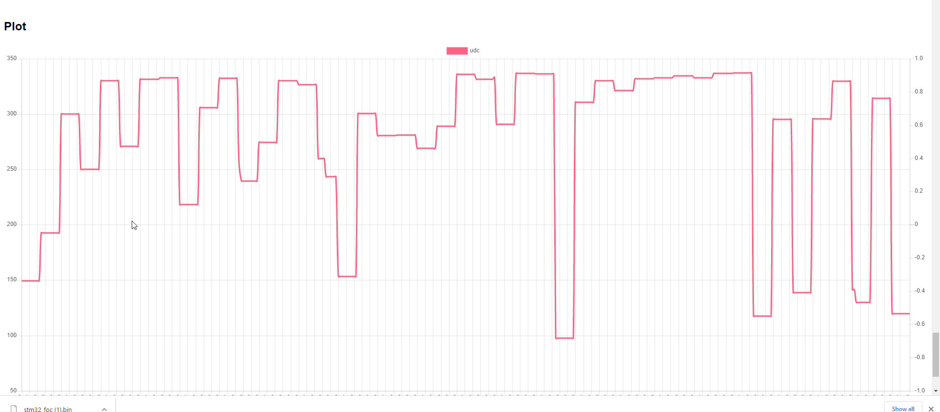

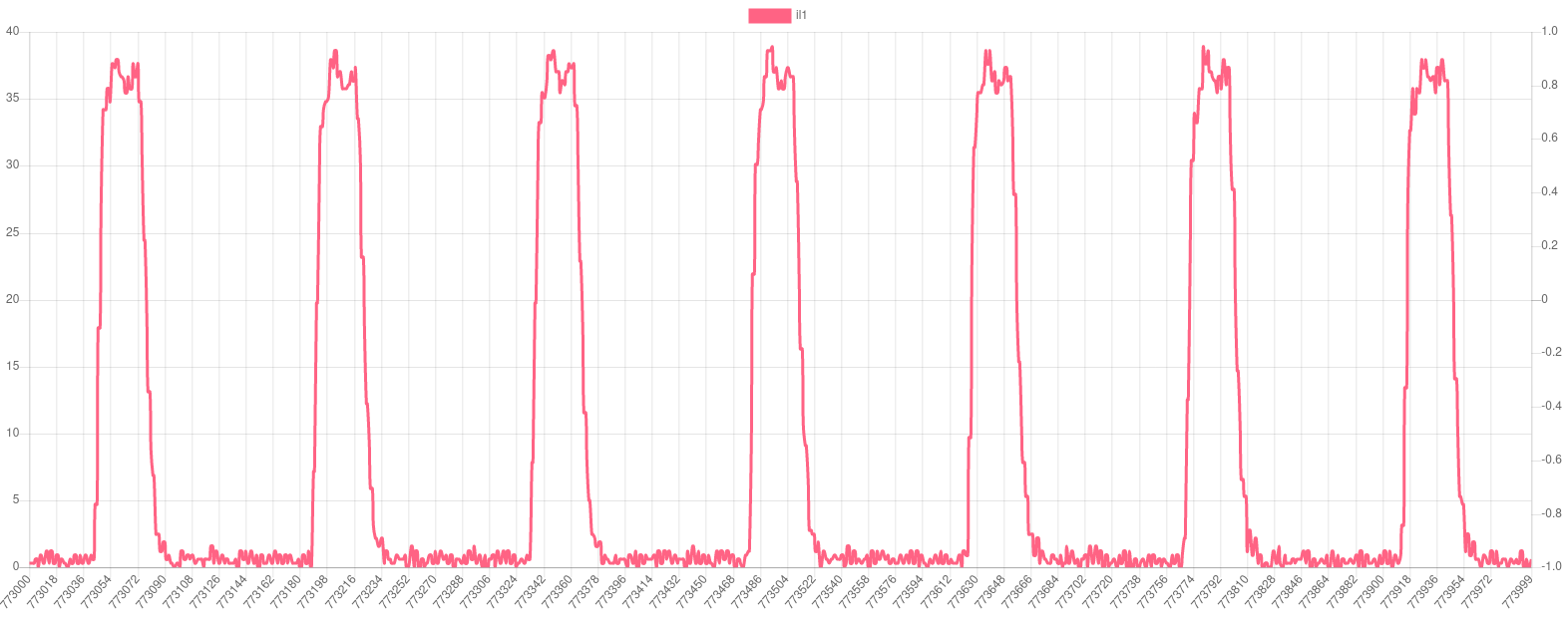

I think it's working in a manner. Rechecked all my connections just to make sure.
What I get too now is the HV bus precharged, all contactors closed and CDSN/CPWM pulled high.
Then I can set buck in the web interface, and manually pulled CSDN low. When both of those are done it starts making a different noise and the EVSE isn't very happy, clicking on and off. I do however get some voltage on the stock battery inputs.
The UDC voltage is as shown. I'm thinking CPWM is pulled the wrong way and the high side IGBT is on, shorting the EVSE. That would cause it to keep trip out and hence lower the voltage? I id try to bypass the 470 ohm resistor on CPWM to give it full 12v but that made no difference.

Shorting CPWM to 12V AND connecting it to the control board can easily blow the output driver. Please check if you still see a valid waveform with CPWM pulled up.
CPWM pulled high and CSDN pulled low (or floating) will close the LOW side transistor, shorting the battery input (the stock one). Pulling CPWM low (or floating) will close the high side transistor thus connecting DC bus to battery input bidirectionally.
CSDN pulled high disables both transistors.
No quite sure what you connected where, schematic would help

Not sure why I decided to by pass the resistor on CPWM now, I think I got confused with CSDN which isn't so clear if it needs a resistor or not. How do we check for a valid waveform?
I was of the understanding that CPWM needs to be pulled high at all times during charging. Then CSDN is pulled high to start with and then left floating or Low to start the charging process.
This is how I have connected CSDN and CPWM, the Teensy control board sends 12v via resistors when needed and leaves them floating when not.

Finally succeeded somewhat with boost mode charging via A/C inverter. When I say inverter I have to say I threw out the IGBTs and replaced them with a standard rectifier. Managed to reuse 3 PCB holes, the 2nd AC input goes directly to a terminal block. Also bridges the emitter resistor as it was blown anyway.
So now I can charge directly from the grid but the current waveform is not pretty. Have to research this further, in my "poor mans charger" it looks way better. BTW the currents are off by a factor of 5 because the charging current sensor has a different gain. The setpoint is 10A (2A real) but the overshoots are 40A.
The DC-DC converter also operates happily from rectified AC.
CPWM is pulled to 12V via 499 Ohm. CSDN is connected to the DC switch out (so 12V with switch off, GND with switch on). So it activates simultaneously with the positive DC contactor.
