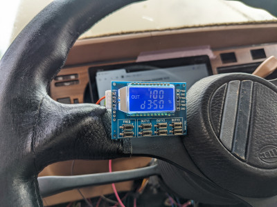

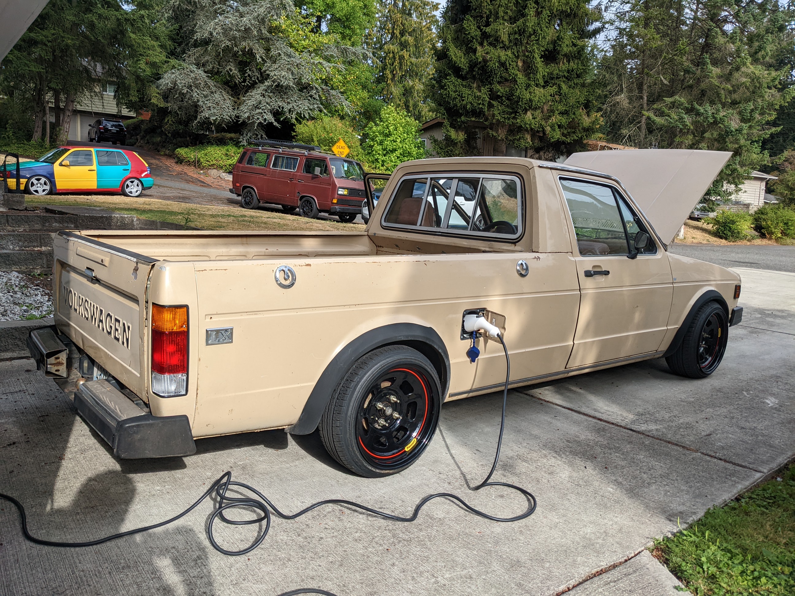

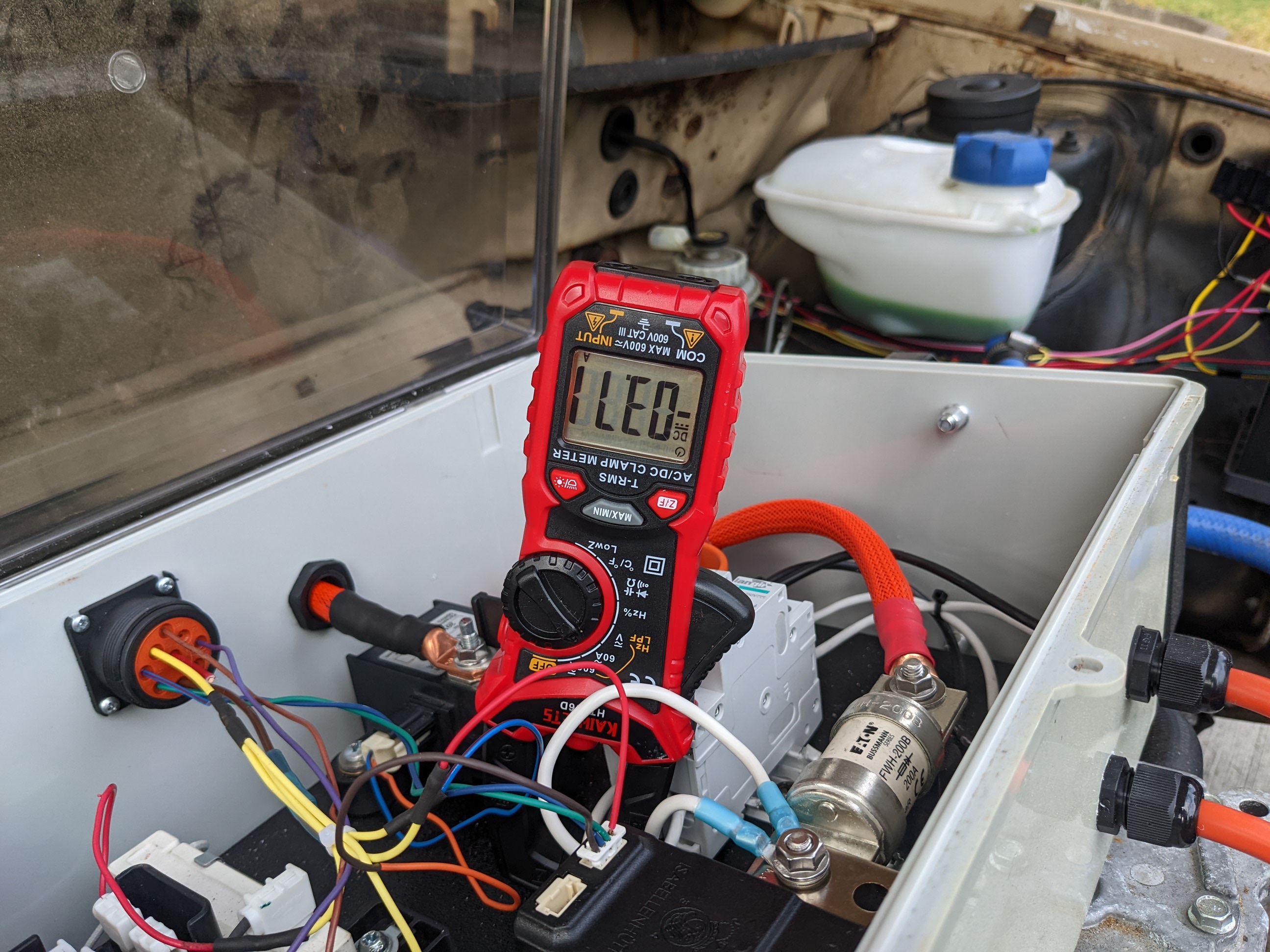

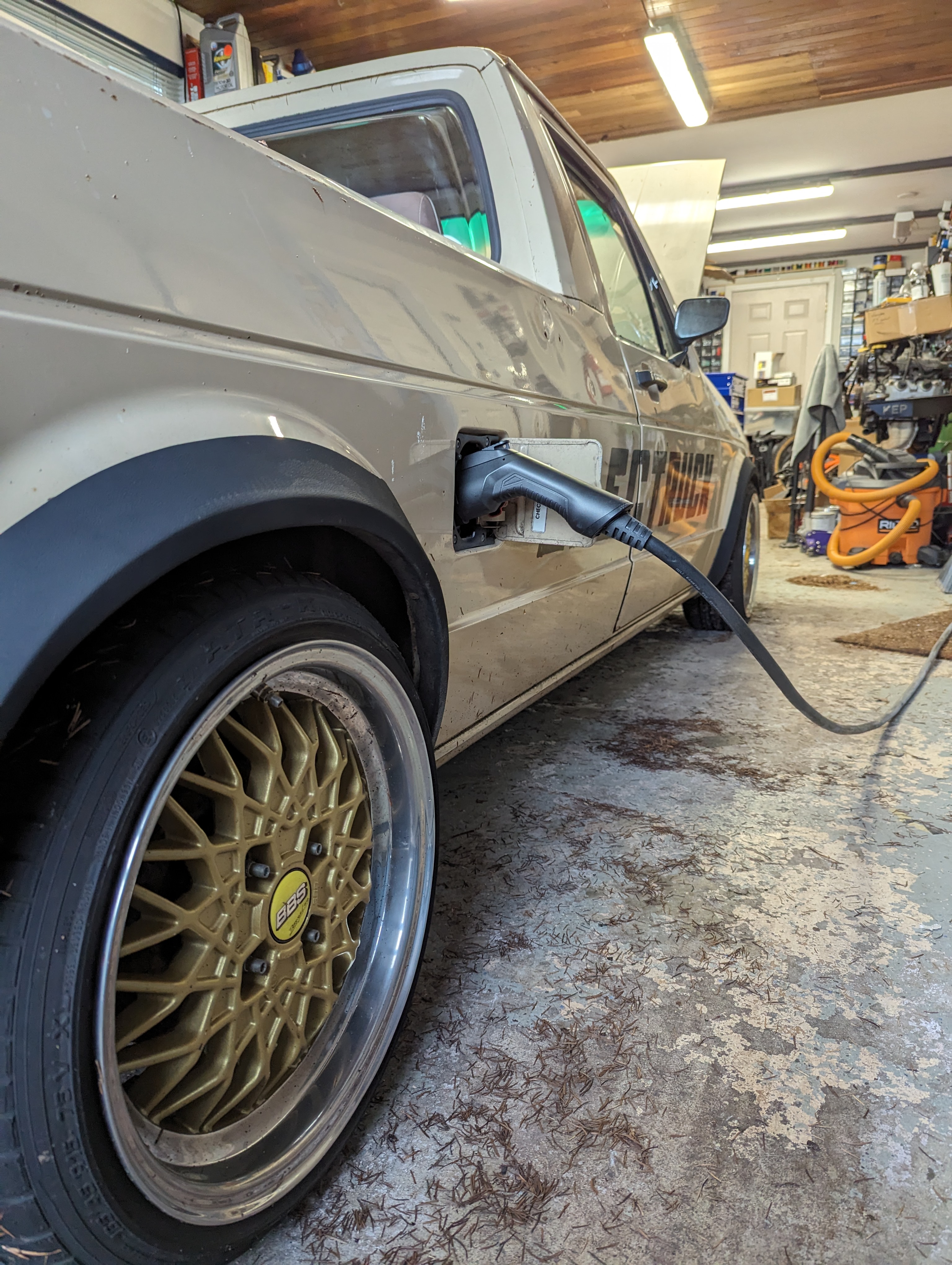

L1 charging at 1300W!
Volt charger being controlled by a simple pwm generator

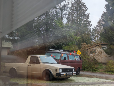

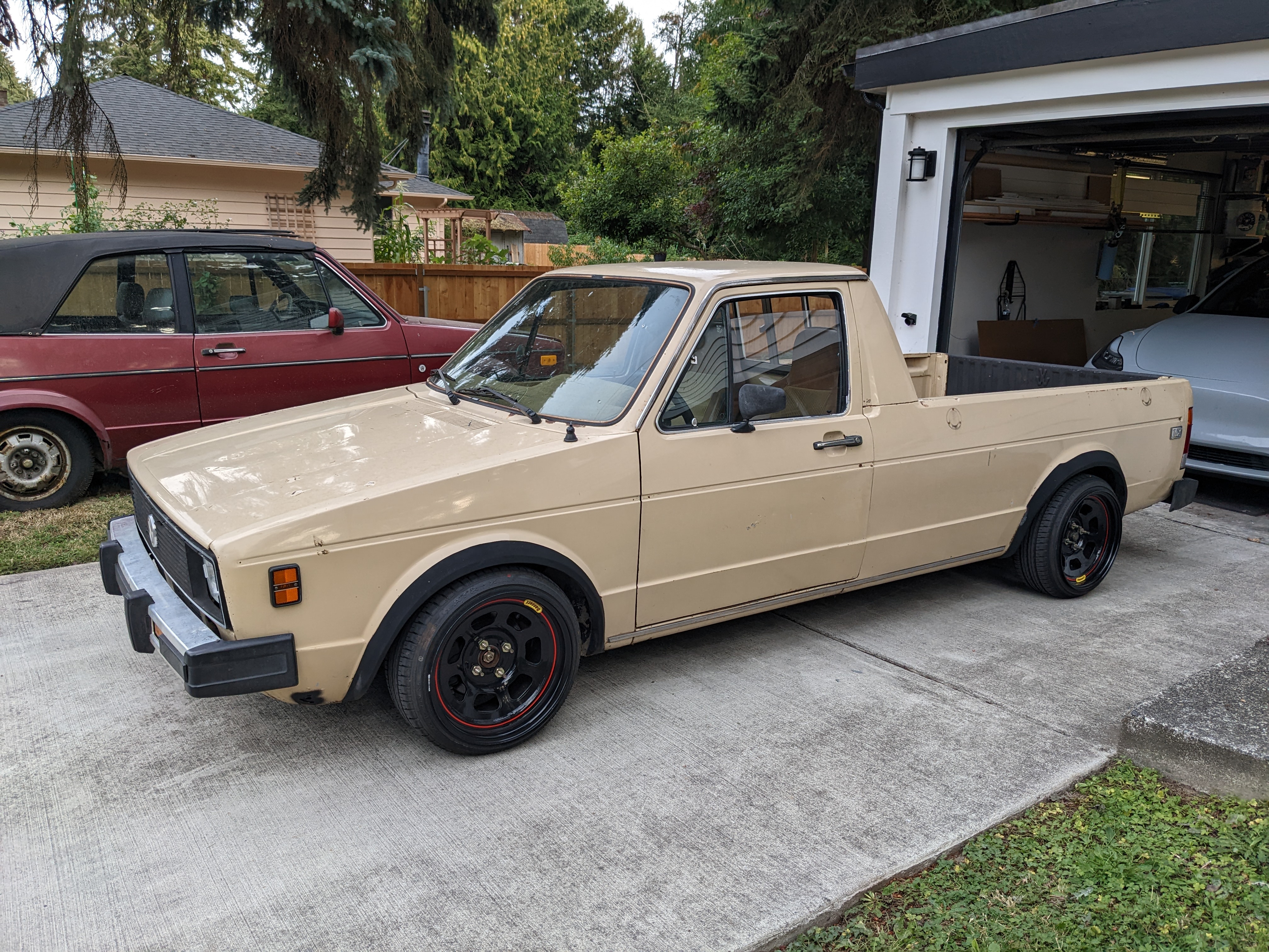

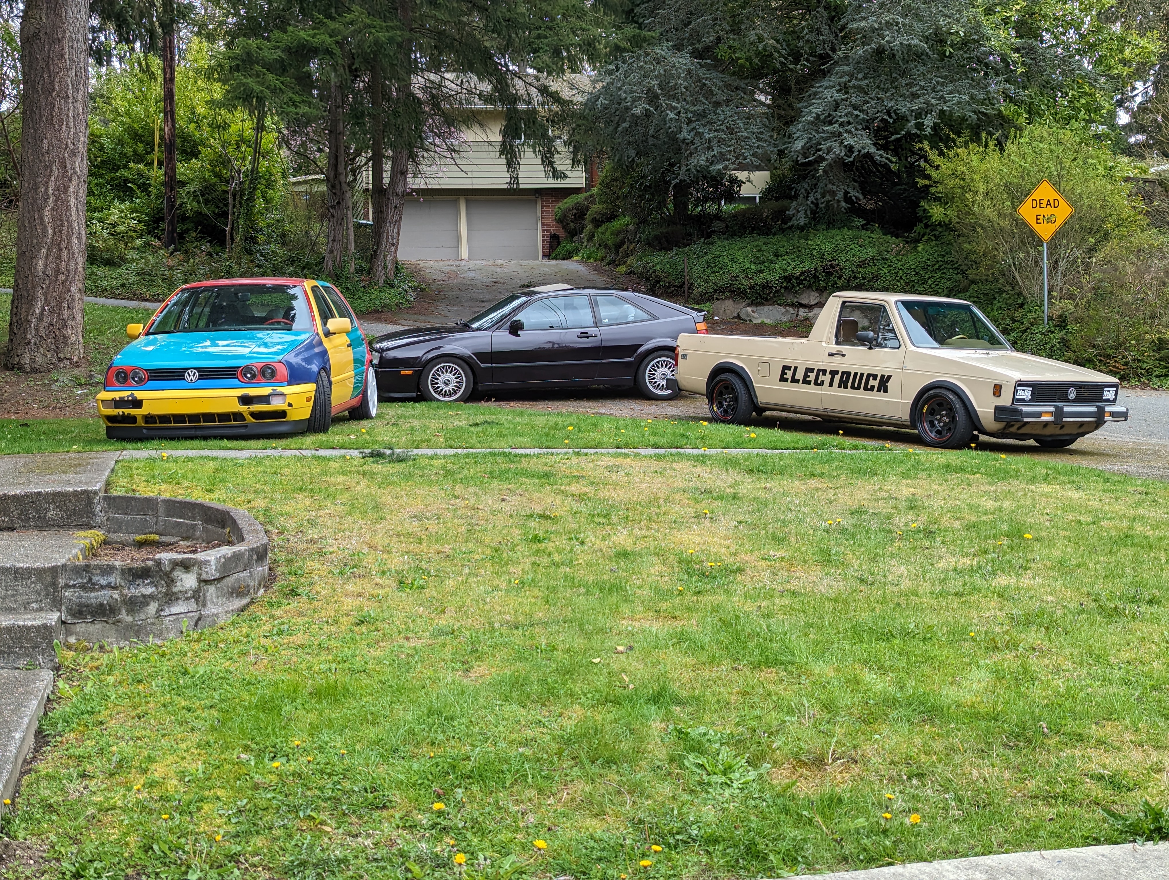

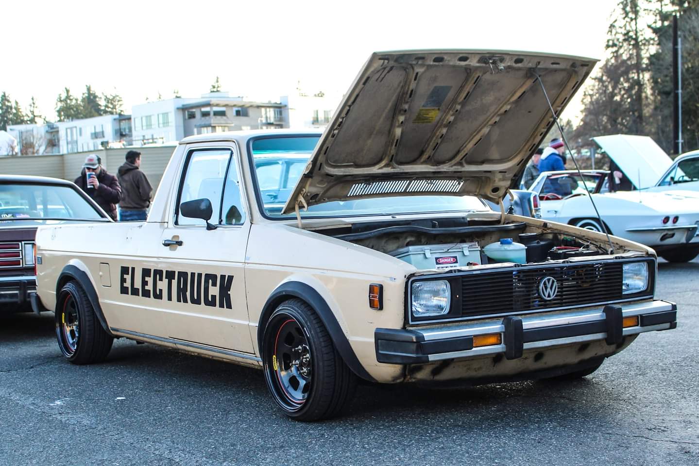

It's been a while! I guess that happens when you reach the "road-worthy" milestone.

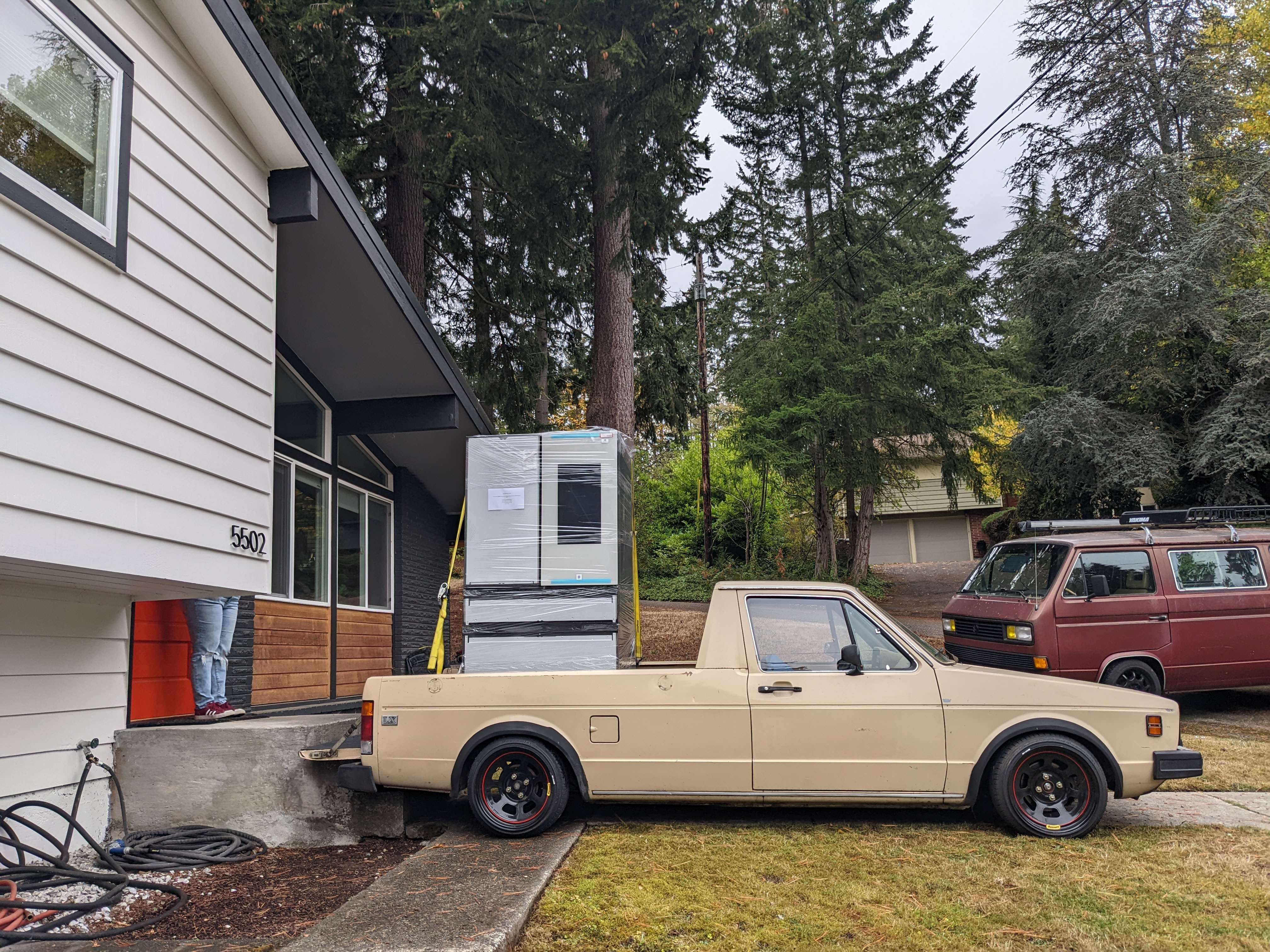

This truck has just worked... It's easily my most reliable, non-modern, car I own. This past summer I nearly drove it everyday including a few 40mi trips on i-5 down to Seattle. It even does truck stuff like haul refrigerators!

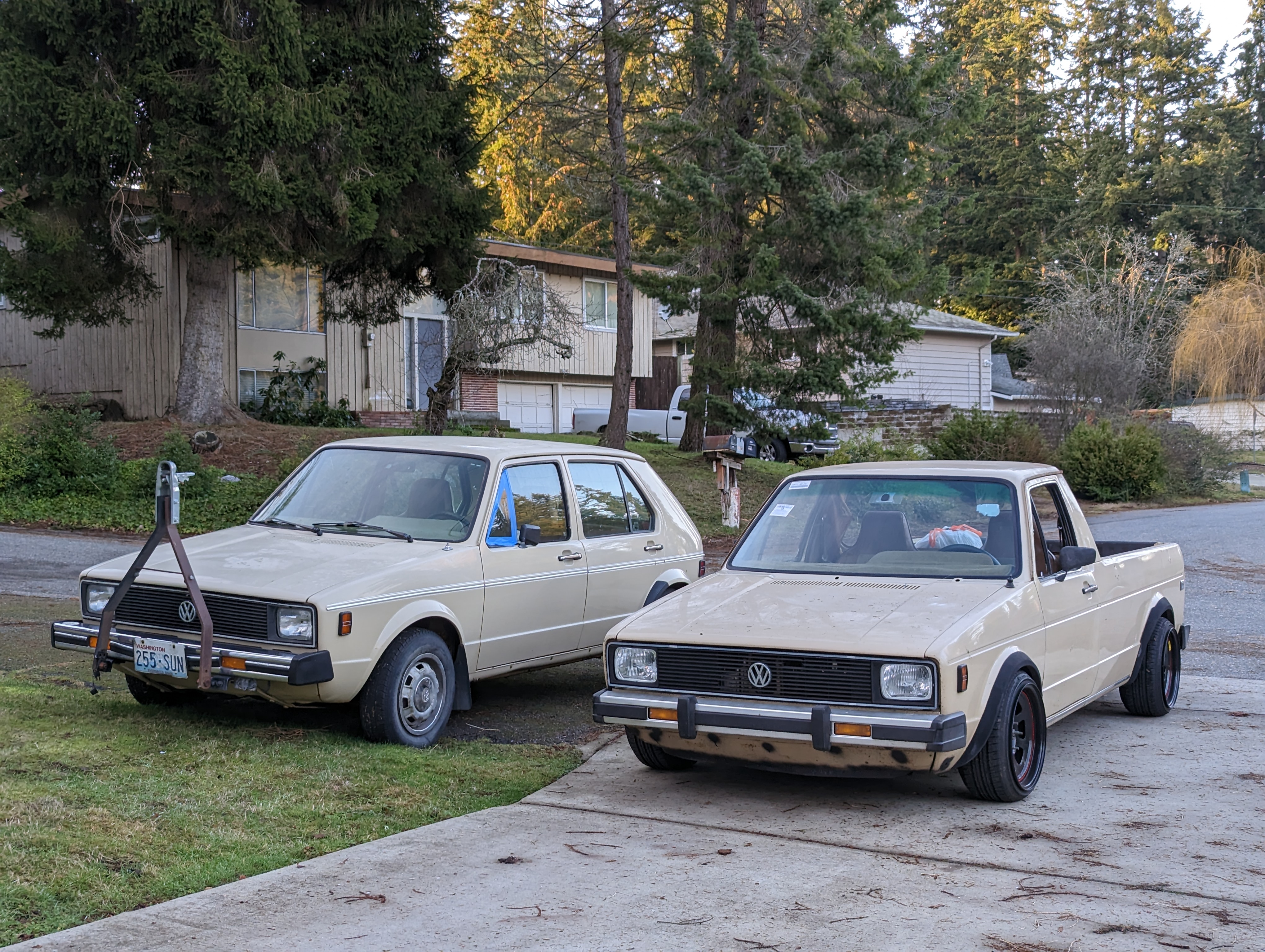

I picked up a matching 1980 4dr Rabbit, that will be getting a model 3 drive unit.
replaced the windshield and back glass along with some minor rust repair

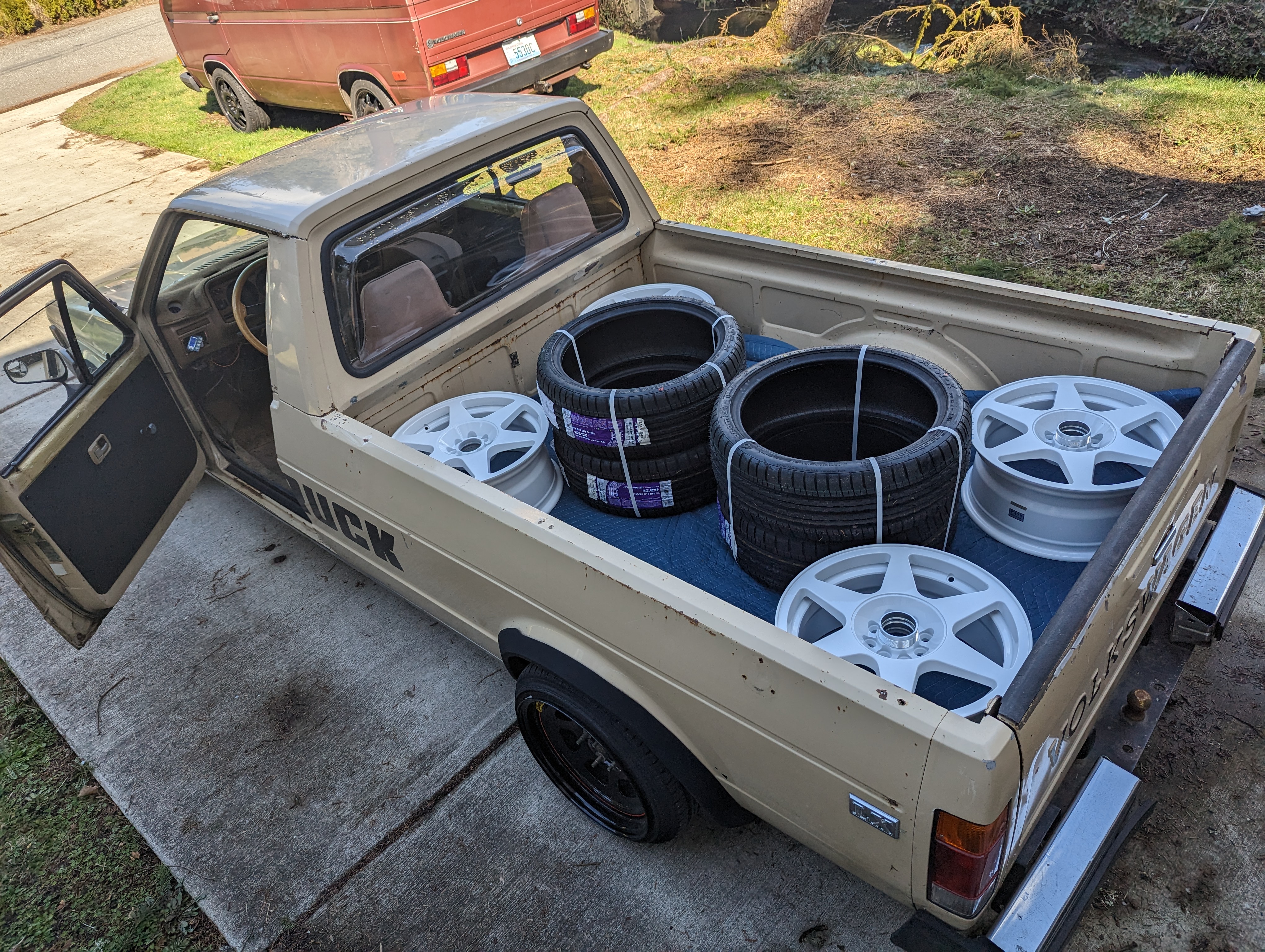

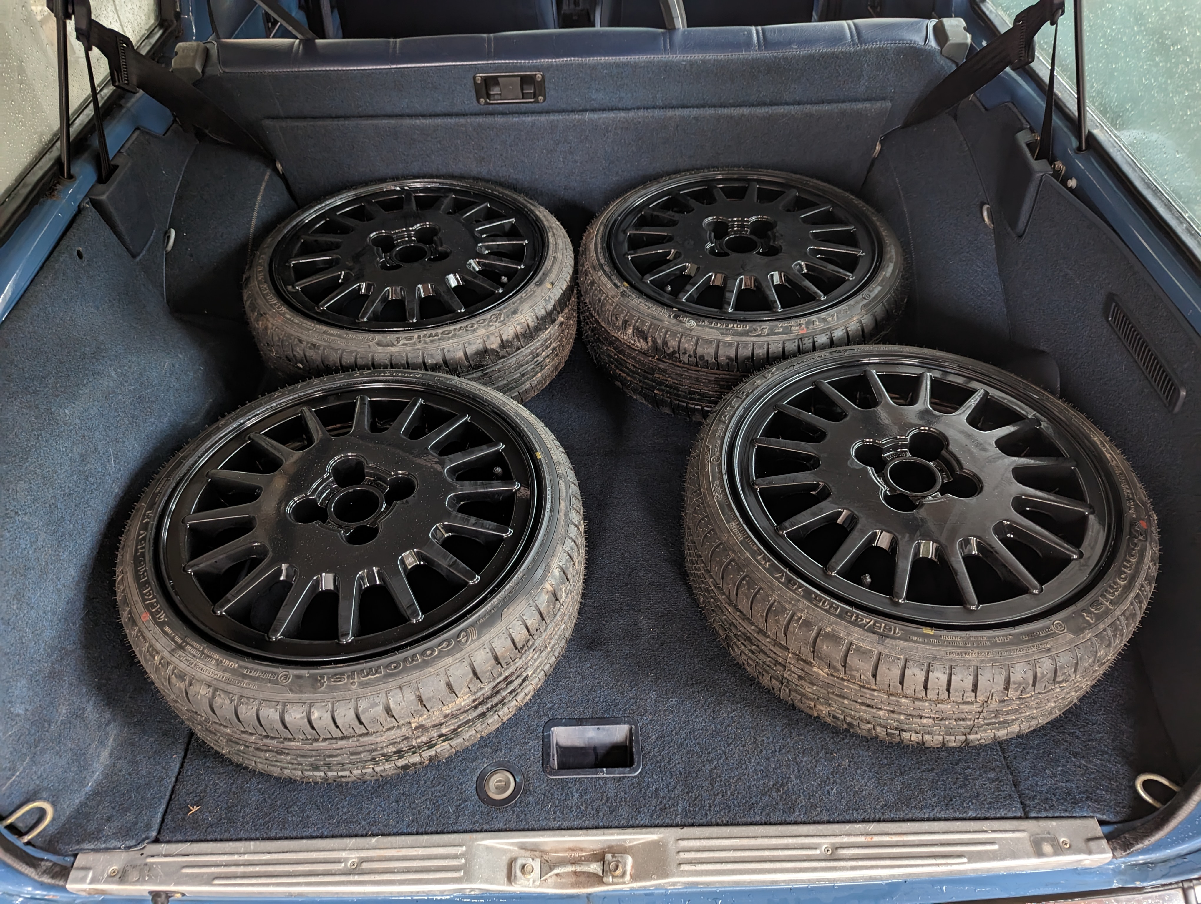

New Corrado Wheels

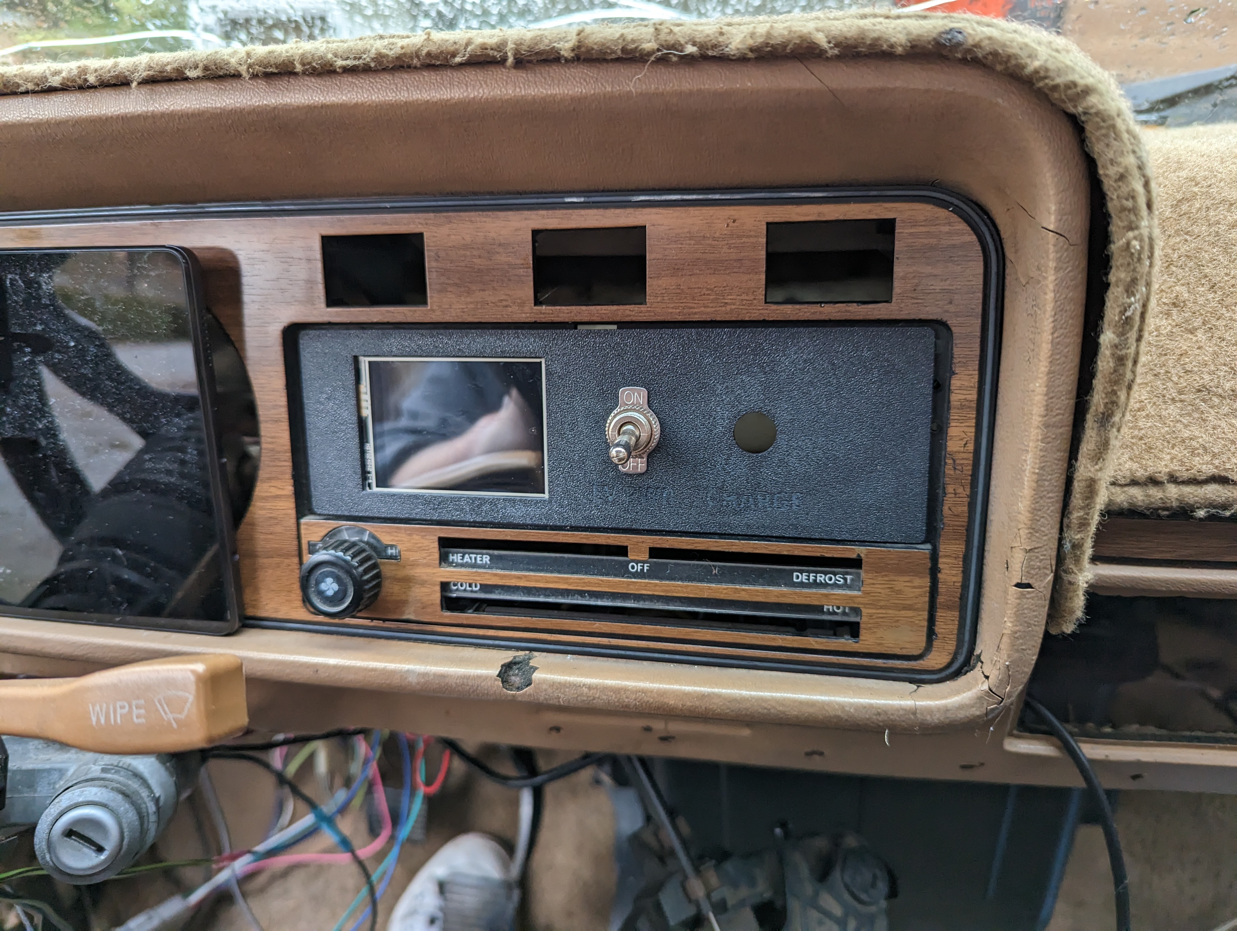

moved the simp BMS display to the dash, but have yet to get it to control the charger

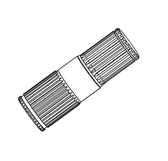

vwbrady wrote: Fri Feb 03, 2023 7:20 pm

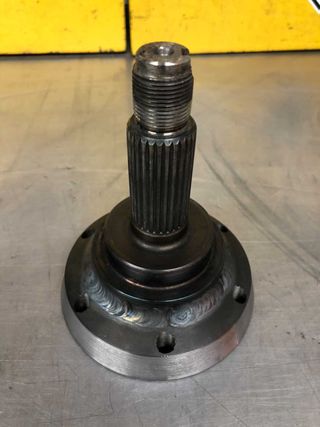

note on the m3 drive units, from what i can tell, the drive shaft stubs between the m3/y and s/x are the same other than the seal od. so looks like you can swap s/x seal on to your m3 drive unit and use the zero ev/ ev west adapter stubs

Bratitude wrote: Thu Feb 09, 2023 12:48 am note on the m3 drive units, from what i can tell, the drive shaft stubs between the m3/y and s/x are the same other than the seal od. so looks like you can swap s/x seal on to your m3 drive unit and use the zero ev/ ev west adapter stubs
I have seen the Zero EV stubs and they look pretty nice! Fortunately, I have the entire front and rear subframe along with all suspension and axles. so being cheap I'll probably just adapt the axles to one another at first. Having the axles I may also find time to model up my own stub for m3/y to VW. We'll see.

vwbrady wrote: Sat Feb 11, 2023 4:15 pm I have the entire front and rear subframe along with all suspension and axles. so being cheap I'll probably just adapt the axles to one another at first. Having the axles I may also find time to model up my own stub for m3/y to VW. We'll see.
id recommend turning down the tripod joint and welding on a flange with the 100mm/108mm bolt pattern.
similar to this:
im probably another 6months away from having tesla to vw stubs (like my leaf ones) available

For anyone curious, the truck has been one of my most reliable vehicles! I can let it sit all winter and come spring time, it just WORKS. Only downside is the ≈7.5kWh I put in it, which gets me about 45 miles. I already have a set of BMW hybrid modules that make up a 12kWh pack that I plan on installing sometime in the future. But as is, I can get to work and back and go anywhere in town easily.
I do only have the option of charging at L1 chargers, which limited out in the wild, but it hasn't been so bad. Next conversion will include CCS1
