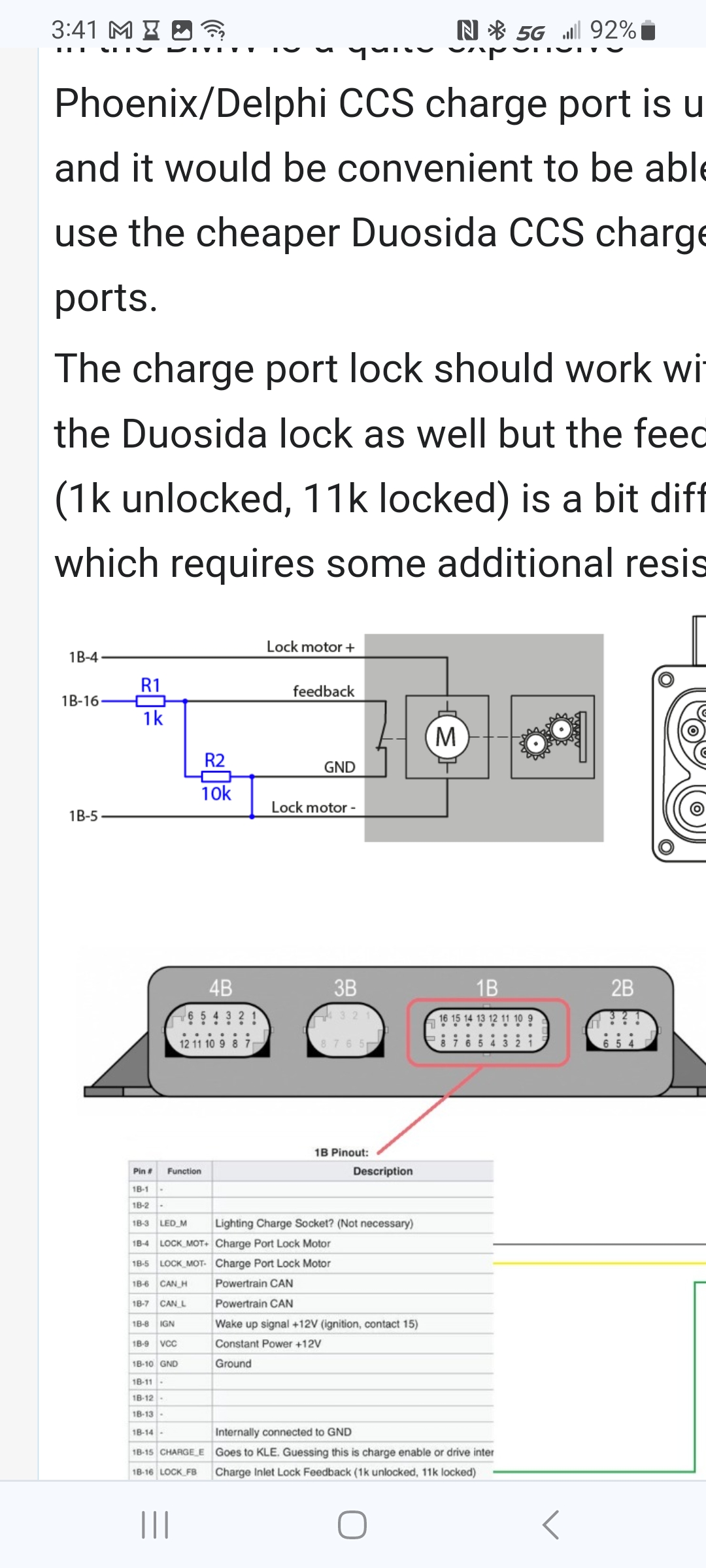

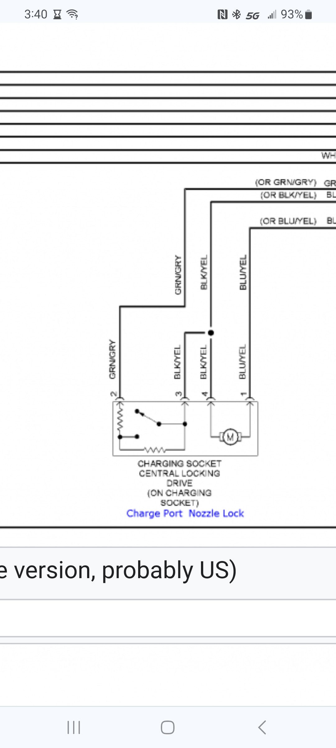

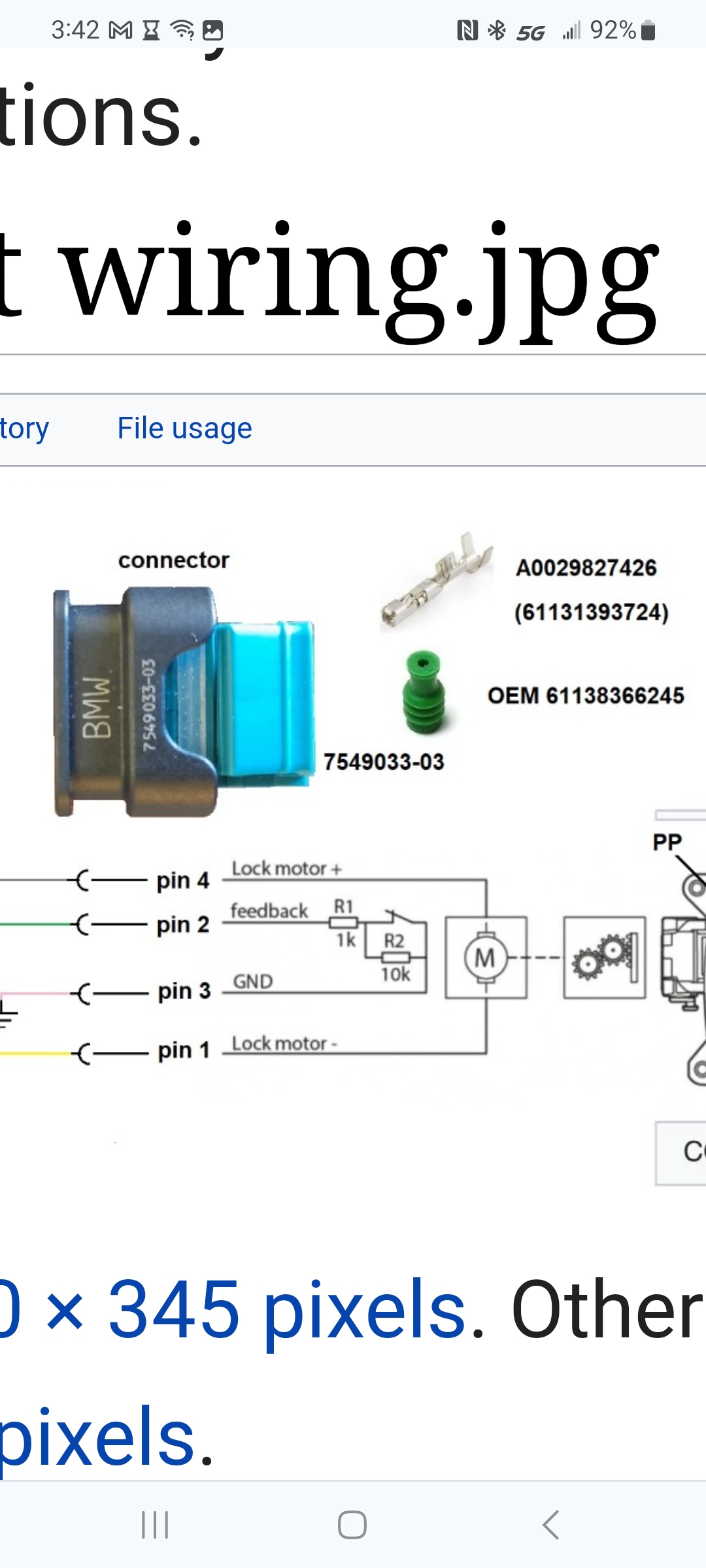

For the charger cable lock motor and position sensor.
On the wiki I found 3 wiring diagrams.
All 3 have conflicting arrangements.
I'm noting that for the position sensor one drawing uses a ground, one uses one of the current for the lock motor, the last drawing uses a ground and one of the currents for the lock motor at the same time.
What drawing is correct. I'm working on CCS1 in the USA if that makes a difference.
I'm also using a BMW i3 CCS1 charge port with lock motor and switch.
muehlpower
Posts: 807
Has thanked: 18 times
Been thanked: 186 times
Post by muehlpower »
The first two pictures show the same thing, a bridge between pin3 and pin4 on the port, which are connected to pin5 on the LIM. It's the same with the I3. The second picture is only important if the resistors are not already installed in the charge port, which is not the case with your original BMW port. Damien did it to put pin4 on ground and it seems to work. To be clear again: picture 1 is crucial for you.
