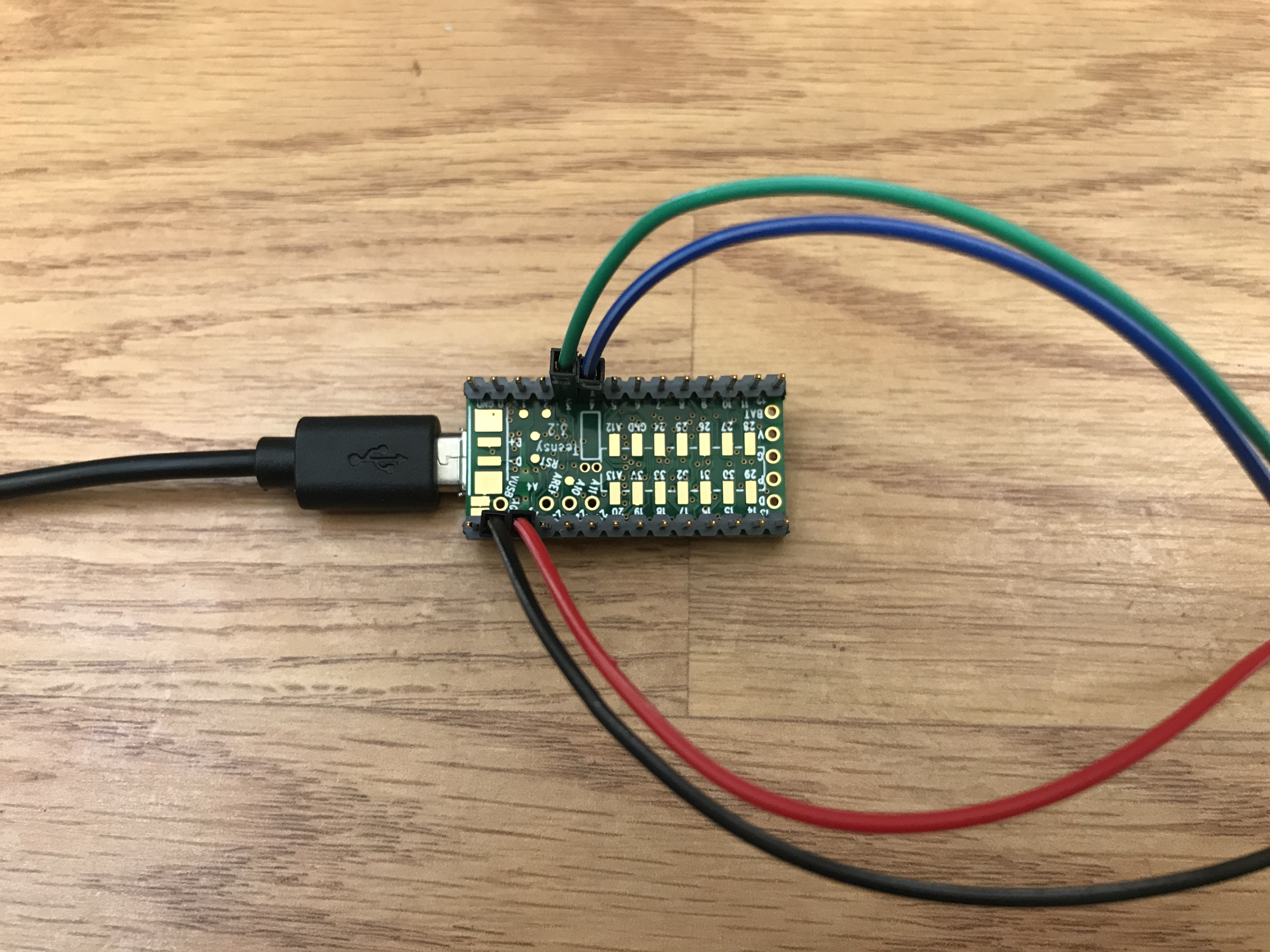

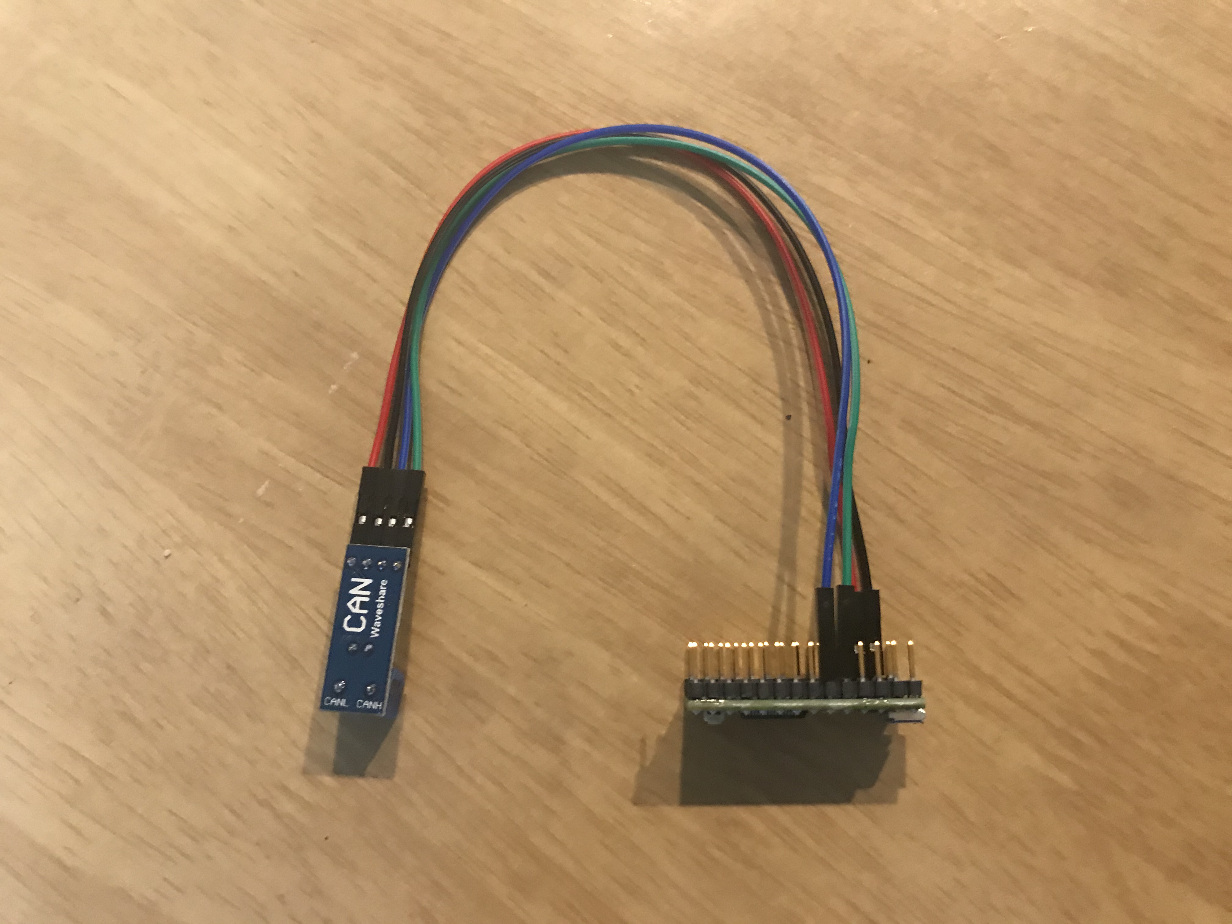

So I am getting some help from a forum friend and Best EV Conversion trophy winner arturk to integrate the aftermarket Intellitronix digital gauges with the EVBMW Lexus GS450h VCU ver 2 hardware

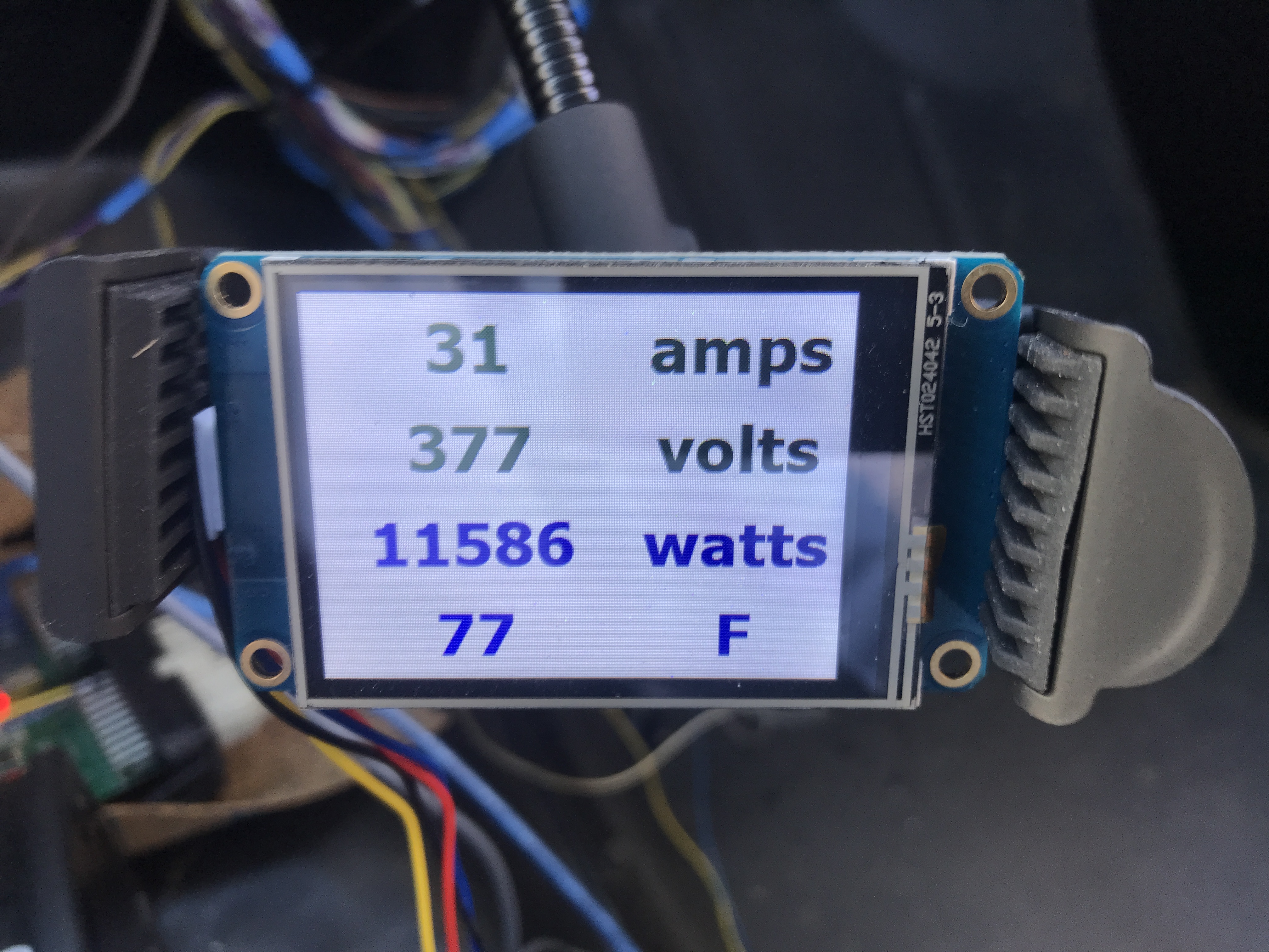

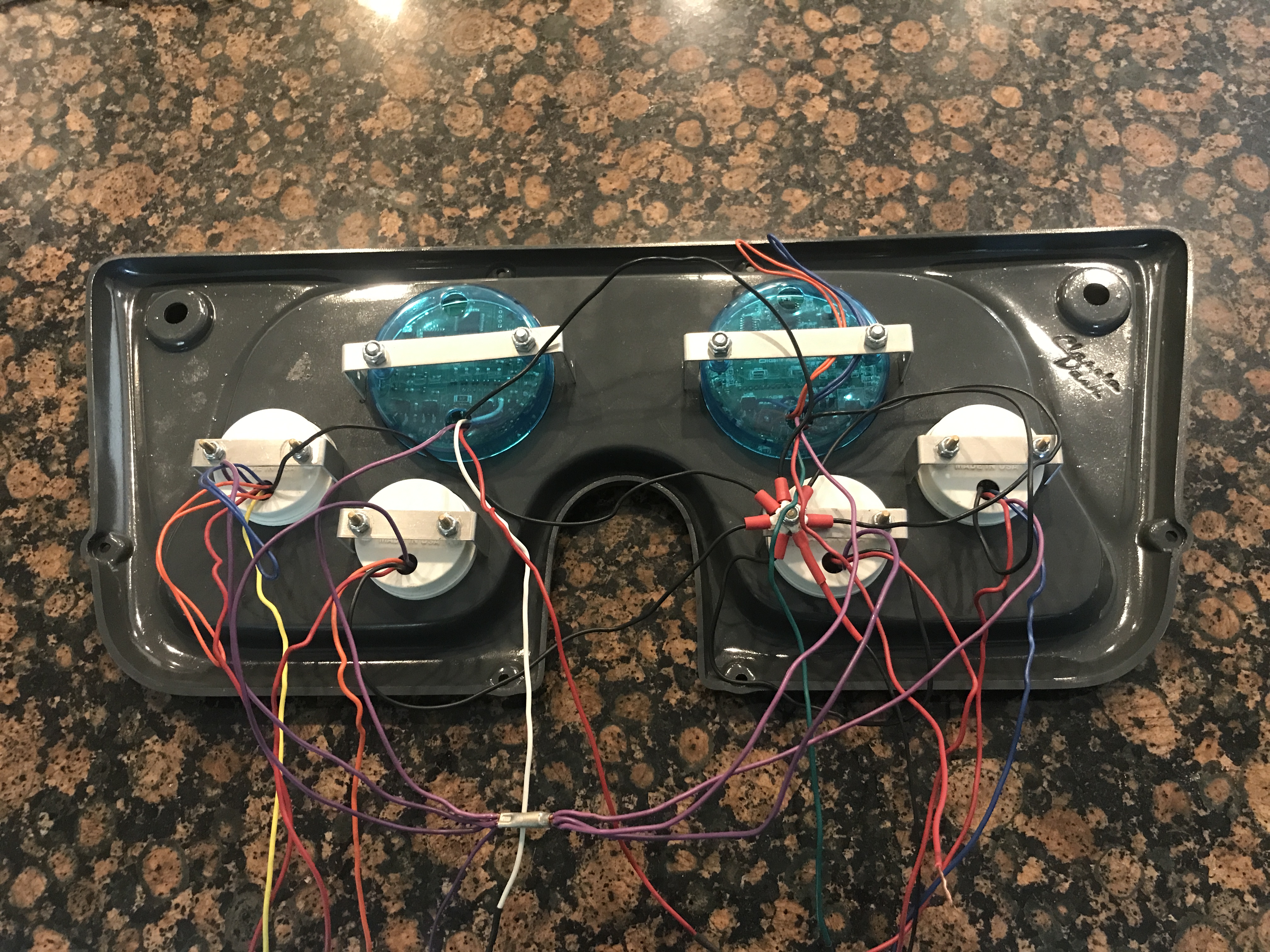

so I finally got my amp reading working so now I can see how much current it pulls and calculate watts aka power, pretty cool
I did a first pull on it and it got up to 311 amps so assuming something like 370 volts that's 115 kW or 154 hp
this is just a random pic of what I am looking at, at a glance on my little handy 2.4" Nextion display

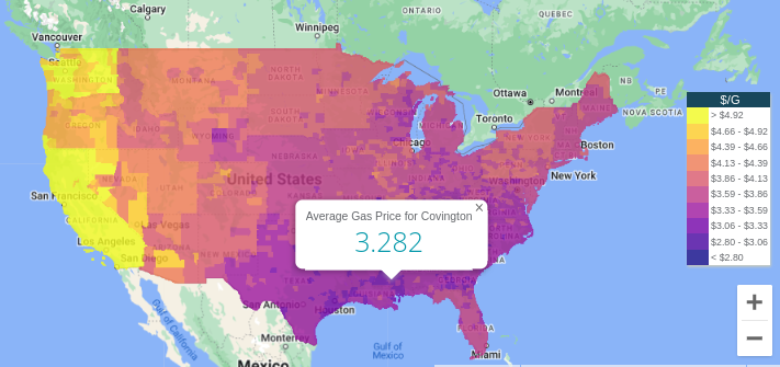

Gregski wrote: Sat Sep 16, 2023 3:06 pm Reason Number: 5,499 to convert to electric
I thought petrol (Gas) was a lot cheaper in the US but the difference not as big as I expected.
We pay around £1.50 per litre which is £5.68 for a US gallon (A US gallon is smaller than a UK Imperial gallon) or $7.04
Proton
Posts: 366
Location: Georgia/US
Has thanked: 227 times
Been thanked: 57 times
Re: [DRIVING]1971 GMCe Lexus GS450H BMW 530e Tesla Model S powered Electruck
Post by Proton »
Alibro wrote: Sat Sep 16, 2023 4:50 pm I thought petrol (Gas) was a lot cheaper in the US but the difference not as big as I expected.
It is cheaper. In Georgia is $3.60. Is expensive only in Democrat states. Republican states have a lot less taxes. Even in Europe at least 60% of the gas price is tax.
For example my sister lives in Sacramento CA. The house tax is about $7000/ year. My house payment + taxes + house insurance is $7200/year. So where you live in USA makes a difference.

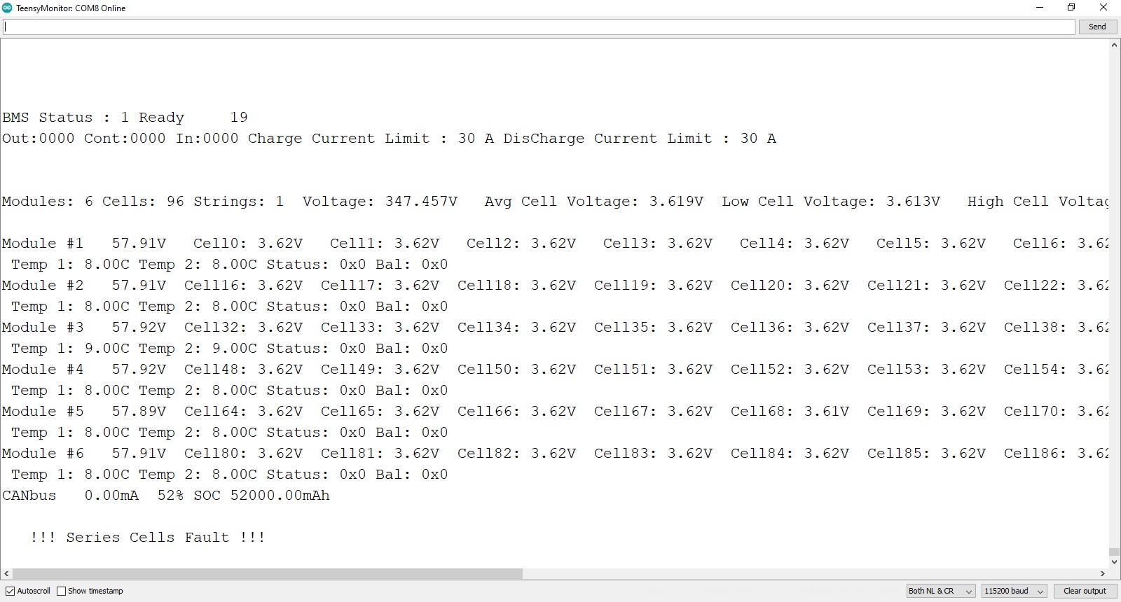

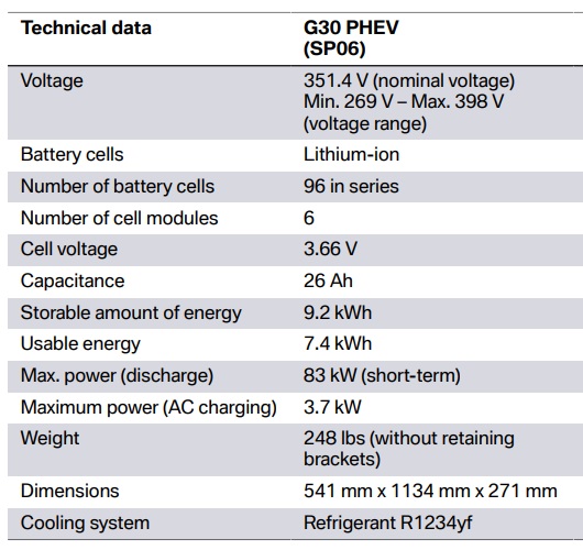

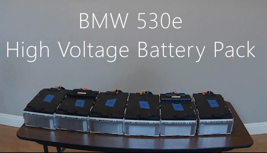

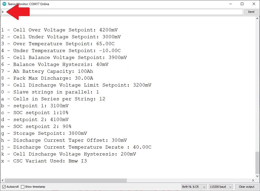

have some Charge Time numbers to share, for those of you Table Data Averse (TDAs), it took 5 hours to charge from 50% State of Charge to 90%.
this is a first crude attempt at getting some idea of how long my pack takes to charge, which I honestly don't care if it takes, 3 hours, 6 hours, or 9 hours, as I just plug it in before going to bed and by morning she is fully charged!
TIME VOLTS DURATION SOC COMMENT
269.0 0 Minimum Voltage per specs
300.0 My practical floor
9:19 PM 346.5 50% per SimpBMS guestimate
10:19 PM 1 hour things to watch while it's charging
11:19 PM 2 hours
12:19 PM 3 hours Tom is at it again vid
1:19 AM 4 hours
2:19 AM 393.5 5 hours 90% No BMS so only going to 90%
398.0 100% Maximum Voltage per specs

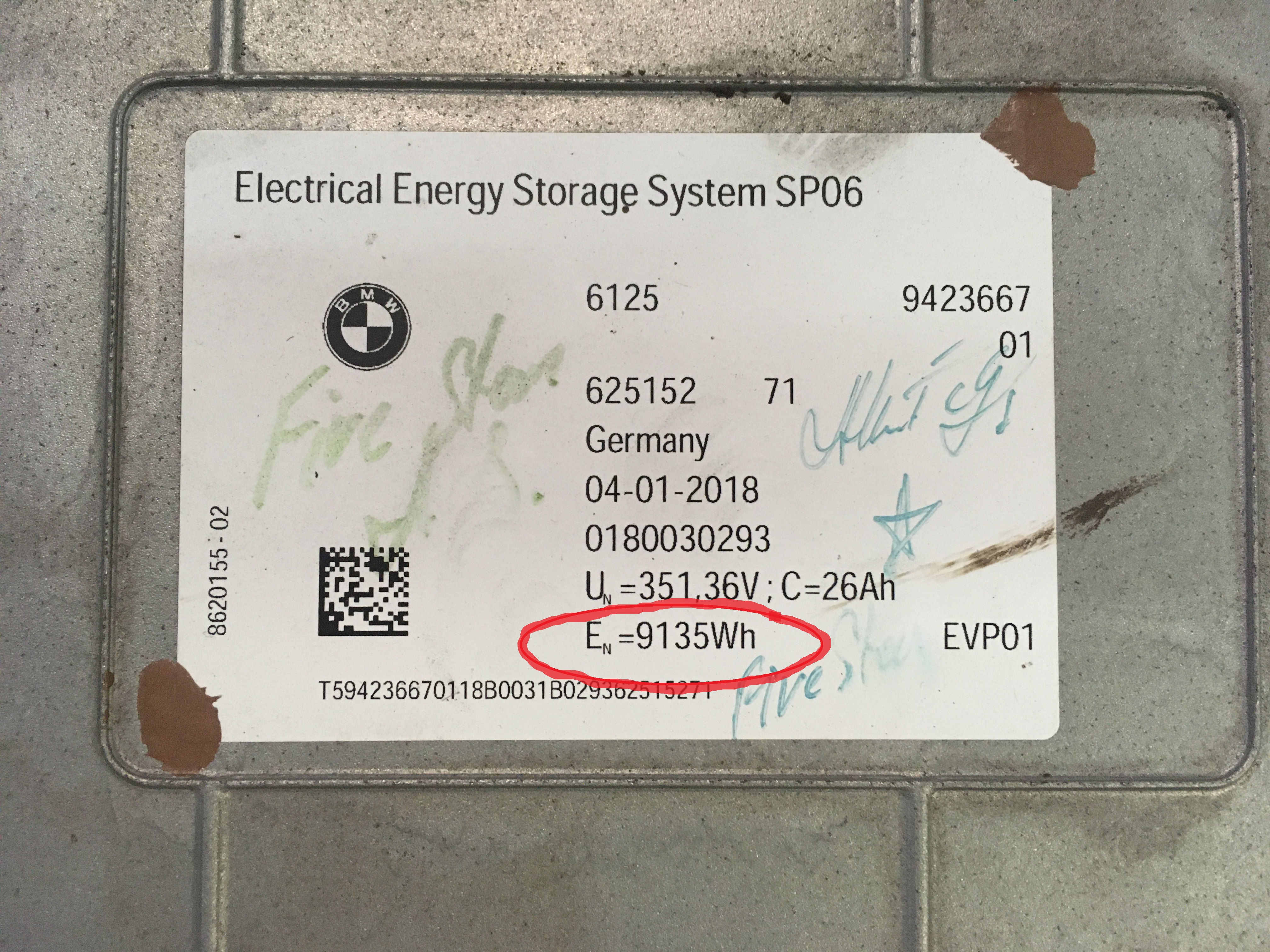

What's the capacity?
Gregski
Posts: 3161
Has thanked: 631 times
Been thanked: 1608 times
Post by Gregski »
andybpowell wrote: Wed Sep 20, 2023 3:34 pm What's the capacity?
9.1 kWh

Gregski wrote: Wed Sep 20, 2023 3:10 pm
You need to input voltage and SOC points for it to guess. :) you just left the standard numbers did you not?
Let me look for a cell voltage curve.

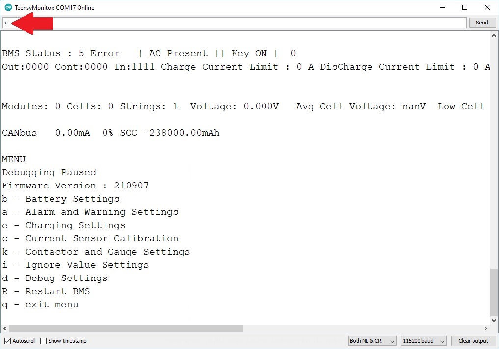

Post by Gregski »
tom91 wrote: Wed Sep 20, 2023 6:05 pm You need to input voltage and SOC points for it to guess. :) you just left the standard numbers did you not?
thank you so much Tom, I appreciate it, yes I just downloaded the Tom-evnut/BMWPhevBMS from your GitHUB and ran it on a Teensy with a CAN bus transceiver, these are the old pics when I first did it a year ago or so, I honestly must have assumed the defaults were set for this pack, don't ask me why

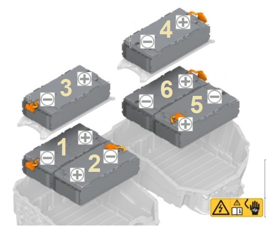

tom91 wrote: Wed Sep 20, 2023 6:30 pm https://www.batemo.de/products/batemo-c ... -bmw-530e/
Knew I seen this somewhere.
Thank you so much Tom, the screen below is what I was going off of, and I thought if the BMS is smart enuff to detect the six cell modules and enumerate all 96 cells than surely it must know the SOC
I further insult your intelligence in an excruciating detail write up here: I bought a BMW 530e hybrid battery pack - Now What?
