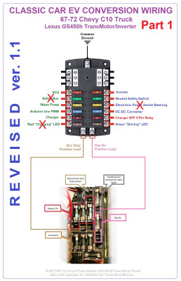

Re: 1971 GMCe Lexus GS450H BMW 530e Tesla Model S powered Electruck [FIRST DRIVE]
so the truck was running and driving great (I mean even the eye balled wheel alignment was on point) so it was time to mess with it
we begin with shuffling a few things around on the EV Fuse block, and providing reasons for it / justifications
1. straight away we learned that the Red "We're Charging" LED has to be wired to the 5 Pin Charger Off relay or else it will just remain on even in Driving Mode (since on these old Chevy trucks the Accessories stay on as part of the Ignition Key On mode)
II. The Toyota Prius Electronic Power Assist Steering - EPAS, has no business living on the EV Fuse Block and is just taking up valuable space. Think about it, you can implement this wonderful stand alone fully self contained setup on a regular Internal Combustion Engine (ICE) vehicle. So we will re wire it to the stock OEM GM fugly fuse block.
C. The BMW 530e Safety Box ie Contactor Box needs to be moved to the Key On side, not because we can't drive with it on the Accessory side, no the Drive Mode is fine, it's the charging through it that we suspect damaged the unobtainable 15 OHM OEM resistor and caused us much grief. Yes, BMW does charge through the Safety Box I'm sure, but until it is fully reverse engineered we will remove it out of the equation and hard wire the charger directly to the battery (safety third!)

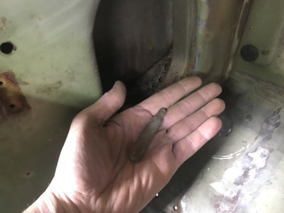

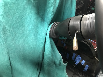

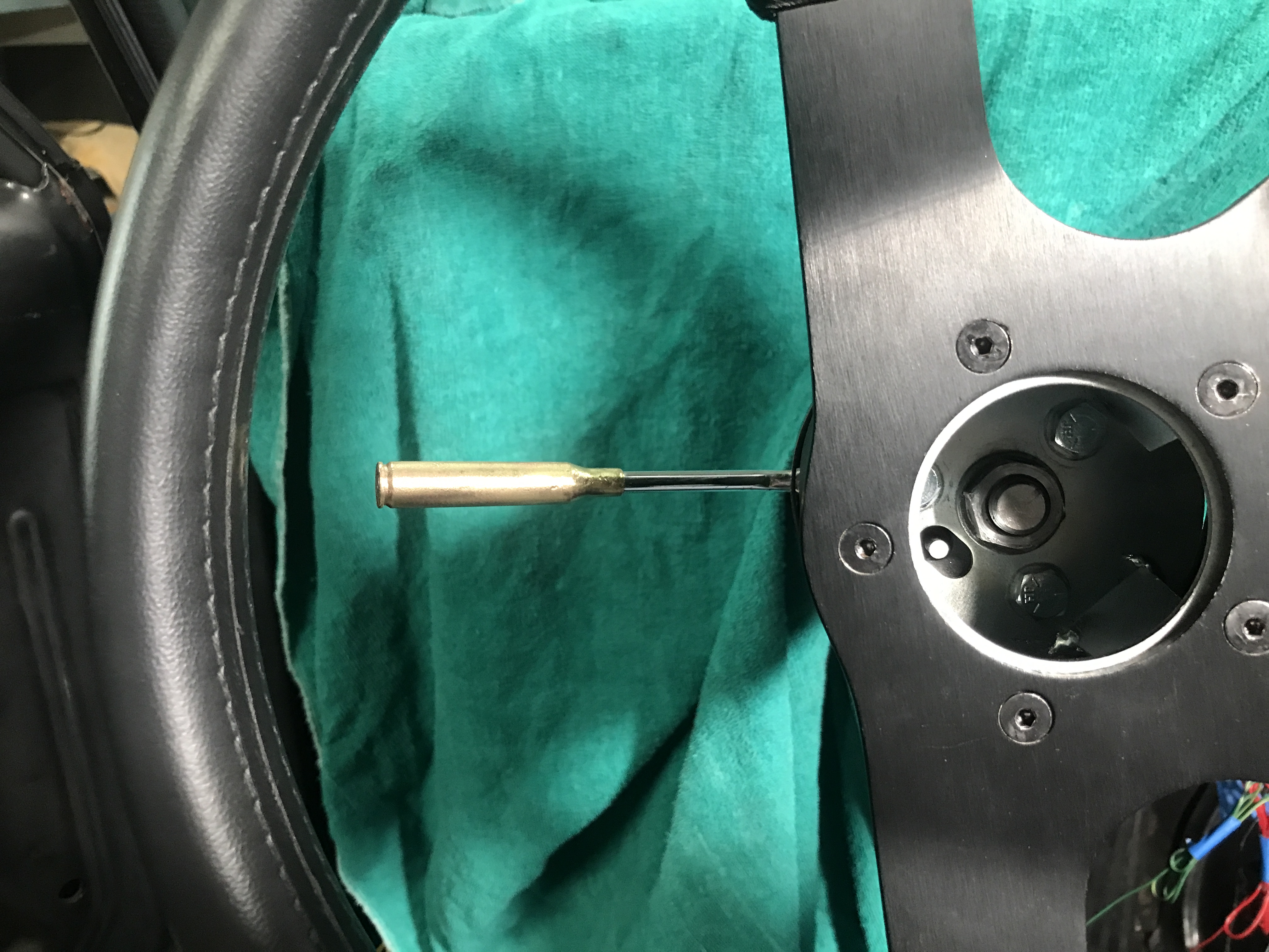

not EV related just friggen cool
I literally found this shell in the driver side A pillar vent, my buddy seems to think it rolled off the dash and fell in there, it's an old caliber probably fired by John Wayne himself, so when life gives you lemmons...

I can give you more of those if you want. LOL.... I have plenty.

W-W Super 270 Win
The .270 Winchester is a rifle cartridge developed by Winchester Repeating Arms Company in 1923

ok, not that one but I have 308, but I like the idea and I want to copy it somewhere i my car too.

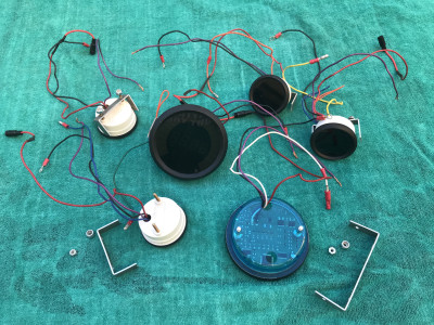

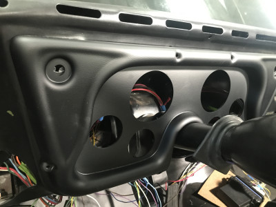

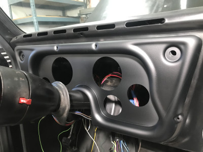

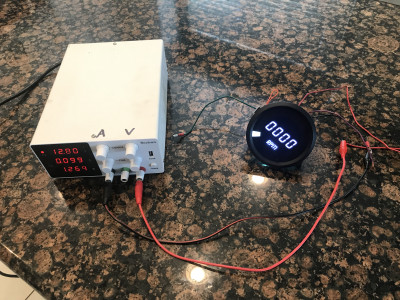

so sorta related to EV's we're going with stock(ish) aftermarket gauges. I had to get a new gauge bezel simply because the GM liked to use 5" gauges and the aftermarket offers more choices in the 3" so we needed smaller holes
I live for the box inside a box moments
well she looks money in the hallway

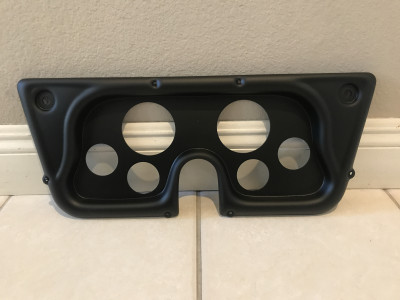

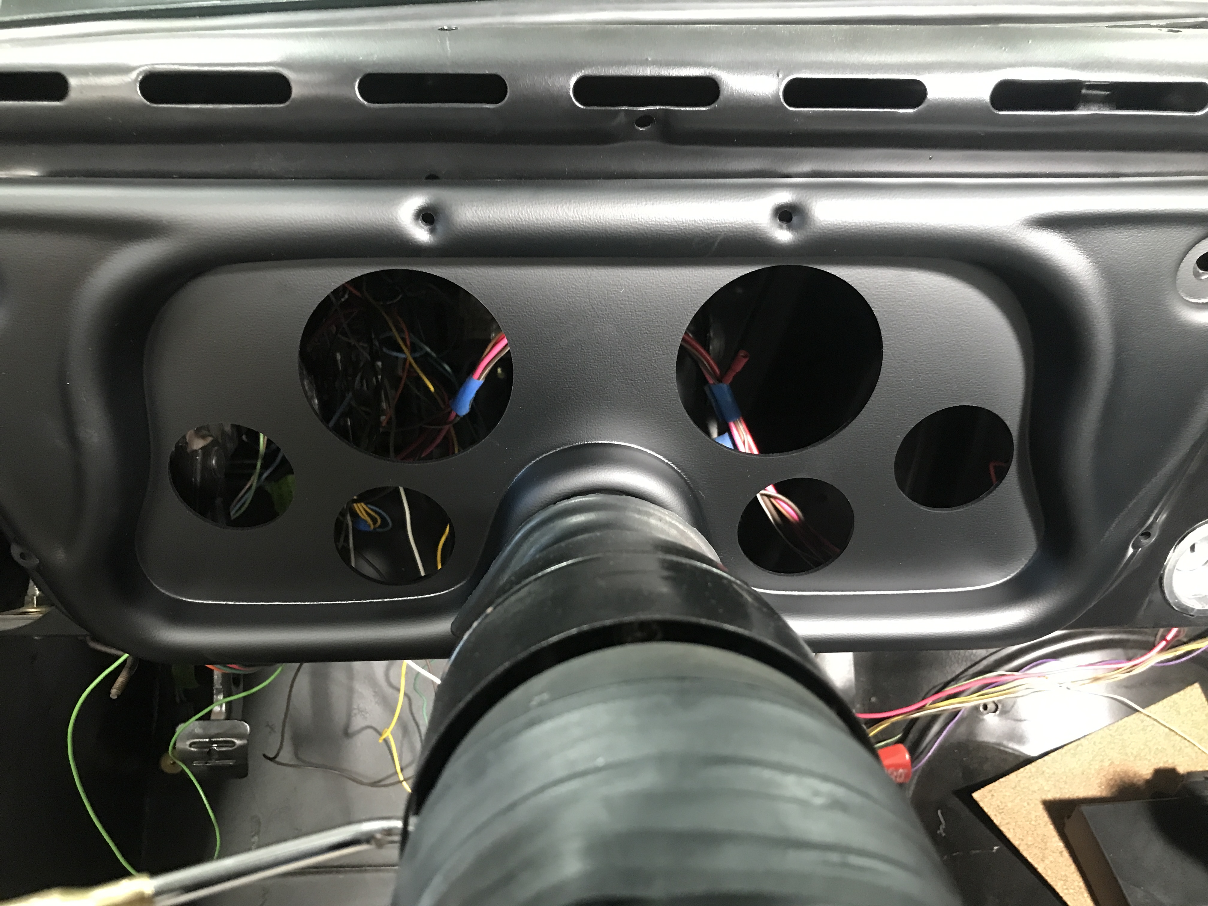

lets try her on for size, the bubbly curves are still growing on me, would prefer the more sleek symmetrical copy of the glovebox like the OEM
AutoMeter 2142
AutoMeter 2142

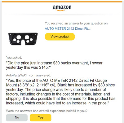

LESSONS LEARNED: One Must Be Johnny On The Spot!
I felt this in my gut, since with two kids in college every dollar counts:
so I first discovered these Intellitronix digital gauges on Summit , not sure if folks in Europe shop Summit I doubt it but in the states they are sort of the COSTCO of aftermarket parts meaning they sometimes rebrand products as their own, think Kirkland brand. so anywho they were offering these gauges under their Summit name, and that usually means they are decent
I have now ran these gauges in two of my trucks and I safely certify them as: "Just OK" and here's why:
- the quality is hit or miss, mostly they won't fall apart on you and won't be crooked, etc
- some models only increment in 100s so the last two zeros on the Tach are just hard coded and never change from zero, this is a PIA if you want to fine tune a vehicle, you will never see it idle at 650 it will either show 600 or 700

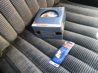

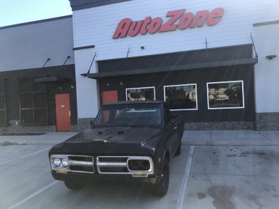

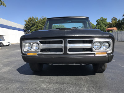

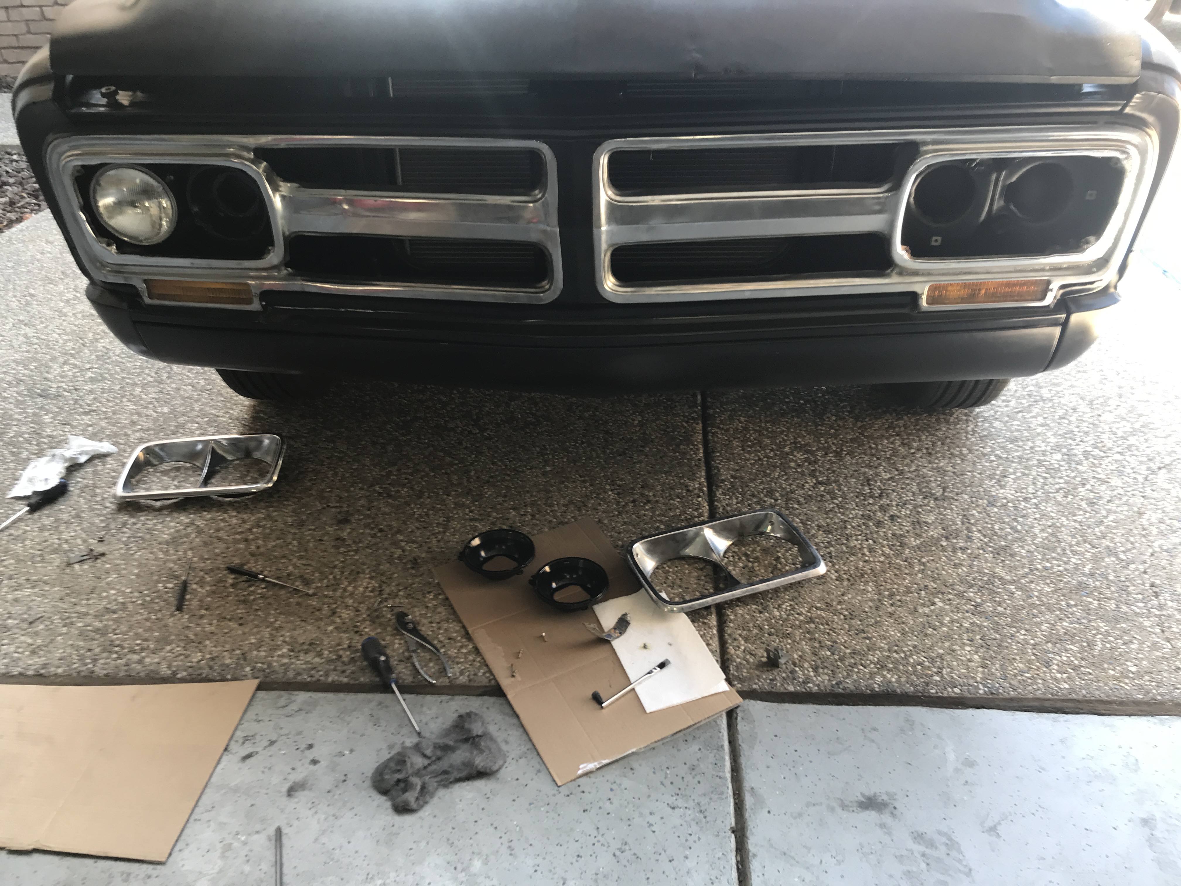

buy a Chevy they said, you'll be able to get parts at Walmart
um, no... ha ha, had to go to three different parts houses for a box of silly headlight adjustment screw nuts, but at least we got to drive the Electruck !!!
- Gregski
- Posts: 3164
- Has thanked: 635 times
- Been thanked: 1610 times

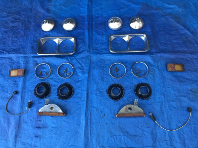

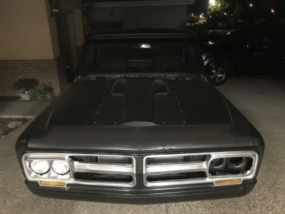

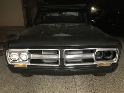

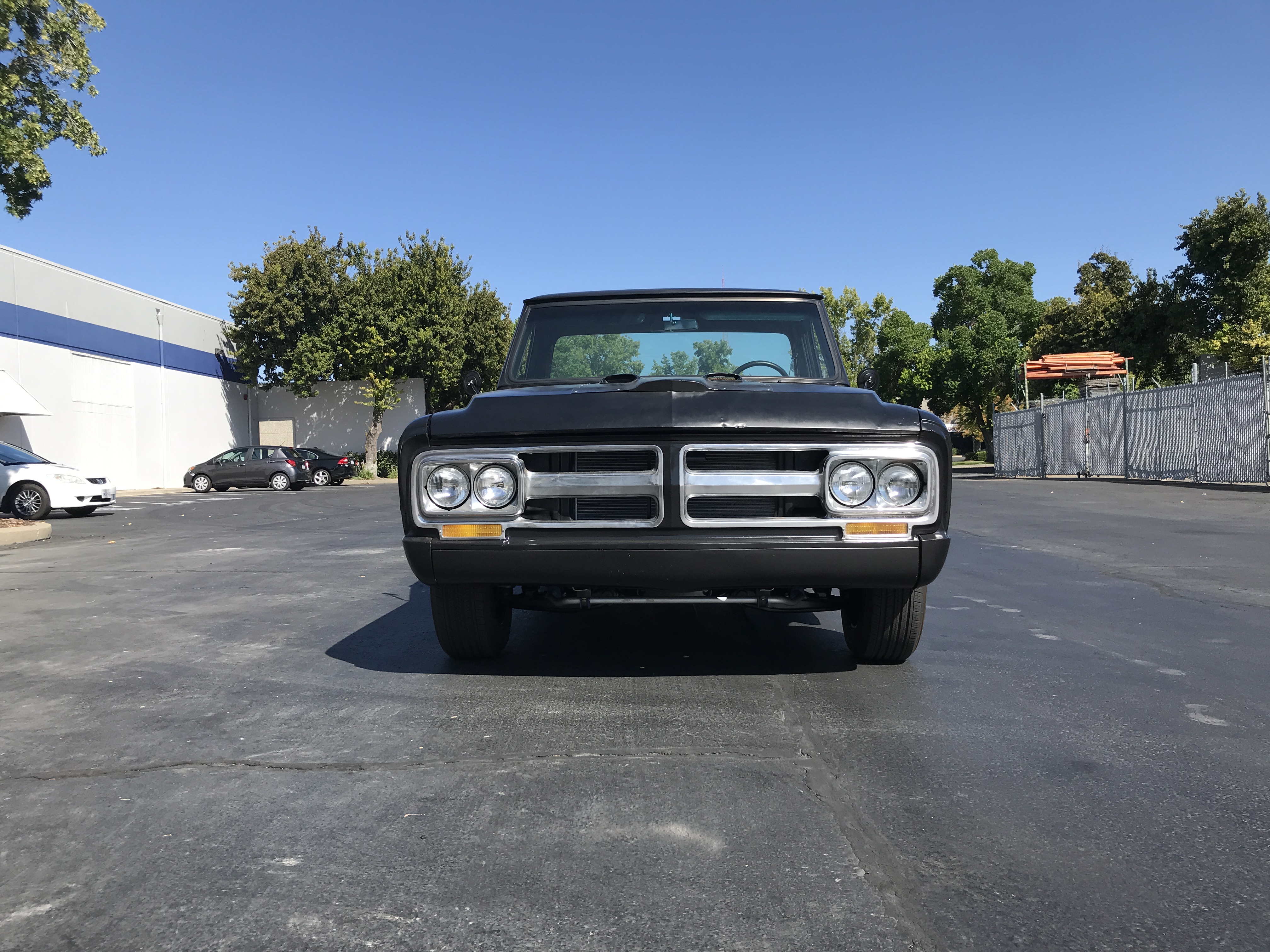

but I think it was worth it, as she now finally has all four eyes

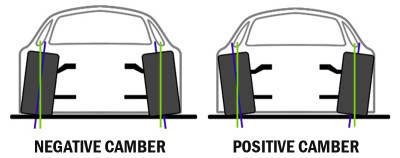

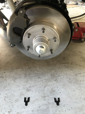

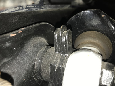

you know the vehicle is lighter than stock post EV conversion when you are forced to remove alignment shims to eliminate positive camber
Say What?
At some point smarter people than me decided that having car wheels be straight up and down wasn't complicated enuff and invented lean, but to be cool they called it "Camber" then they went further down the complexity rabbit hole and decided that "Positive Camber" is bad, and "Negative Camber" is good (in some cases, it all depends)
some say it's for stability, I know it's for street credit and the cool factor, anyway here in the Colonies we rely on old tech so in order to make the top of our truck [sorry] pick up wheels to go from leaning outward at the top to leaning inward at the top we have to remove these funny opened on one end metal washers (add more to create Positive Camber, remove them to get Negative Camber) which sit between the upper control arms and the frame of the truck
Say What?

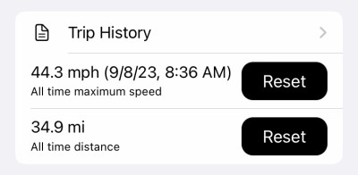

Range Test #3 - didn't quite hit 35 miles and I babied the hell out of it, No Freeway driving at all, mostly residential and kept it under 45 miles per hour, gentle and took me well over an hour
so I am calling this the 30 mile battery pack, and NO I aint saying run a 9 kWh battery back, of course it is too small, but you know what for a quick install for a Proof of Concept it is absolutely brilliant and makes for a functioning "One Errand At A Time Truck" aka the OEAaTT
"hey dad, can we go to Subway?" yes kid, no problem, "hey honey can we also go to Target?" tomorrow baby, tomorrow, ha ha

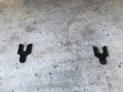

stop reading my mind, I just need to remove the last of the alignment shims since I still have .50° of positive camber and the specs on these trucks called for negative camber, stay tuned

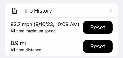

TOP SPEED TEST #1
82.7 MPH
so took her on the Highway for the first time and OH MY GAWD she drove like a dream, effortless! I just jumped on, on one entrance and did not stay on too long cause I had no idea how far she could go on speeds upwards of 65 MPH, but she did fine. Keep in mind she has no side windows yet and that creates drag, and I didn't fully commit on this first test, so this is just a start. Also only running on one motor in that Lexus GS450h transmission aka MG2, we are not sending any torque commands to the smaller motor aka MG1 at this time, this is on purpose.
