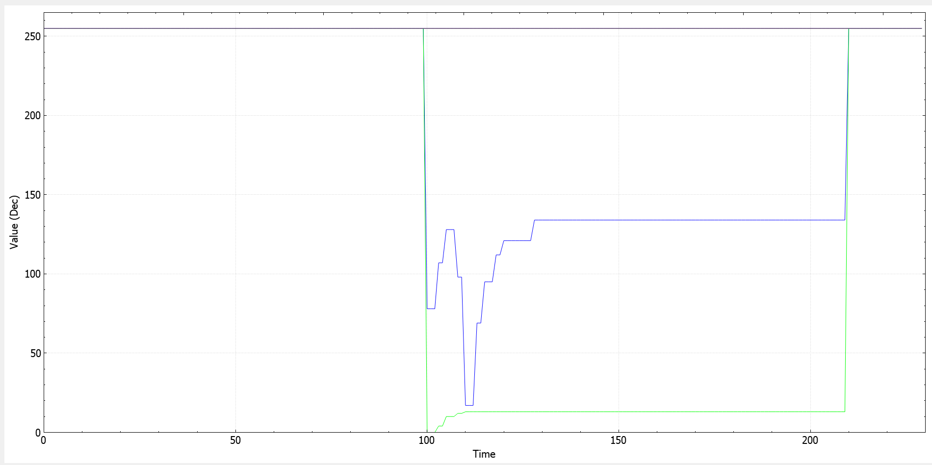

I have been helped a number of times on the forum in the journey to my own conversion project. and now I have arrived at the last part, CCS.
my setup is: Zombieverter VCU(only for the LIM), BMW LIM 61 35 6 828 052, 96 cell 24kw BMS hybride pack.
with the AC charging the lock works and i can do contctor test successfully. the DC inlet voltage sensor also works properly, when I apply the various voltages I read them back correctly (on a few volts, I don't know if that's good enough) via 0x3B4.
I went to a shell recharge station to test, I've come a long way but the chance that everything would go well in 1x is of course quite small. the charging station starts and I see a screen with the SOC at 50% (comes from the VCU), I hear pumps and fans come on in the station. but then it stops. no error messages on screen or VCU. in the VCU the last CCS_State is 4. at that moment I also hear the CCS slot open, it seems as if the session is just being stopped. when I go through the CANlog I see the charger in Pre_charge state trying to match the inlet voltage and then it seems to stop. I think this is the time for the relays in the car to switch on? i couldn't hear any relays switching because there was too much noise in the area. so I'm not sure if they work, what I also noticed is that I don't hear them switching during the weld test. I actually assumed that this would happen, but the weld test is apparently completed successfully. the relays work just fine when I put 12 volts on them.
the relays come from the BMW s box and have a coil resistance of 30 ohms so I put a 30 ohm resistor in parallel with the coils to get the 15 ohms.
would someone who has been working with the LIM module for a while take a look at my log files?
I am curious what the problem could be, if more information is needed please let me know.

I think I have already found a hint, when I look in the code of the VCU it is checked in state 4 whether the inlet voltage is < 20 volts of the charger. when I then look at the log the value I get back appears to be very unstable, so I have to make that stable first before continuing to the next step.
I will give an update when I have solved this, if any of you have another insight, I would like to hear it.

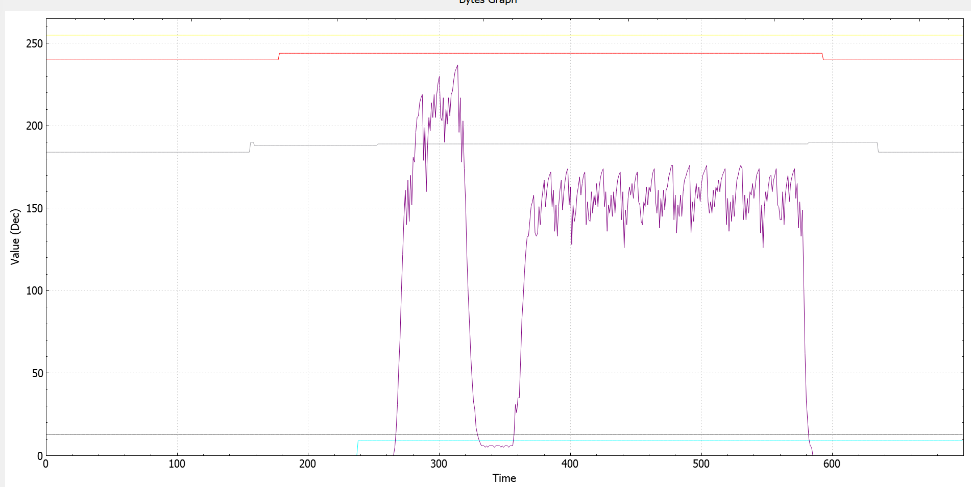

one more question, in anticipation of the next step, my current sensor reads a positive value when I use current from the battery when driving, and a negative current when I charge. so when i go to charge it will report negative current to the lim, is this correct or not?

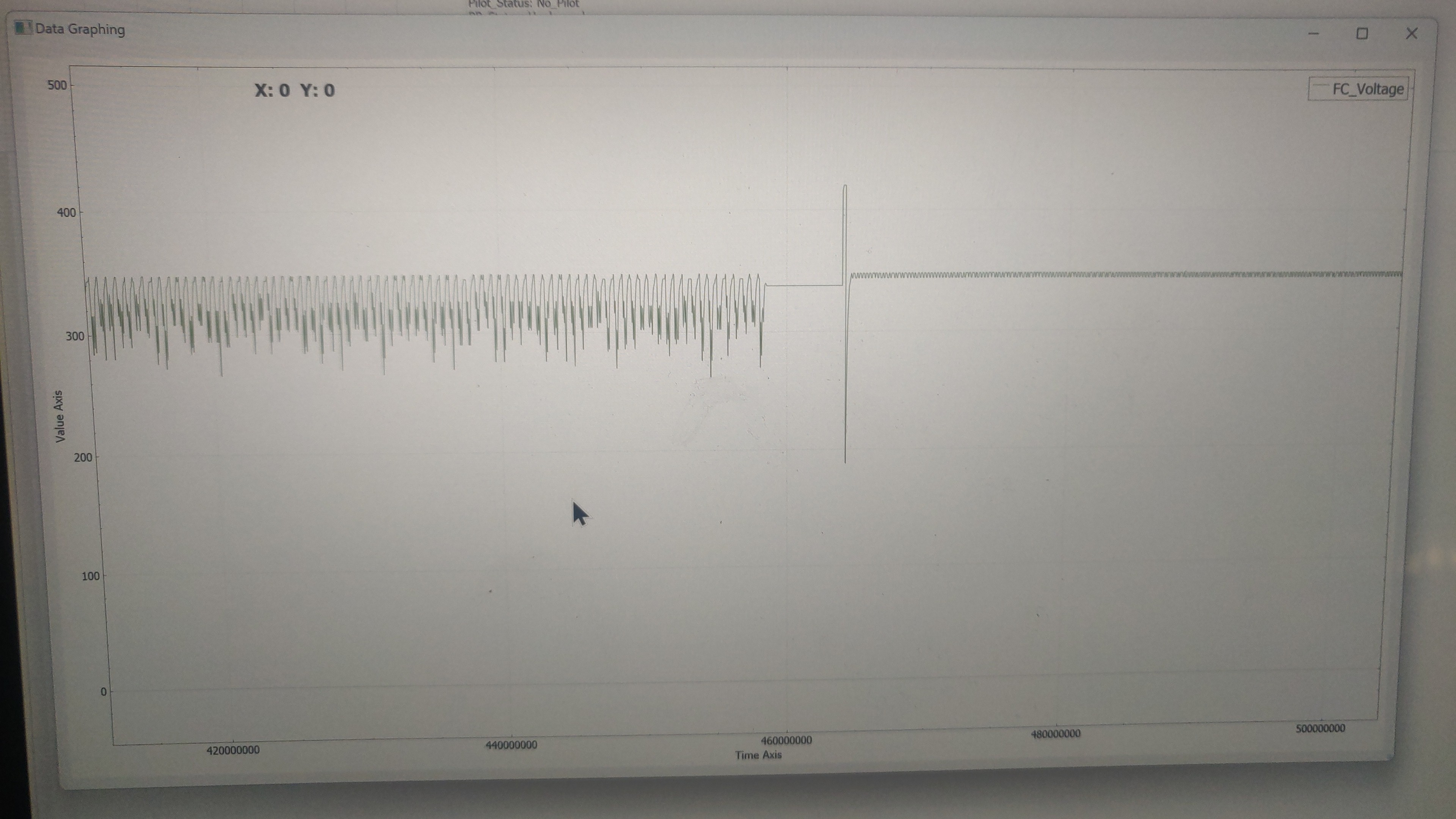

Some progress, fixt the unstable init port measurement and now I come to stage 6 but fails after that. I have a log but I want to look at this first. But I don't hear the relays closing and they should be at that stage, so I think there is something there.
During the weld test I also don't hear them closing, assuming this would be the case. Can anybody confirm that?
Screenshot from the signal before and after, the problem was clear
