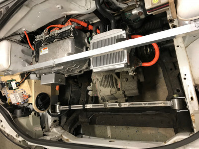

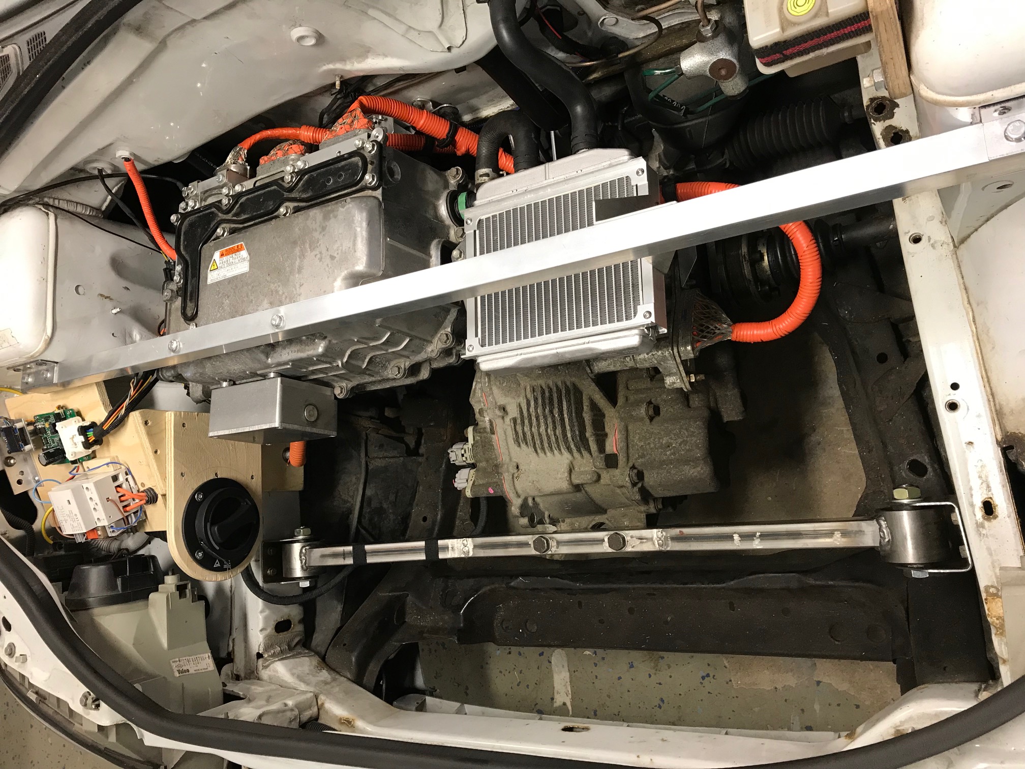

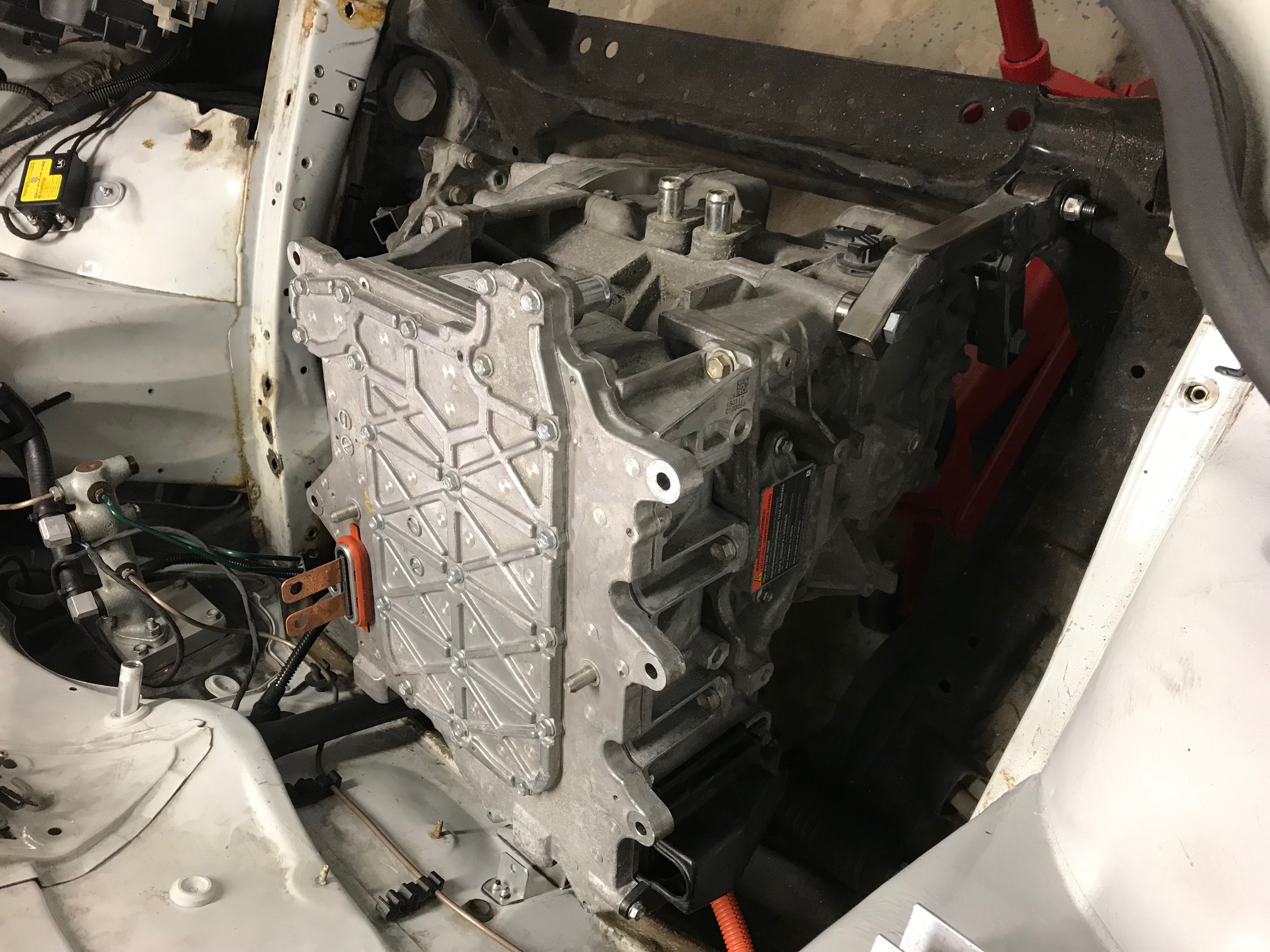

I have now taken the decision to replace the MGR with a Leaf motor/inverter. Started the work this weekend and can so far conclude that it fits nicely in the engine bay, with space to spare.
Plan is to control the Leaf inverter via CAN and retain the Prius inverter for DC/DC and charging.

How much voltage for Leaf motor?bexander wrote: ↑Mon Sep 27, 2021 6:23 am I have now taken the decision to replace the MGR with a Leaf motor/inverter. Started the work this weekend and can so far conclude that it fits nicely in the engine bay, with space to spare.
I see with Lebowski brain FW area can be really wide. I would think you could use 200Vdc and still retain up to 8000rpm with reasonable FW no problem.

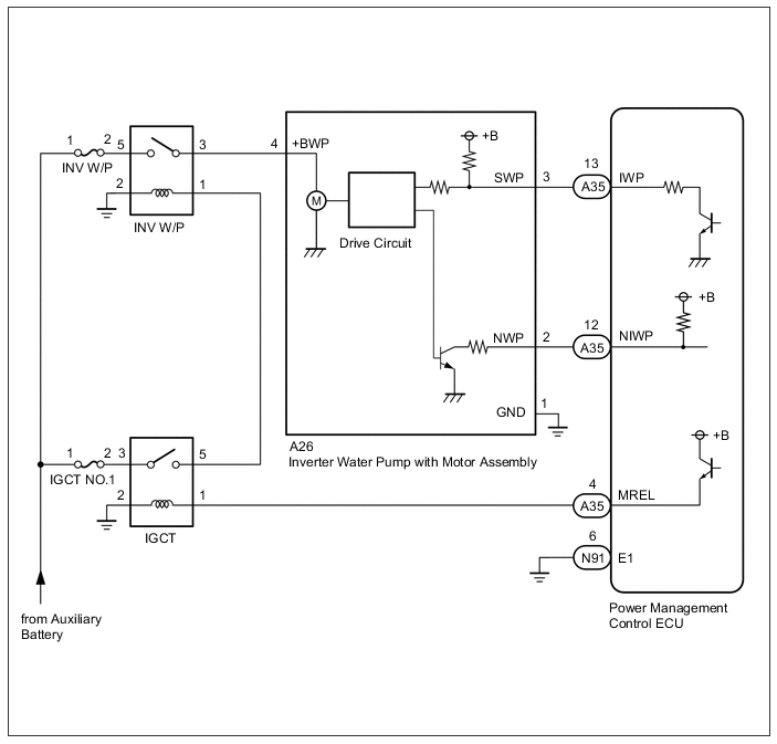

I found a Lexus CT inverter coolant pump, G904047090, with controlable speed and feedback signal as well as 16mm inlet and outlet.

I'm unable to figure out how to control the Toyota pump.
Is it possible to control the speed of the Bosch pump using PWM?

The Bosch pumps don't have any inputs other than power inputs. They also aren't super powerful, PWM wouldn't make any sense - I think usually they take way less than 1 A when running. Personally I control some directly using MOSFET outputs and some via external relays.

Aha, the Toyota or Aisin pump takes 2,5A at 14V at full speed, give quite high flow though.
I will have to source out a Bosch pump then.

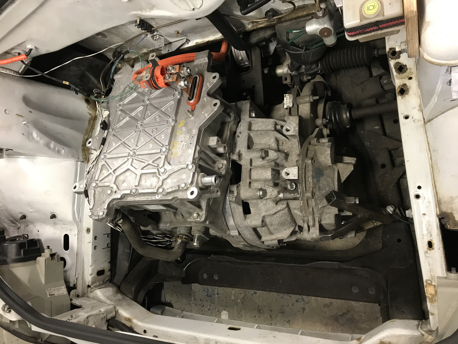

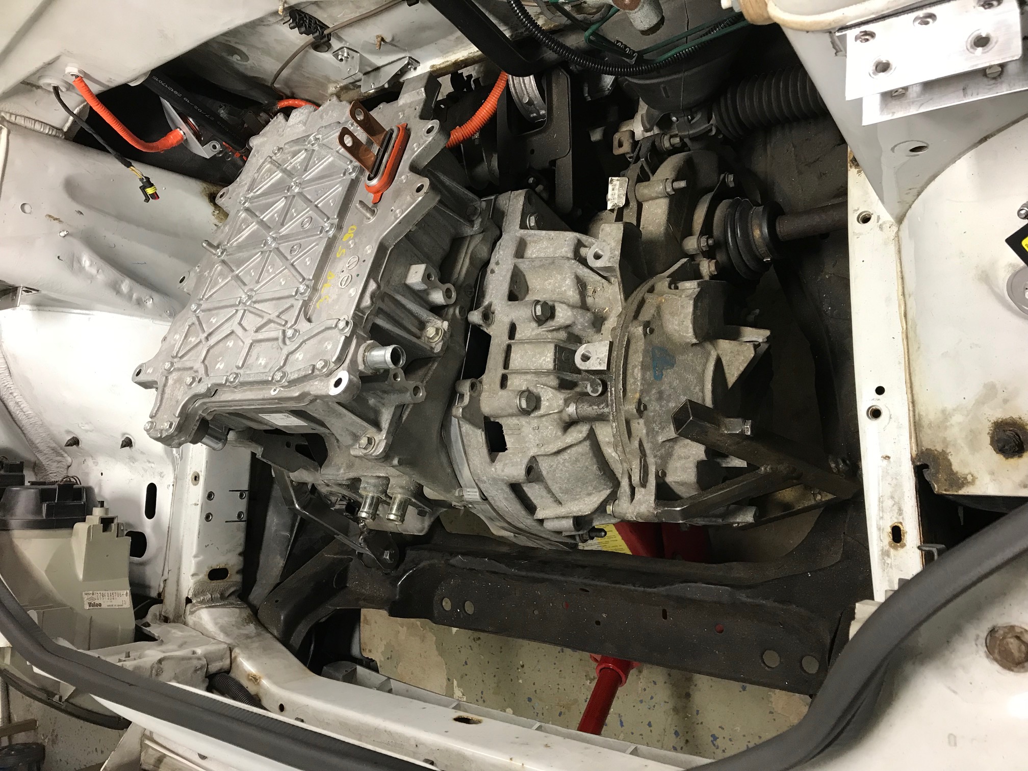

Now it is getting silly but the Leaf motor is back...
Have so far managed to change the resolver setting in the inverter and testdriven it inside my garage... 0,5m reverse and 0,5m forward. So far so good! A bit hampered until I got a working DC/DC.
Plan A is to use the DC/DC from the Prius inverter. Will try to put it in a custom case and place it on top of the inverter and hopefully get good enough cooling this way. Plan B is to source something OEM.
Charger will be home built based on 7pc of FlatPack2 HE:s. Will make it capable of charging with up to 17kW from 3-phase and still also able to charge from 1-phase 2,3kW outlets.

I haven't totaly given up on the MGR and OpenInverter SW but will pursue the Leaf options to get the car out of the garage as soon as possible. There are smaller motors out there but I was given this Leaf motor for helping a friend and decided to test it in my car. The Leaf motors advantage is that it is hacked and well proven so should be much more straight forward to use. Might find another, more suitable, car to put it in later on...
The Prius gen3 charger works but has its drawbacks such as requiring 3-phase power and poor power factor. Using the Flatpacks provides more flexibility at basically the same weight and doesn't require liquid cooling.
The Prius option makes sense when used as an inverter/charger and DC/DC in one very compact package. Not so much as a separate charger only.

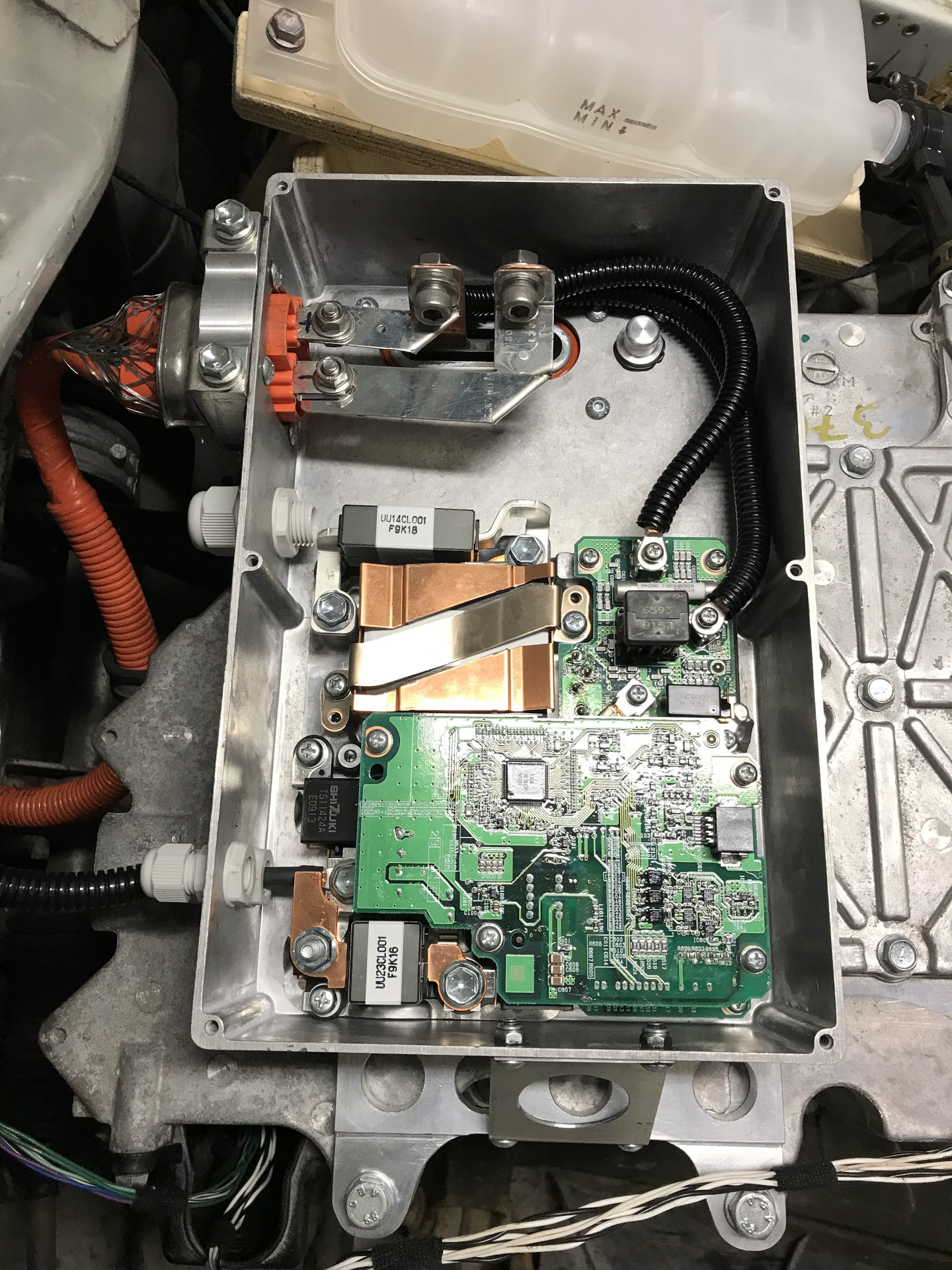

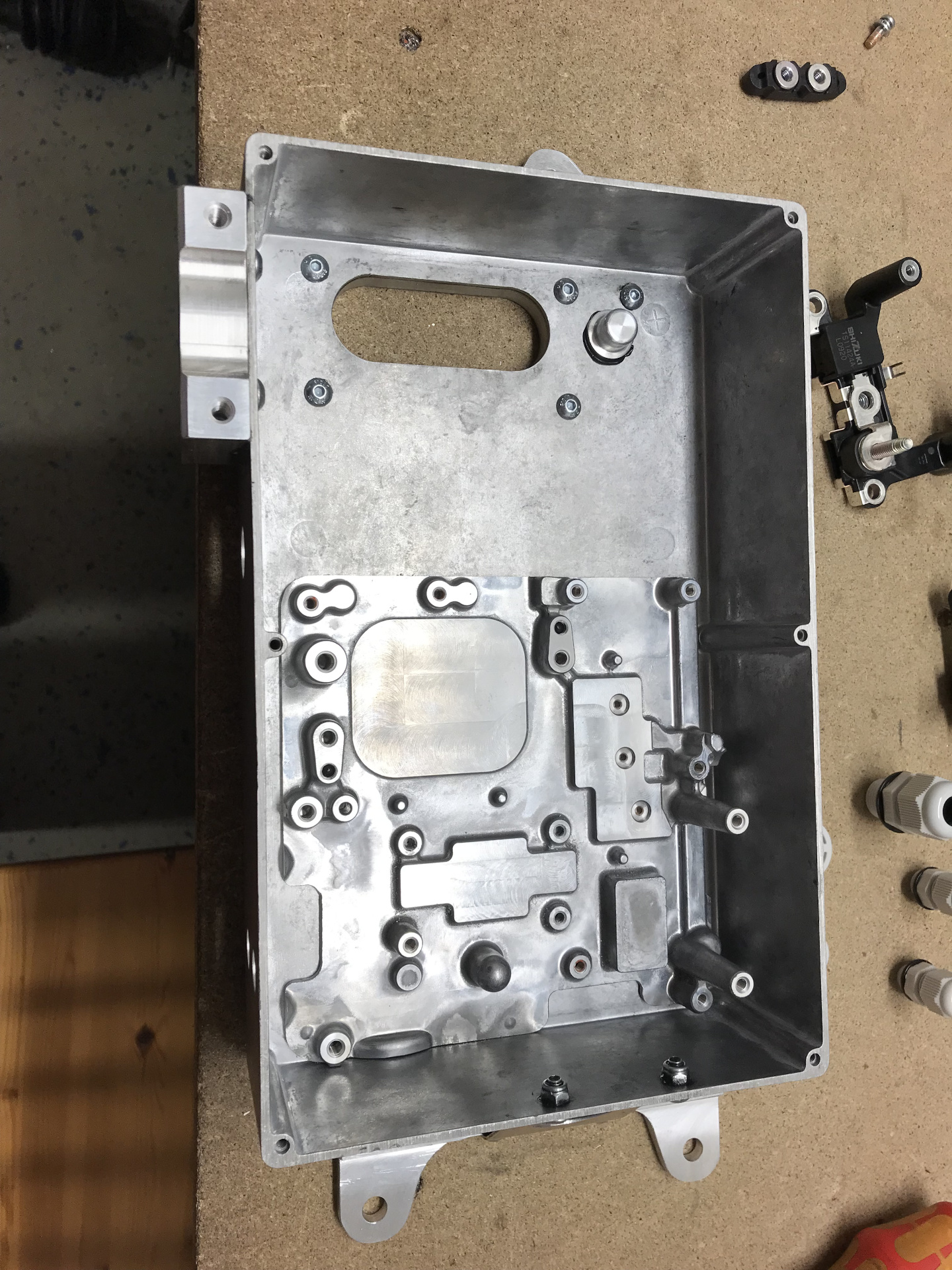

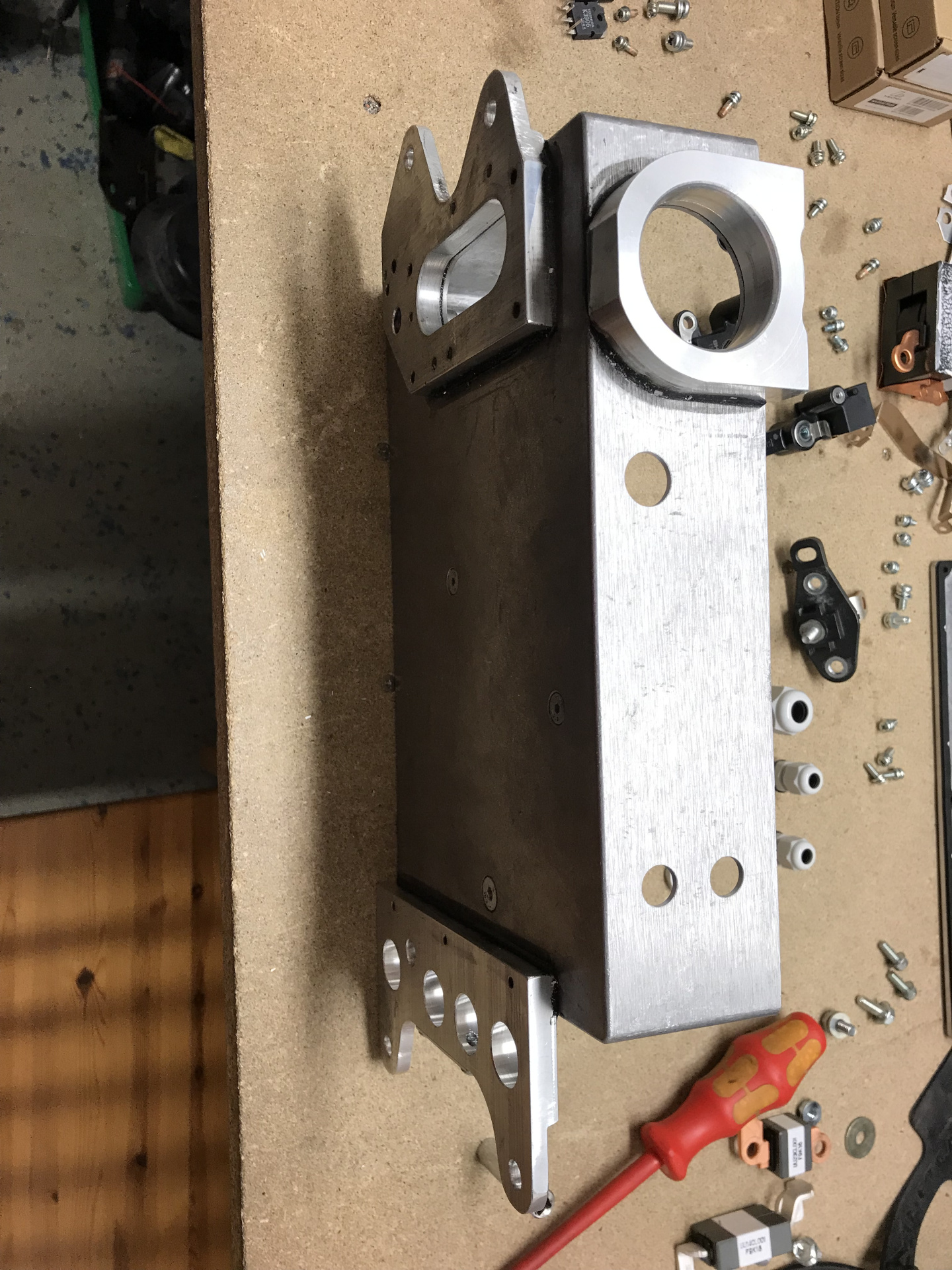

The progress on the DC/DC has been very slow but this is what I arrived at.
It is a cast aluminium box that I have added flanges and sealing surfaces to. I've also cut out the center piece from a Prius inverter. It all connects thermally to the top plate of the Leaf inverter which is the lid for the water cooling so hopefully this will also keep the DC/DC cool.
Waiting for parts for the control circuit of the DC/DC so started to work on the charger.

Cool, did you extract that from the converter I sent? Did you manage to repair it yet/find the fault?
