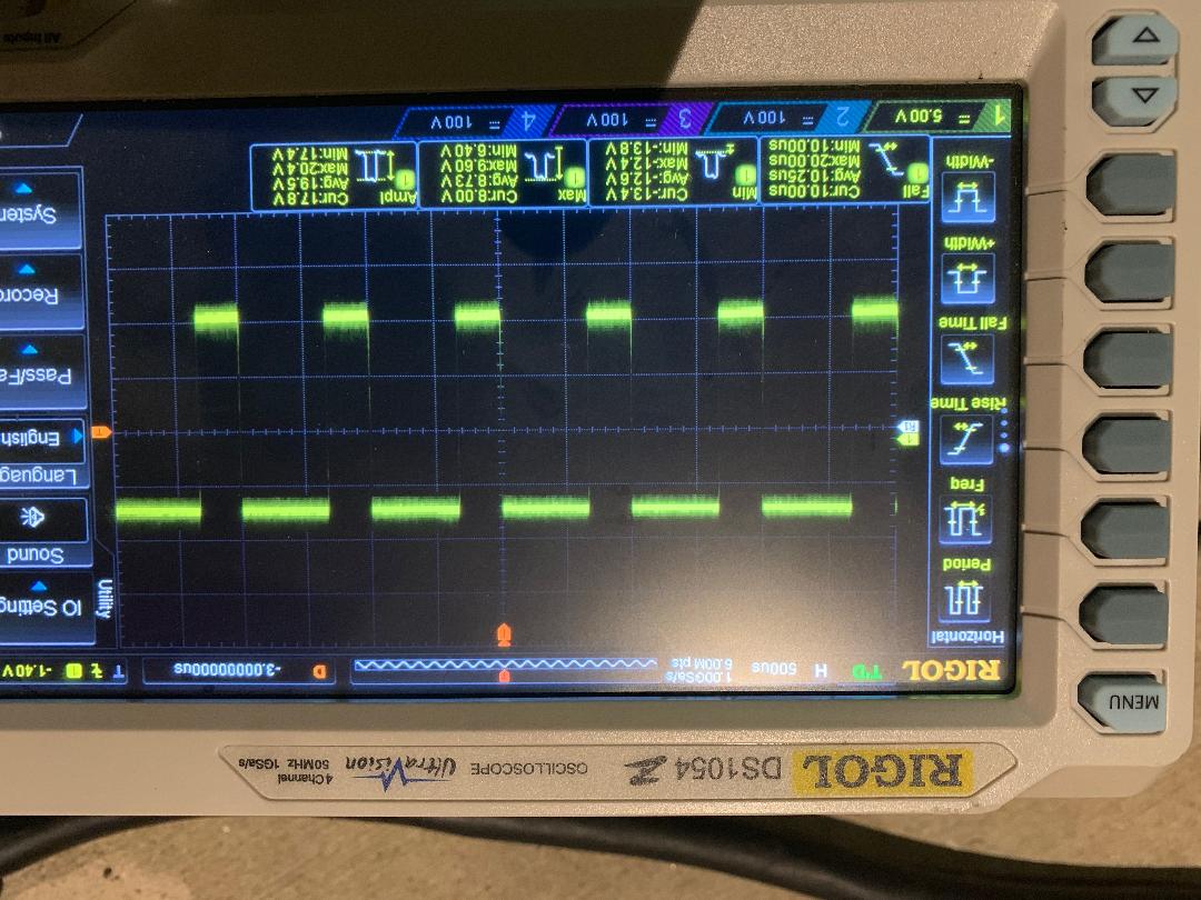

Posted: Fri Oct 25, 2019 4:13 am
by DrJeff
Chasing down the "Gen2 US EVSE SinglePhase 16Amp limited - Only one module will activate" problem.
Data Points for my setup
1) Modules are measuring only 16Amp available from the EVSE
2) EVSE duty cycle is 67% or 40Amps
3) Only 1 module will run, any of the three modules, but only 1 at a time, otherwise resets on Activate (state = 1 in Code)
Further up the thread it was reported that "US SinglePhase in EVSE mode always gets 16amps" which got me thinking. So I started investigating the Control Pilot signal. Per the J1772 details on Wikipedia ( https://en.wikipedia.org/wiki/SAE_J1772 ) "Control Pilot (Mode): The charging station sends a 1 kHz square wave on the control pilot that is connected back to the protected earth on the vehicle side by means of a resistor and a diode (voltage range ±12.0±0.4 V). The live wires of public charging stations are always dead if the CP-PE (Protective Earth) circuit is open, although the standard allows a charging current as in Mode 1 (maximum 16 A).". I know the software is reading the duty cycle correctly, but the 16A reference was intriguing.
So I stuck an oscilloscope on the control pilot line from the EVSE (with a reference ground back to the GND on the charger). When the EVSE was not activated the amplitude of the square wave was 20V (??? expected 12V). When the EVSE was activated the square wave amplitude fell to 17V. I only use the oscilloscope once in a blue moon so please correct me if I'm reading this wrong.
Per J1772 the EV signals to the EVSE that it is ready for charging by dropping the voltage on the control pilot line to 6V. I'm assuming that if it doesn't drop into the 6V range then the EVSE does whatever it's default is - which for my EVSE is 16Amps.
Could this be the source of the 16Amp limit / only 1 module problem?
Jeff
Posted: Fri Oct 25, 2019 9:34 am
by tom91
The full swing is -12 to +12V. So you need the centre to V positive measurement.
The EVSE signal interpretation is not the issue, if the logic board says it is sending a 16A per module command the modules only see canbus commands that says 16A.
No the EVSE does not change anything, it is dumb and just tells you the limit. As soon as it sees the pull down by the charger it just closes an AC relay/contactor.

Posted: Tue Oct 29, 2019 9:24 am
by Kevin Sharpe
DrJeff wrote: Fri Oct 25, 2019 4:13 amSo I stuck an oscilloscope on the control pilot line from the EVSE (with a reference ground back to the GND on the charger). When the EVSE was not activated the amplitude of the square wave was 20V (??? expected 12V). When the EVSE was activated the square wave amplitude fell to 17V. I only use the oscilloscope once in a blue moon so please correct me if I'm reading this wrong.
Something wrong here. Can you measure the pilot signal and ground at the J1772 connector without any connection to the charger? You're looking for a solid +/- 12V signal.
See Basics of SAE J1772 (here)

Posted: Wed Oct 30, 2019 3:04 am
by DrJeff
Kevin Sharpe wrote: Tue Oct 29, 2019 9:24 am
When connected to the Proximity line on the controller card, I'm getting +9-12V which is consistent with the EV Connected Ready signal. When I disconnect from the Gen2V3 card (so EVSE connected to nothing I get +12V - no square wave. I used the GND connection from the EVSE to baseline these measurements. Tomorrow I'm going to check the consistency between the GND connections in the garage (I saw a slight difference when measuring yesterday which used a GND from a separate line. All the lines are all feed from the same sub-panel.
Jeff
