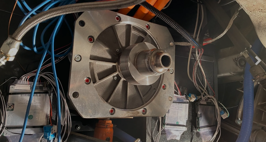

Yesterday, on the way home from school, I began noticing a 'clunk' when going from foot on pedal to foot off pedal. This rather concerned me but I let it be for the night (had to charge at 120V which takes about 10 hours after the commute).
So this morning I got in the car and drove down to the corner, where there is a stop sign. I hit the gas (gently) and the motor revved up -- but the car did not move! Shifting into a different gear had the same results. Ouch.
I'm fairly sure the motor-transmission adapter decided to give out. It looked very strong but seems to have disliked the motor's power. I've only put about 400 miles on it, so that's pretty terrible reliability.
So here I am, looking at a Tesla unit once again. With some Zero-EV Porsche 930 driveshaft stumps and a Johannes board, it should be fairly easy.
If anyone has some bulletproof adapter ideas that will prevent a drivetrain swap, I'd love to hear about them.

Nice the electronics are sorted, not so good you blew you coupler with it
Can you upload a picture of your coupler? Maybe the MEs here will spot the weakness and propose something stronger.

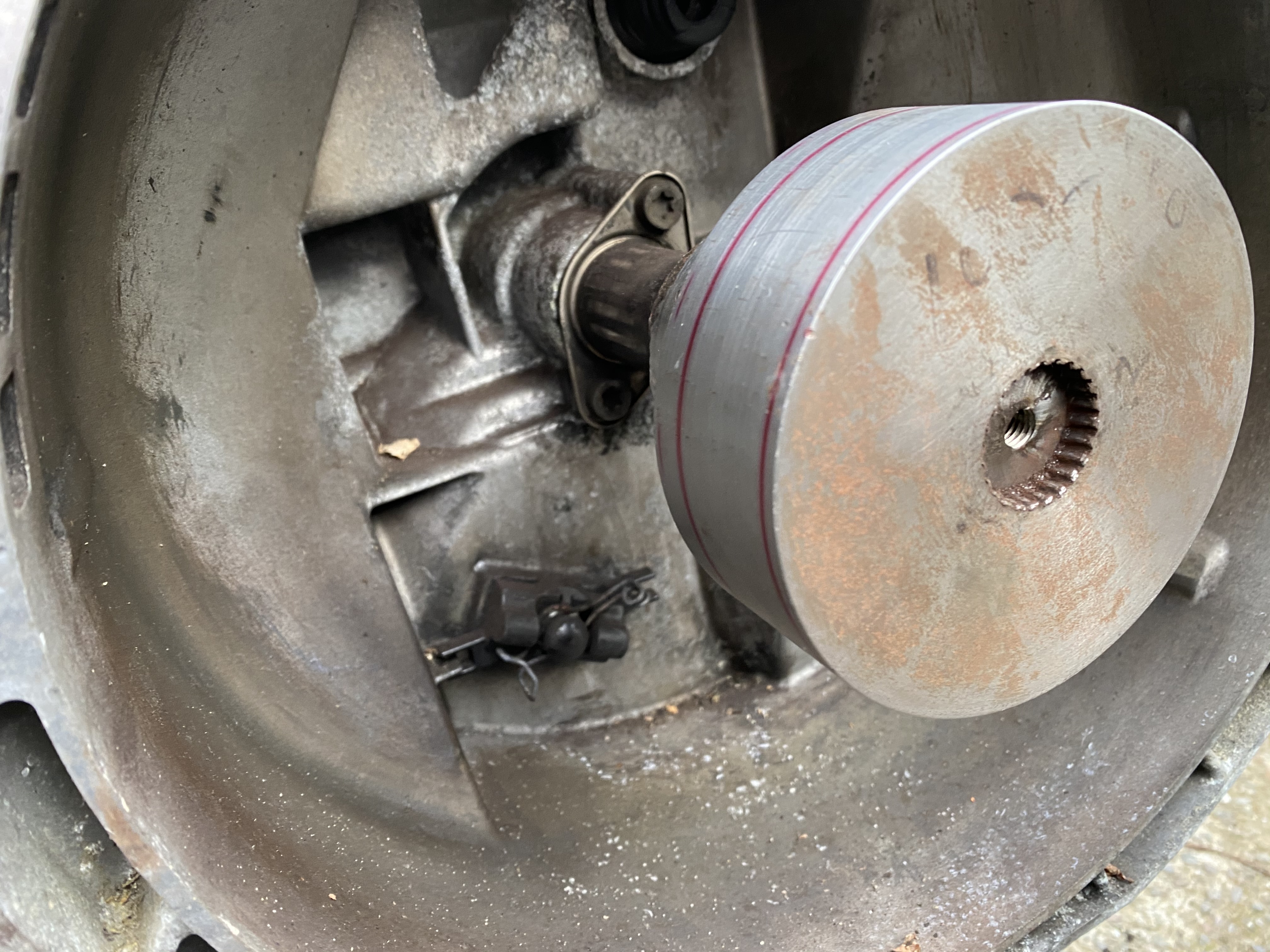

Here it is installed (pre-breaking): And on the floor: This is one of those EV West splined blanks, welded to a Porsche clutch disk. It fits beautifully on both sides but apparently couldn't take the strain.
I'll upload more pics once I get the sucker out of there.

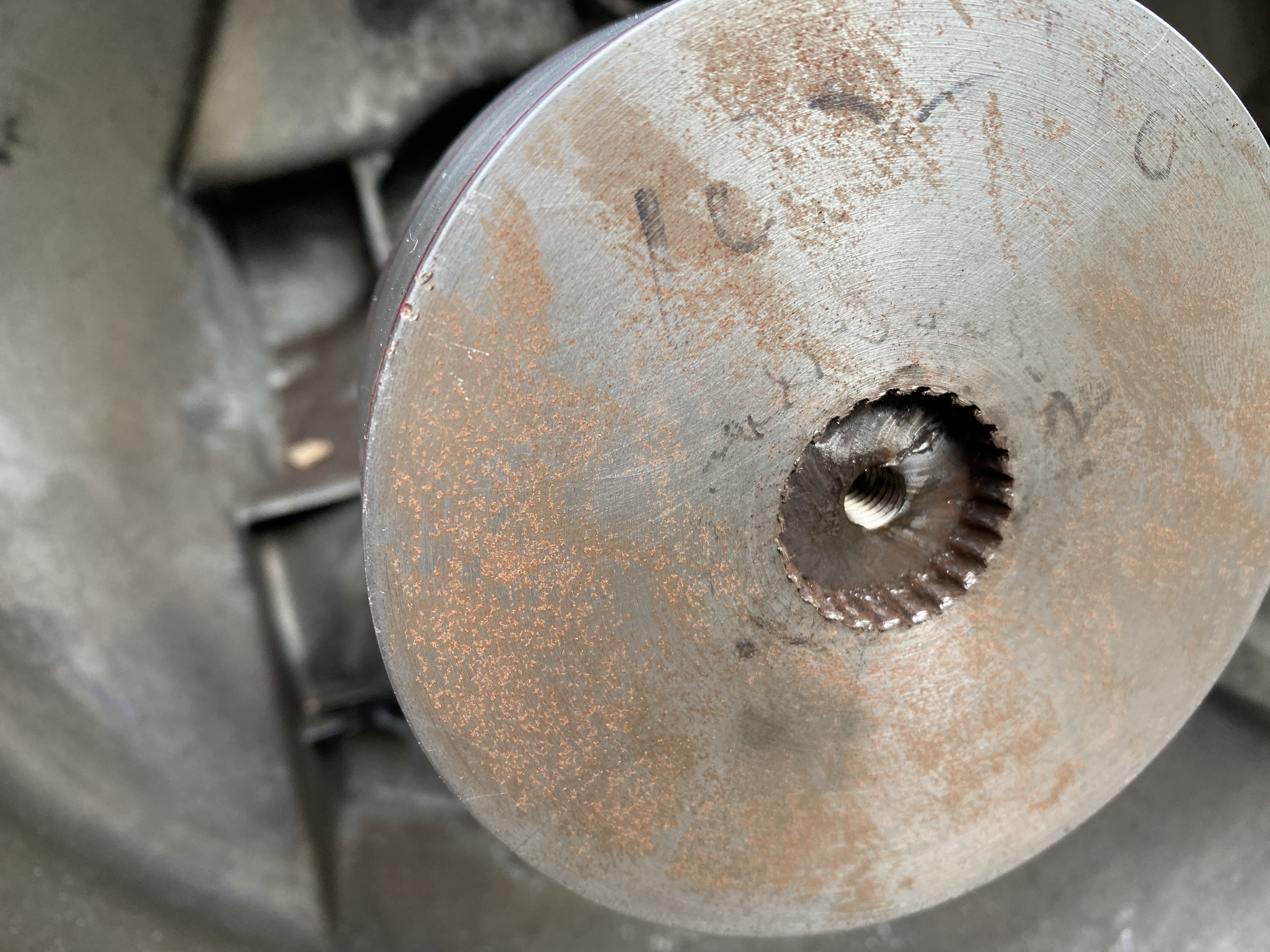

It's quite likely that the weld between clutch disk and splined blank just broke. Which is rather weird, it was done pretty darn well by a professional.
Damien, I really appreciate the offer, but that's almost exactly what we've got in there right now. Thanks anyways!Jack Bauer wrote: ↑Sat Jan 23, 2021 3:21 pm How about this baby :

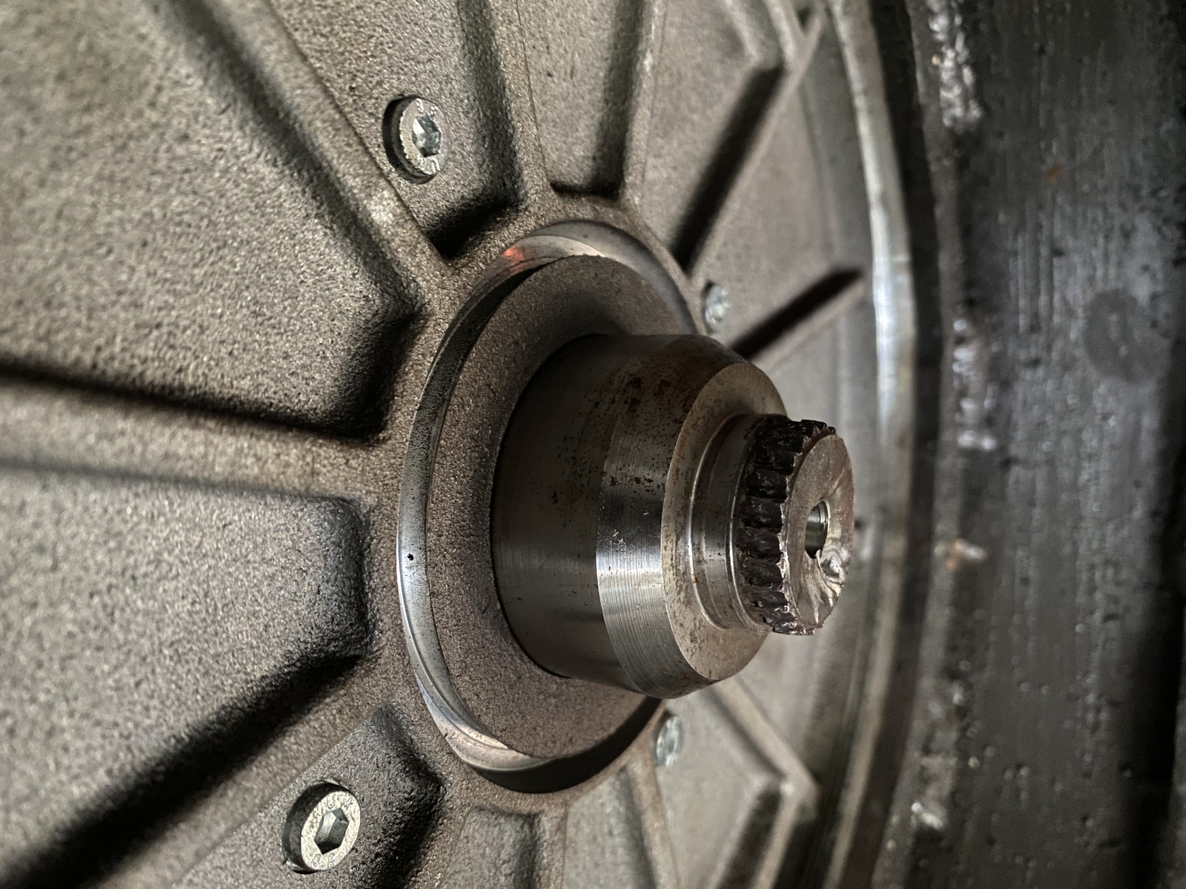

Finally got the transmission down (or rather my dad did) and diagnosed the issue.
It's quite an issue.
Ouch.
Time for a SDU! I've got a place that'll sell one fairly cheap so all set in that area -- and will likely buy some Zero EV Tesla to Porsche CV stubs.
Anyone know what to do with a shaftless motor? I could build a new rotor theoretically....

Not enough meat/splines on the shaft i gather. Maybe it even oscilated a little before braking... It makes a lot of rotating mass.

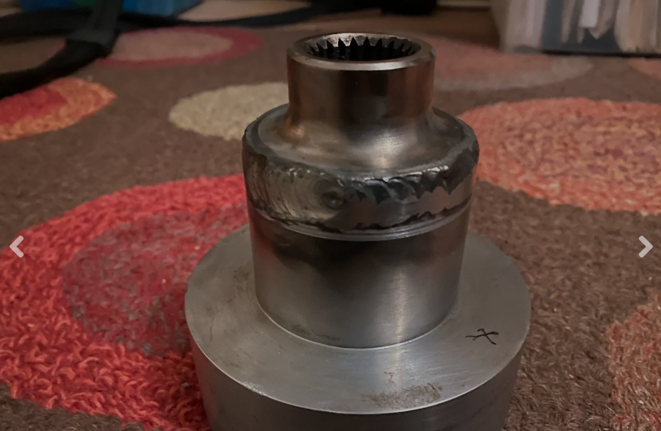

I have used gas engine clutch disc centers in similar way in my Mazda setup. I went through 3 discs in about 120.000km! Luckily disc centers are a lot weaker than transmission shaft end and it just broke the splines or spring holders on clutch disk.
What i have now is lovejoy coupler with 2 splined centers welded on the transmission side which increased the spline surface. As of then i didnt have an issue besides seeing how banged up lovejoy coupler is getting
Oh and to all of you using transmission i really recommend you put an inspection hole on the underside of the TX bell so you can quickly inspect your coupler... just saying.
If you can get a machine shop to make another coupler for you i suggest you make an extension in two parts with some clamping method that can grip the smooth part of the shaft right up to the bearing seal. Then bolt that up to your transmission part like prop shaft. I bet larger crosssection will transfer more torque and make easier to fit. You need to take care everything is in center with transmission though! Maybe make a fitting step in the old coupler before you drill any holes.
Maybe you can even get one off the shelf since you are in california?

It's quite likely that the motor was slightly misaligned... the adapter plate is not exactly a work of art. It might have been fine with a clutch but did not work with the tight interference fit coupler. Ah well. I'll think about the clamping method, Anne Kloppenborg (sic?) of New Electric Netherlands did that at one point.

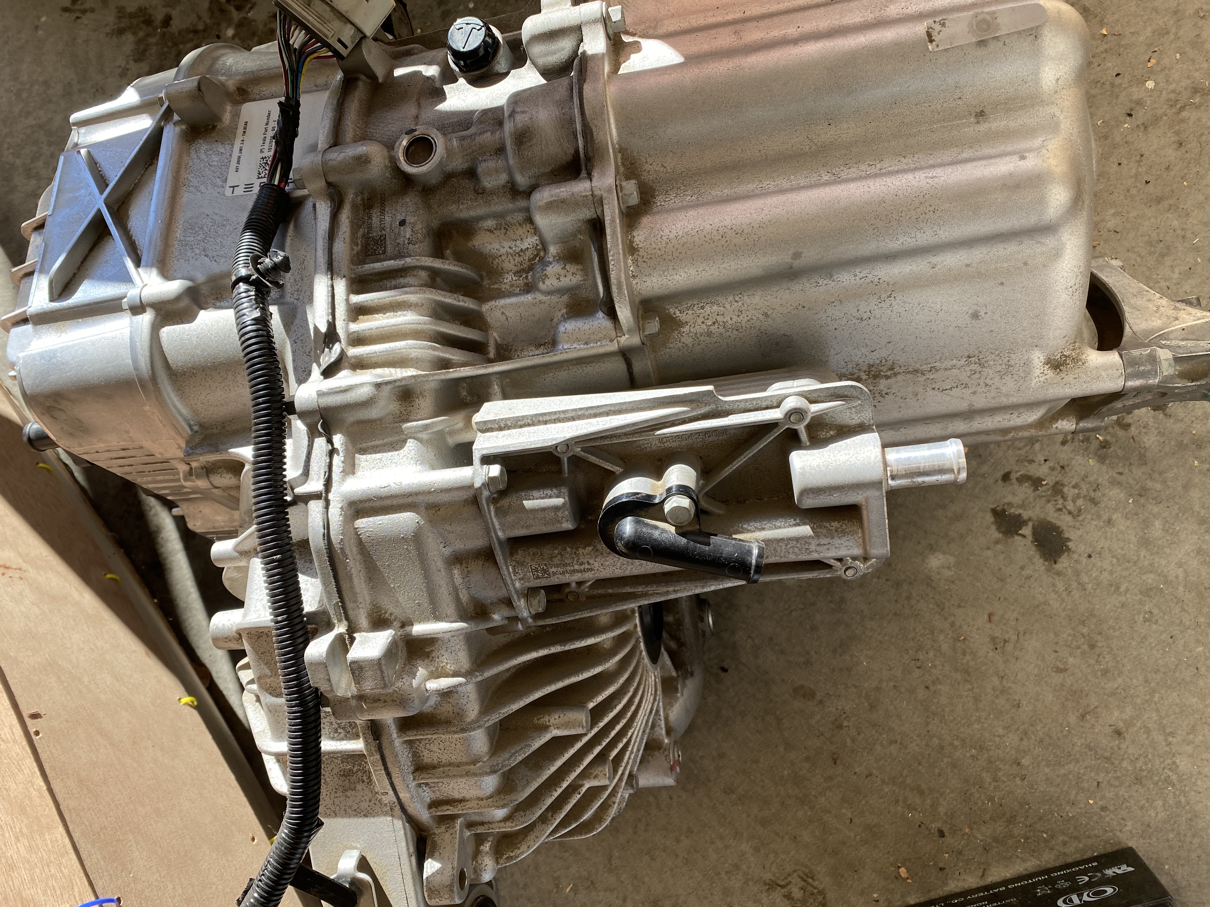

Here is the next phase of this vehicle though, and the direction I wish I'd gone in two years ago.
This was cheaper than the original price of the Siemens + DMOC.

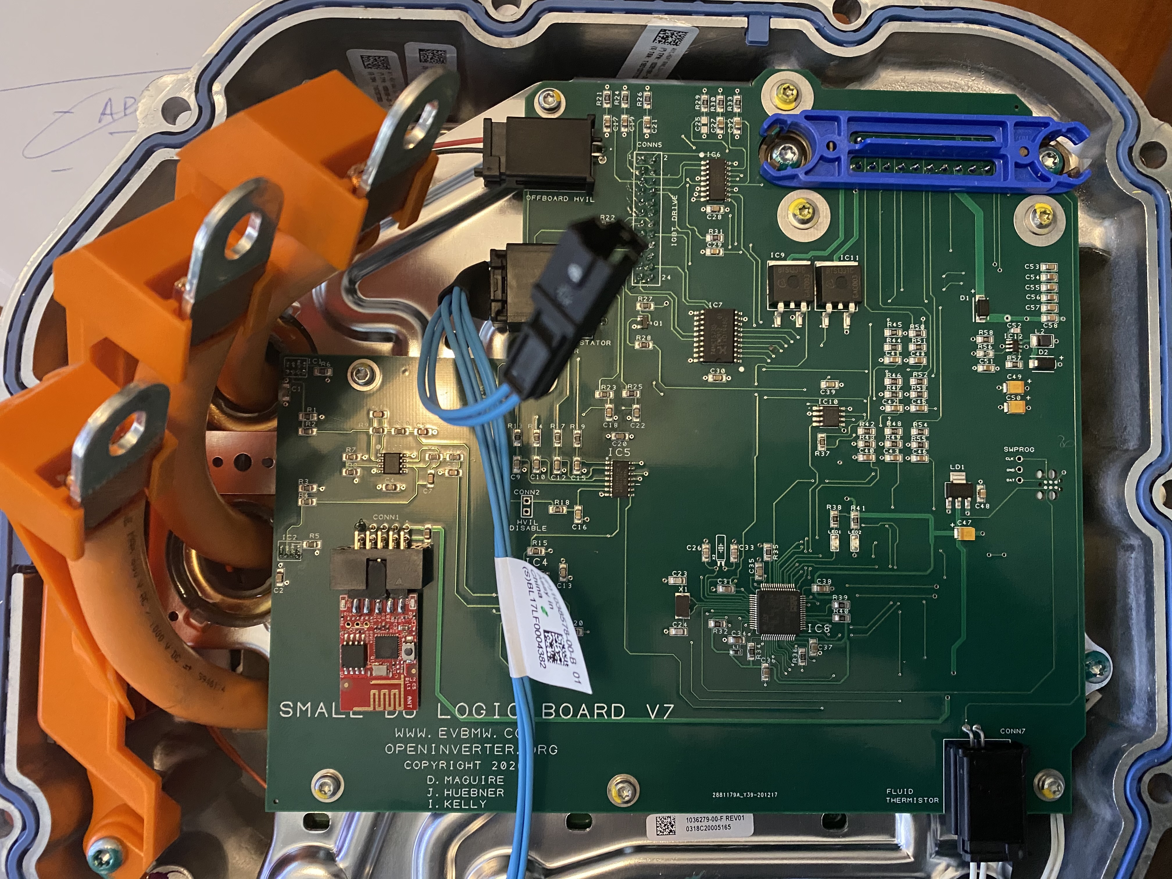

Time to order a SDU board! I hope I get one of the new slim ones
Incidentally, when I went to flip the unit over in order to get at the phase bolts, it leaked what looked like some cooling oil out of the black "T" logo thingy at the top (bottom) of the photo. Is that normal? It looks like a standard air vent to me.

Yup, 4 hours of driving and here it is. It's a model S small rear (fits better in the space needed).

The drive unit fitment is looking better and better. It looks like the Tesla diff is offset a little to the left, meaning the unit can be moved to the right -- exactly what I need to make the sucker fit on the original transmission mounts.

The Tesla SDU will fit. Barely.

SDU board arrived today! Thank you Johannes!
And now it's installed in the inverter. That was not an easy task, the current sensors are quite a pain when one only has a 120w soldering gun.
And my MX150 connectors arrived, one for Tesla and one for Chademo controller. Time to wire up the inverter! I'll start with just the basic; 12v, start, etc. Need to get more wire...
C25 on the SDU board is missing, looks like it's 1uF; I'll just solder one on there. Might be a good thing to check in QC. Looking at the SDU/LDU update thread, the other v7 boards might be the same? I'll check the CPL file and see if there's a screwup.
EDIT Yes there was a screwup. C25 is missing in the BOM. Johannes, expect a new BOM with C25 added (1uF is the correct value).

What was I thinking, I actually spotted that but forgot to just whack one on. Have already added it to the BOM but thanks anyway
It's just the filter cap for the temperature which is quite low impedance, so shouldn't cause a functional issue. Heavy software filtering is used anyway.

I thought as much. I don't have any of the same but a 0.1uF should do, just to fill the spot

And just like that it's been 3 weeks again.
Spent a few hours testing and playing with the inverter (just powered up with 12v, no motor attached). I temporarily jumped the HVIL DISABLE and got it up and talking, checked the default parameters and all look good.
I ordered MX150 connector and pins, made up a harness with all the wires I need.
12V rewiring is mostly done. I'm looking at an iBooster for the front end (thanks to Lars) so if that pans out I'll redo the front end wiring.
Trying to position the SDU perfectly has been taking up lots of time; jack it up, check all directions, move it a bit, check again... Only 3 mounts to make but they've got to be perfect. The rear end is going to be in the way of a rather important chassis bar so that needs to be replaced or the motor moved. At least we have the Tesla to Porsche stumps from ZeroEV now, they're gorgeous.
I'll be doing some 90v testing with the SDU assembled; need to get some sort of coolant in the inverter first as I've heard about all the burned up inverters which have occurred.
And in the cabin; removed the shifter and all those cables, which will be replaced with a F-N-R switch ($1 from a salvage yard, needs a nice knob.)
With luck and lots more work, shouldn't be more than a couple of weeks before we're on the road again. This is what, revision 3 now? This one should last...
-Isaac

Thanks for the update - a good read.Isaac96 wrote: ↑Mon Mar 08, 2021 1:15 am And just like that it's been 3 weeks again.
-Isaac
Really interested to hear how you get on mounting the ibooster. I'm keen to go that direction too but haven't really assessed how well it'll physically fit in the frunk.
I have two annoying things on my 986. One is the power steering pump noise and the other is the vacuum pump kicking in. Hoping to improve both this summer.
