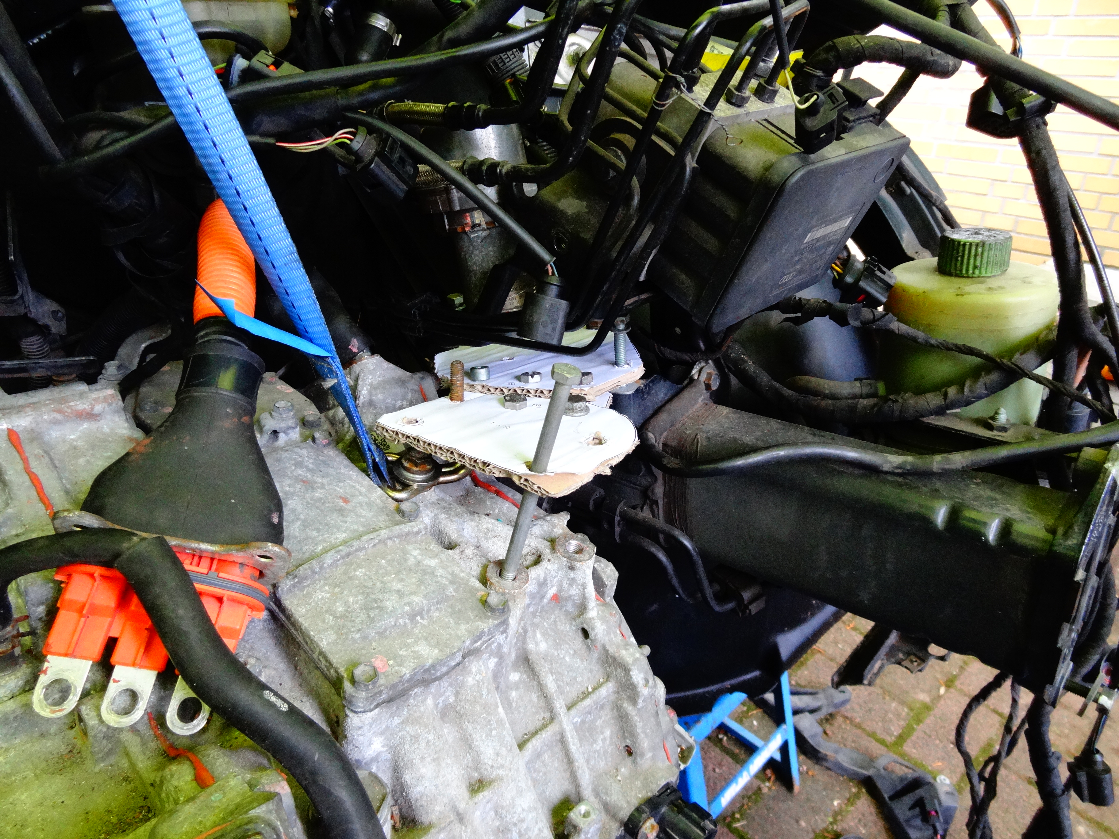

Did some CAD today:
A guy on A2 forum just made a little fake device: https://a2-freun.de/forum/forums/topic/ ... ent-622906
Apparently you can also buy the actual sensor and leave it dangling somewhere.
Did some CAD today:

Why you do not use original audi mount? will you have a rubber bushing there? or EV motors are so vibration free that you can mount it directly to frame?johu wrote: ↑Wed Feb 09, 2022 1:53 pm Cool, thanks for checking that!
Did some CAD today:

Argh! NO dont bolt your motor directly to frame!
Seriously, electric motors need separators as well. It is just that they can use full rubber mounts (higher order damping) versus various engines that need spaced rubber because of lower frequency vibration and larger offsets in movement.
I think original Audi rubber mount would be OK with it. I assume it has some oil inside? You would just had to remodel the boltup interface.

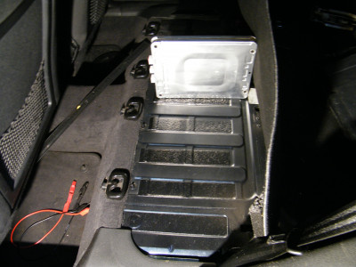

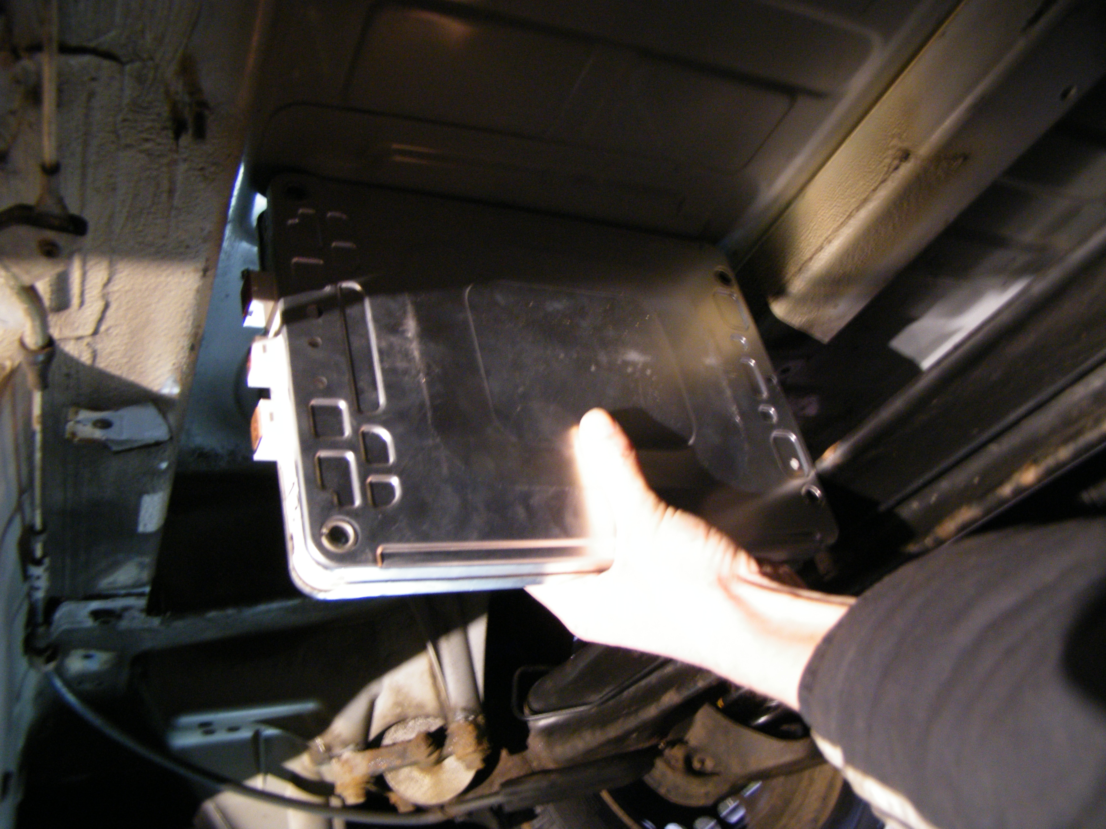

I removed the fuel tank and remaining exhaust parts today and am again delighted by the very boxy space that makes. So I will be able to easily fit 24 Leaf modules (i.e. half of them) where the tank used to be.
We will cut out the floor and place a plastic box (800x330x230) into the void for weather protection. The actual battery brick will then be mounted with a set of angles into the longitudinal carriers. So the battery box has no structural task. The other brick will life directly on top of that, so the rear seats are gone. The owner prefers it that way. But we might also put them into the compartment below the boot. Time will tell
