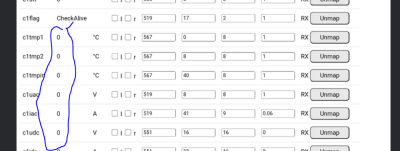

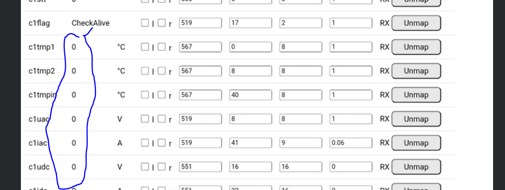

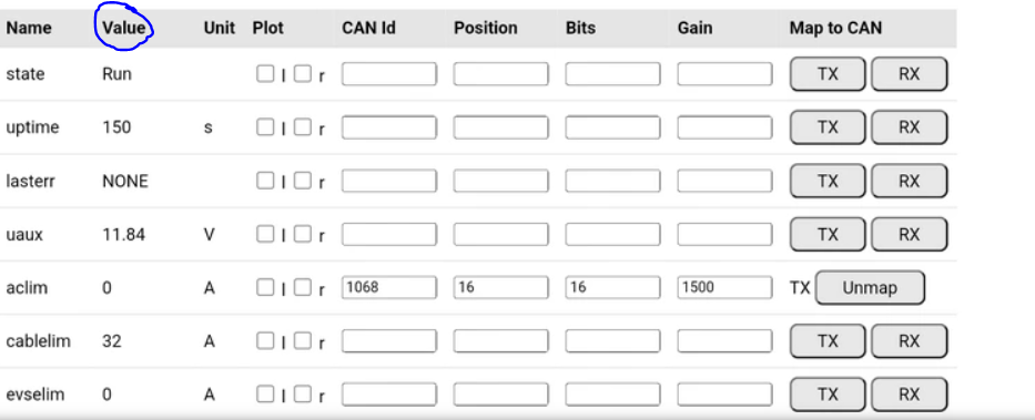

Well the firmware update at least made a difference!! Progress is exciting. I see spot values populate on the web interface now:
However I still only see the one CAN message in cangaroo echoing over and over. Doesn't make sense to me. What do you guys make of that? Faulty USB adapter?

Re: Tesla Gen 3 charger board assembly as of mid-2024
Nothing is showing, it just shows you how the CAN frames are populated for the messages form the modules.
No change on getting CAN working.
Oh. You're right I see that now. Well at least I had a few minutes of excitement.

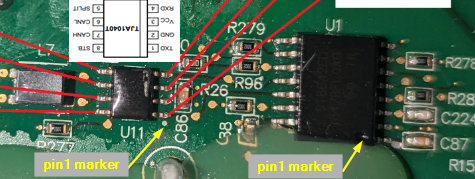

Could you identify the CAN transceiver chip on the modules? It could be an 8pin IC, which should have CANH and CANL routed to it.
I measure continuity from the open inverter board CANL and CANH terminals to this chip, as labeled:
I read these markings:
1040AQ
[Texas Instruments logo]83T
C0QYG4
I included measured voltages at each pin just for the sake of science. Of course, this was while the board was powered on. With power off, the middle two legs on the right hand side of U11 are continuous to ground (i.e. - the charger case).
As a side note, while I was probing things, I happened to touch the chip just to the right labeled U1 and noticed it was extremely hot. Is that normal? It heats up about 5s after I supply 12V to the board, and it didn't quite burn my finger, but it was more than simply warm.
Anyway, I was secretly concerned my solder joints may have been part of the issue, but I believe this rules that out. At least for the CAN connections.
The CAN transceiver U11 is a TJA1040, and it's supply is OK. What is strange is the (average) voltage of the tx and rx line. If the board would not transmit anything (as your CAN log says), the tx line would be permanent high (5v). Any chance to record the tx and rx and CANH CANL with an oscilloscope? The RX should go to low as soon as CANH is significantly higher than CANL. The TX should at least shortly go to low at the end of a received frame (the ACK bit).
U11 and U1 have the following connections:uhi22 wrote: ↑Mon Aug 12, 2024 7:42 am I do not think that the TJA1040 is broken, but maybe it is. I prefer to measure the things, this usually helps to find the root cause. If you see the chance to easily replace it you could give a try, but I guess the issue is somewhere else. Is the U1 connected to the tx and rx of the TJA1040? What type is U1?
U11 top right (assuming pin 5?) is tied to the 4th pin on the left of U1. Bottom right of U11 (pin 8?) goes to U1 pin 5 (5th down left side). U1 pins 1, 7, 8 are ground when powered off.
U1 is marked:
Si8642ED
1817BFL0AG
The pin 1 is usually marked with a dot, in best case on the PCB and on the IC housing.
The transceiver pinnings can be seen here: https://www.nxp.com/docs/en/data-sheet/TJA1040.pdf
The marking of U1 does not say anything to me, maybe a custom chip? But nevertheless, it should send ACK (and data messages) on the TX pin to U11, and it should receive the CAN messages from the U11 RX pin.
Just to make sure: You have ground of the module boards and of the control boards all conntected together? And all CANH together, and all CANL together. And you measure a resistance between CANH and CANL between 50ohms and 200ohms while everything is powered off? And you measure the identical resistance on the pin6 and 7 of all involved transceiver chips?
