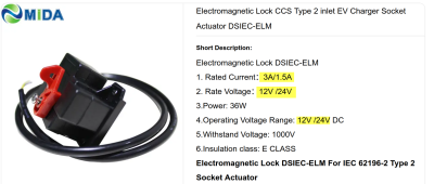

Do you think this is suitable for the locking actuator?
https://www.mouser.de/ProductDetail/Tex ... qTkw%3D%3D
The locking actuator is ratet at 3A in 12V version!
https://www.evsegroup.com/electromagnet ... x-product/

muehlpower wrote: Fri Aug 11, 2023 2:05 pm Do you think this is suitable for the locking actuator?
There is the following statement in the datasheet, I think it is not appropriate. only parallel connection is suitable
• 1-A RMS current for each output
– 6-A maximum current for paralleled outputs
Re: Develop a QCA7000 board?
Posted: Fri Aug 11, 2023 5:08 pm
by asavage
muehlpower wrote: Fri Aug 11, 2023 2:05 pm The locking actuator is rated at 3A in 12V version!
That web page has two different sets of specs!
Nozzle Lock DSIEC-ELM 01b
Nozzle Lock DSIEC-ELM 02b
Which to believe?
Alas this doesn't quite add up. The part you listed is 4 x 1A half bridge. In order to be able to reverse the motor we need a full bridge (half bridge on each side of the motor), so that's only 2 x 1A on each side of the motor or 2A total. Not quite enough.
The 6-driver version of this chip would do, but I suspect there are larger full bridge chips available without the complication of paralleling.

The DSIEC locks come in a variety of different versions.
The earliest models were solenoid operated, they require a 12V pulse @3A for around 0.3 - 0.6 sec
On the newer models a 12V motor operates the locking pin, they require a lot less current. (around 100mA)
There are also locking actuators from Hella: 11122-05 also 12V and driven with a motor.
The one from Hella is most likely the most suitable, as they are fitted with a automotive (TE MCON) connector.

I installed this, it is specified as 3A / 36 W. Most sources say so. But maybe there are also differences, e.g. DC motor versus solenoid with peak and hold.
https://www.evsegroup.com/electromagnet ... r-product/
Posted: Fri Aug 11, 2023 7:51 pm
by asavage
The linked page above shows wildly disparate specs.
muehlpower wrote: Fri Aug 11, 2023 6:52 pm I installed this, it is specified as 3A / 36 W. Most sources say so. But maybe there are also differences, e.g. DC motor versus solenoid with peak and hold.
https://www.evsegroup.com/electromagnetic-lock-v4z-dsi-el-for-iec-62196-2-type-2-socket-actuator-product/
This is a different unit, with more reasonable printed specs.
I mistrust suppliers who can't keep their specs straight (consistent) on a single web page. If they can't be bothered to fix their publc-facing documentation, what other corners have been cut? I will always pay more to a more professional vendor . . . even for the same product! Because they are providing better service overall, and not forcing me to guess, cross-check, and doubt.
