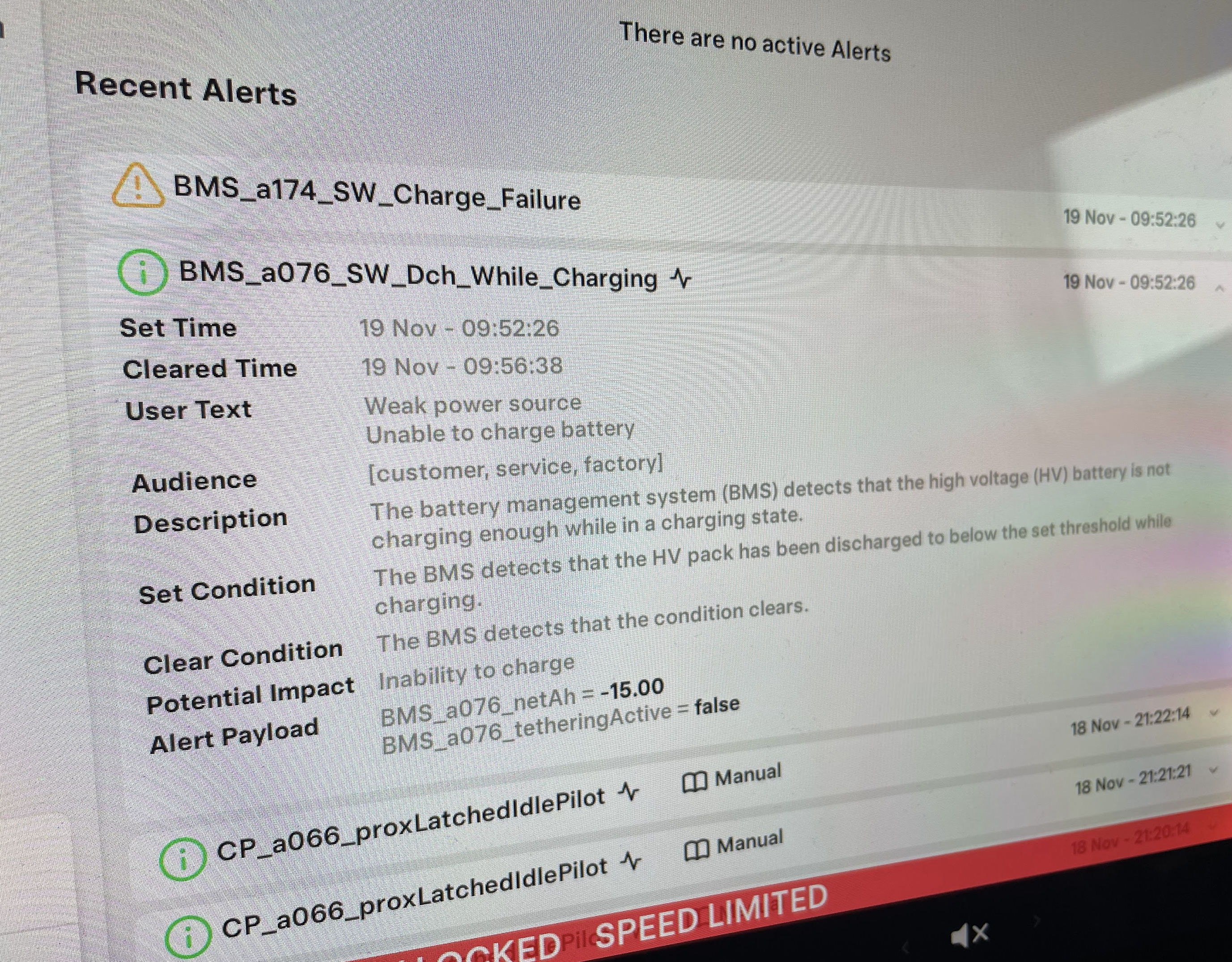

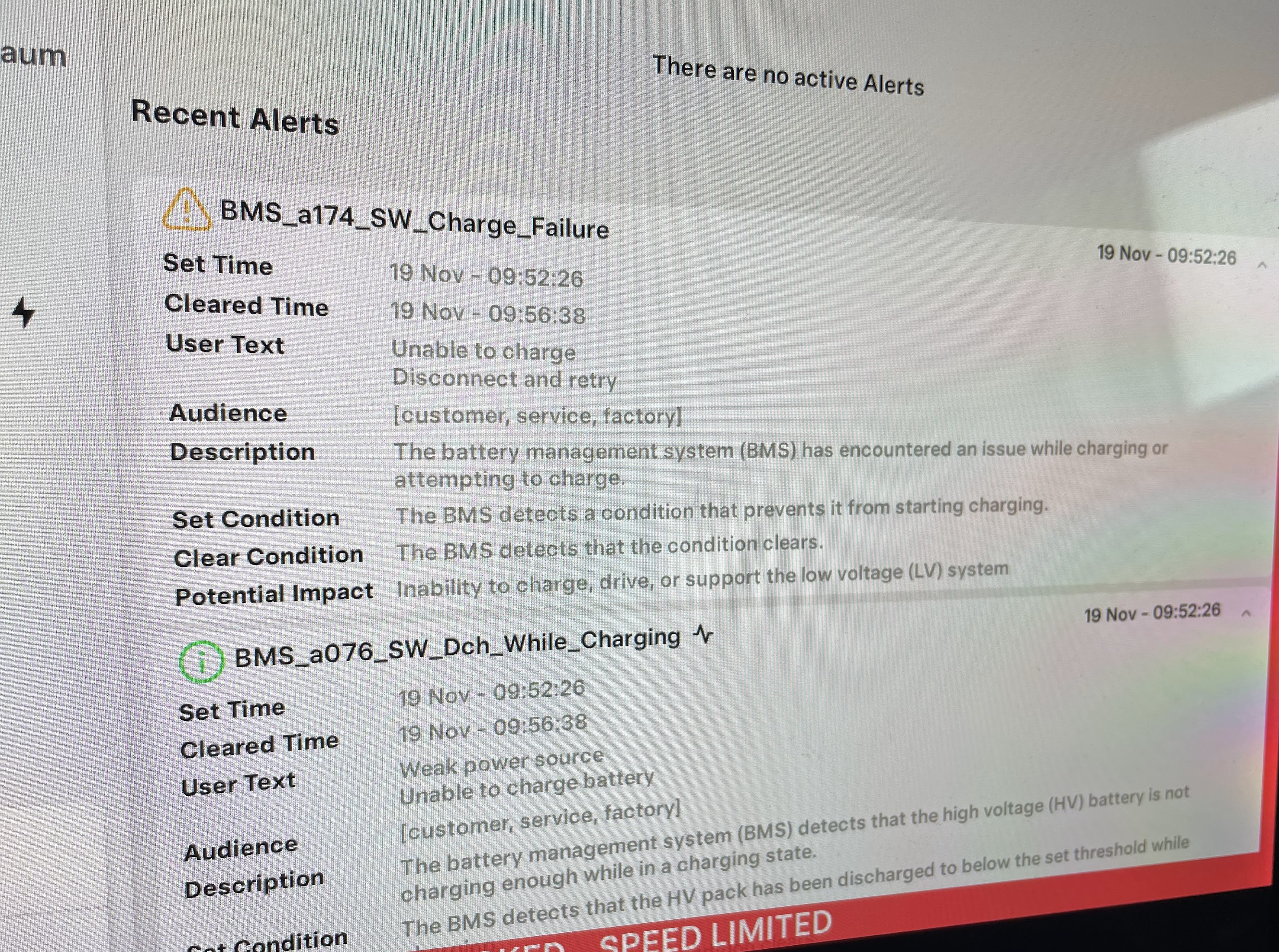

by lewurm
Let's make that ~70 minutes :)
The car sent a PowerDeliveryReq with "ReadyToChargeState": "0", and then a SessionStopReq, last lines of the log is attached.
Also the alerts in the service menu are very interesting. Seems to be the threshold is 15Ah of discharge.
Edit: Including BMS_a076 / BMS_a076_SW_Dch_While_Charging and BMS_a174 / BMS_a174_SW_Charge_Failure as text here, so it's searchable.

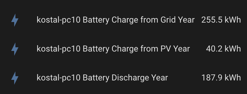

Finally...
Convincing the Kostal inverter was trickier than expected. After some help by the Battery Emulator community I finally got it to work. There is also a ModBus register in the inverter where the current can be changed from -13A up to +13A. Both works :)
johu wrote: Tue Nov 19, 2024 9:04 pm Just a random thought: if you command the inverter to actually charge the car for a few seconds maybe that resets something?
Yeah, I will conduct some tests in that area since I can finally control the (dis)charge rate. If that shouldn't work, another attempt would be to disconnect the CP line via a relay to simulate a unplug/plug and thus restart the charging session. But even those 5kWh are "workable"... that would get us through a summer night ;)
What I also want to investigate is the handling of SessionStopReq. This should rather quickly communicate to the inverter to reduce the current to ~0A. I did it manually so far, but if the car for some reason (e.g. -15Ah threshold reached) requests it, pyPLC will just send "yeah, good bye", although there is still some load on the line... :)

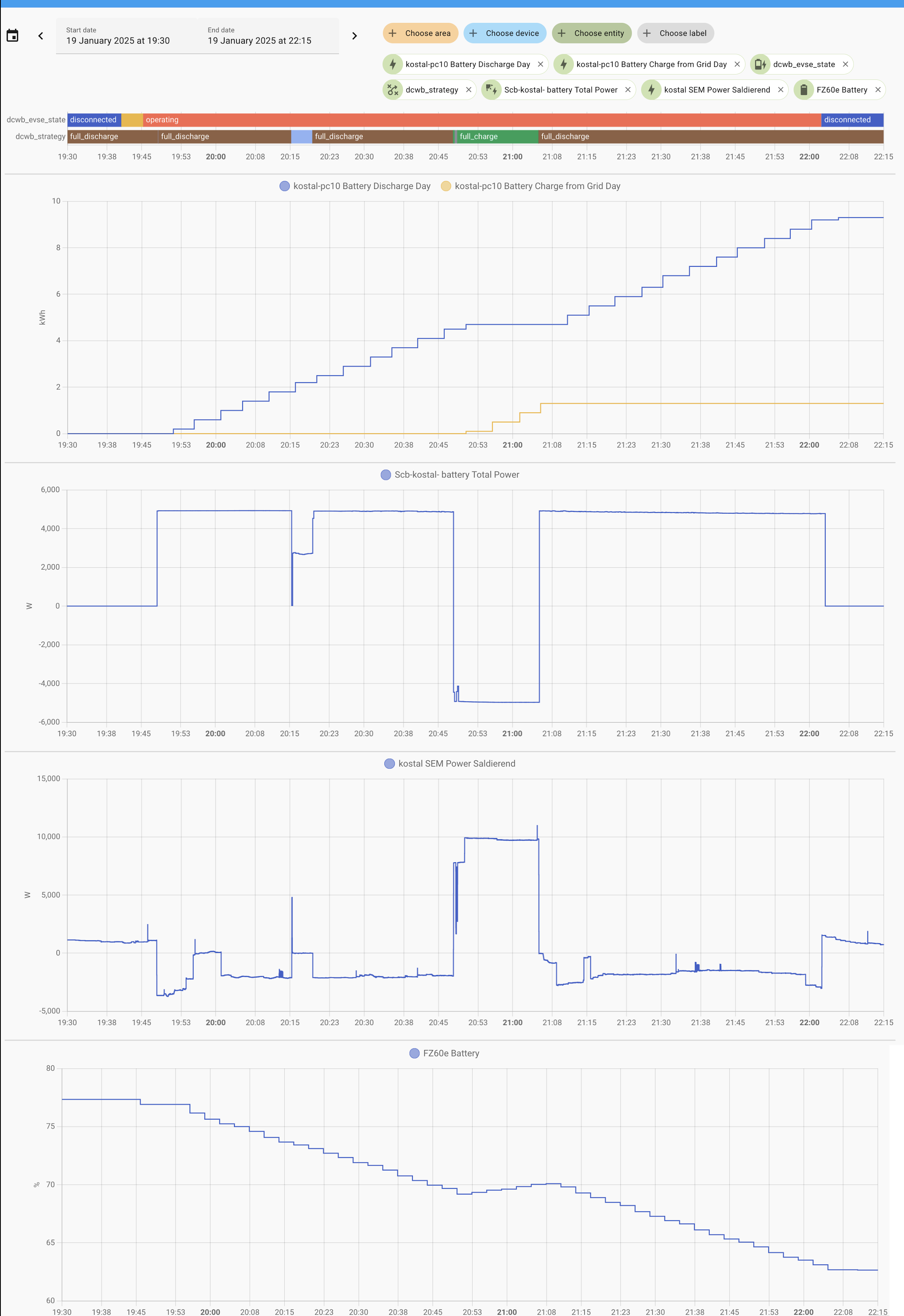

Yes! I'm planning to do a more structured write-up somewhen next month, but for now a braindump for curious folks must do it; basically all the information is out there, I just built something on top of giants (pyPLC and battery emulator) and put them together :)
NO FURTHER PYROFUSE HAS BEEN HARMED IN THE FOLLOWING ACTIVITIES (first good news :D )
The first thing I tackled is the timeout issue. There are two ways to detect it: (1) Whenever the communication is in state CurrentDemand the expectation is that the next message will arrive within 110ms, if not, a stopDCSoft is triggered, and if it happens again a stopDCHard is triggered: https://github.com/lewurm/pyPLC/blob/cd ... #L473-L480 The difference is that stopDCSoft tells the inverter via ModBus to reduce the power to zero, while stopDCHard will open the contactors of the wallbox (ignoring any potential load and thus risk welding).
The (2) way is to hook into the sniffer https://github.com/lewurm/pyPLC/blob/cd ... #L317-L320 which will also trigger a stopDCSoft. This is however slower in terms of reaction time, it's somewhere around 300ms. I assume you could tune that value somewhere in the TCP settings of the kernel, but I guess the first variant is already good enough.
And then I replaced the jumper cables that I used within the wallbox for CP with some 2 pair telephone cable that has shielding, and suddenly the timeout situation was much much better. It's still happening, and from the few observations I have it seems to only happen when there is a lot of sun; I assume the DC cables between wallbox<>inverter are carrying some noisy stuff when the inverter is more at work? I ordered some ferrite rings to put on the DC cables (please tell me if this a bad idea, I have no idea what I'm doing regarding EMI).
I also gave up on using the Battery Emulator, and instead ported the inverter communication to Python and use it directly within the pyPLC loop. This makes the coordination much easier, it's basically another variant in hardwareInterface.py. It's also equipped with some additional tweaks that are easily possible in a Linux environment, e.g. I'm using the pykoplenti command that uses the REST API of the inverter to turn on/off its battery support. Probably possible on an ESP32 too (which Battery Emulator runs on), but much more cumbersome. And then there is some interaction with my local Home Assistant instance for high level control, logging state transitions and bookkeeping. By the way, I had some "performance issues" because that involves network stuff, which can have delays... and that's not good to do on the same thread as the car communication (which is pretty sensitive to timeouts, roughly one second). So there is another thread that polls/push certain stuff, to unblock the main thread. Seems good enough, but a bit hacky due to the GIL in cpython.
Regarding the step-up converter, I followed the mod described here: https://github.com/dalathegreat/Battery ... age-source
And have a little calibration script to figure out good frequencies for the PWM: https://github.com/lewurm/pyPLC/blob/di ... ter_mod.py
It depends on your input voltage, but then didn't require much tuning, it rarely needs more than one attempt before the car is happy: https://github.com/lewurm/pyPLC/blob/cd ... #L303-L339
It's pretty solid!
That's how it looks like currently.
Still janky... looks better if you hide it ;)
So I did my first longer session last Sunday:
kostal SEM Power Saldierend is the sum of the three phases going to/from grid according to the Kostal smartmeter (an additional device). Scb-kostal-battery Total Power is the power to/from the battery according to the inverter. dcwb_strategy is the input to a script that controls via modbus regarding how much power should go to/from the battery (it runs as part of Home Assistant via PyScript https://gist.githubusercontent.com/lewu ... 3e/dcwb.py yes yes, I'm a Home Assistant fanboi :mrgreen: ).
So it's discharging for a while, and then doing a little "charge pump" to hopefully reset the BMS state and thus bumps the 15Ah threshold. And it seems to work, because I sucked out more than 15Ah in this session. It was pretty cold in the garage already and I was tired, so I stopped the session. I thought that was already pretty cool, but there seems more to this 15Ah limit...
