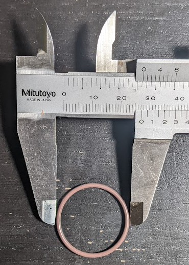

Does anyone know the size of the O-ring on the drive unit speed sensor? I don't see the ring itself listed in the Tesla or MB parts diagrams. Mine was torn when removed.
Edit - it appears to be a 24mm ID, 2mm thick O-ring.

TastyGuac wrote: Wed Aug 10, 2022 7:13 pm Does anyone know the size of the O-ring on the drive unit speed sensor? I don't see the ring itself listed in the Tesla or MB parts diagrams. Mine was torn when removed.
It is necessary that someone measure what was taken, try to approach the car market with a torn ring, it may turn out to pick up or cut another
Johan
Posts: 28
Joined: Thu Jun 02, 2022 11:59 pm
Has thanked: 7 times
Post by Johan »
@TastyGuac:
The maximum inner diameter should be 24.25mm in order to fit snugly around the speed sensor ("circuit assembly switch").
Mine measured 23.85mm after taking it off the sensor.
The minimum outer diameter should (after assembly and straining) be 27.00mm in order to fit snugly in the aluminium manifold.
Mine measured 27.25mm after taking it off the sensor.
Measured thickness: 2.00mm (assuming a circular cross-section)
I know that 23.85mm + 2 x 2.00mm ≠ 27.25mm because the cross-section has become oval in the course of time.
My measurement accuracy estimation: 0.1mm.
You can also buy a new "circuit assembly switch" for $245.57 :o at at Toyota
Disclaimer: Despite all efforts, all (which I write) should be conservatively interpreted as a poorly informed, error-prone, non-expert opinion that is subject to continuous change, especially in this age of hyper-specialization and newly gained insights.

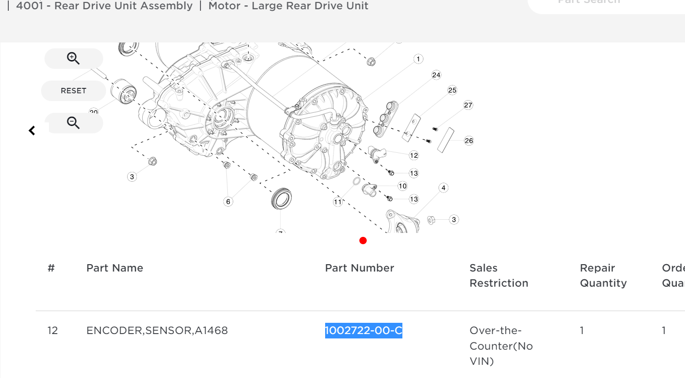

To give them their due :o - the encoder/sensor is listed in their catalogue - with a comment "Over-the-Counter(No VIN)" so in 'theory' it should be available? RRP in UK is £90 - which is a bit steep if you just need the o-ring!.
They list an inlet manifold o-ring separately - 11 INLET MANIFOLD FITTING O-RING 1008806-00-A why not the sensor o-ring! would be nice if they were the same size?
