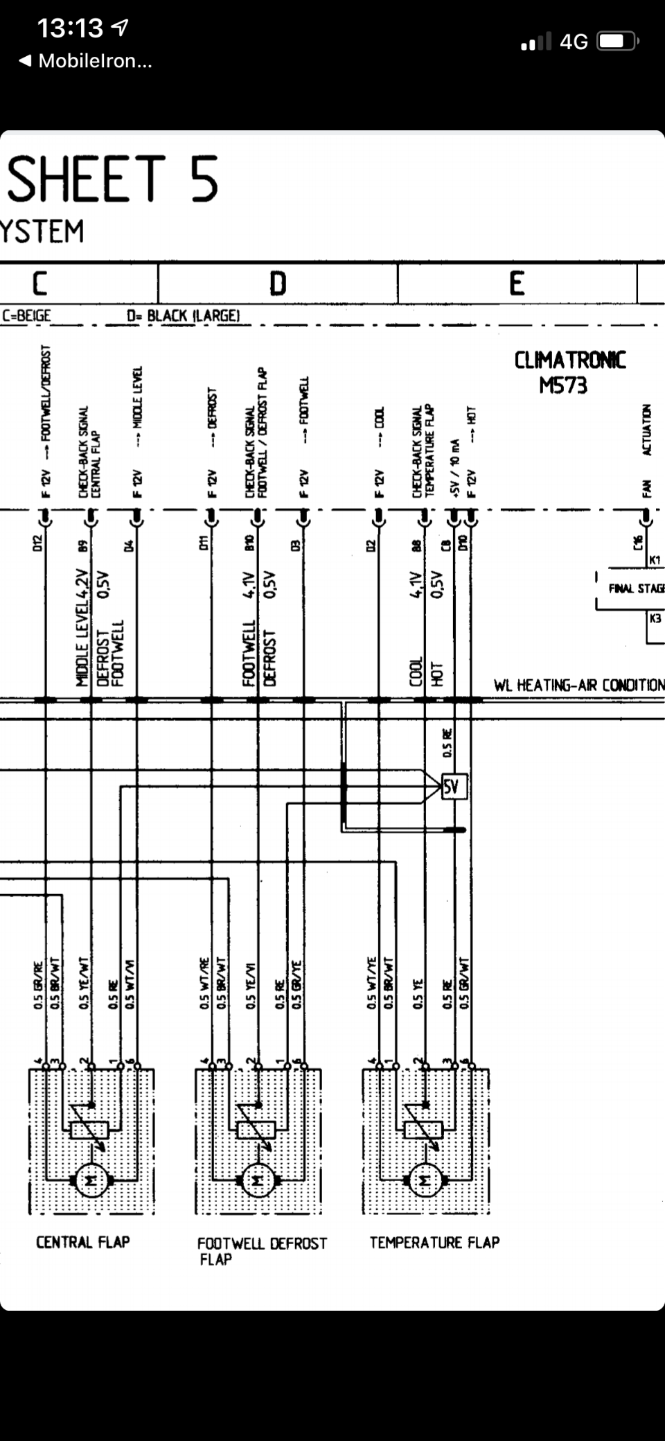

I'm interested in the heating signal - I found one for A/C, any pointers on where the heater is?

There’s an analogue 5v check back signal - yellow wire connector B that gives the signal between hot and cold (column E below). It’s a fairly blunt method, but certainly good enough to maintain the existing climate control panel via an Uno and relay.

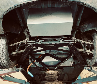

I was contacted via a Facebook group, by a Porsche magazine journalist who asked to feature the car. I’m supposed to encourage you to go out and buy a copy, but in the interest of open source, the article is below.
The pictures were taken a week before the second Chevy volt pack and battery boxes were fitted therefore to the eagle eyes of this forum, the car isn’t looking its best.
Regardless, it was good to get it featured. The journo got most of the technical information and spec correct.

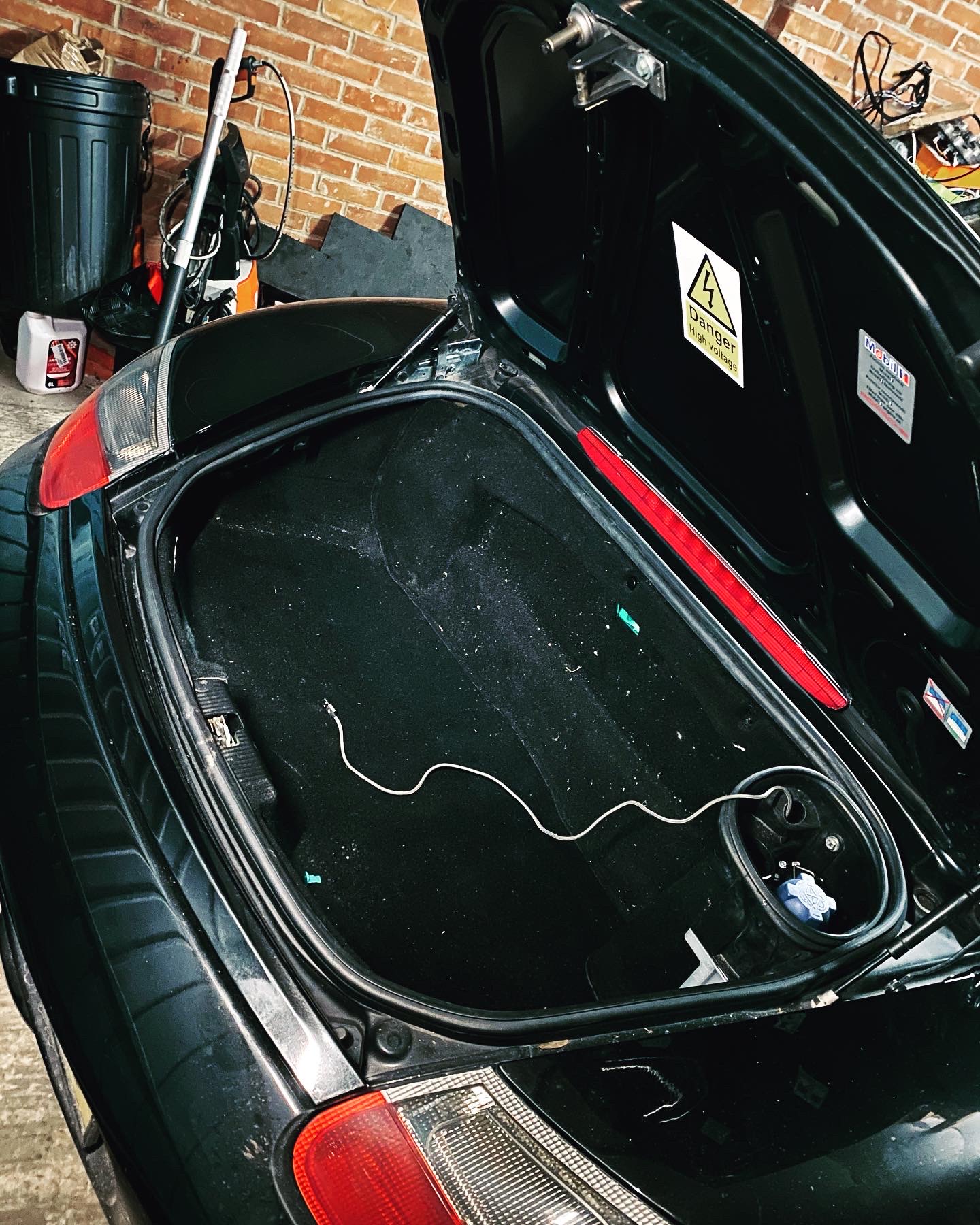

1) There isn't sufficient space in the fuel tank area (the Tesla gen 2 charger is big)
2) The charger has no ingress protection whatsoever. It's meant to be mounted inside the vehicle
3) Ease of access.
I tried the charger everywhere in the car and found that the frunk gave the best options in terms of space, positioning and locality to AC wiring.

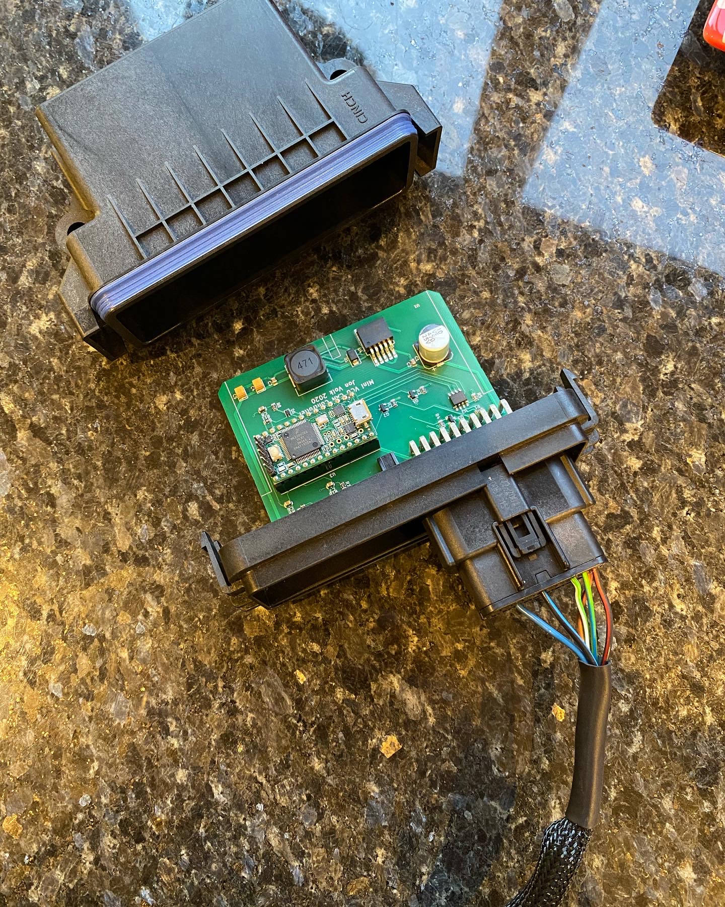

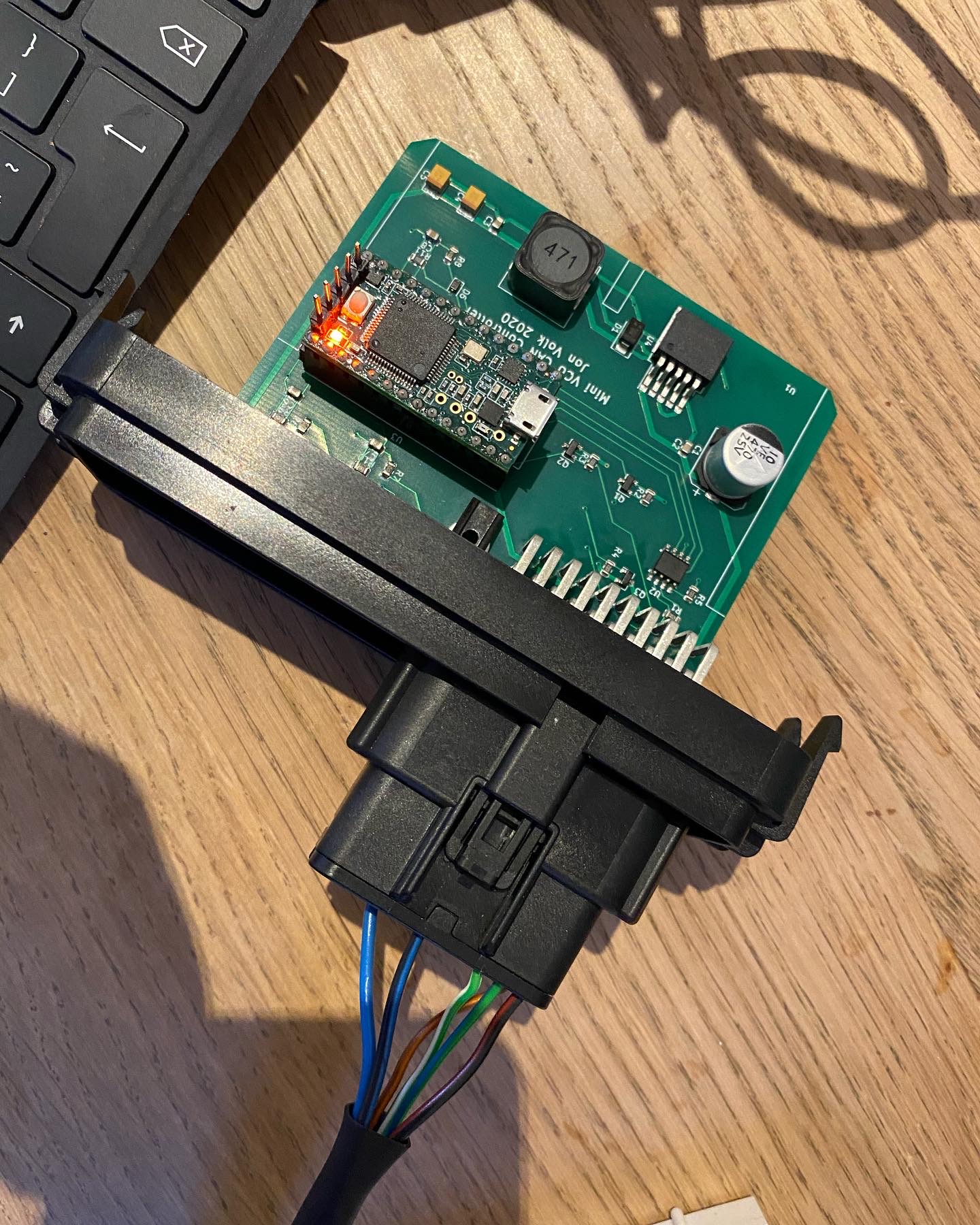

Jon was kind enough to knock me up a small Teensy based JLCPCB to handle my CAN BUS drive unit comms and a few other items such as gauge cluster CAN messaging and LV battery tender, IE kick-on the DCDC if the 12v is getting low at any point (when the car isn’t in drive mode).
So nice to have a Cinch enclosure and do away with my amateur breadboard and loose CAN transceiver.

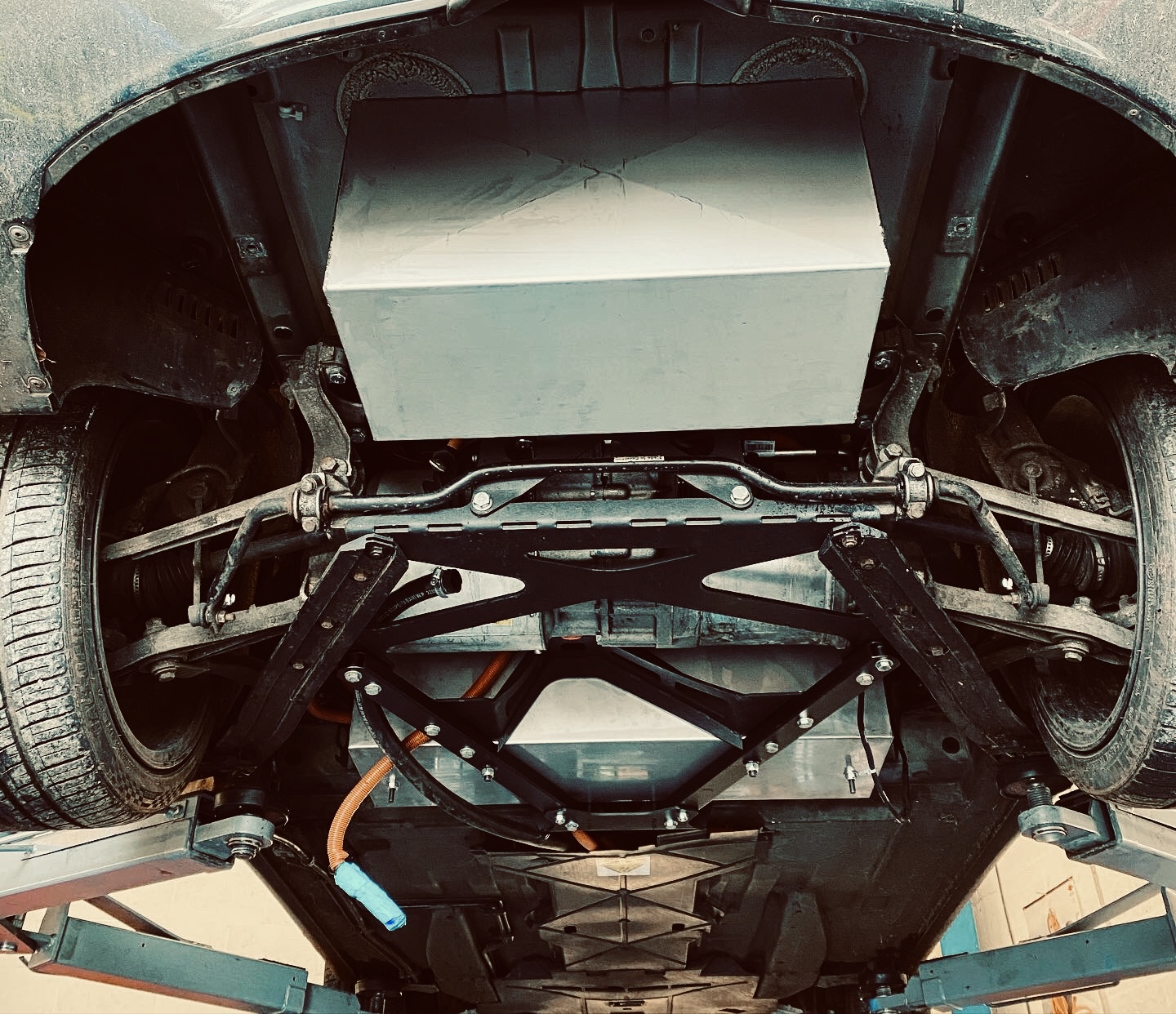

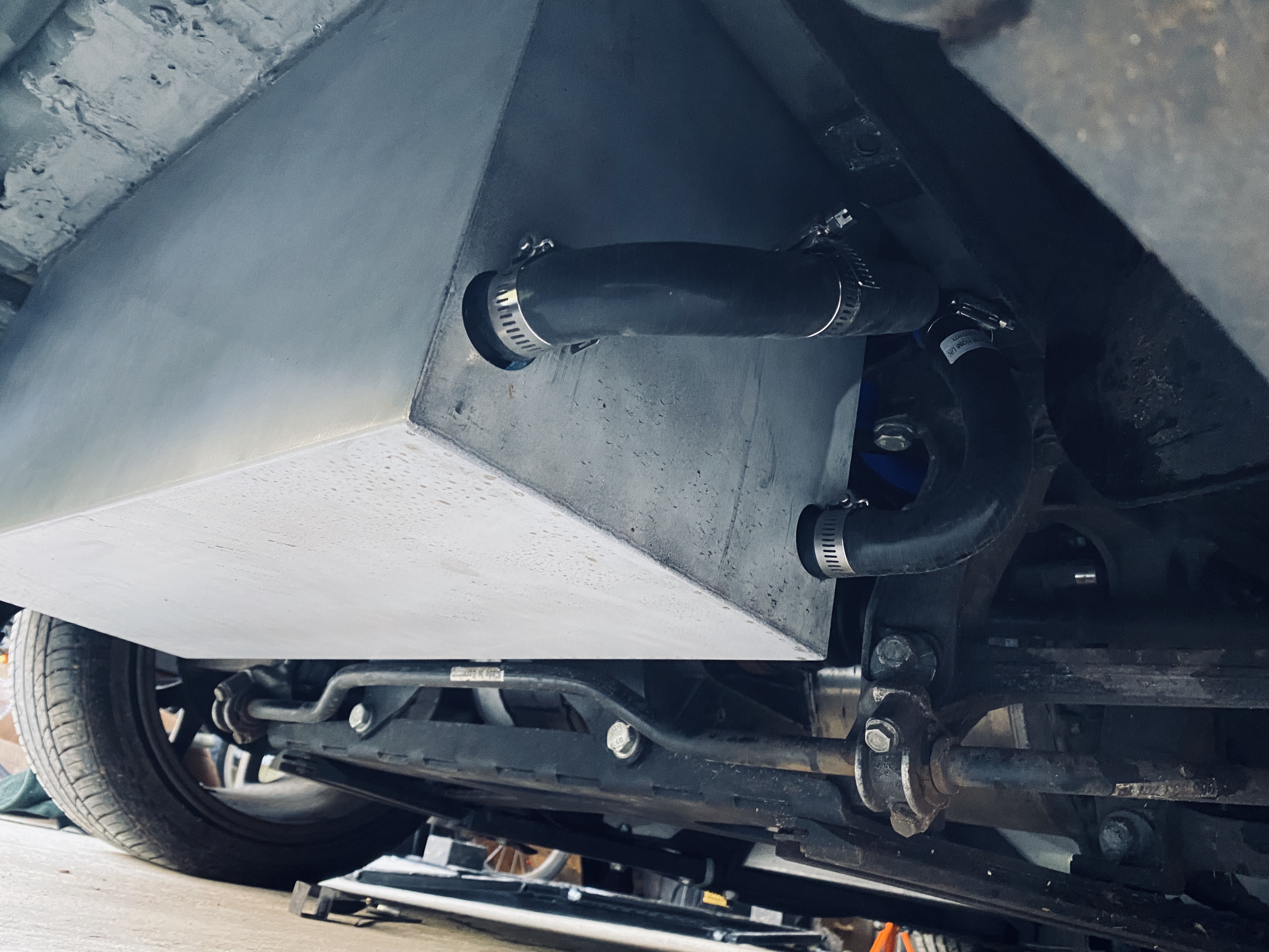

I've also finished off the rear battery box for the medium size Ampera battery module for the second pack. This means I get my boot space back.
The car continues to perform well as a daily driver.

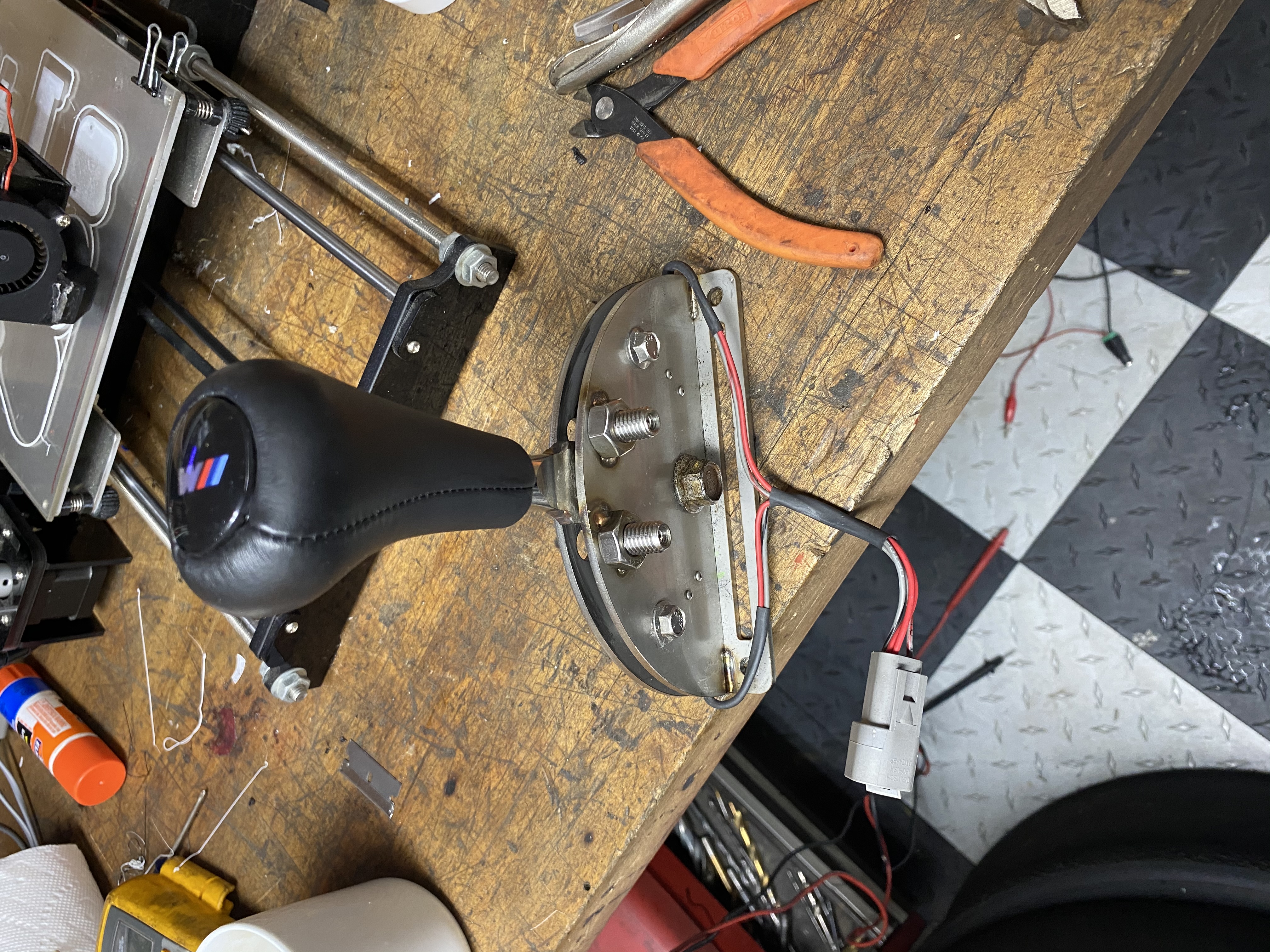

One thing I'm working through is an elegant way to select R-N-D. I have the knob from zeroEV and it works well, but I would love to have a more OEM solution like you. Did the Boxster auto shifter already have internal switches that are triggered and send a signal, or did you have to add some internal switches?

Yes, I just added micro switches to the OEM auto selector. Although I had to re-do them as the first iteration featured cheap Chinese jobbies which failed after a few months. Since then I've used better quality switches.
This more or less demonstrates:

Awesome - thank you! I have switches like that laying around from my 3d printer so I can definitely make this work.

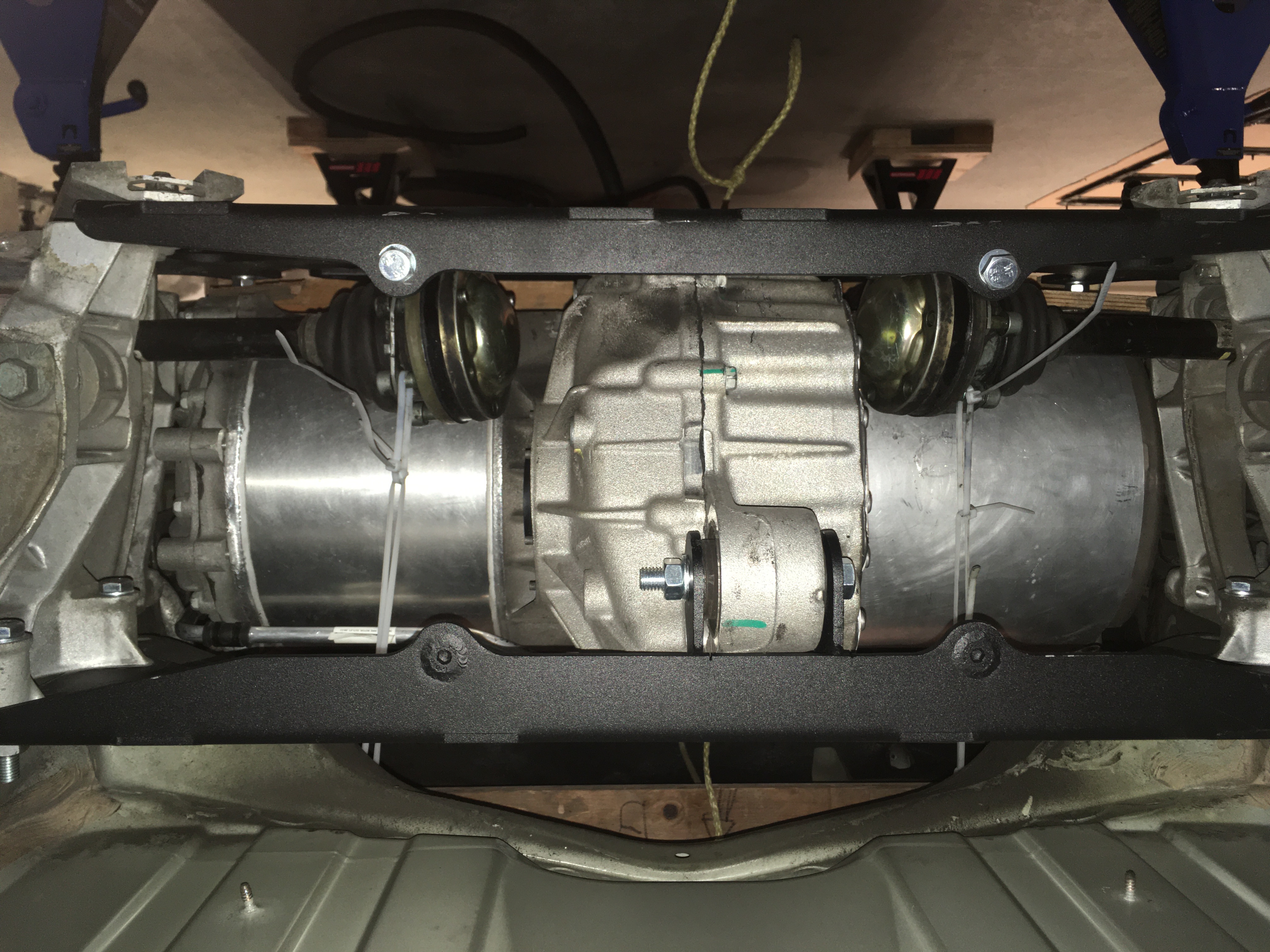

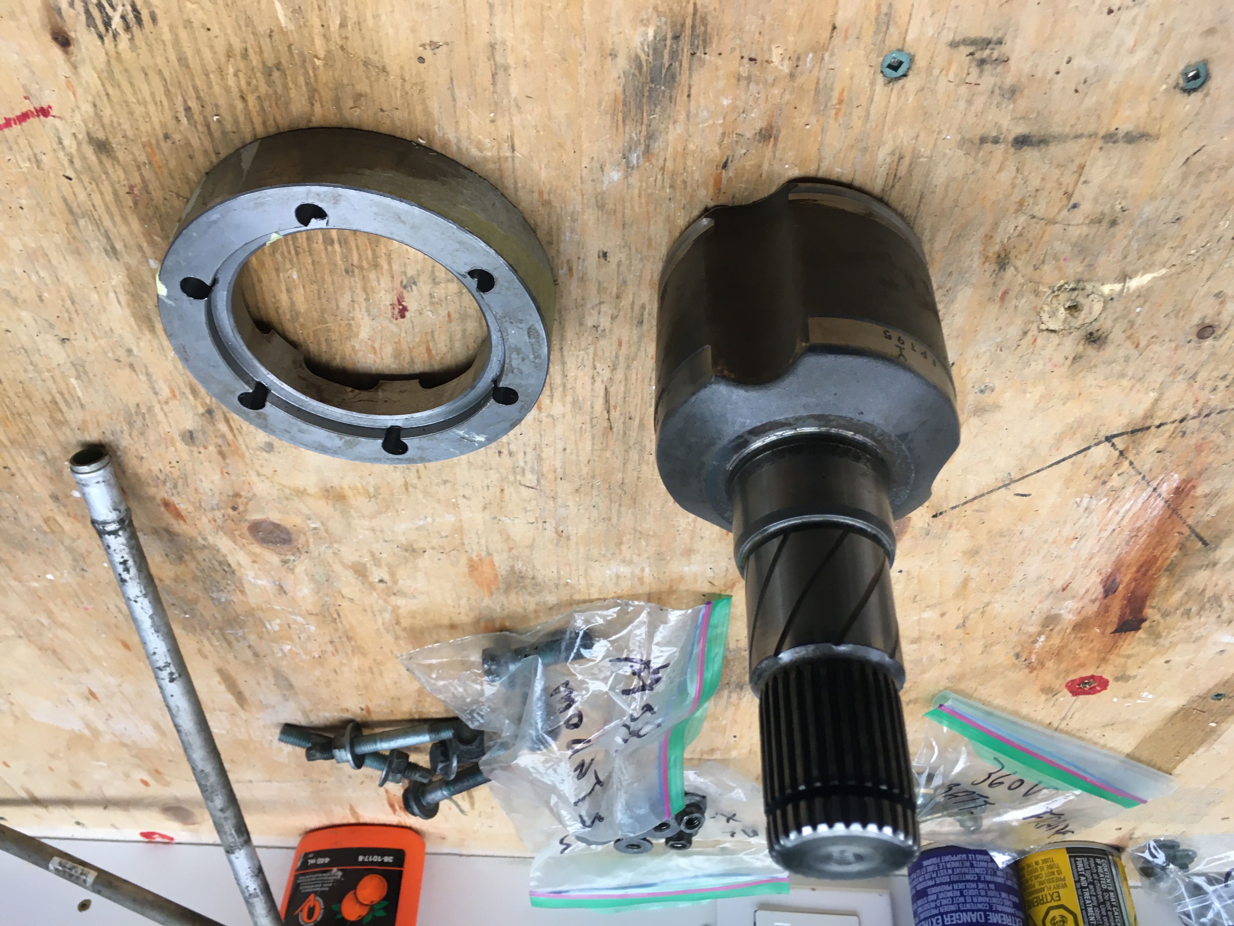

I got the Porsche Tesla frame in early January and installed the Tesla motor into the car for initial fitting. It's a tight fit but nothing is rubbing.
Now I need to fit and measure the Tesla drive stub shaft in preparation for cutting to length and welding the cup adaptors for the Porsche drive shafts. I have an '02 Boxster S and was wondering what is the total length of the Tesla drive shaft stub with the cup welded on?

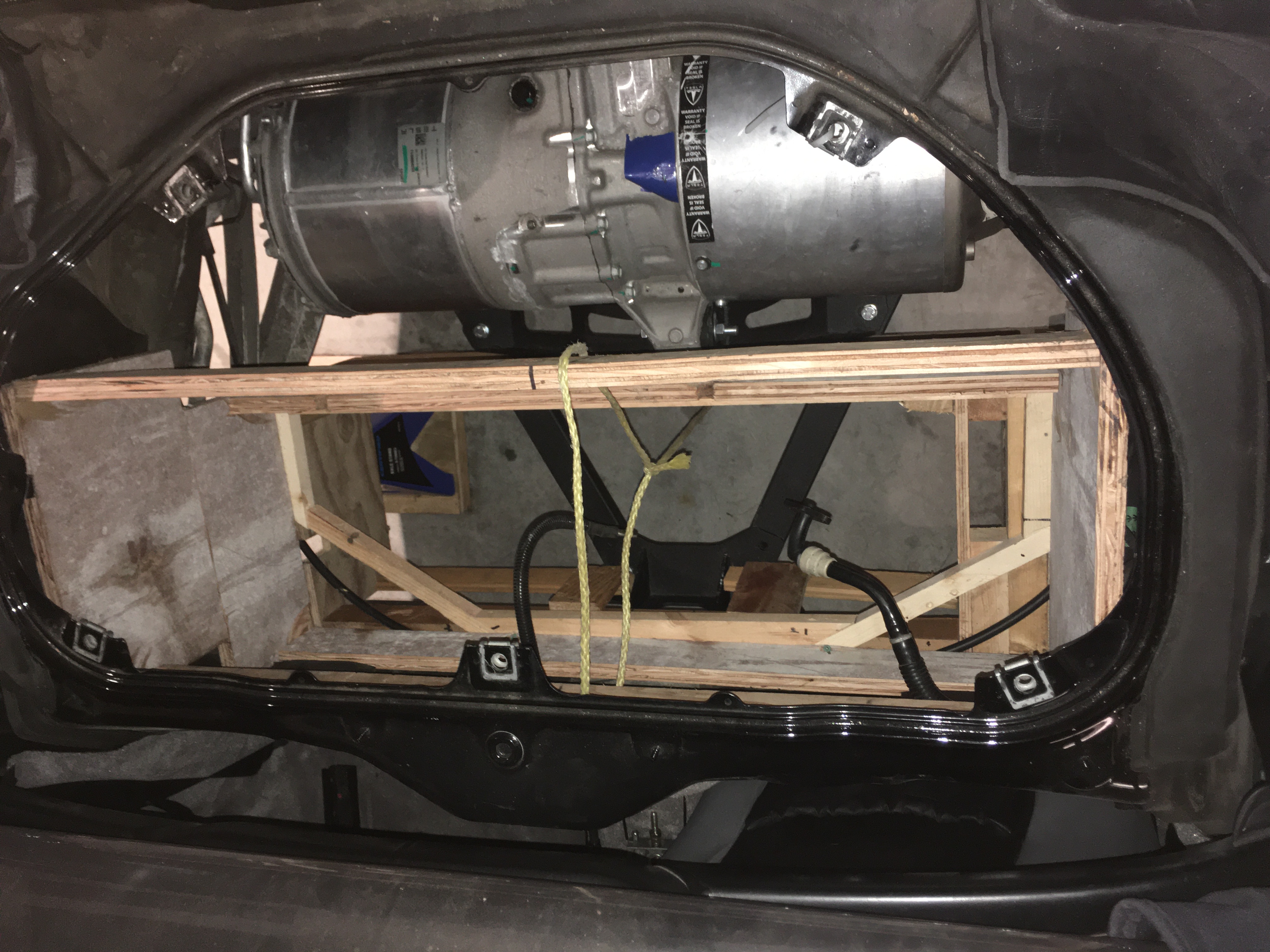

I have also built a wooden template for the battery box that will fit in front of the motor.

I can’t easily get access to my stumps, as they’re well loctited in. I’ll take some pictures of them in situ this weekend. Bear in mind my car is the baby 2.7 and will have different drive shafts and adapters to the S.
Have you asked Nev? His Boxster conversion is an S and he’s probably got the dims somewhere.

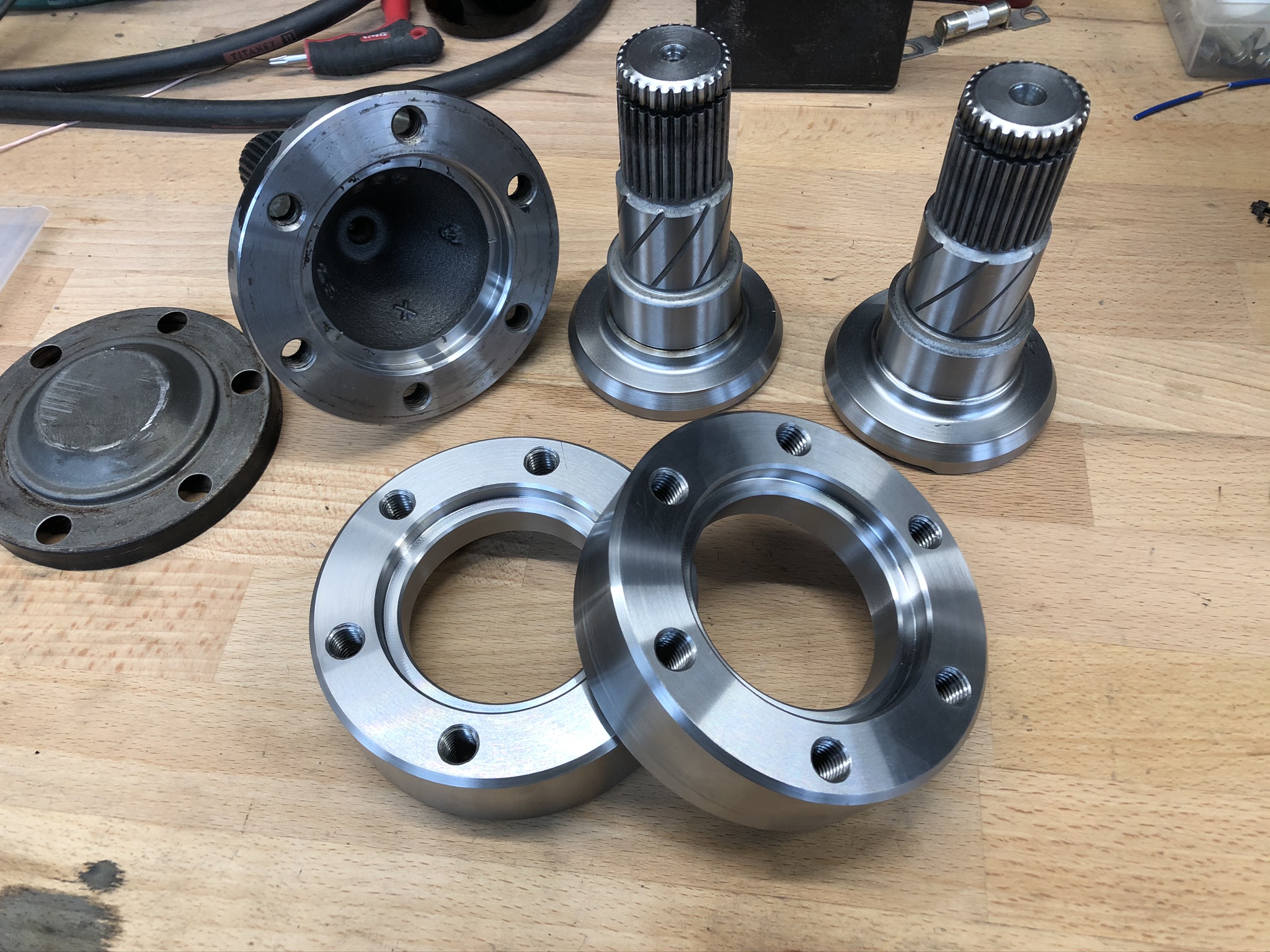

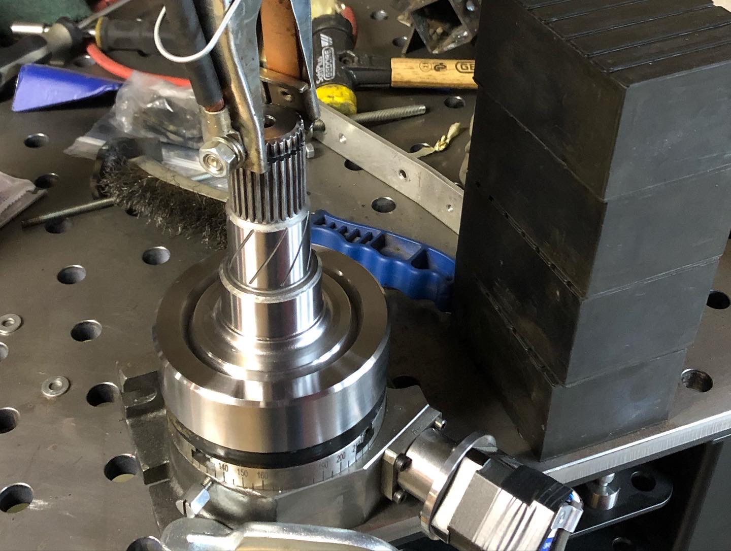

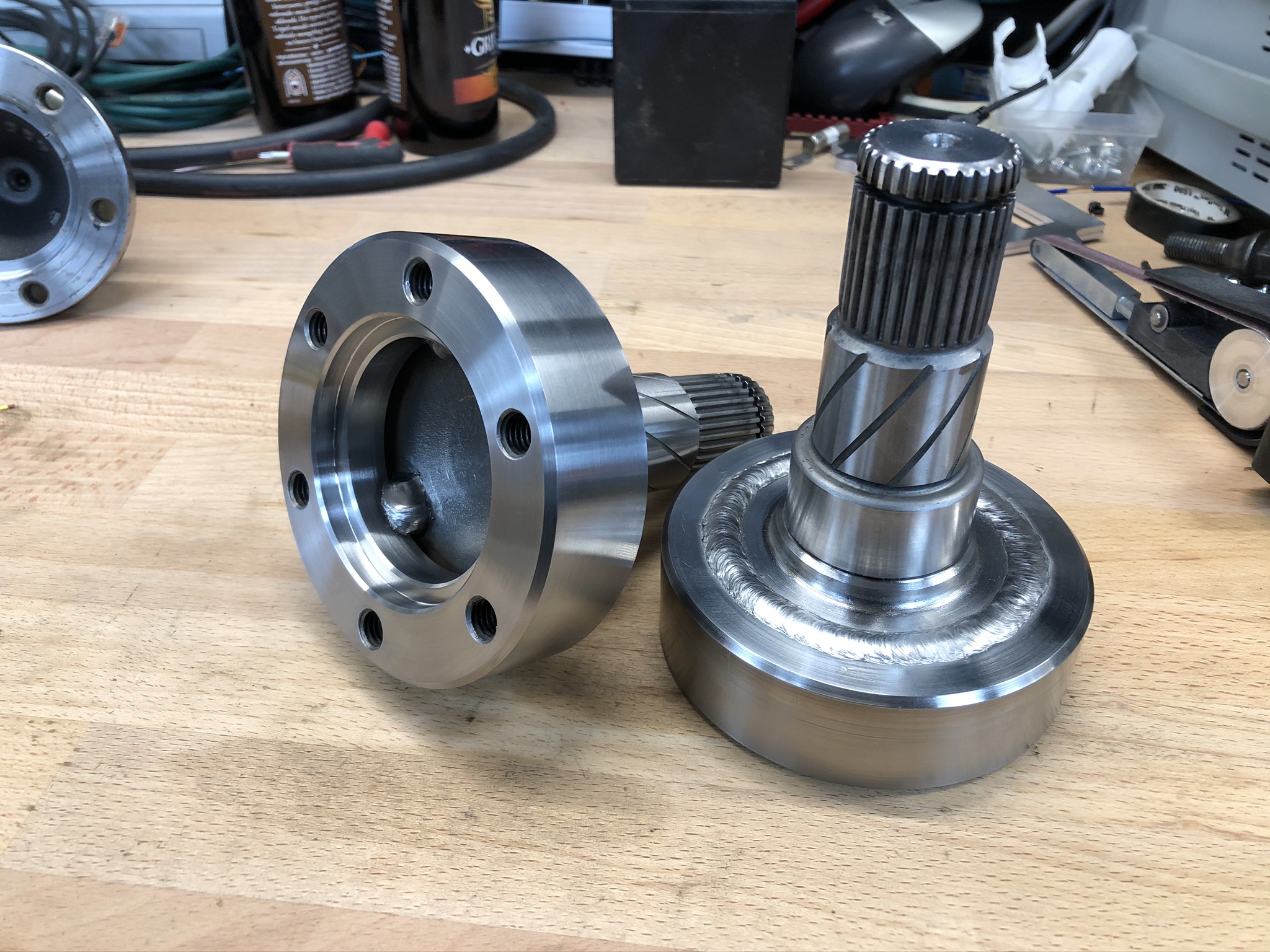

Maybe the safest way is to measure the distance over the flanges of the original diff. Borrow somewhere a large caliper (how I did it), measure the original distance vs. the flanges in Tesla DU and dimensions the cup adaptors accordingly.
This is how I made mine from Tesla stubs. Original stub at the left.

Hi Boxster EV. I am using Kia Soul batteries. I think they are a little heavier (higher energy density) than the Chevy Bolt ones but are air cooled. I am planning on getting 6 modules between the motor and firewall and the final 2 modules will go under the trunk (boot)

Good shout. Measuring my thin 2.7 shafts will be no use for S variants.FJ3422 wrote: ↑Fri Jan 29, 2021 10:05 am Maybe the safest way is to measure the distance over the flanges of the original diff. Borrow somewhere a large caliper (how I did it), measure the original distance vs. the flanges in Tesla DU and dimensions the cup adaptors accordingly.

Wy didn't you weld first the chunks of metal to the Tesla stubs and then afterwards on the lathe you brought everything into shape?
Wouldn't that be more precise? Since welding can "move" the parts?

Sure, that would have been more precise. But I am limited in machining possibilities (just messing around in my 32sqm basement) and had nothing to fix the welded adapter for drilling & tapping the hole-pattern. So I had to do that before mating the parts. Stubs were pressed-in, axial & radial runout checked, welded at the inside, checked again, and finally welded around on the outside. Runout in both directions is less than 0,1mm which is sufficient.EV_Builder wrote: ↑Sun Jan 31, 2021 11:24 am![]()
Wy didn't you weld first the chunks of metal to the Tesla stubs and then afterwards on the lathe you brought everything into shape?![]()
- EV_Builder
- Posts: 1205
- Location: The Netherlands
- Been thanked: 37 times
Re: Porsche Boxster 986 Tesla conversion
Sounds good enough indeed!FJ3422 wrote: ↑Sun Jan 31, 2021 1:22 pm Sure, that would have been more precise. But I am limited in machining possibilities (just messing around in my 32sqm basement) and had nothing to fix the welded adapter for drilling & tapping the hole-pattern. So I had to do that before mating the parts. Stubs were pressed-in, axial & radial runout checked, welded at the inside, checked again, and finally welded around on the outside. Runout in both directions is less than 0,1mm which is sufficient.
