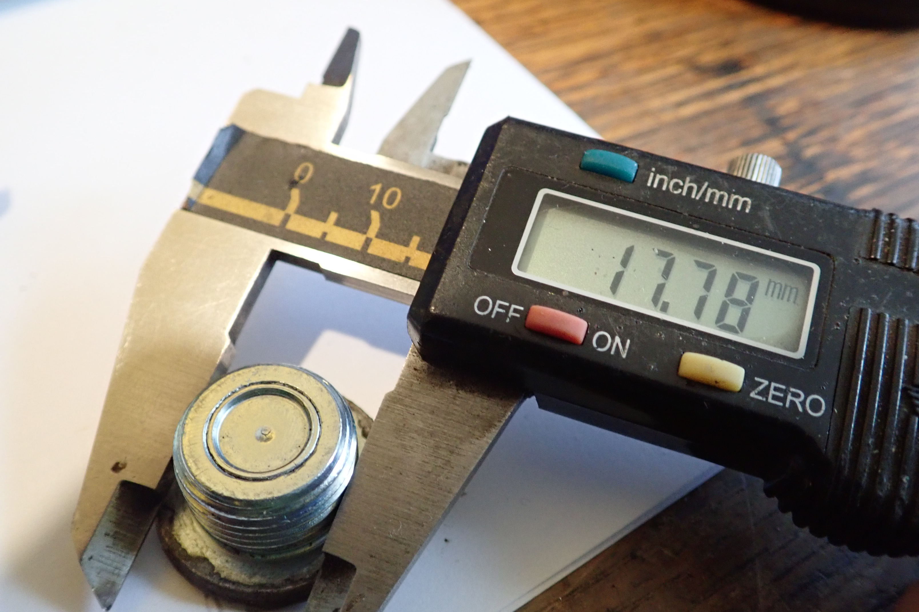

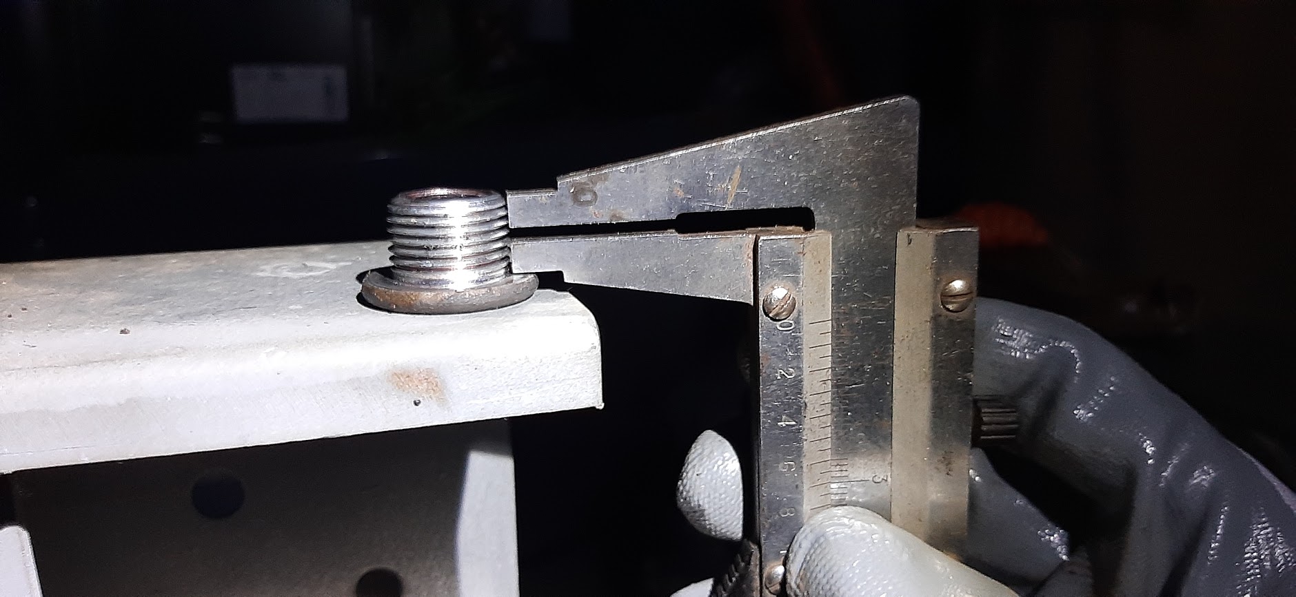

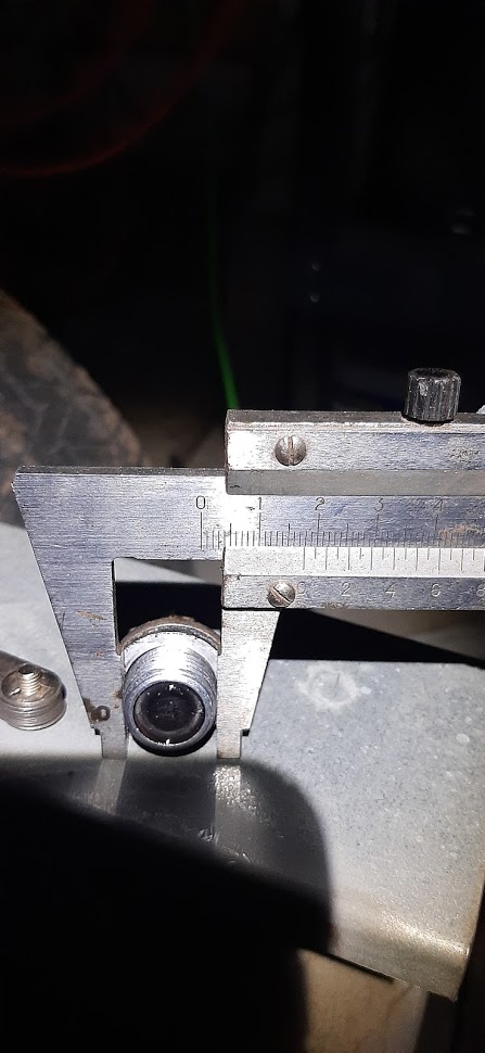

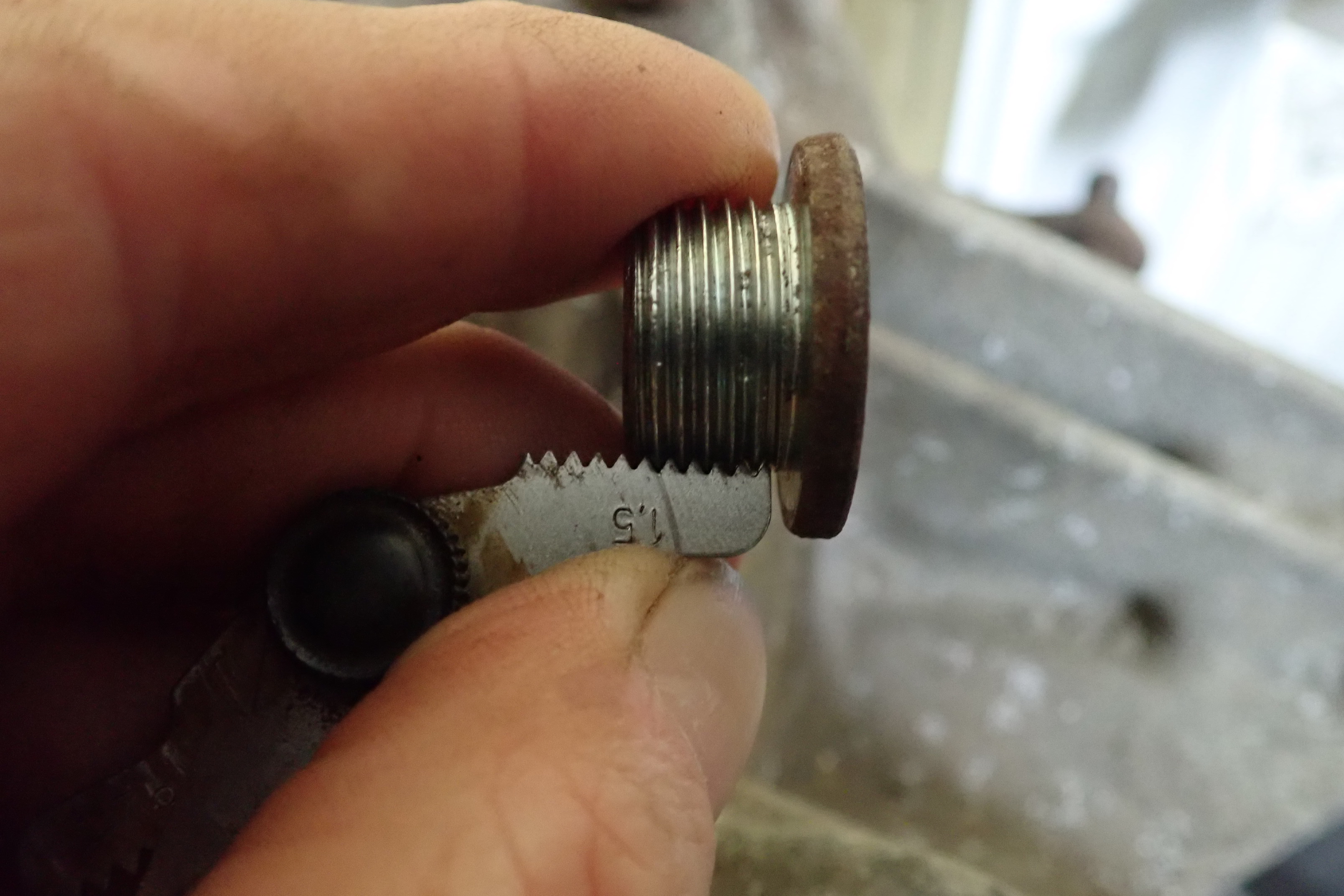

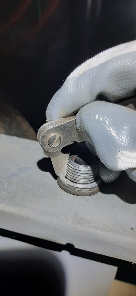

Re: Toyota MGR Rear Traction Transaxle
All three plugs are M18x1.5 Length 11mm.Jack Bauer wrote: ↑Wed Sep 02, 2020 2:35 pm Anyone know the thread on the oil drain and level check plugs?
The filler is M18 by 1.5mm pitch and I haven’t taken the drain out but cant imagine it's different.Jack Bauer wrote: ↑Wed Sep 02, 2020 2:35 pm Anyone know the thread on the oil drain and level check plugs?
I was just coming back to say I don't know the diameter but definitely measured 1.50 thread count.
