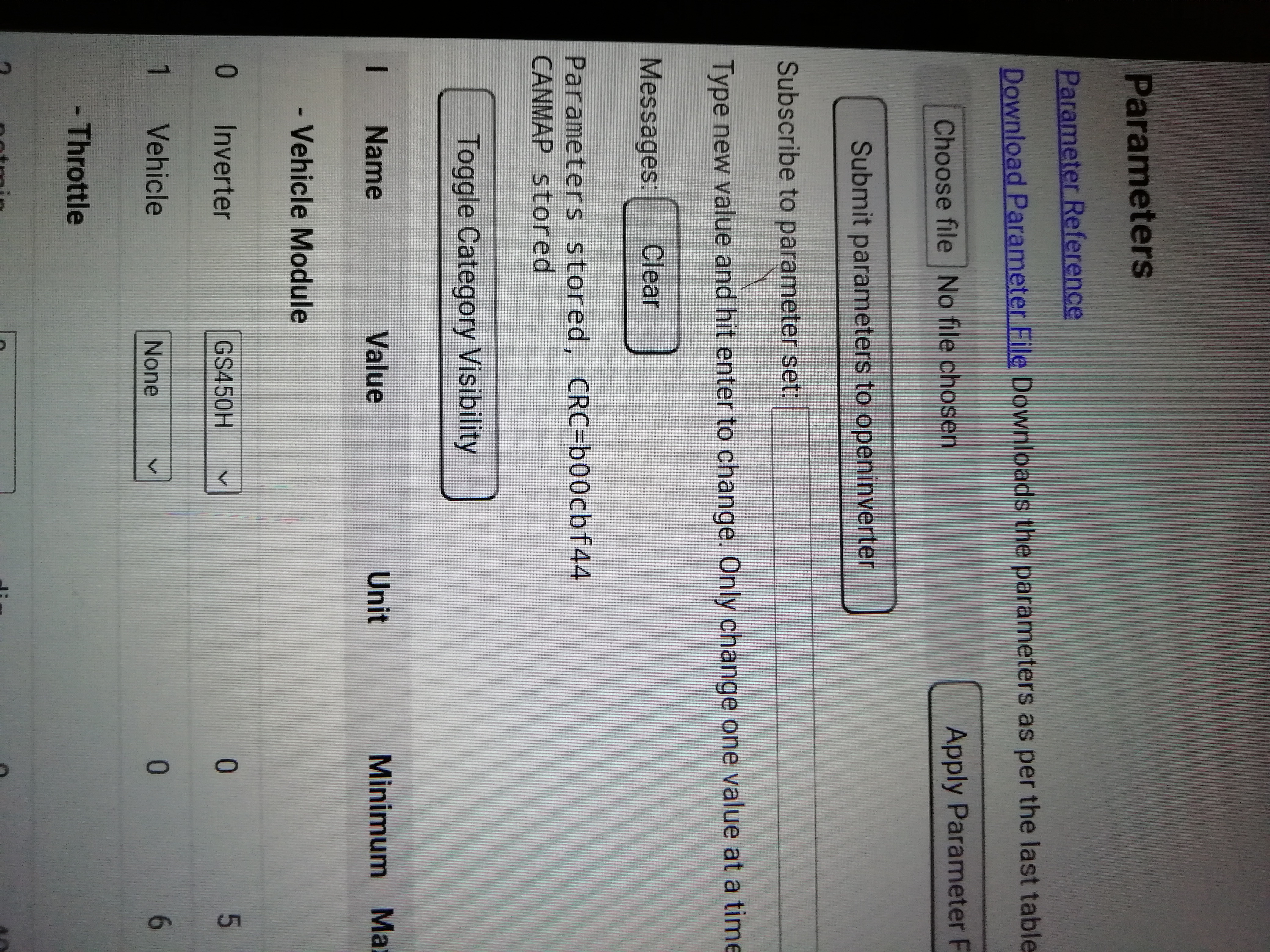

Jack Bauer wrote: Wed Oct 20, 2021 12:01 pm It's been a bit since I messed about with the lexus stuff but sounds like you are good to go. Data exchange is happening with the inverter. 65v is more then enough to spin up the motors. What is invstat parameter? When you press throttle is potnom and torque registering a change?
Invstat is ON
Potnom and torque are staying at 0
My pot ranges from 420 to 2580 when fully pressed
Potmin 400, potmax 2800
Potmode single, dirnode switch..
Posts: 3831
Has thanked: 75 times
Been thanked: 696 times
Re: ZombieVerter VCU Support
There's your problem:) Have you set udcmin to a sane value? say 20v? also potmin needs to be greater than your off throttle reading. so if your off throttle is say 420 then set pomin to 430. Potmax needs to be less then your wide open throttle value. So if your wot value is 2580 then set potmax to 2570.

Jack Bauer wrote: Wed Oct 20, 2021 12:16 pm There's your problem:) Have you set udcmin to a sane value? say 20v? also potmin needs to be greater than your off throttle reading. so if your off throttle is say 420 then set pomin to 430. Potmax needs to be less then your wide open throttle value. So if your wot value is 2580 then set potmax to 2570.
That makes sense. To be fair I had been playing about with them already. Now set 500 min, 2500 max, and pressed UPDATE
But it’s still the same result, potnom stays on zero :/
Udcmin is 45, tried 20. No errors but no go.
Edit: tried cycling / restarting it with the new setting, no change. Thanks for the help, will come back to it tomorrow.

Jack Bauer wrote: Wed Oct 20, 2021 6:02 pm Ok few things. You need to always press enter when changing a parameter.
Changes survive a power cycle so I assume I’m doing that correctly.
Is your opmode in RUN? If not no torque commands are sent
Are you using a single or dual channel throttle? Dont forget to set potmode accordingly.

Jack Bauer wrote: Thu Oct 21, 2021 7:23 am Yes but is pot 2 reading? I'm guessing it is and if not calibrated this will cause the problem. Calibrate pot2, select dual throttle mode and see if that makes a difference.
OK - the problem was that Throtmax was set to zero. I hadn’t changed that so it’s either the default value or it got scrambled.
The VCU will run with two pot inputs when set to single pot mode. But it looks like pot2 is referenced in the calculation, even in single mode, so yes, beware of that.
Other issues:
InvLSswitch output does not work. Must be a hardware problem I guess? We’ve ordered a new board anyway so I won’t spend time investigating that for now.
Tmpmmax is still coming in at 6400, which does prevent it from working. Where does that value come from, have I got a wiring fault?

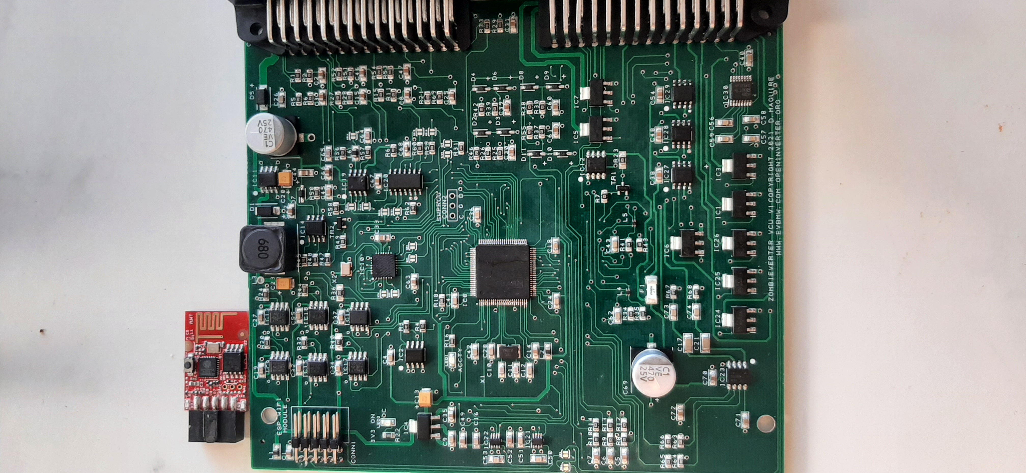

Hi strange issue here. Updated the software on my v1 board yesterday(compiled from master on github) I did update as normal and then it just stopped at 80%. No problem pulled power the did tweezers across c12. The board then accepted the update and finished. Only issue is now it doesnt show any parameters on web portal(it did before update) I have tried Johannes tip of clearing the files on the/list page. II have also tried another wifi board that works with the older vcu to no avail.Already tried compiling a new bin on other computer just to be sure. Would i be right in assuming the issue lies somewhere in the communication between stm and wifi module? Any body got any thoughts?
Can anyone share a .bin file with me to see is it i just made a mess when compiling?

@paa your most likely issue is a bad solder joint on the MCP25625. the latest firmware initialises this device at startup and if not present or has a problem will give the problem you describe. Attached see binaries for an early release without this check in place. Future updates will see a timeout on this so the vcu does not halt.

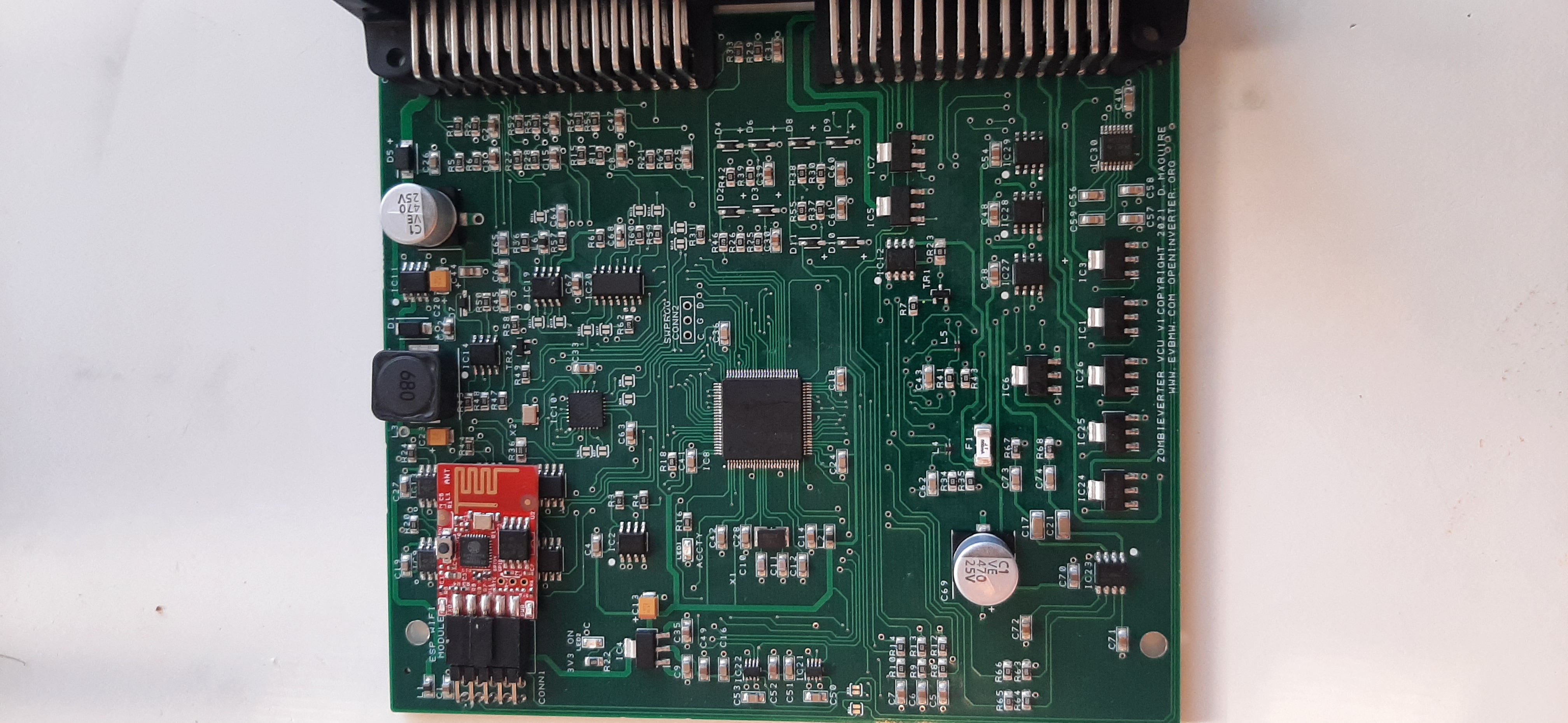

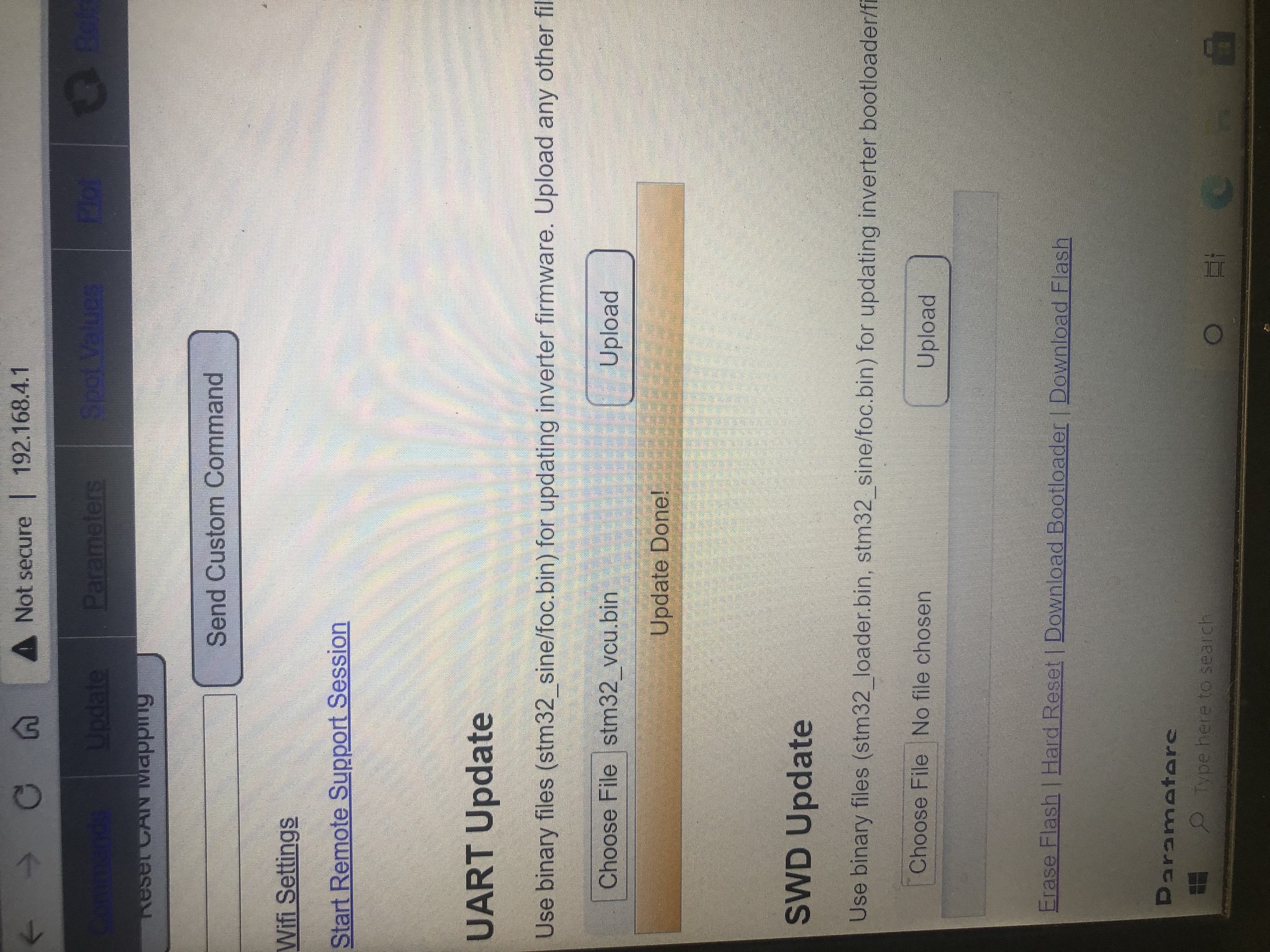

Coming back to it today and the web interface is empty, like paaa described above. I have re-loaded it several times, apparently it accepts this OK (with or without the tweezer reset) but still no life after a reboot. I tried your .bin file too Damien. There should be a LED flashing if it’s alive?
The soldering on the MPU / IC10 looks fine, I can reflow it but not too optimistic right now. Any other ideas?
Posts: 3831
the led should be flashing when the software is running. The fact that its uploading means the bootloader is alive. The .bin above should run regardless of the MCP25625. Honestly, I can't generate a fault like this here.

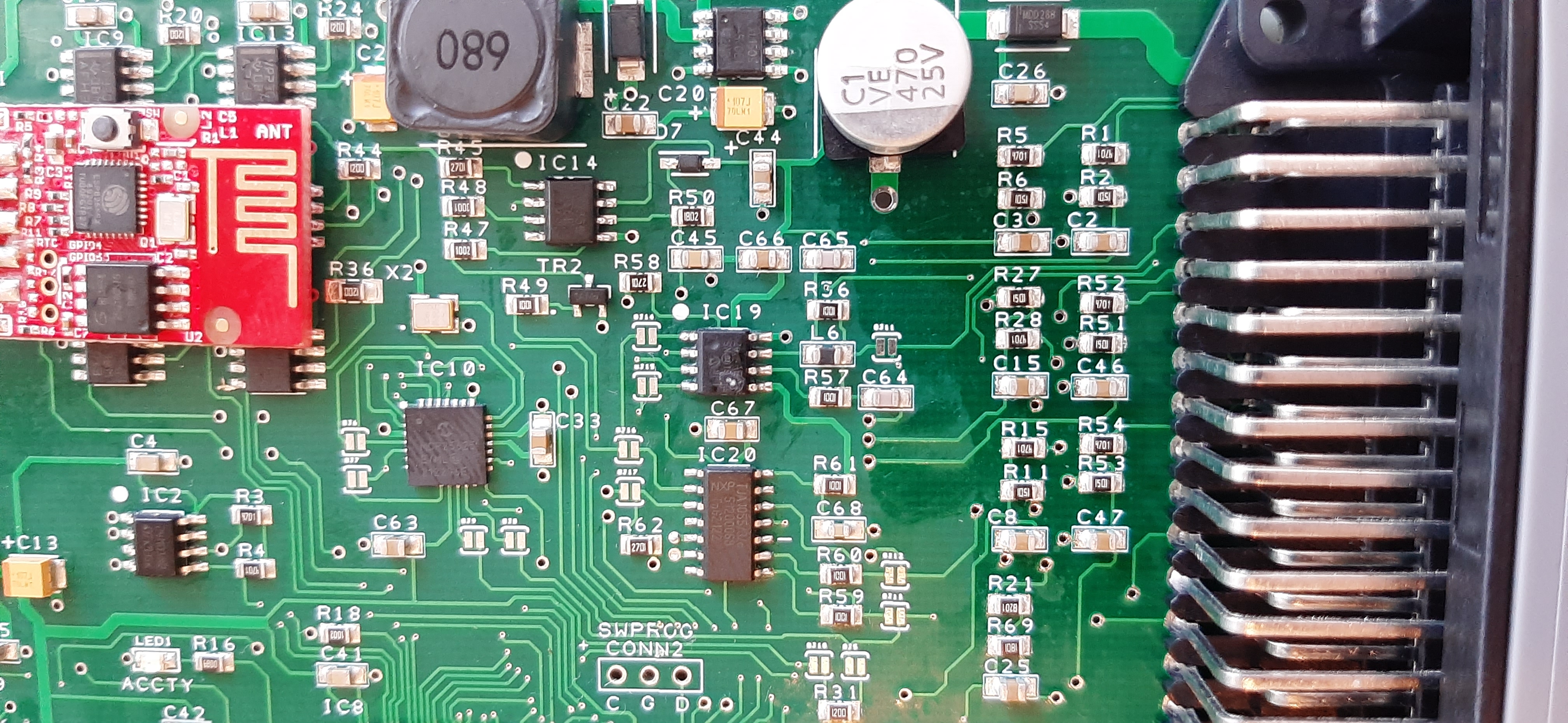

andrewjenkins34
Posts: 57
Joined: Thu Dec 17, 2020 1:48 am
Post by andrewjenkins34 »
Anything new is always challenging. I wouldn't have even started my project if it weren't for the work you're doing and I look forward to seeing it through.
That being said...
I trust my soldering skills about as much as I trust the gov't so I paid someone to do it for me. As soon as I hooked up power and ground, the component at ic19 let out it's magic smoke. Before I have it replaced, can anyone see anything else that would cause problems?
All leds light up and blink, at least for the half second before the smoke started.
Posts: 3831
IC19 is an NCV7356 SW can transciever. As such it gets a direct 12v feed to pin 5. It looks from your pictures to be oriented the correct way so I'm going to guess its the wrong part.
andrewjenkins34
Posts: 57
Great, so that means at least one other component is in the wrong place.
So of the similar components:
IC2 - 24M01RP
IC11- XL1509
IC12 - NCV8461
IC14 - V7356
IC 27, 28, 29 - 3122C
IC23 - TDA2822G
Whatever is at IC19 is not legible. IC14 is supposed to be at IC19 and I'm hoping that's the only change?
Is this information available somewhere that I missed?
Posts: 3831
Full schematics and board layouts on the github as always :)
https://github.com/damienmaguire/Stm32- ... are/Zombie
Looks like IC14 is the NCV7356 that should have been in IC19
