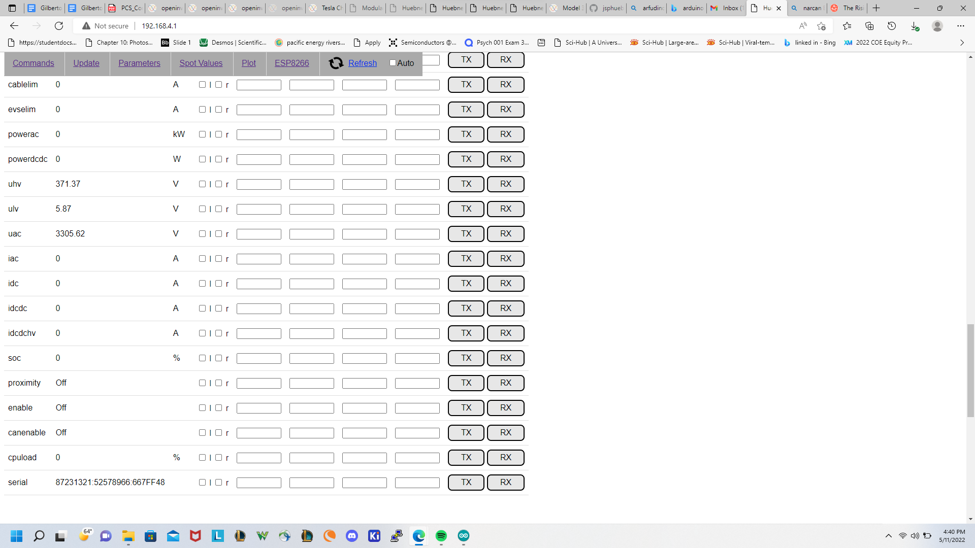

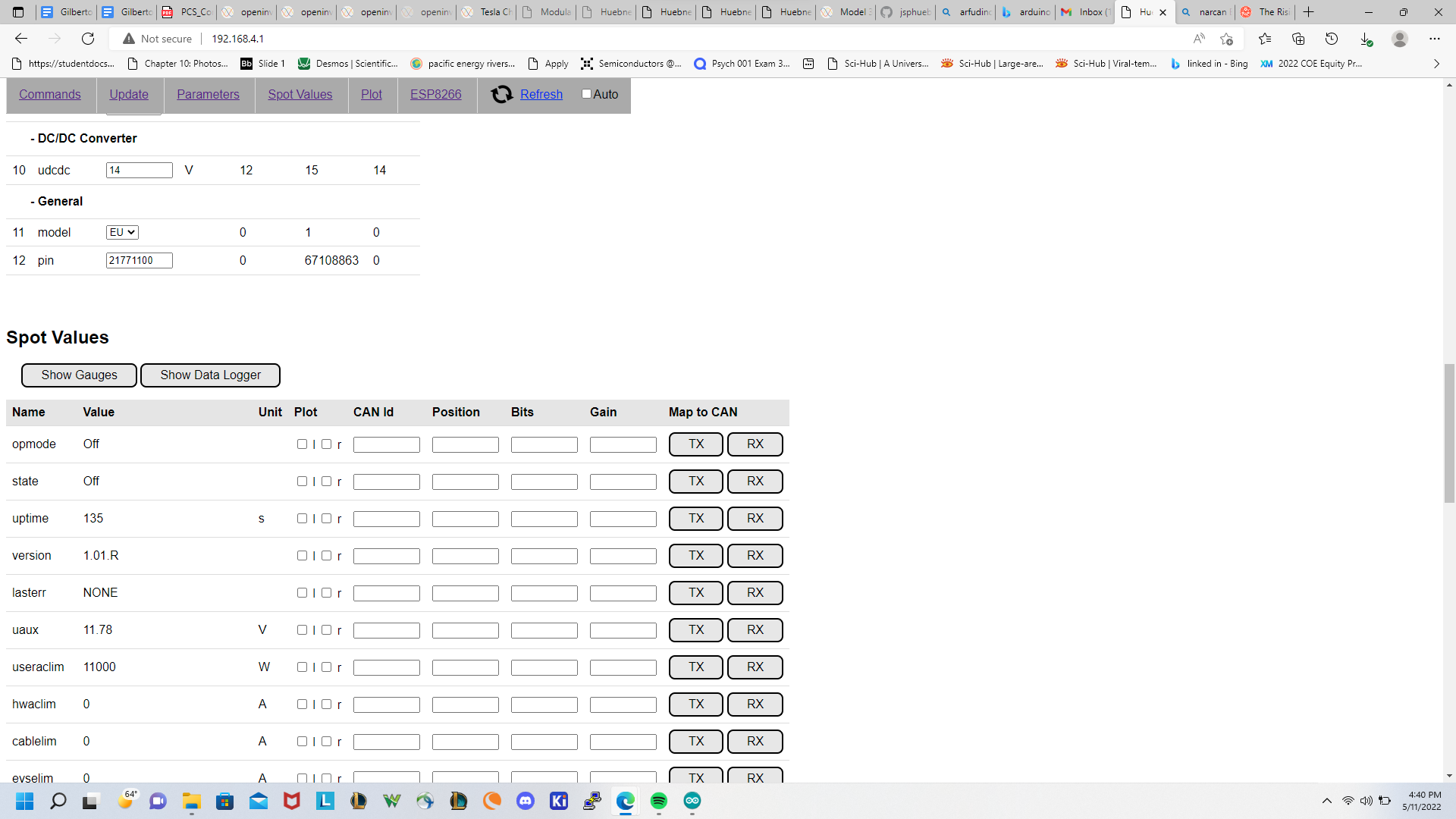

nkiernan wrote: Tue May 25, 2021 8:22 pm PCS controller up and running and connected to web interface
Until I get a wall charger set up, what would be the minimum requirement to be able to use the PCS with 240V single phase domestic supply to allow some testing and light charging of Tesla pack!? Is a fused connection to the AC charge input allowed? If US versions are 120VAC on two pins, will EU PCS work with similar?
Were you able to bench test the PCS before the attaching it to the batteries? I would like to test mine as well but I am struggling with the Arduino side of things. I have downloaded the .ino file from Damien but haven’t been able to run the code bc of the dependent libraries. I have been looking all over the internet for the needed librarie but the code will not run with the libraries I have downloaded. Is there a specific place that can holds them all or does the community have a better way of finding the libraries?
(EDIT: I solved the problem, there are multiple libraries that can be used by the Arduino code that Damien provides but they will continue to give you errors. You need the Metro library from collins80/metro.h, due_can from collins80/due_can, due_wire from collins80/due_wire, DueTimer from the arduino libraries, wire_eeprom from collins80, and AverageValue from Arduino )
Gilbo
Posts: 3
Joined: Mon May 09, 2022 6:59 pm
Post by Gilbo »

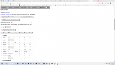

I have been able to run the Arduino code that Damien provided and have been able to attach all but one wire to the Due which is the EVSE_ACT wire which is meant to go into pin 44. I do not know where I am meant to get the EVSE_ACT wire from but any advice would be really helpful. I also have managed to get Damiens board to read the voltage but there does not seem to be any more communication between Damien's board and the PCS. I attached what I see with the arduino Due and Damien's board plugged into the PCS, while the PCS is connected to wall voltage (not a charger) and the battery pack. If this is similar to what is expected I would really appreciate anyone letting me know if this is close.
nkiernan
Posts: 589
Has thanked: 514 times
Been thanked: 95 times
Post by nkiernan »
Gilbo wrote: Mon May 09, 2022 7:26 pm Were you able to bench test the PCS before the attaching it to the batteries?
I've not got this far yet but getting close to having to get back to the PCS, so not much help to your quries unfortunately. Keen to see how you get on, cheers

Gilbo wrote: Thu May 12, 2022 1:00 am I have been able to run the Arduino code that Damien provided and have been able to attach all but one wire to the Due which is the EVSE_ACT wire which is meant to go into pin 44. I do not know where I am meant to get the EVSE_ACT wire from but any advice would be really helpful.
EVSE_ACT is not used on the dedicated controller, so I'm not sure where that should be. There's no activation pin persay on the J1772, and the code has provisions for pilot and prox so its not that. I'm lost as well.

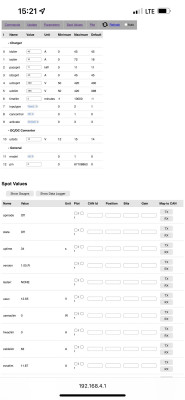

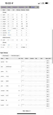

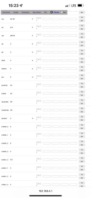

I use stm32 version v2 board with commercial firmaware (demo version for 5 minutes) made by JLCPCB (US version PCS) and have some error bits.
errbits0_2 8 (PCS_a032 unused I think)
errbits1_0 577 (can't explain this errors)
Can you explain this errors for me ?

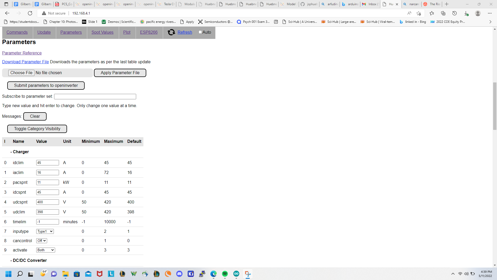

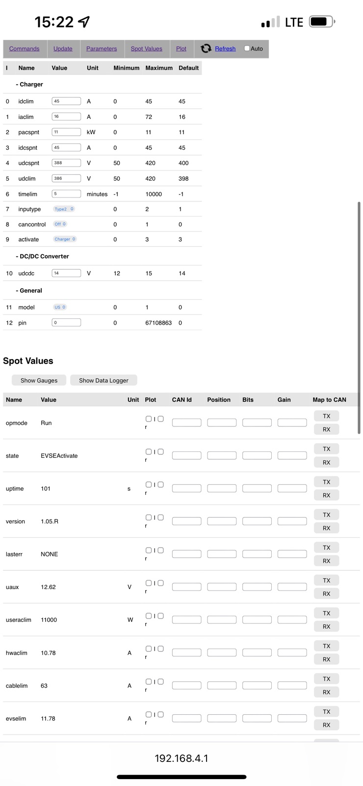

Cannot find a network to connect 192.168.4.1, tried using CAN wires nothing. Get red blinking lights, green light on wifi blinks quick only when turning on. Looked at videos did not find instructions on entering program screen. What is being overlooked?

The main board should have 2 leds. One on sold marked 3v3 and one blinking at 10hz marked "accty". The wifi module should also have two leds. One red on always indicating the module has power and the other flashes green at powerup indicating the module receives data from the stm32 on the main board. At this stage you need a laptop or other wifi enabled device and search for networks. You should find on with ssid "inverter" and password is "inverter123". Once connected, open a browser and navigate to 192.168.4.1 to bring up the web interface. Would be great if someone could please update the PCS wiki page as there is a lot of info that needs to be captured.
Boards are programmed and power tested prior to dispatch as with all the kits. As I have repeated in multiple threads I do not as yet have a workshop up and running to allow me to work on ev parts. Perhaps if those who have their PCS up and running could jump in to help those who do not then some progress could be made. Assuming this doesn't happen then the only thing I can suggest is to ask someone with a non working PCS and controller to send it to me so as we can get to the bottom of this. I have one US and one EU PCS successfully tested on both the original prototype controller and the new V2 stm32 version.
