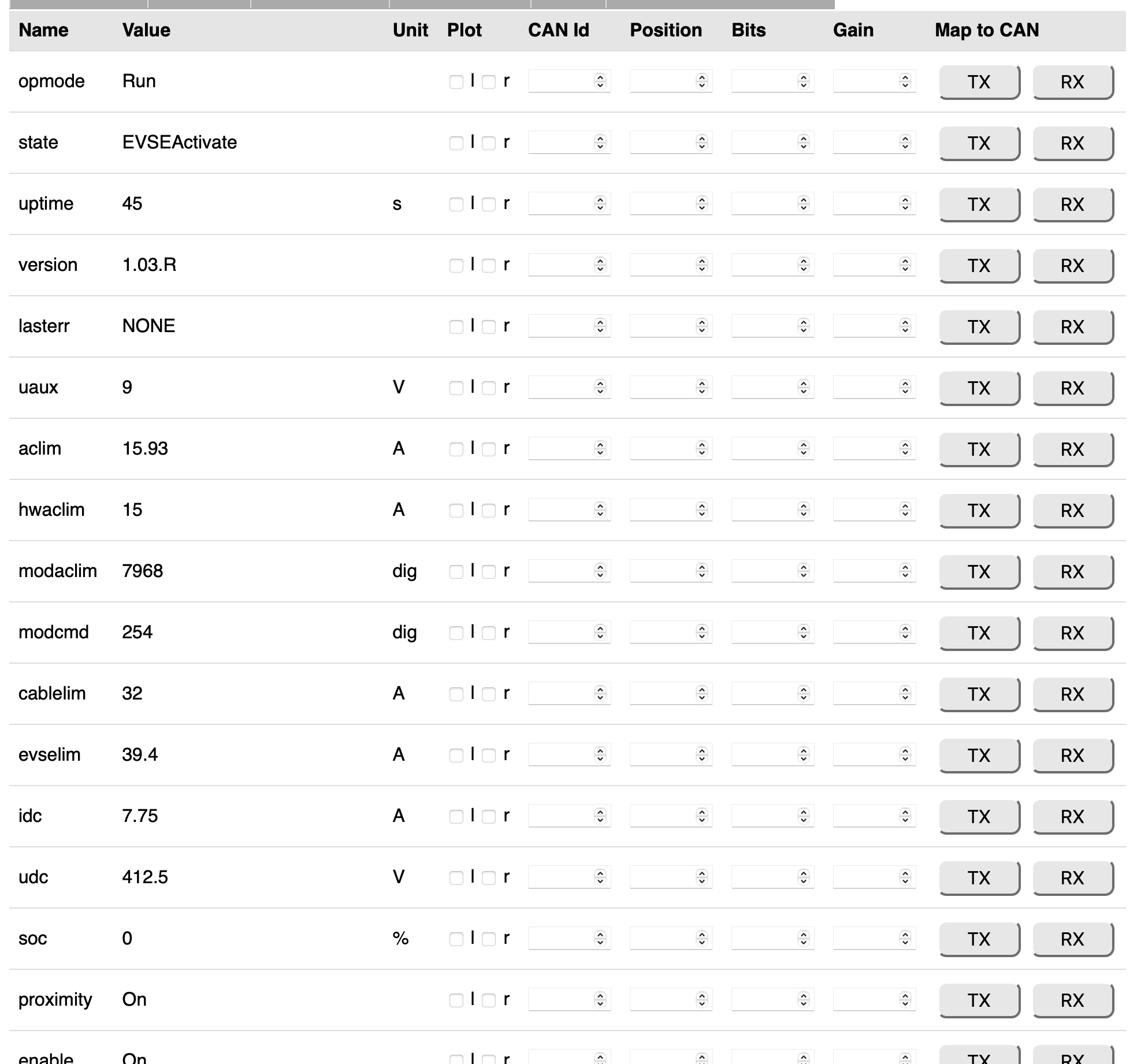

Thought about this. if you read the can back from one of the charger modules it tells you the max mains current. gen2 = 16A and gen3 = 32a if I'm remembering.
- Been thanked: 1913 times
Re: Tesla Charger alternative firmware
That would be great. Do you know where in the CAN stream?
- Posts: 3999
- Been thanked: 1114 times
0x207 is the module 1 line status message. Available line current is in bits 32 to 40 as a 9 bit unsigned int with a scale of 0.06666. On the gen3 this will report as a little under 24A at power up and around 13 A on the gen 2 at power up.
Great!
I continuously sample that message now, can you check for a valid value in "hwaclim"? It will read a little (like 7%) low due to the limitations if the scaling capabilities of stm32_can. I also realized that the scaling of cXiac was off, fixed now.
What is the max DC current of the gen3 charger? I found 18000/400 still yields 45A.
EDIT: just tested on my GEN2 charger, it displays 15A and with the 7% scaling error that is 16A

Also thought about the low voltage problem, i.e. using the charger with <200V batteries. The problem is that it will send 3.7 kW to the secondary side which results in 18A i.e. more than 15A of DC current. Now I could enforce a per-module DC current limit to make sure the DC current never exceeds 15A per module.

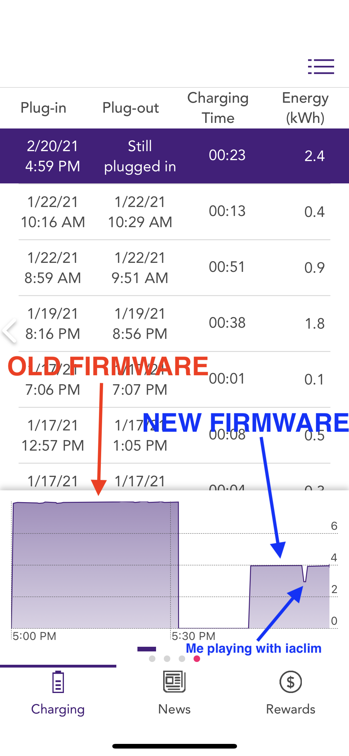

So I uploaded the latest firmware and gave it another shot. The AC current per phase (cXiac) is now scaled correctly, but it looks like hwaclim and/or aclim changes are preventing me from getting full juice. I'm only getting 5A per phase max.
I started a session with the old firmware, updated firmware, and now I'm stuck at a max charge of 15A AC.

One more thing for Johannes - based on what I'm reading in the description of Type 1 and Type 2 settings, the charger will always enforce a maximum AC current of 32A, even if the EVSE is telling it that it can do more. Is that correct? My EVSE regularly puts out a full 40A with other EVs, Tesla and otherwise, so I'm not sure this interpretation of J1772 single phase is 100% correct. Am I reading it wrong? Should cablelim just be set to whatever the evselim is?
You'll notice that with the 'old firmware' in my image above, the EVSE is putting out just under 8kW. At 240V, that's about 32A total, curiously equal to cablelim.
Here is the same charger, cable, EVSE on the 'pre-Johannes' firmware running at 40A (@240V = 9.6kW): edit, last thing: I made a window in the charger case and covered it with a layer of kapton, this definitely improved my WiFi:

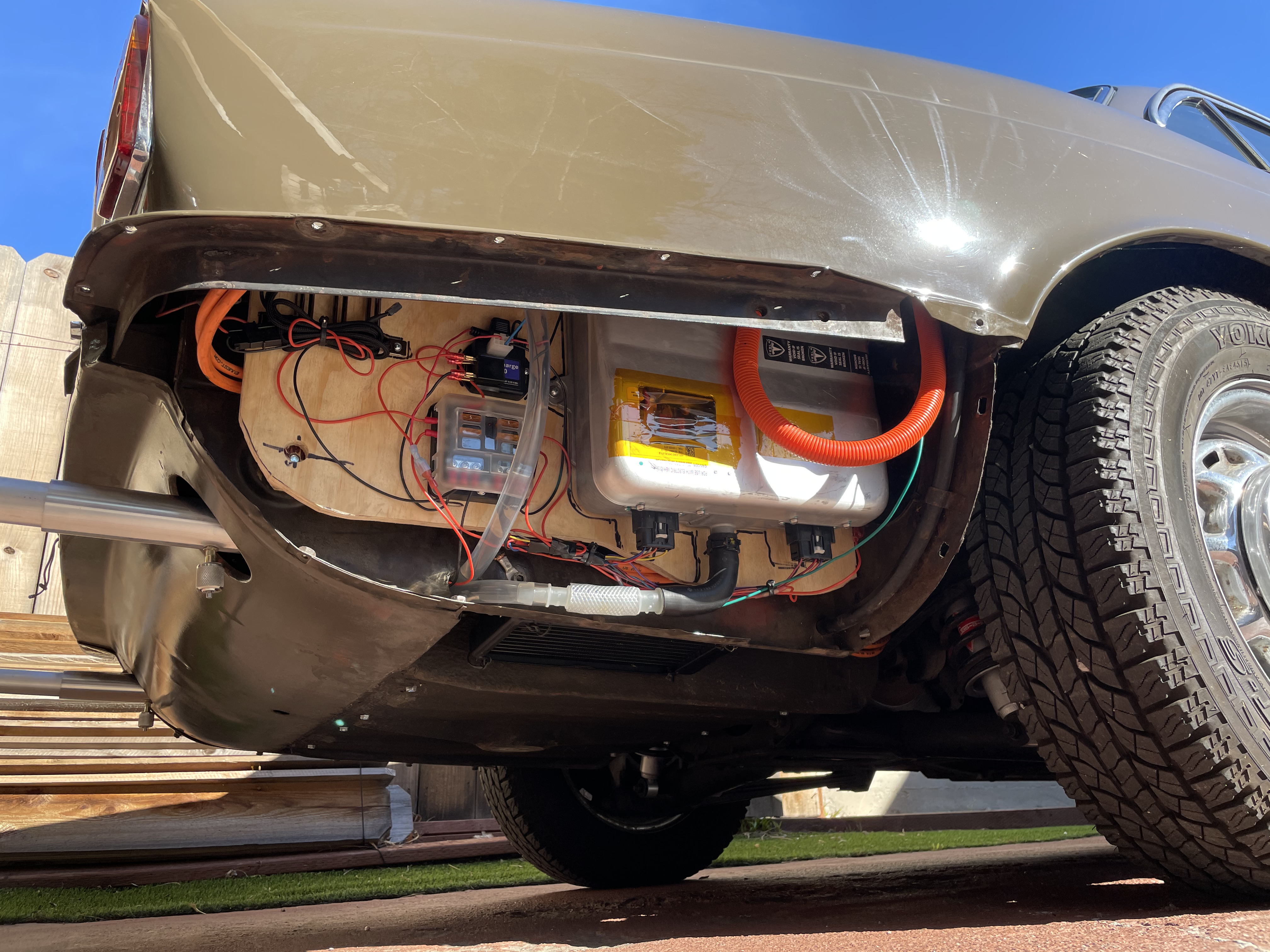

There are similar range issues with the wifi module buried under the LDU case. I use this in an enclosure with automesh. It functions transparently and I can connect 10' away from the car.

Here is a new firmware that should fix the low current limit.
- stm32_charger.zip
- (35.22 KiB) Downloaded 426 times

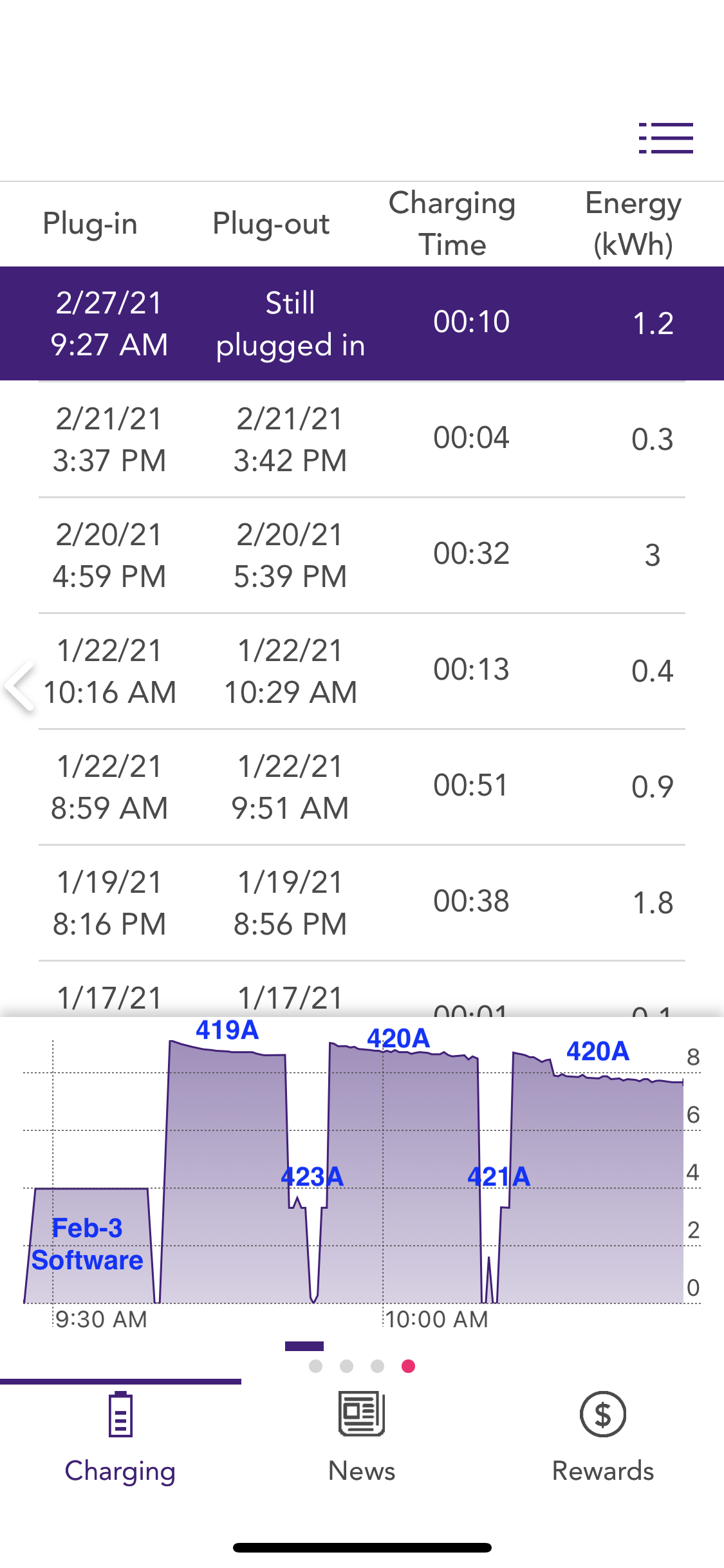

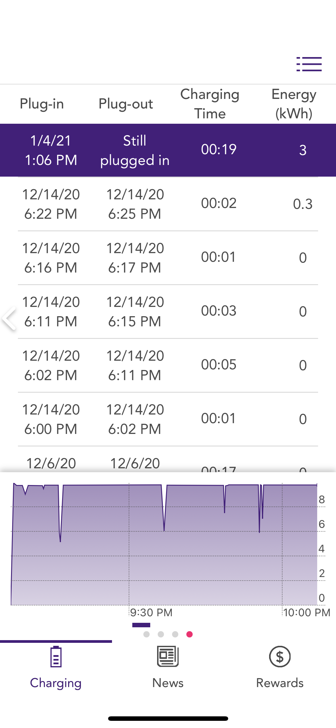

Well gents, I learned something this morning!
1. New firmware works great, thank you Johannes! I charged up to 37A, limited by constant voltage charge (EVSE does 39.4)
2. The Tesla charger doesn't like more than 420V set point. It looks like this may have been my issue. I played with different values and was able to quickly reproduce the cycling issue. I'd suggest limiting the max values at 420V instead of 430V based on this learning.
Note that this testing was done purposely in the constant voltage range of charging to attempt to trigger some of the high voltage cycling issues I've been seeing, nothing here is in the lower SOC constant current range.
Off to the office now...
* these should all be VOLTS not AMPS. Oops
Thanks! I guess I will make this the new version then. While also dropping max voltage to 420V.
