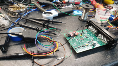

Little progress this morning. Re did the dma so the loop now looks at the dma transfer complete interrupt flag before pulling out data. Annnndd we get a sane temp value displayed on the interface. Tried in the E65 and the tacho is quite jumpy despite the mgs not spinning. Same result with throttle. Vibration from the gearbox but no rotation.
Ok definitely something funny happening here.

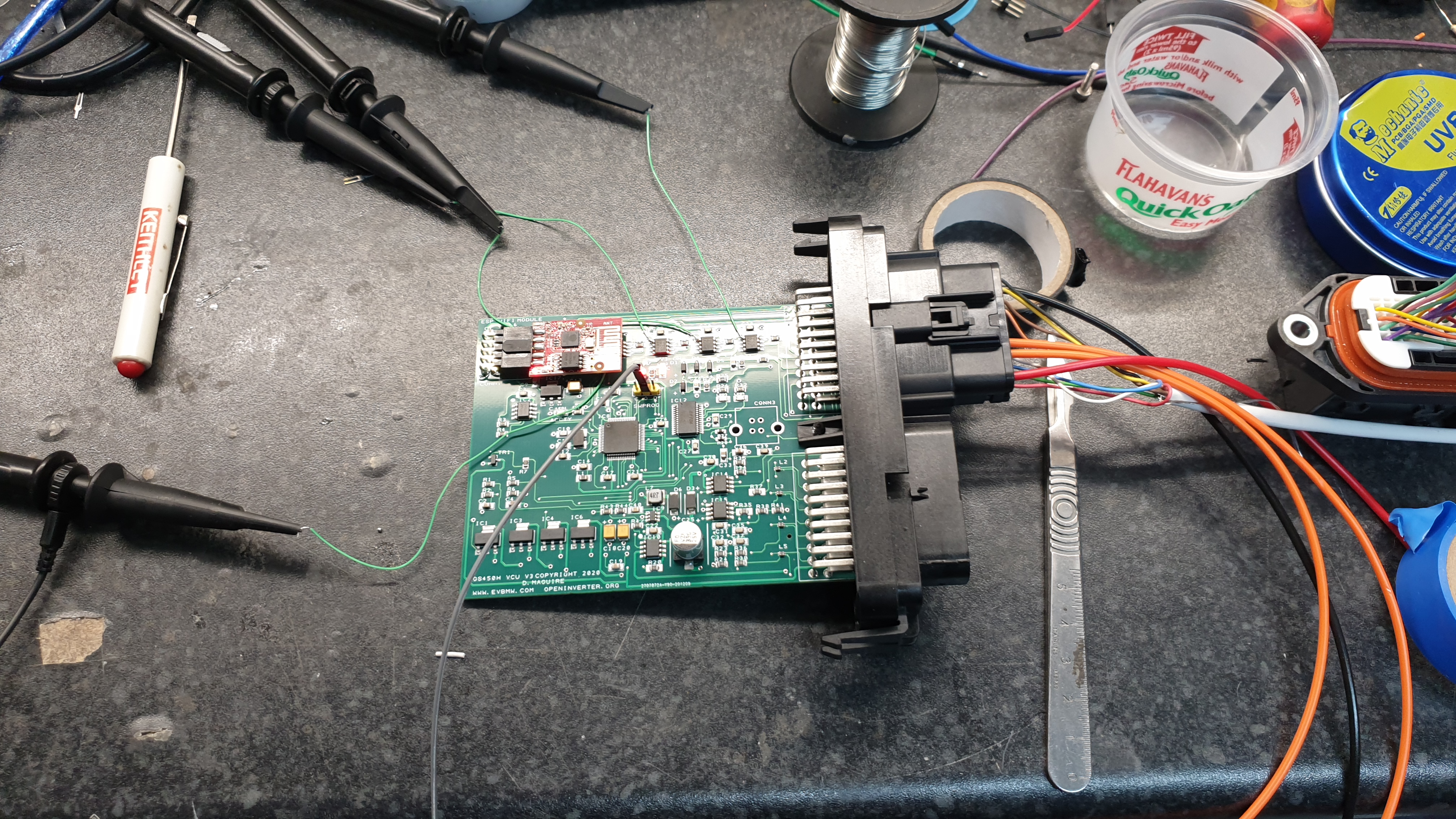

Ok so this is where I'm at with the gs450h control routine and I'm encountering a problem that so far I've not been able to solve. So , after being a world class idiot with the interrupt and dma priorities I have them working away properly and the nvic system seems happy. Now, DMA1 Channel 3 is used by usart3 receive for the wifi interface. it does not use interrupts. I am using DMA1 Channel 6 and 7 for transmitt and receive on usart 2 for talking to the gs450h inverter. If I don't use interrupts but manually check and clear the transfer complete interrupt flags (TCIF) on channels 6 and 7 all is well from the perepective of the wifi interface. Now, If I enable one or the other or both interrupts on channels 6 and 7 , even if the isr does nothing then we dont receive any data on usart3 from the wifi. All the interrupts work as far as I can tell and the micro runs away happy but won't see any data on Usart3 from wifi. DMA1 Channel 3 is set to max priority, Channels 6 and 7 to lowest, Interrupts on 6 and 7 set to low or high priority makes no difference. Its probably not stopping anything working from a gs450h point of view but would be nice to know why:)
Any way, here is my latest on the 450h routine. More tests tomorrow :

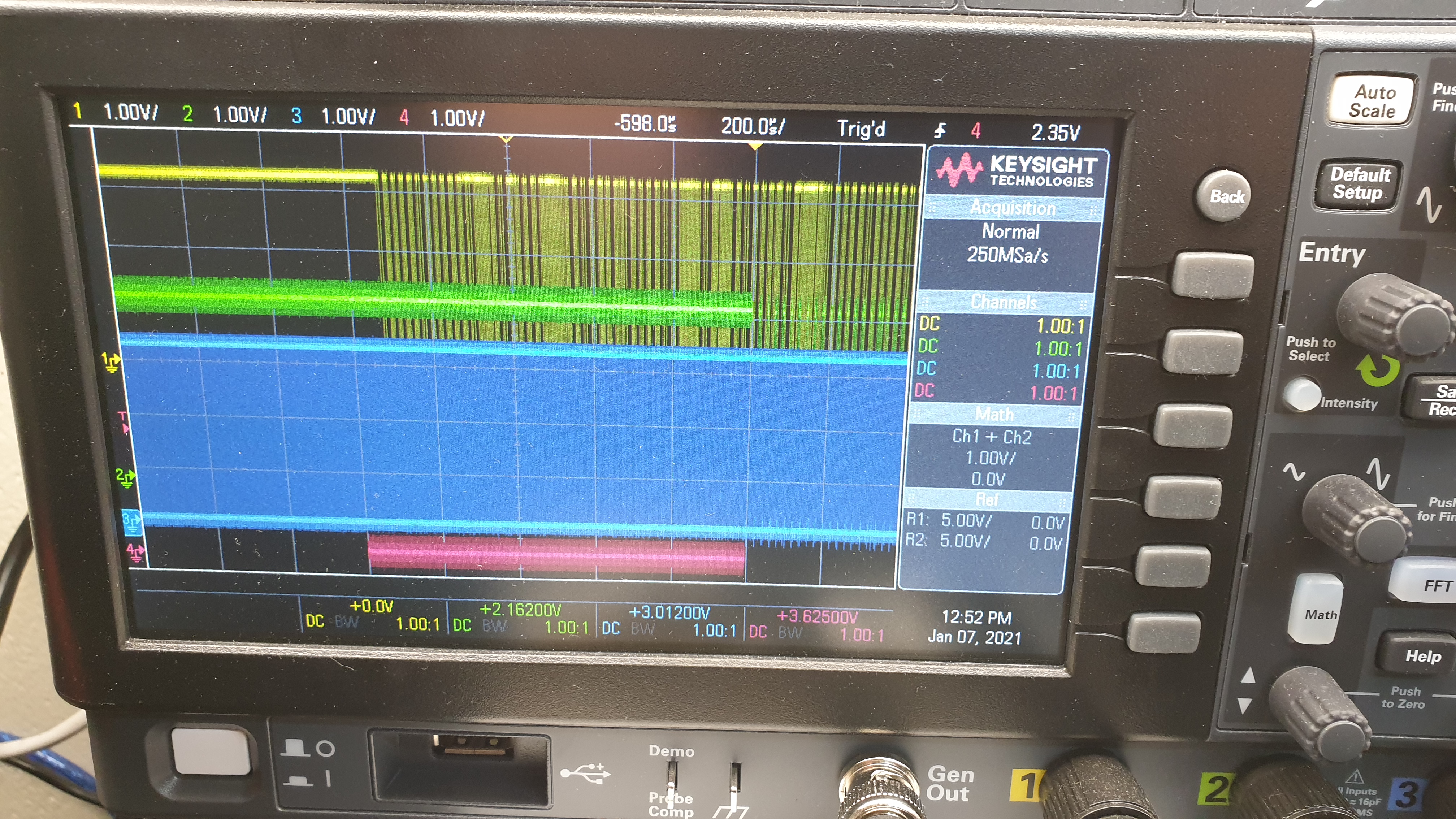

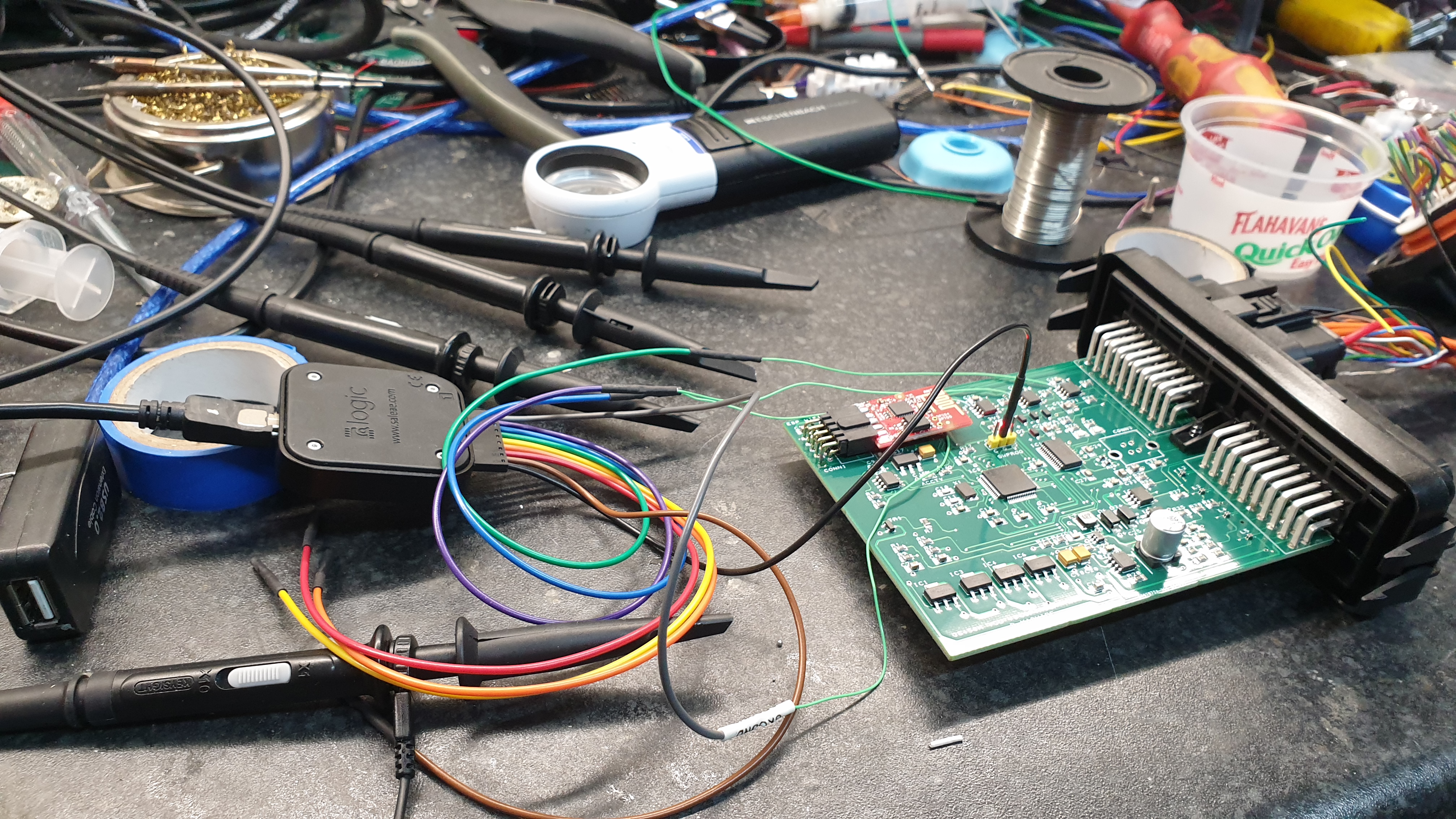

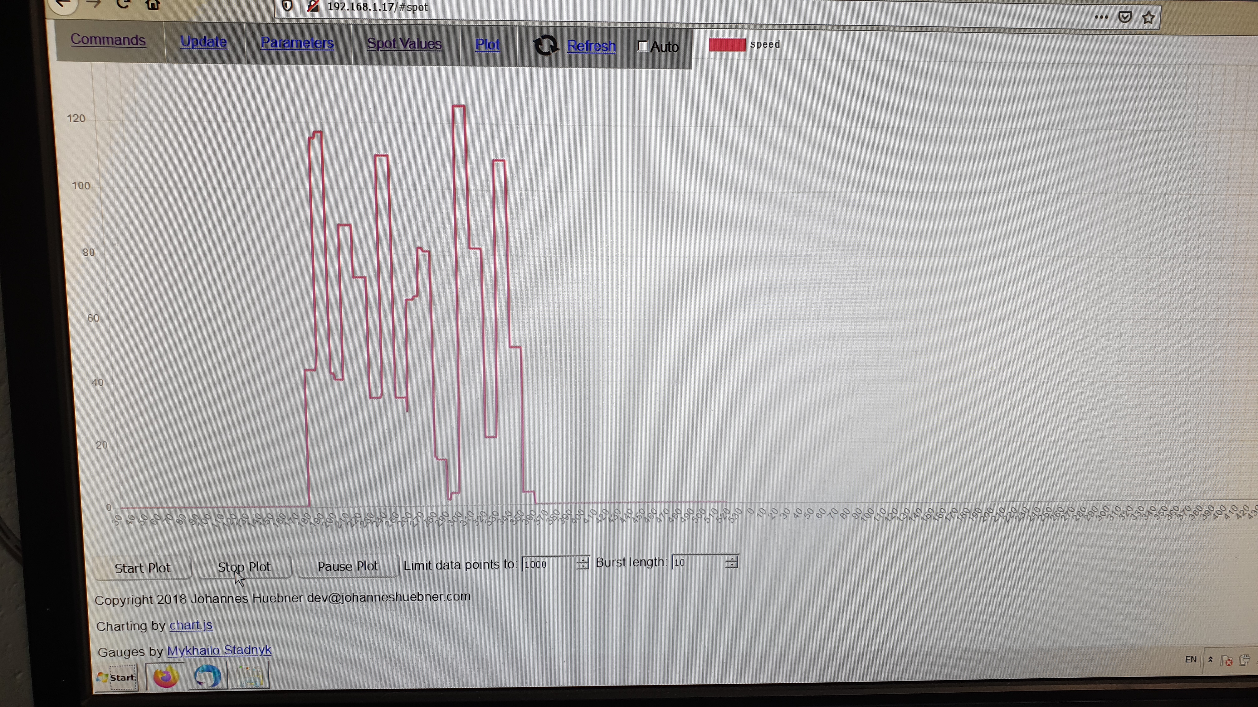

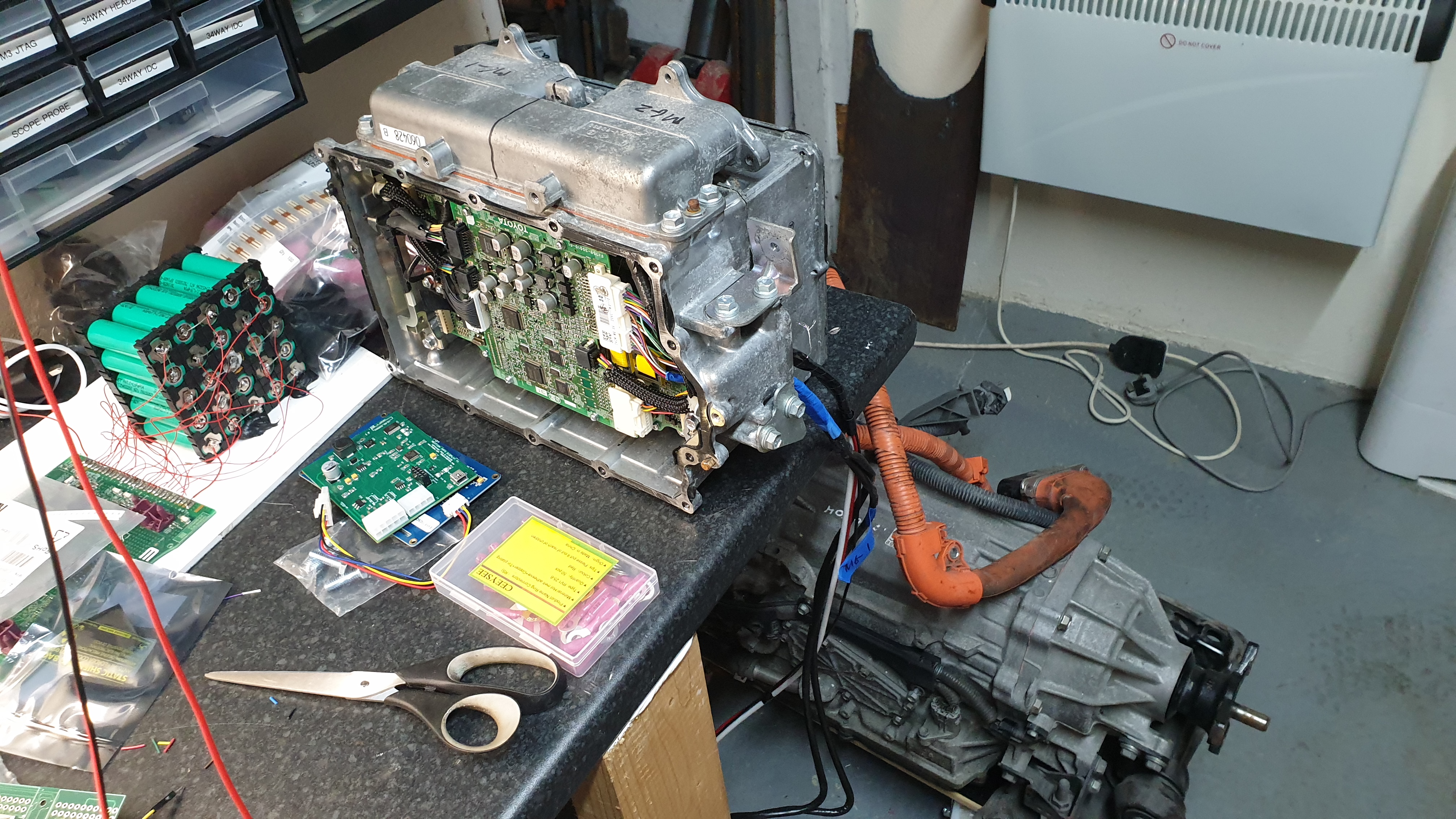

Ok sports fans we have some progress. Dug my second GS450H gearbox and inverter out of hibernation , undid the mods to the logic board that I had done during reverse engineering and wired up a bench setup.
1)At very low torque input it works perfectly. Output shaft spins nice and smoothly and we get steady speed feedback on the wifi.
2)Once torque demand is increased the motor becomes very jerky. Its almost like the inverter looses sync, resets, sees a torque demand, pumps power into the motor then trips out. rinse and repeat.
3)Tested on 30v 2 amps psu, 60v 5amp psu and 160v battery. All the same.
4)Connected up my Saleae logic and did 3 captures : idle, smooth slow running and faster rough running. Attached in the zip.
Going to see If I can spot anything in the analyser captures.

Ok I have an idea of what's going on. Pouring over the analyser data shows that in idle we are spitting out the standard htmdata frame correctly, in slow and easy we are sending a correct torque request to mg2 but none to mg1 for some reason. In higher throttle setting we are wrapping around numbers and making a mess of the data. I wonder is this a result of using dma. It is a 32 bit micro so I wonder is it treating the data like that in memory and then dumping what it thinks is correct out to the usart. Or it could be a Damien moment.........
