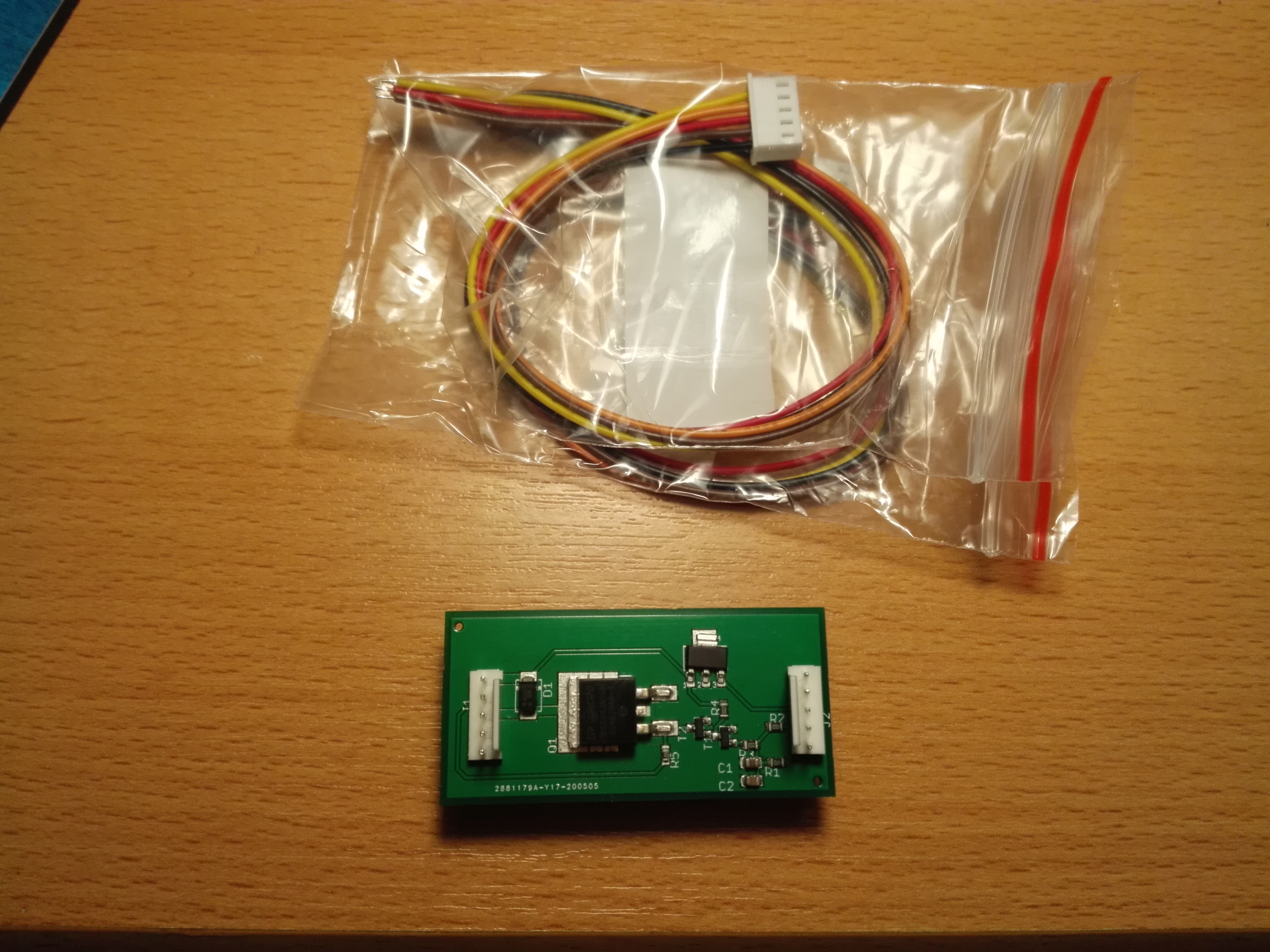

Just got the switch from Johannes. It works great, however, for my Saab 93 I need at least -65 to -75 kPa pressure, the board switches the pump off at -45 pKa.
Quesiton: how can I modify (by replacing a component) the board so it will switch of at a lower pressure?

Re: Hardware threshold switch for brake vacuum pump
try replacing R1 with a larger value, like 10k or so.
I tried various resistor values and found that 15 k gives -5 kPa pressure (cutt-off). Max pump pressure is -80 kPa so close enough.

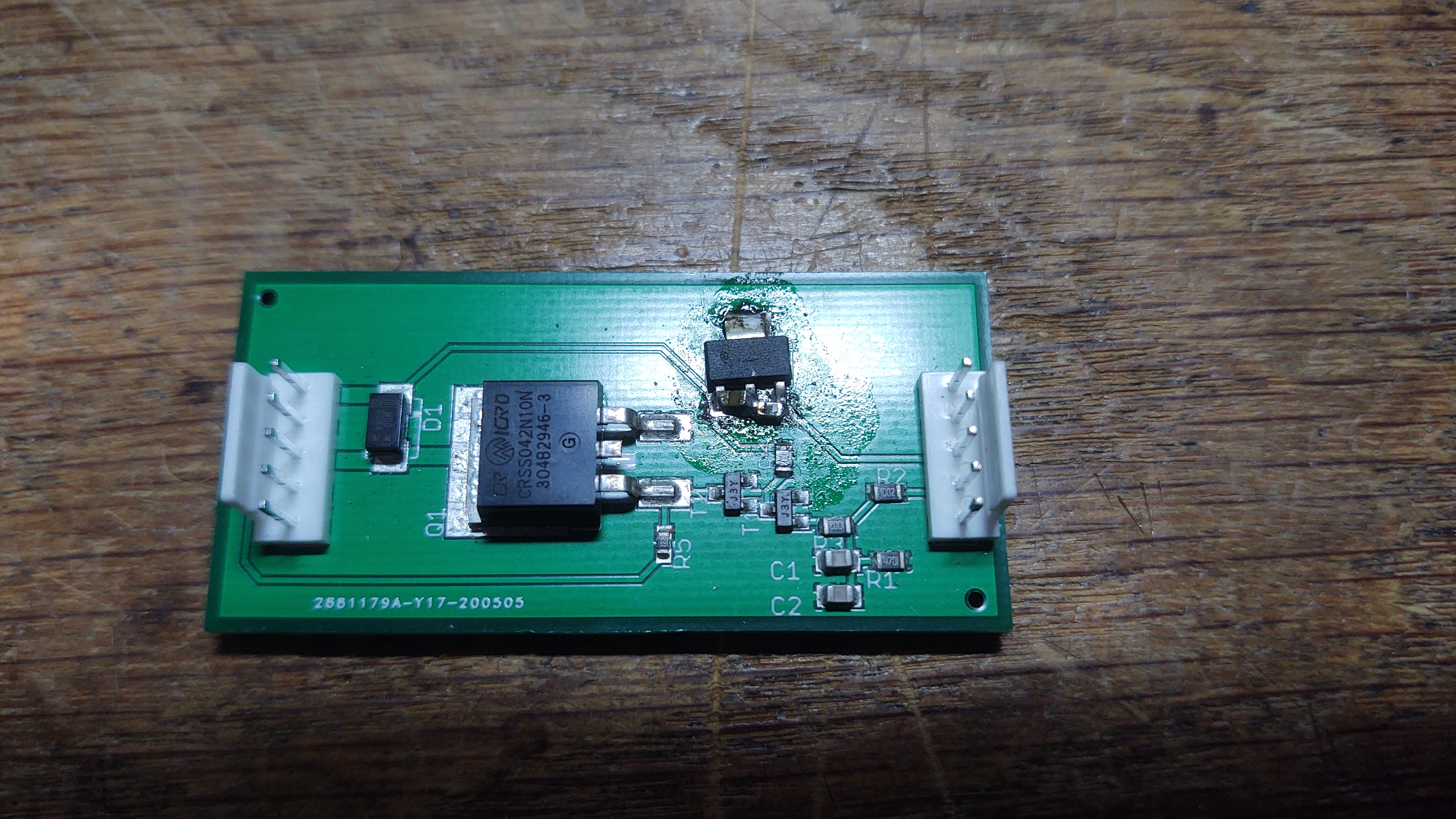

I've been sitting on this for a few months now but finally got round to replacing the voltage regulator and caps so hopefully it will be OK.
I haven't tested it yet and it ain't pretty but no shorts.
Apart from the terrible soldering does this look OK?
- Been thanked: 1913 times
Should do. Meanwhile I added a 16V TVS diode across the 12V input to protect the regulator. You might want to do that.

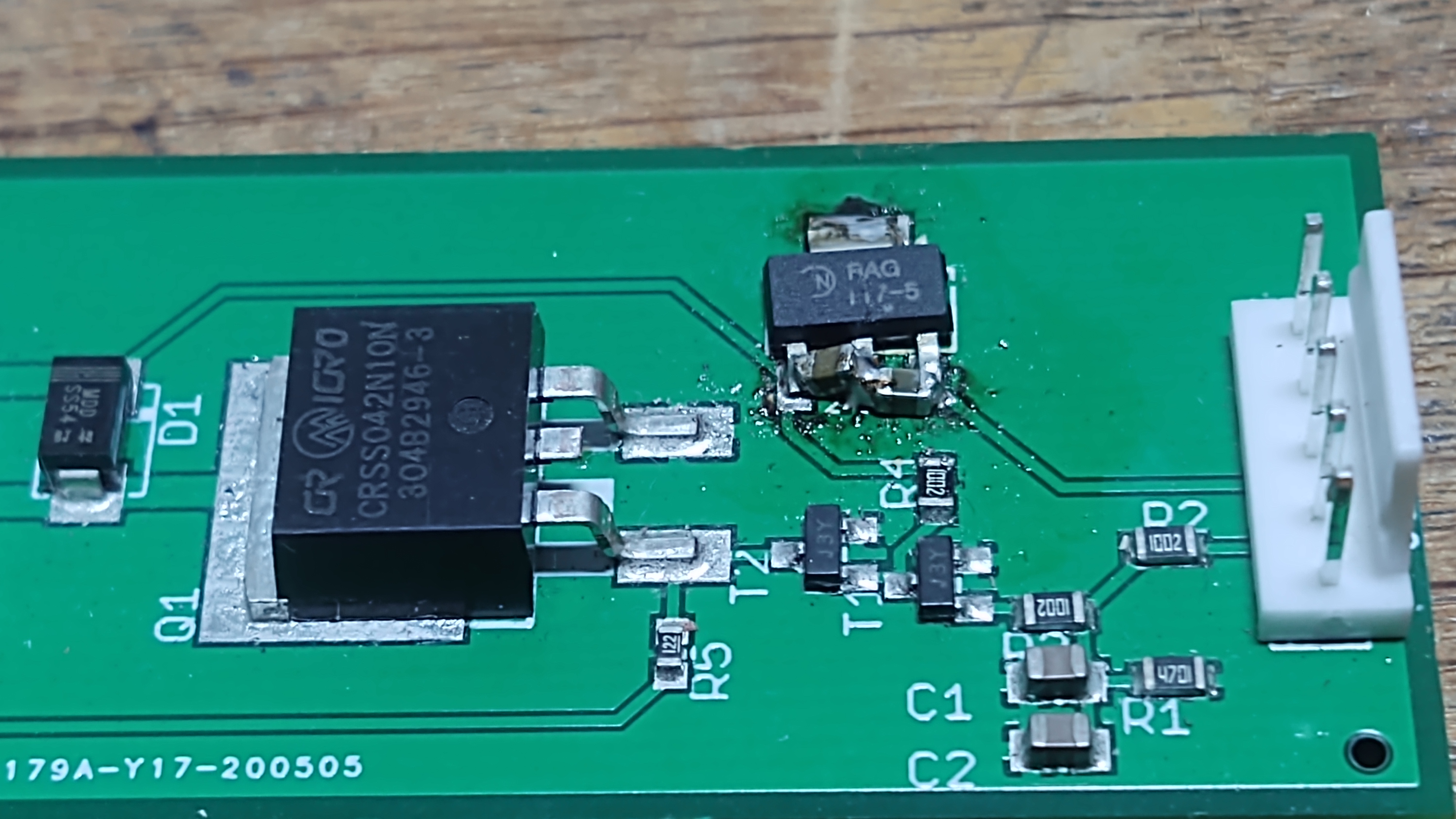

I'm having a few issues with the voltage regulator I installed as in I've replaced it a couple of times and it keeps going pop.
The component I ended up ordering was RAG117-5 as it came up as compatible but I can't find any info for it so I don't know if it is the correct part or not but suspect the pinouts are not correct.
After a bit more checking I'm even more confused though as all the voltage regulators I found when searching for NCP1117-5.0 (Replacment part suggested by Johu) have pin 1 as Gnd, pin 2 as output and pin 3 as input, and as far as I can see reading the circuit Johu has pin 1 - input, pin 2 is ground and pin 3 is output.
Can someone please advise where I'm going wrong.

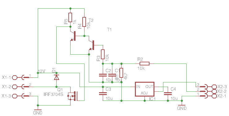

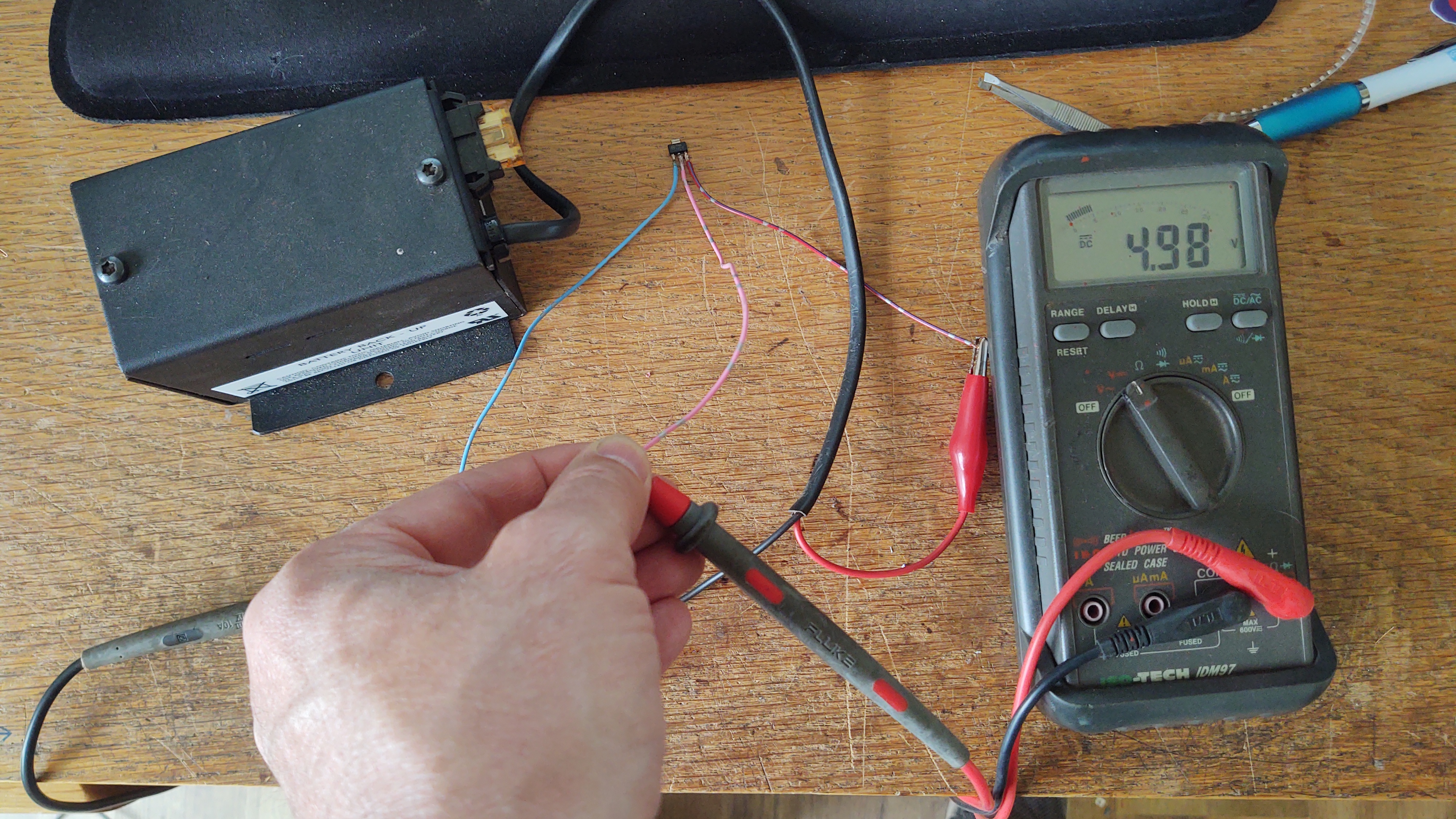

So I've confirmed something but still very confused.
When buying the voltage regulators I bought 10 as they were cheap, so to confirm the pinouts I soldered wires to a spare one and applied 12V to see what would happen. When I connected it as below I got a steady 5V
So if this is correct then I must be reading the circuit diagram on page one wrong because I cannot see how this component would work in the circuit.
Can someone please advise where I am going wrong. I even thought about making my own 5V supply for the sensor but am unsure how this would affect things.

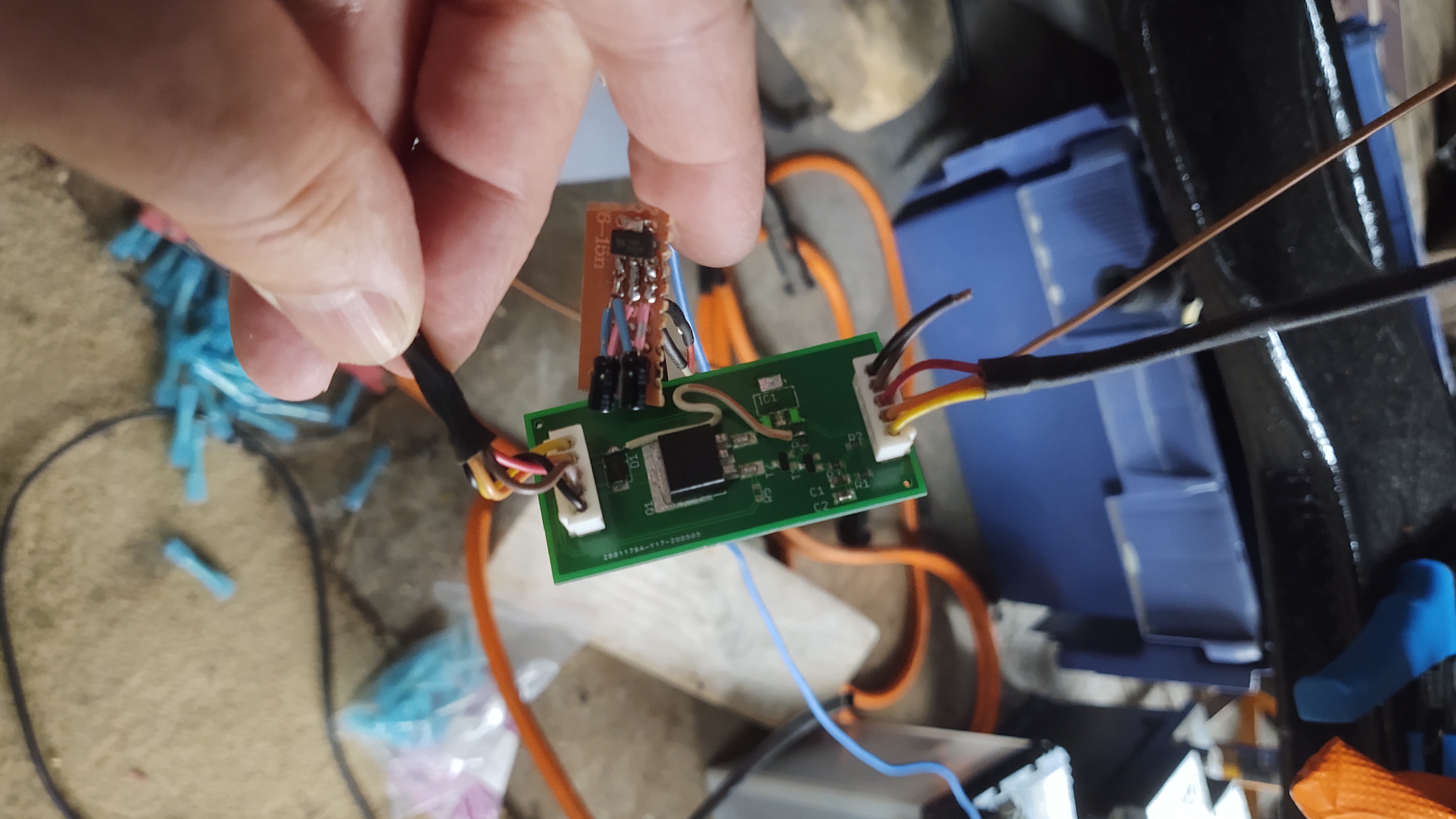

So to see what would happen I decided to make a small daughter board for the 5V regulator and 2 caps and solder it in with the pins going where I think they should.
If you look carefully you can also see where I messed up the board by replacing the voltage regulator too many times and had to use a link wire.
And the good news is it now works. The bad news is I'm still confused about the circuit.
the worse news is I only get one press of the brake before the pump starts again.
I'm using a very small lead acid battery so that may be the reason or maybe I need to reconnect the vac hoses differently but the main thing is it works.
Seems you have the version without the TVS for protecting the regulator.
Otherwise the PCB design has pin 1 as GND, pin 2 (and the tab) as output and pin 3 as input.
Schwellwertschalter.pdf- (10.59 KiB) Downloaded 204 times
Alibro
- Posts: 1108
- Location: Northern Ireland
- Has thanked: 503 times
- Been thanked: 321 times
I think I got version 1.0
I was trying to get it working before putting the TVS diode in.
This is the same as mine.
Unless I'm not seeing it properly, in this PCB pin 1 is 12V, pin 2 is ground and pin 3 is output?
