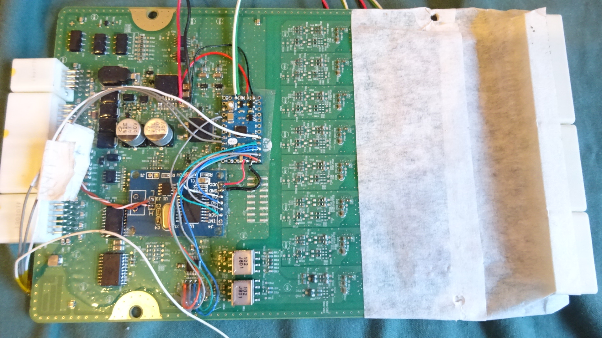

Success! i can see the voltages on some cells but then it seems to crash soon after.
There is a cell reading zero in the middle so i assume that as this is also sometimes used as a 72 cell bms in other models the one they didnt use was the middle cell?
good to see some data starting to come through :-)
Attached log
Edit: got the crashing under control, was a just a hardware issue with the int pin, seems to read consistently and updates. :D
error.txt
(3.97 KiB) Downloaded 844 times

I think the cells are connected in the same manner as the PHEV-bms, i.e. pos 1-4 and 6-9 and not pos 1-8 for each chip.
That means you need to roll back some of the early changes.

This is a bit strange and I suspect some hardware issue.
Have you checked the cell connections (wiring) for cell no 8 for all modules (max17823)?
Please also verify with a multimeter that the cell voltages are infact close to 3,68V / cell, for those no 8 cells?

I tested the BMS using Torque and an ELM Bluetooth adaptor before i began and it showed all cells and they were all 3.6 range,
I just checked the individual cells on the input connector with a meter and they all seem fine end each module is outputting 58v on the bus bar.
If it was a fault in the CMU would that not be one whole horizontal row not the end cut of each one?
Could it be that the top cell is being read by something higher than 9? it does have 12 channels on each chip
The only thing i don't have per your schematic is the SHDN pin connected to the atmega and is just pulled high.

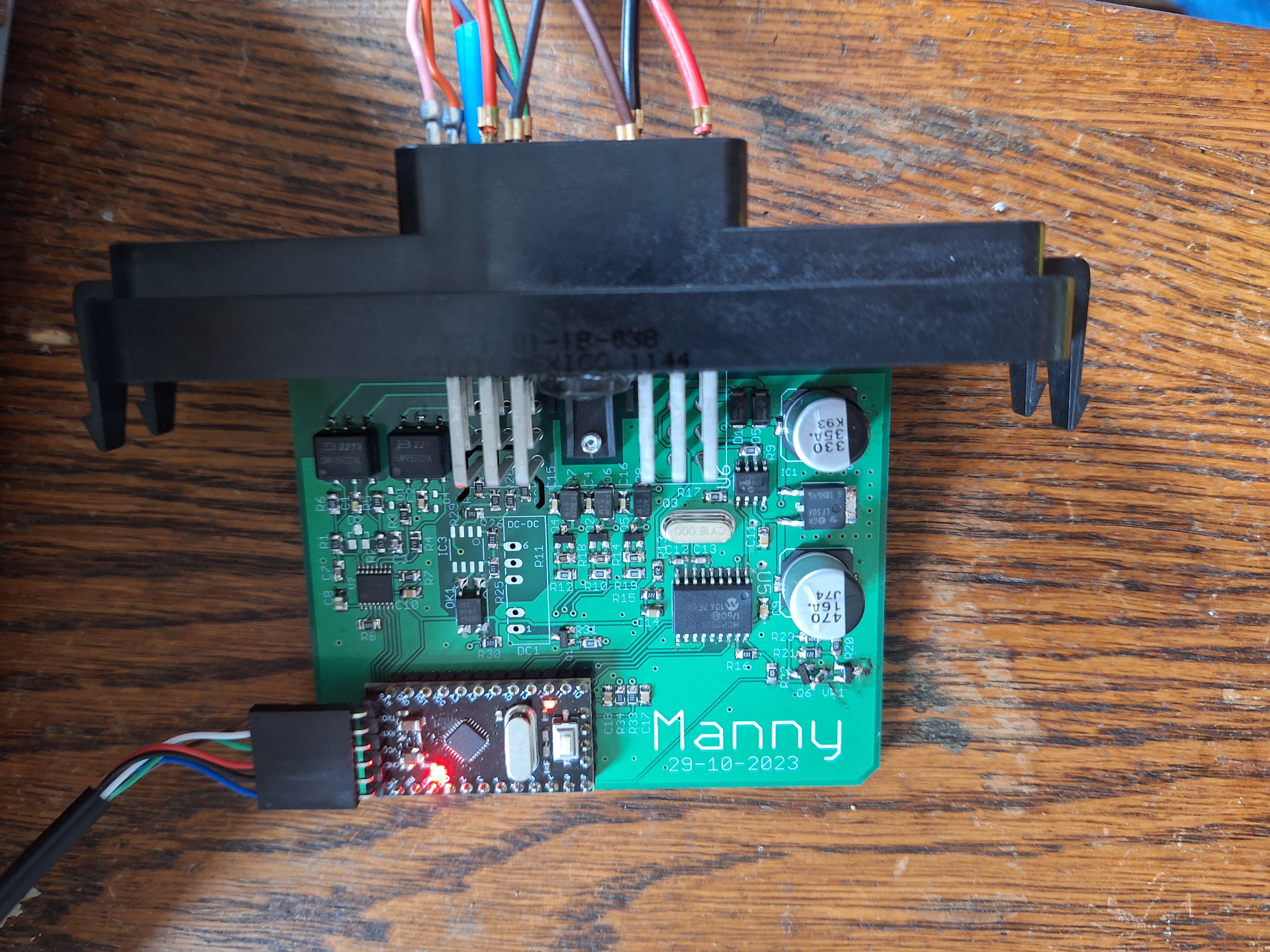

First of all great work on this code!
Very happy I can reuse the bms slave modules
I have a complete e208 pack. So i needed to change the code.
The e208 pack consists of 18 modules with 6 cells each.
Got the original code and the latest code posted. I used notepad++ to make a diff. To be able to find all the changes made.
To make the code less hard coded I adding a couple of variables
  • numberOfModules
  • numberOfCellsPerModule
  • Message_length
Got it working with my modules (3 at the moment).
Not sure that i got all the hard coded bits.
The split in cell layout in the original code is hard to code for, so I removed it
Also made a board to fit in a waterproof housing
The DC DC converter and attiny are missing but on their way.
BMS2_7_4.ino
(50.27 KiB) Downloaded 812 times

tidy setup, do you have contactor control on that board? I think this will need to be changed to reflect the number of modules and whether they are series / parallel
if((batteryVoltage > 300) && (compareVoltage > batteryVoltage) && (millis() - lastMillisContactor > 500))
I also found a thread on here where someone had done a similar thing to this code, it might be worth having a look, search for "MAX_Teensy_1.2"
Im interfacing with an all in one BMS with the CMUs onboard, using as much existing hardware as possible.
I realised my current sensor is only a single sensor not with high and low, and also I need an additional contactor and economizer control as well as a canbus signal from the inverter to determine voltage, so im trying to work out what I need to change in the code.
