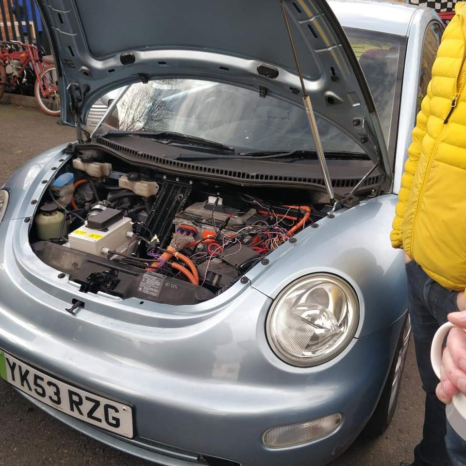

Re: VW - Beetle 2003
Posted: Sat Feb 12, 2022 9:19 pm
by Bigpie
Took the car to an EV meet, with bobby_come_lately, we got a charge from an 800v EV6.
Fair to say the 2 conversions there got a fair bit of attention.
https://yorkshireevclub.co.uk/
