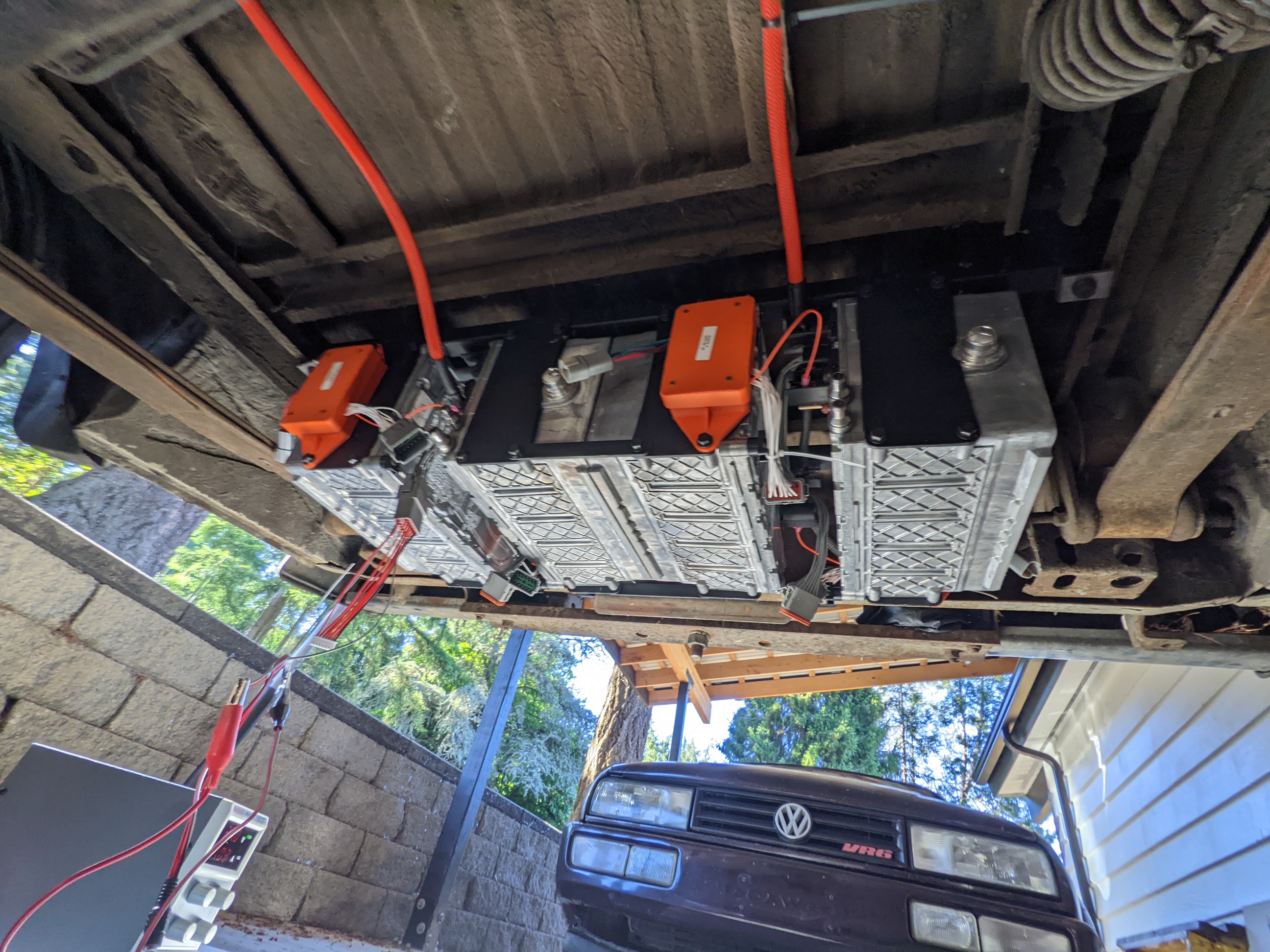

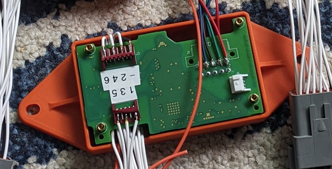

Well it fits nicely on the battery. Now just need to finish soldering on up and test it on the first module.

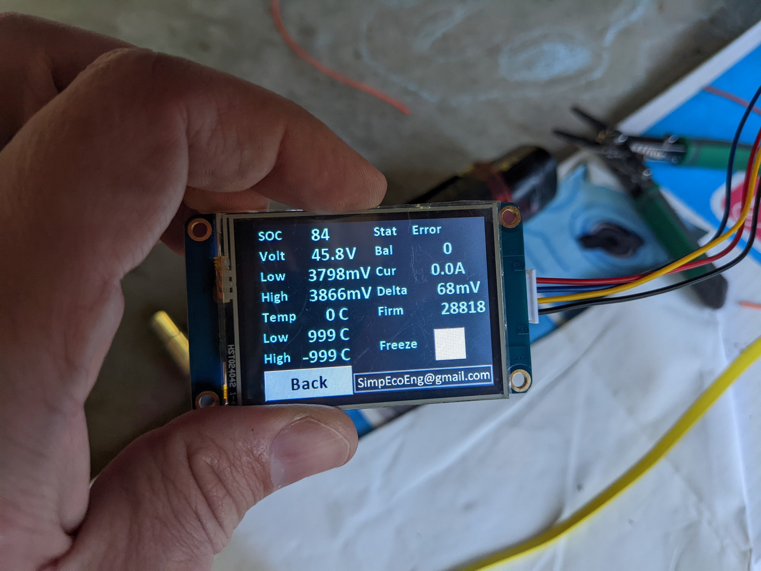

I got one 12s module hooked up with 2 Model S bms boards. The error was set because I had the series cell count wrong in the SimpBMS settings.
Now to make a larger wiring harness.

I agree!, though it's been a lot of work getting all battery modifications, soldering, and wring done.
If I was using a SimpBMS supported charger and batteries, I would be in a cleaner situation but for a lot more $$. But, I now have more custom work to integrate the cheap Gen 2 Volt charger.
For now i've left out temperature sensing, since I really don't plan on stressing these batteries. I may go ahead and wire one of the built in thermistors, then play with the Steinhart-Hart equation in the code to get them reading correctly.
Baby steps, i say.

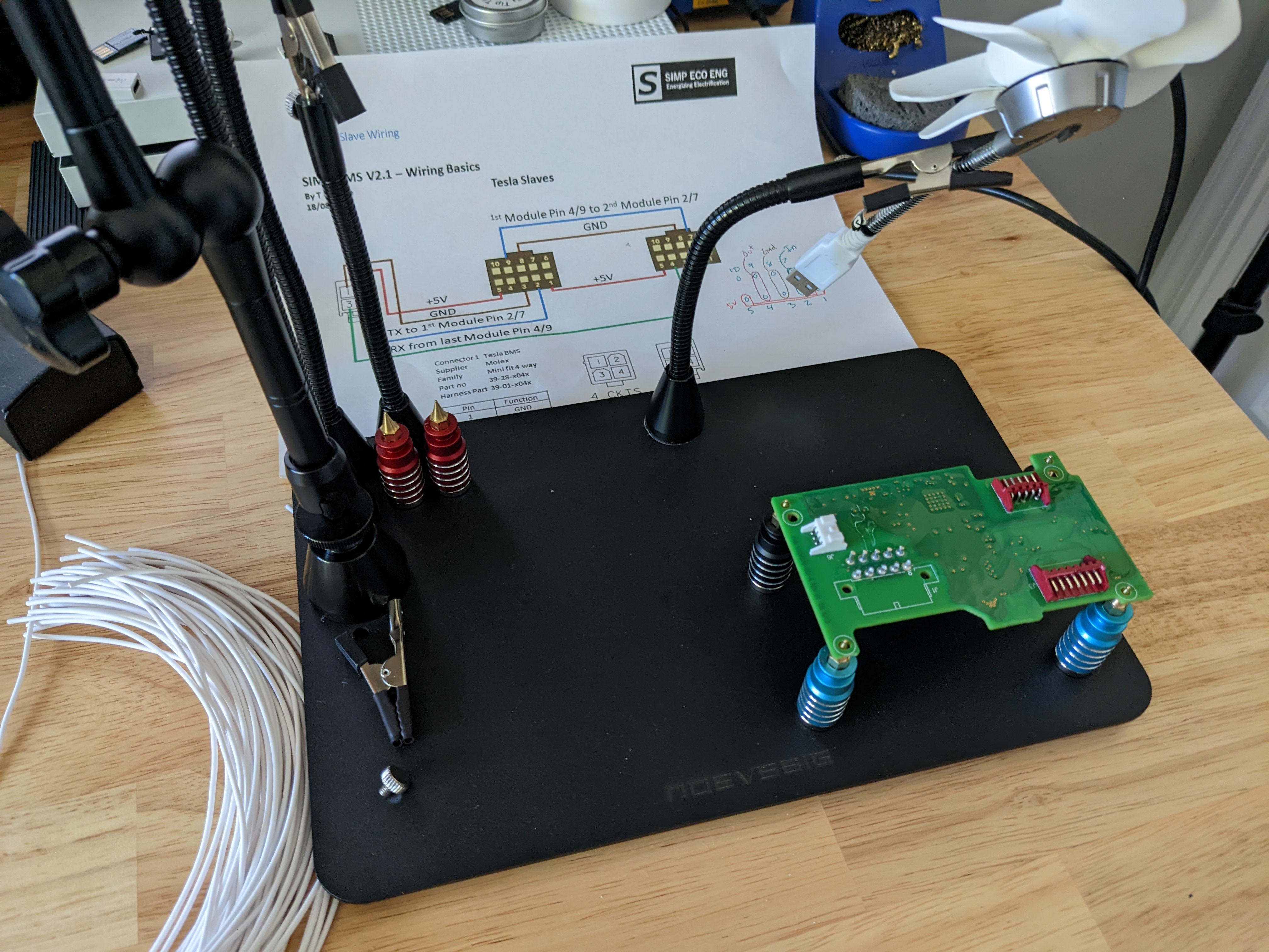

Adding some detail about connecting to the model s/x secondary boards.
Tesla uses a board-to-board JST JL connector (pdf attached) for the cell taps on these gen 3 boards, which means simply buying the connector and wiring it up yourself isn't really a thing. Tesla does this by using a ribbon cable to a small flying PCB with the mating connector mounted to it. I guess you could make small PCBs for the connector then connect to that PCB, but that's a lot of work to make a connection. you could also potentially cram some same-pitch connector in there, but it will require cutting.
A lot of times im attempting to do something that's actually contrary to my goals
. in this case I stopped trying to source connectors and just jumped straight to cutting and soldering 176joints. This makes the most sense because it's free, and I don't need a connector in this location at all - in fact it's kind of a bad idea considering my implementation; connector to wire to connector to wire to cell all within 10" makes no sense.
my soldering setup which made this relatively easy.
final product:
final product:
eJL.pdf- (160.9 KiB) Downloaded 376 times

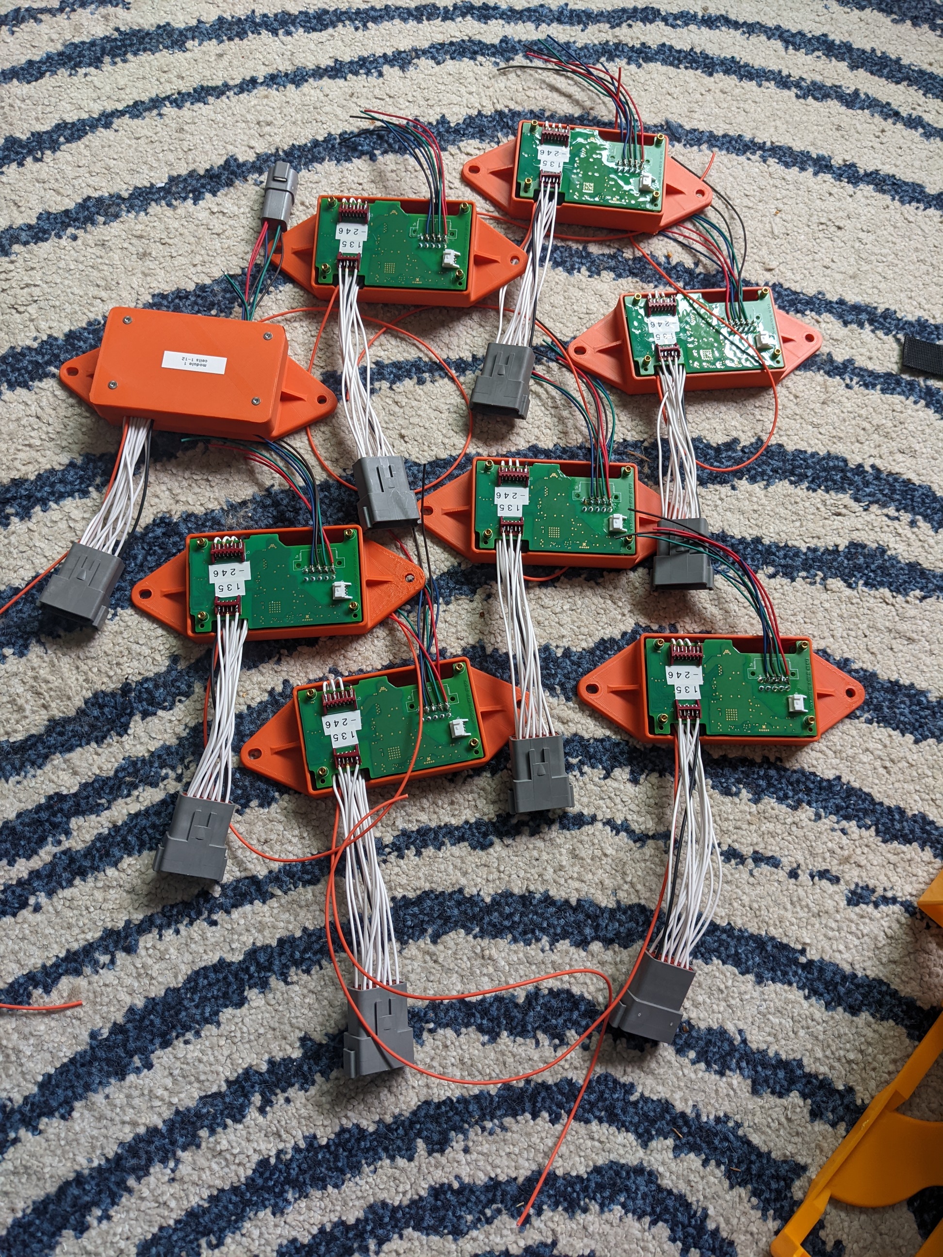

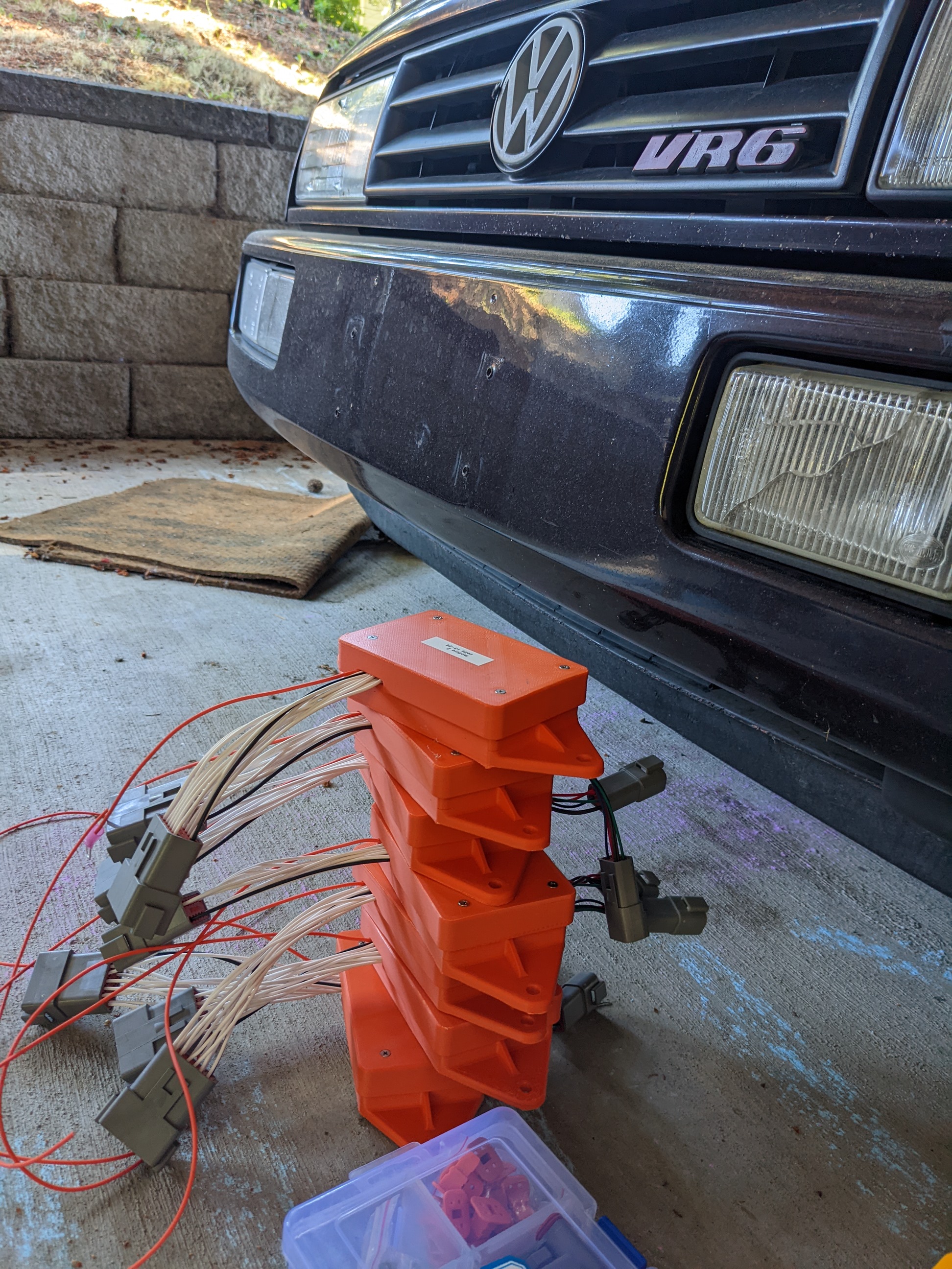

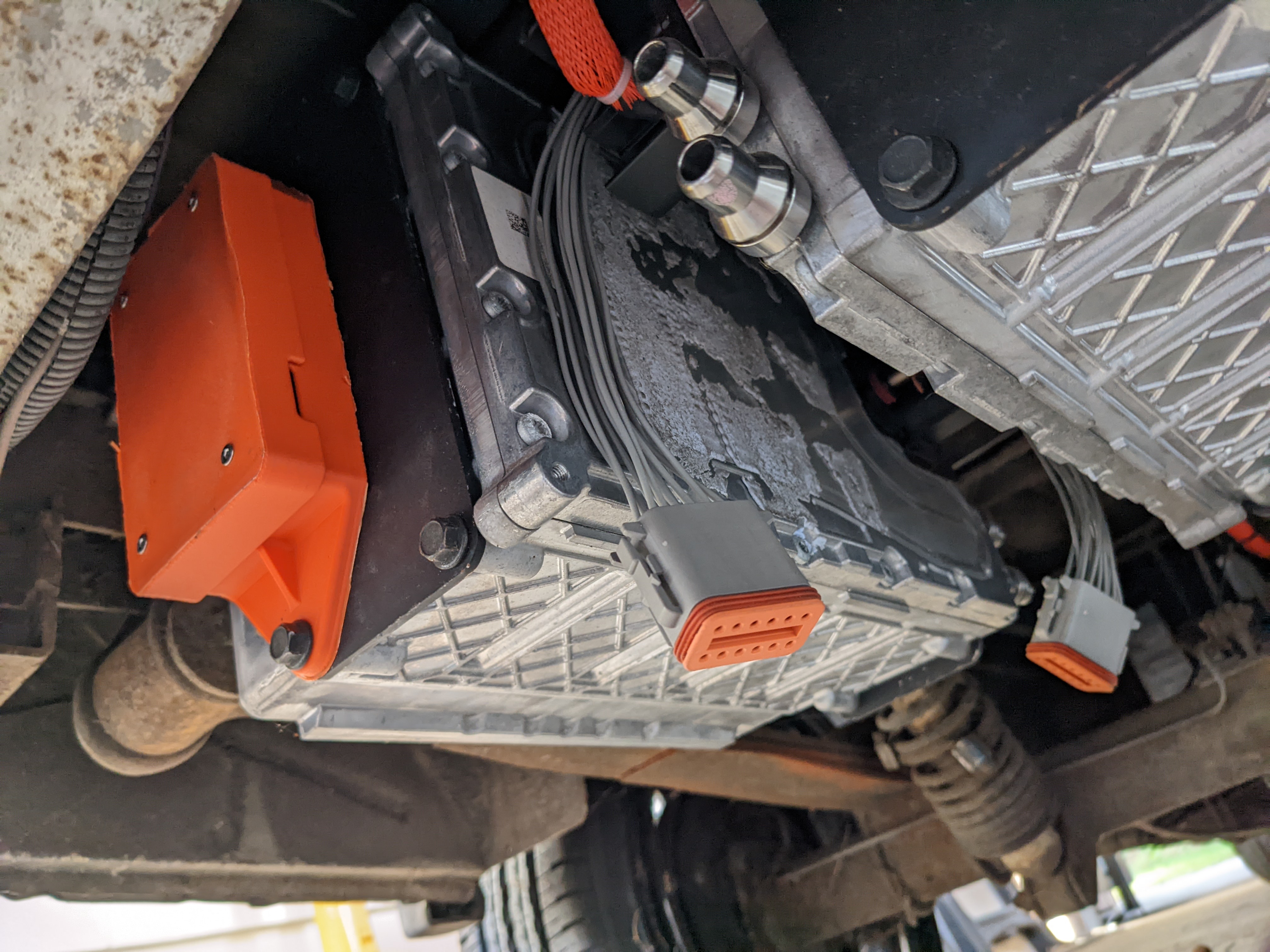

BMS boards mounted and cell taps connected. Next is power and comm harness. Im currently top balancing all the cells so i'll need to get this thing out on the road soon and burn off some energy to empty the battery a bit and so i can start testing charging.
reminder: 8x Mercedes 12s 875Wh hybrid modules. 2x Model S BMS boards on each.

I wish the SimpBMS had a screen that showed individual cell values. I may try to create one. would be nice to actually see a histogram and voltage of all 96 cells like LeafSpy does.

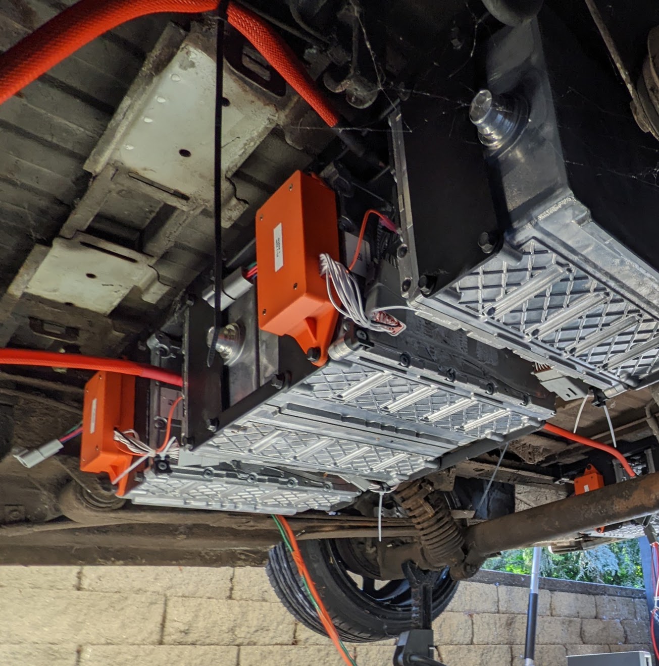

Been doing some shake-down drives in the Cadd-E. Need to burn some energy out of the pack so I can start testing the charge system.

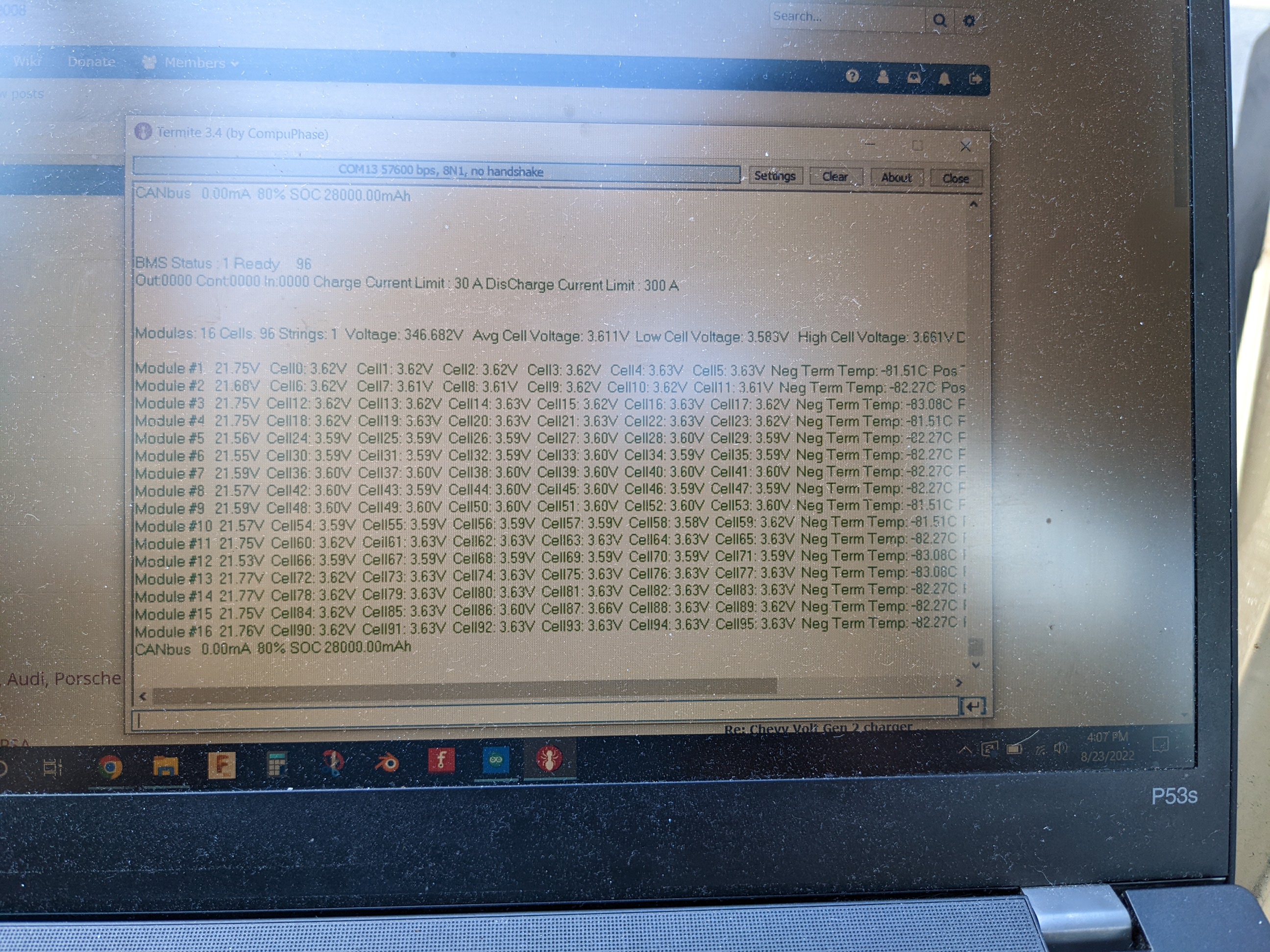

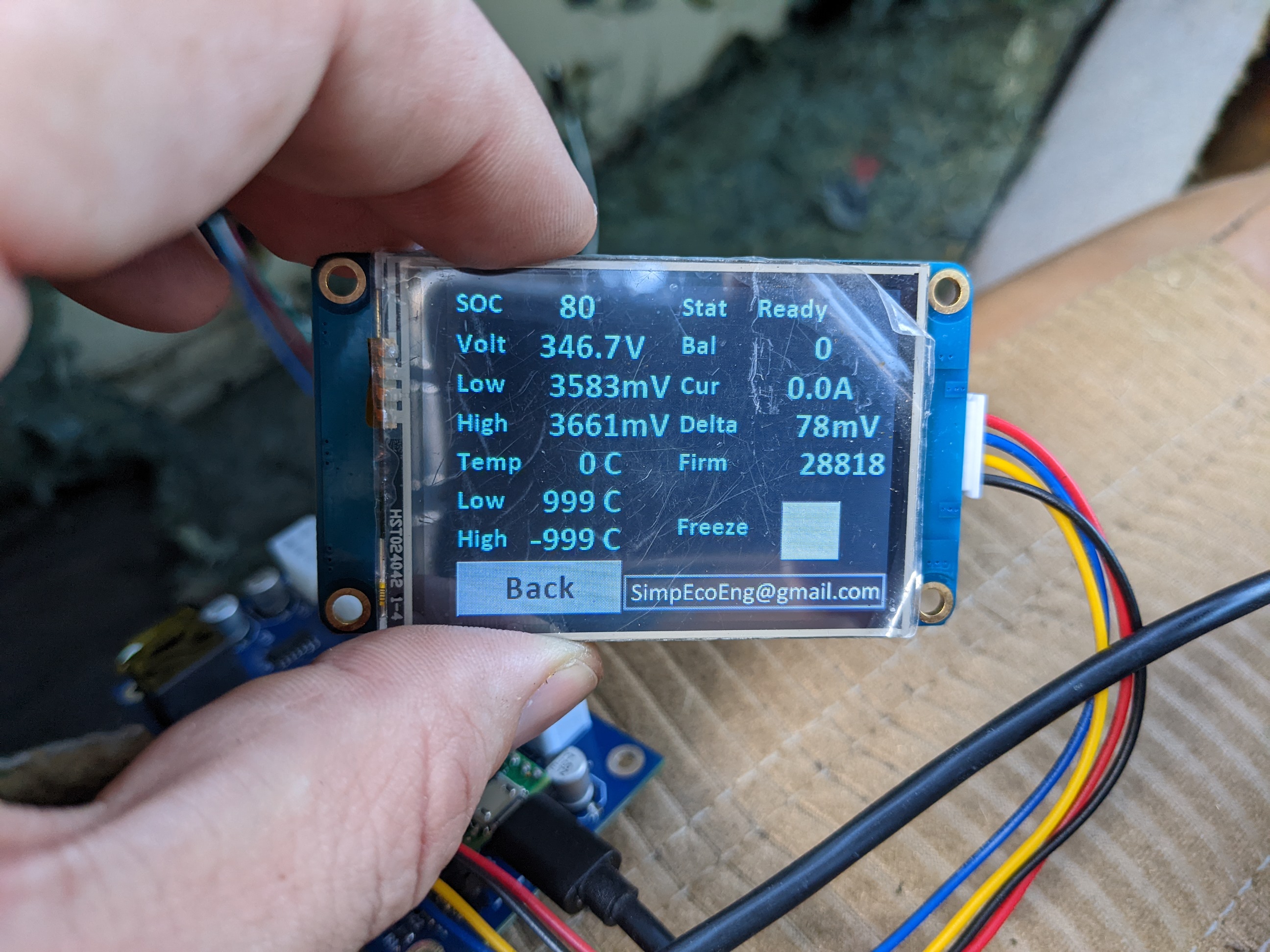

Re: Project VW Cadd-E, Leaf/Volt/Mercedes + Mk1 VW
We have BMS success!
After frustratingly replacing 2 tesla module boards, it's all working
now to get a current sensor input so i can actually count Wh
BMS notes:
Using 16 model S/X module BMS boards was actually kind of a lot of work. I would say it's only something you should consider if you need a battery form factor that you can't get with a compatible BMS. I'll say this was my case to make myself feel better
Here is a summary of the work required:
Batt side: cut out all native BMS content, design and order busbars, sand each cell tab so I could solder a cell tap, then add a 12p connector (leaving main + for a ring terminal). This added up to about 12 hours of my free time over many months.
BMS side: find and order 16 model S/X boards from a source that doesn't want insane money for them. my V3 boards had the weird JST board to board connectors so I went ahead and cut all those off - which caused a blister on my hand!. then cut 4+7x16 = 176wires, strip them, set up a soldering station and add all wires to the BMS boards. Then design and print 3d enclosures for 2x boards for each 12s batt module. add 12p connector to battery cells and HOPE you connected everything correctly. In my case I had a 2 boards that were just not right. one wasn't communicating at all, and the other was reading a cell 700mV low! All this was easily 20-30hours of work.
Finally after running RX/TX and power wires to each module I was "done". Still need to integrate my charger somehow.
I have another 8 of these batteries, so would I do it again? ... maybe.
