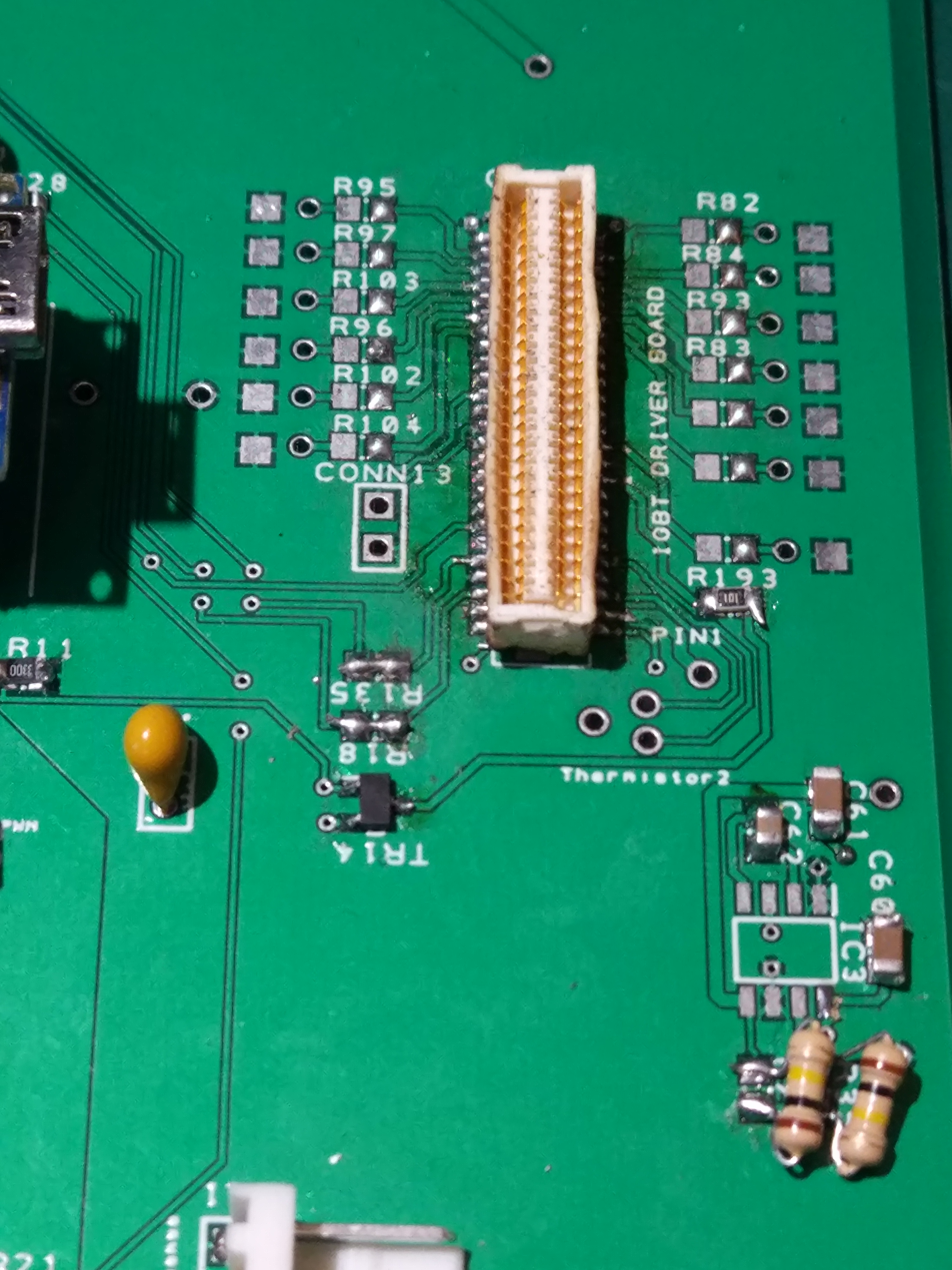

@Celeron55
Hi, i finally found time to assemble my Prius Gen3 charger board. Now i am working on charger Arduino code. It is really simple dual comparator with PID code. Prius voltage and current signals work really adaptive and are universal in respect to other 5V uC.
Please mind the schorched connector it was salvaged from Prius main board.
However a have some doubts about hardware. Can you tell me how did you manage to connect battery across AC power? What I mean to ask did you have to actuate any of the other transistors or did you just keep them off?
Next question i have is, how exactly should i keep rest of transistors off? Do i feed them 5V through the pullup or do i just leave them floating?
Does driver board have its own pullups?
I am still deciding which current sensor to use. I have Melexis sensors and boards, but i would need very accurate setting for mV per A. I am not sure if i can et repeatable results with usual chip placement. I would need signal full swing up to 100A. Alternative is Tamura 200A hall sensor which is bulkier.
Johannes, your opinion on melexis sensor placement and its accuracy? I havent used them before.
