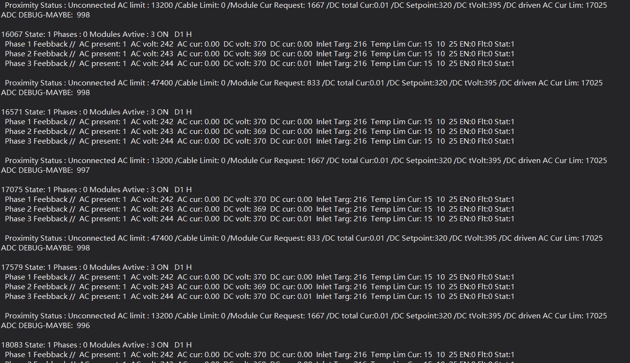

Progress made. It turns out my prox input put wasnt fully seated in the molex connector. Once my oversight was fixed, we now have the J1772 connection state properly working.
Ive now run into another issue. My evse will click the AC voltage on as shown in the debug screen, but it will not command any current. There is also a toggling going on with the AC cur limit values. Need to look into that further. Any ideas there?
Video in action.

Screen grab of the latest plug in.
Posts: 3563
Been thanked: 87 times
Re: Gen 2 Charger V5 Software Development Thread
You the man Jon:) I had not gotten any further then the prox detect problem but I see there your cable limit is 0 that is why its not drawing any current. It's not setup to calc the cable limit from the new values from the adc I would guess.

jon volk wrote: Sat Apr 25, 2020 2:00 pm Screen grab of the latest plug in.
That looks good to me the current request is what is shown in the debug. so it should be asking for 4444mA ac current into the phases.
What is your configuration?

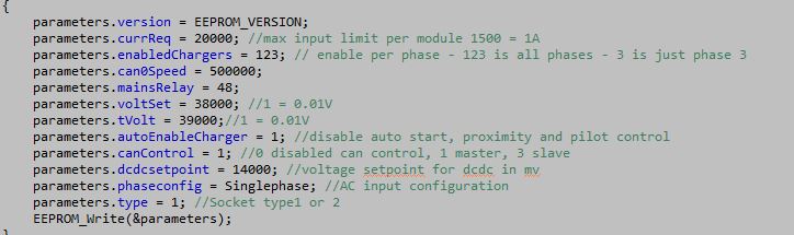

Heres the settings I have in there. It appears the AC is being requested, but the EVSE is not supplying the requested voltage. If i look at the EVSE app, it shows as connected, but not supplying any current.

jon volk wrote: Sat Apr 25, 2020 2:23 pm Heres the settings I have in there.
Be good to do debugging on the pilot signal output values.
Like add at line 1284:
  else
    accurlim = (micros() - pilottimer) * 100 / duration * 600; //Calculate the duty cycle then multiply by 600 to get mA current limit
    printf( \r\n);
    printf("Pilot curlim: ");
    printf(accurlim);
This will be a pain to see as it will be a lot of data due to the 1000hz pwm. But should indicate if there is an issue interpreting it.
Also a can capture of the charger coms would be usefull just to check what is being sent and to make sure you are not just having a quick on the module side.
