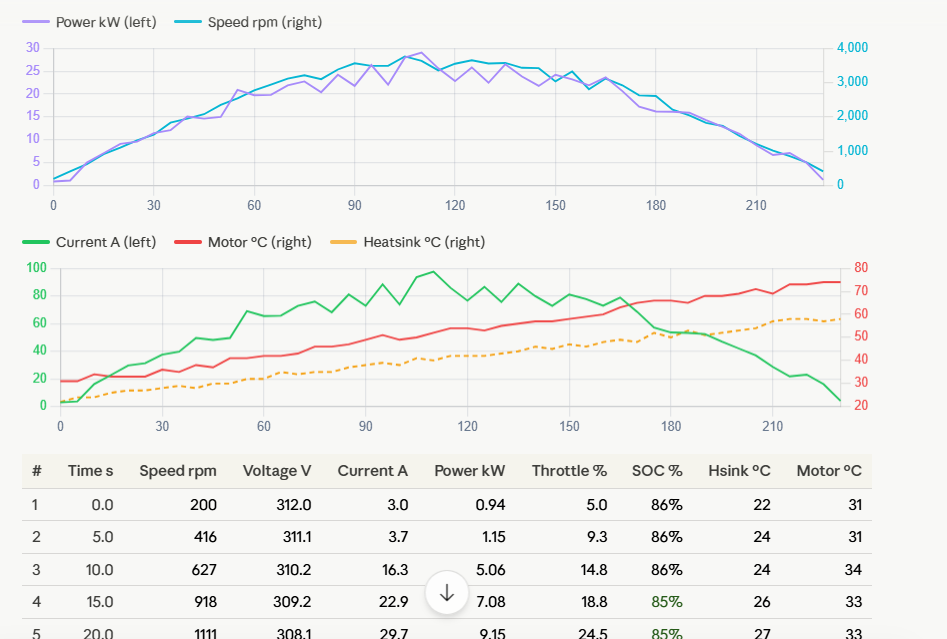

Finally got the Openinverter Web Interface working with the dial.
Released v2.1.0

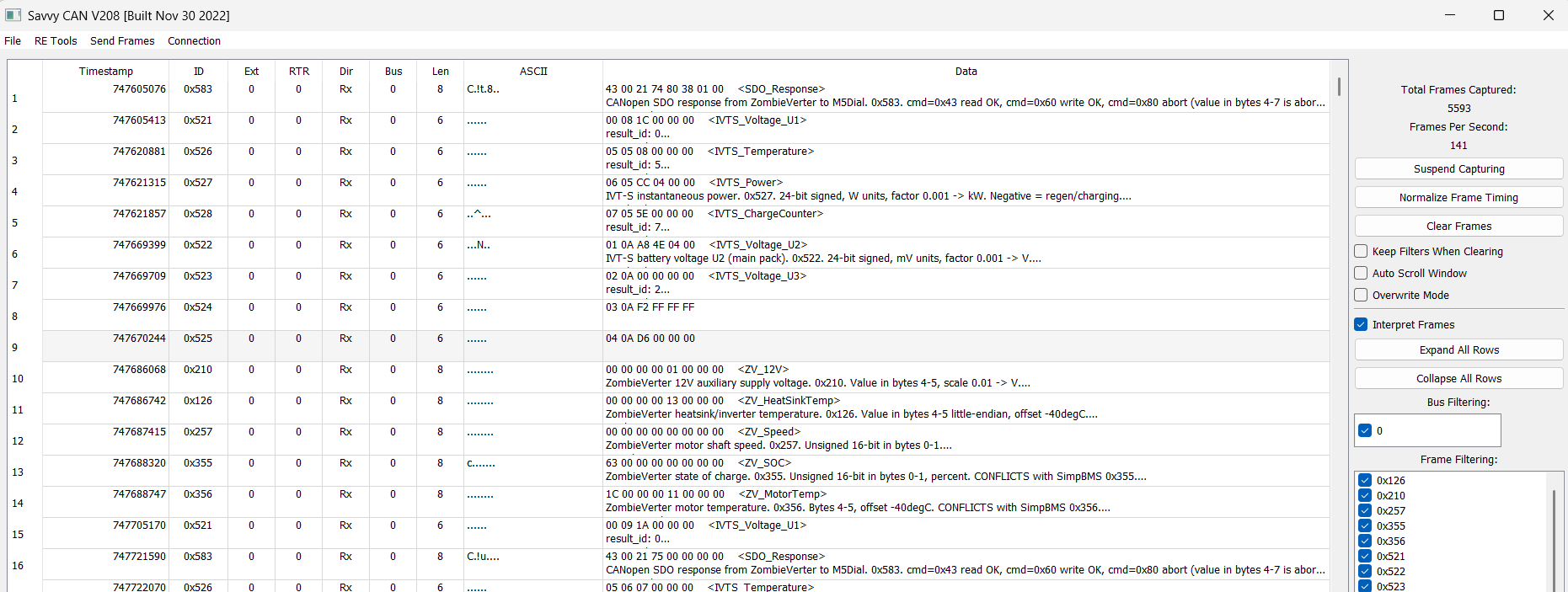

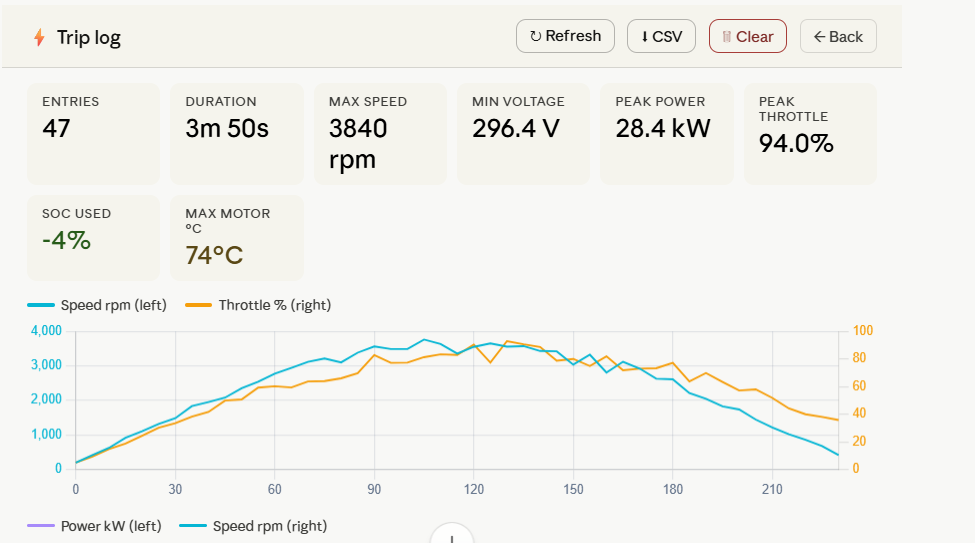

Released v2.3.0.
Full release notes: https://github.com/robertwa1974/Zombiev ... tag/v2.3.0
Key changes:
- Changed gearchange, motor select, regen to SDO, no more need for parameter mapping.
- Added tab to web UI screen showing CAN traffic, decoding, transmit single packet and logging
- Added OTA FW updates on web UI
-Added parameter fetch on web UI (in addition to fetching automatically on dial boot)
-Fixed bugs on parameter fetching on dial boot
-General file cleanup and dial graphics optimization

Re: M5Dial Zombieverter Dial Dislay
Released v2.4.0
https://github.com/robertwa1974/Zombiev ... tag/v2.4.0
* Added a GVRET-compatible TCP endpoint to WiFiManager so M5Dial doubles as a SavvyCAN bridge. The M5Dial becomes a permanent CAN analyser for the car, no dongle needed * Added trip logging feature (fake data below for now)
