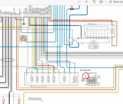

Looking for pin out or a picture of the 450H inverter internal wiring harness.
I had cut the end off to install the amp seal connecter but didn't mark the wires correctly.
And now I can't figure it out, because Toyota used same color wires for different signals.
below is a picture of a Camry Inverter internal wiring harness. 450H has a different layout.
Please help! :)

Found this on the Wiki somewhere.
But for the life of me I can't find it again.
Thank god I saved it on my computer before i closed the page.
THANK YOU to whomever put this up!
Anyways this is for the next guy that screws up royally like I did. ;)

For those of you who were scratching their heads trying to figure out why there are 2 "SP" pins on the wiring harness diagram... well
Pin 1 is NOT used!
Sorry for the poor quality picture.
On my transmission (and I'm sure others must be the same) the actual Pin 1 was missing on the transmission side of the connector and I thought it had broken off somehow.
So I removed the connector from the transmission and I can confirm that there only 10 wires going to the connector from inside the transmission.
I should've taken better pictures but I didn't think I was going to post this, but then thought someone else might be having the same issue.
If I had the factory wiring harness with the connectors this wouldn't have been a issue.
