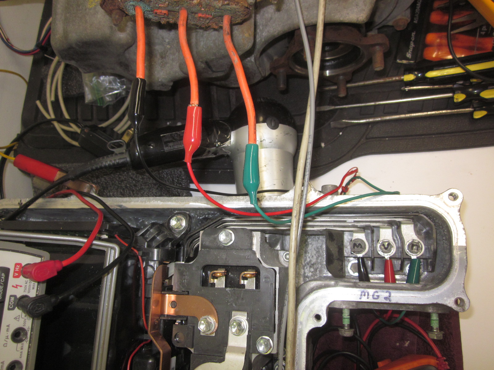

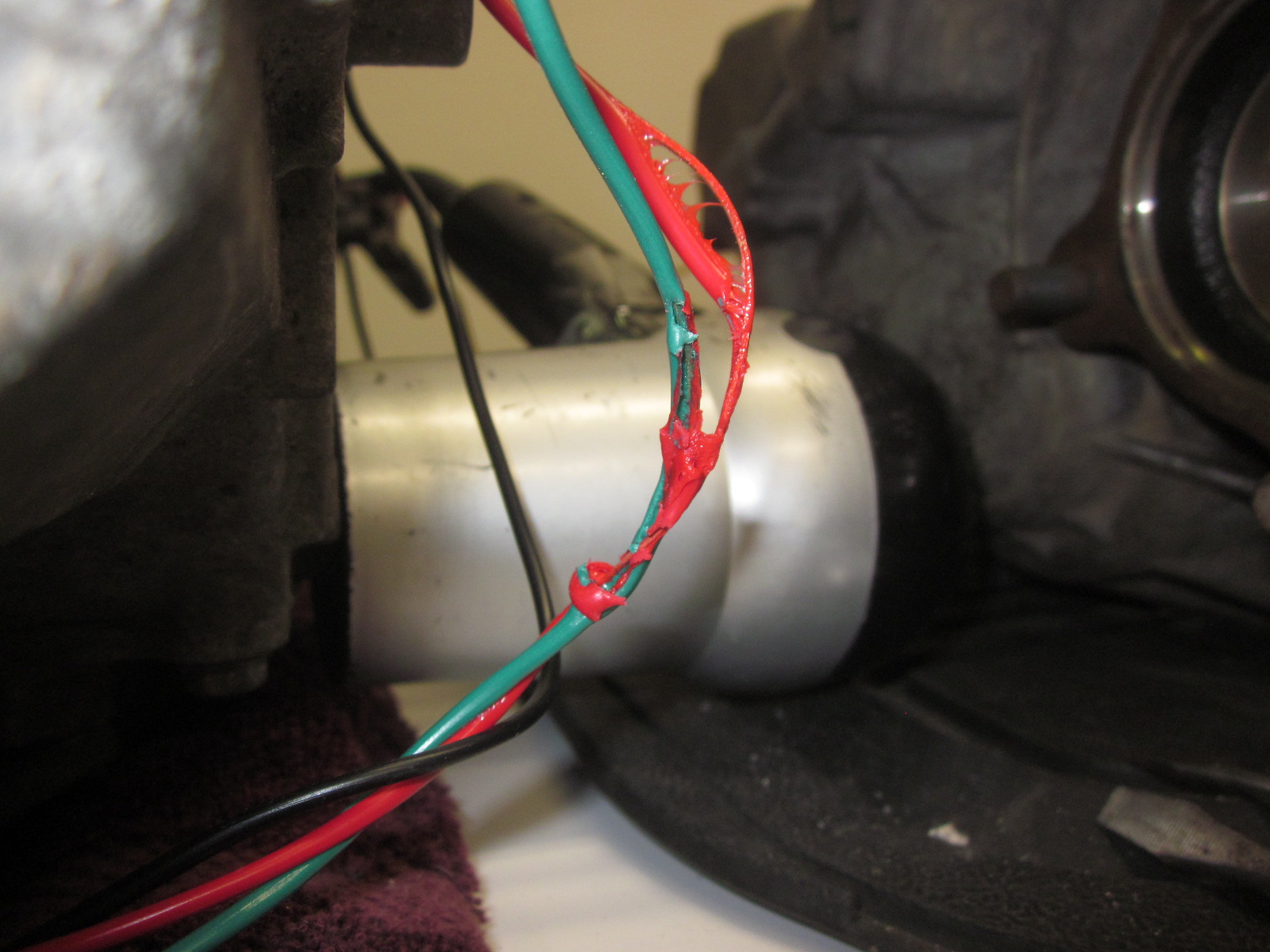

Re: VW Squareback DIY EV
Let the Magic Smoke out
Fortunately only the motor jumper wires are affected and have plenty more of them
Is my understanding that the Inverter and motor phases are wired the same and that switching the outboard wires will only result in a direction reversal? All my searching suggests that is so, but if anyone knows differently, please do share.
- Posts: 43
- Joined: Fri Nov 01, 2019 9:39 pm
- Location: Ochtrup Germany
For the MGR you need the FOC software and here it is important how the wiring is.
The inverter must know the position of the rotor in order to control the appropriate coil, so the position and the direction of the resolver (sin, cos) and the phases must match. If the direction of rotation and resolver is correct, you can correct a phase shift with the offset value. In addition, the current direction of the measurement must be correct, otherwise the control will not work either.
Number of pole pairs from the motor should be 4 and 2 for the resolver.
Since this "Magic Smoke" event, I have not been able to get any output from the Inverter. I switched back to SIN from FOC and no change in results.
There is no evidence that the short touched the inverter case and being able to handle 350A or more, I cannot see how it could have been damaged by the (relatively) low over current event. But w/o an oscilloscope scope, I can neither inject PWM into it, nor effective verify the VCU is outputting to the inverter.
Begging the question, with typical shop tools, how can I verify VCU output? I have measured ~16V on the three VCU output wires (U,V,W) so can I use lightbulbs to verify variable PWM to the inverter somehow?
Having some voltage on the VCU optputs suggests the inverter is logic is OK, so I hate to replace it needlessly.
"New" inverter, same results. Looks like I damaged the VCU somehow, really wish I knew what happened because the most important thing is not to repeat the failure!
I also switched back to "FOC" and have no resolver signal, it is stuck on 106*, and wire voltages do not change with rotation
BTW, here is a tip, remove the blue seal from the Cinch box and green seals from the connector housings until you are done with wire up and placing it in your project because it is MUCH easier to latch/unlatch the tabs with the seals removed! Trust me, you will be connecting/disconnecting a few times and it is worth the 5 seconds to remove the seals. If you are mounting the VCU inside, you *could* leave the seals out completely.
OK, I have the resolver working again
After correcting the phase wiring per the updated instructions, I still have no output from the STM32 to the ULN2003, where it's pins (5, 6 & 7) "U, V & W" are all 14.7Vdc with no pull-down in Manual Run with fslipcnt & ampnom = 1 and I am running out of ideas
