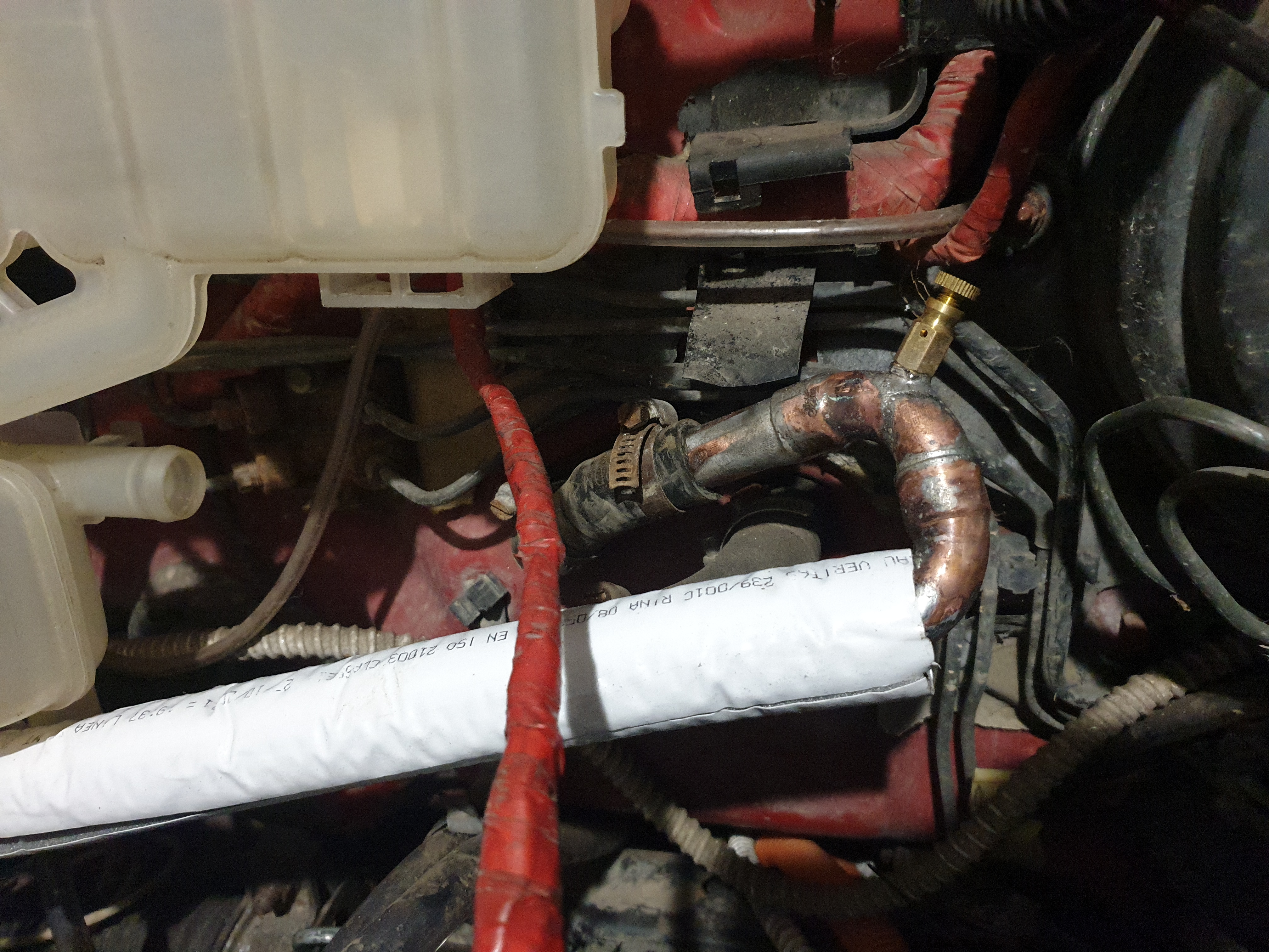

My Part-Lander get hiccups due to cooling problem. Inverter temp1 exceeds 85 deg. and inverter shut off. Maybe my pomp is to weak - it's Bosch PAD. What type of pomp do you use with Outlander stuff? I know, that I made fault, because there is no narrowing between coolant circulation and expansion tank, fluid level in tank increases while pump is on. It is easy to fix. But I will ask you to check my system of cooling if there are any another faults: bottom of the radiator -> pump -> charger -> joint to expansion tank -> inverter -> motor (we are going down) -> radiator top. Generally it's sequence like in OEM, but unfortunately there are some siphons, which I can't avoid. Any suggestions?

Show us some pictures of your setup.
Is the coolant getting warm? I would measure it to make sure the heat is actually getting into it.
Posts: 3660
Has thanked: 145 times
Been thanked: 368 times
I dont think this is correct. Probably you have a lot of air still in system. you need to deair so that you almost dont hear the pump.
1. i think your header tank connection should be before pump so its suction would pull fluid rather than push it in header.
2. radiator input should be lower because heat is rising... then it should exit through the upper port. Also bubbles are also rising. You need a port to deair on top of radiator.
To deair use simple brass valves that i solder to 18mm copper tube and I leave enough of the valve to attach 10mm tube which I use to such air out manually. Usually works without me gulping a lot of coolant :)...
https://mazdamx3ev.wordpress.com/2023/1 ... ng-piping/

marucha79
Posts: 31
Joined: Wed Jul 20, 2022 6:28 am
Location: Poland
Been thanked: 8 times
Post by marucha79 »
Some elements are seen here.
Fluid isn't warm, CAN reports that only this one place in inverter getting hot. I think @Arber is right, there is problem of air in system. Pump doesn't work smooth, can hear irregular noise. I use radiator of Civic VI, and there is plug, which could be used to release the air. First, I will move joint to tank before pump inlet, as @Arber suggest, it make sense.
Posts: 3660
Air goes out at highest point.
It is not very efficient to have radiator fluid under the inverter level. Then air can remain trapped at the highest point.
Then you should make a new highest point....
Put one 2m long 10mm diameter transparent hose on the smaller release on your radiator. then you need one M8 bolt to quickly plug the hose if pump sends fluid flying.
1. you go and fill the fluid and observe how radiator fills up. your transparent hose should show you level with header tank.
2. route your hose across open hood so that majority would go higher than.header tank and turn on your pump.
3. observe the level rising and bubbles go out. if coolant would escape use M8 bolt to plug the hose. repeat...
4. turn off the pump and suck the air at other end out the system. Watch out for fluid ;). repeat with step 3 until you dont see bubnles anymore and pump runs smooth
https://evmeganetech.wordpress.com/2025 ... lant-loop/
