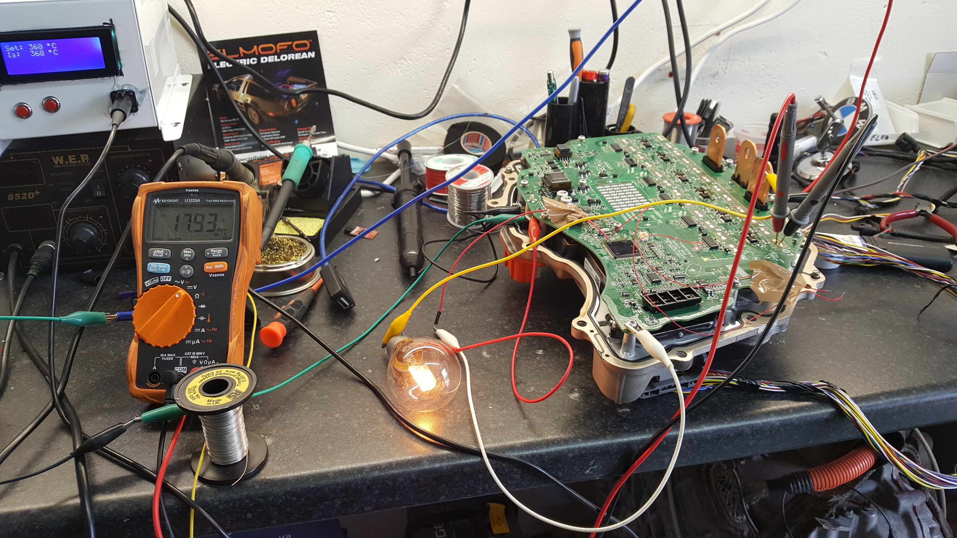

elon busted my chops on this one but we have control of the mosfets:)

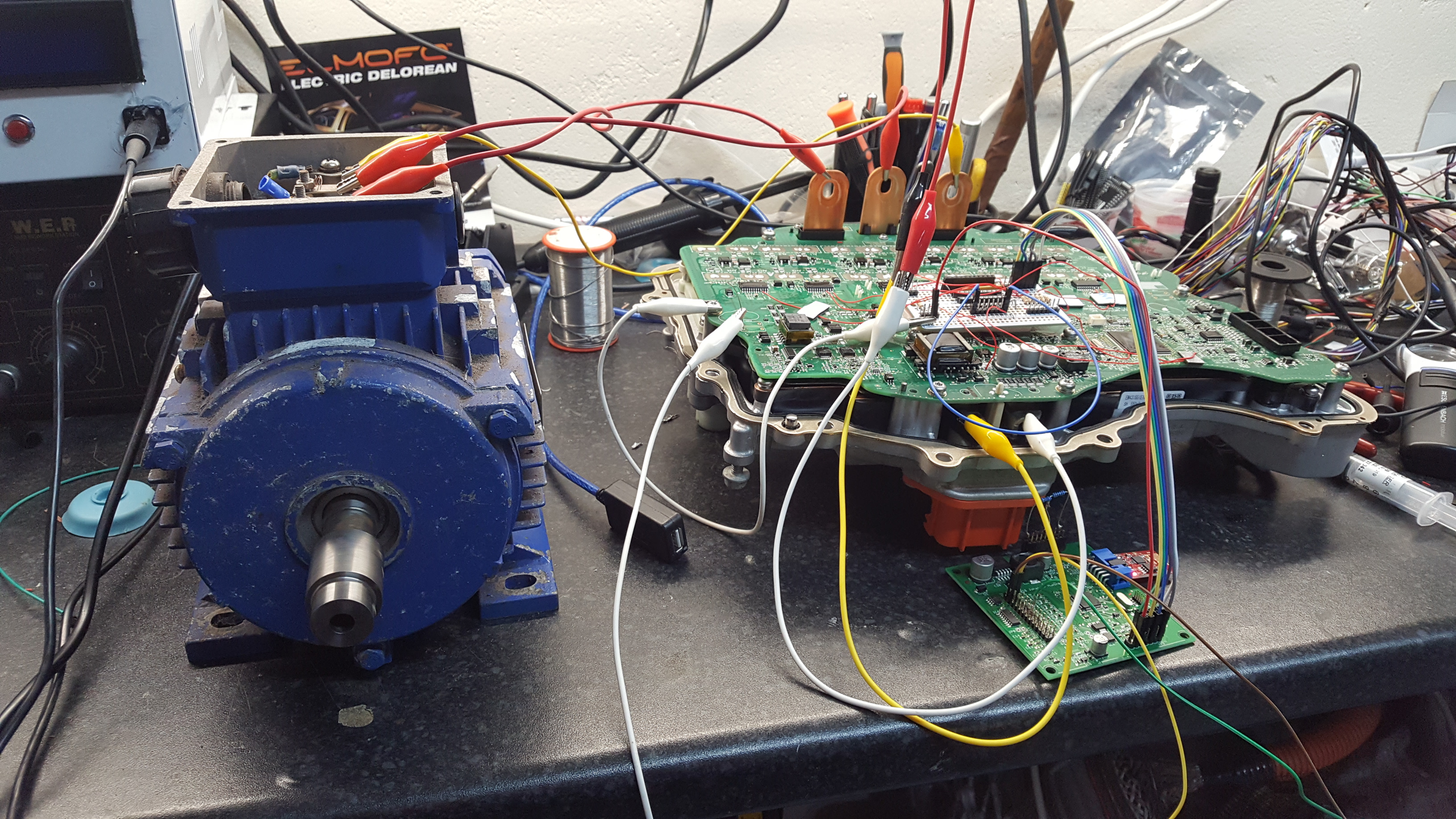

First spin of a motor using the rear drive unit inverter. Switching at 17.6khz.

And with Elon awake we get a 10khz sine wave as our resolver exciter that goes away when he sleeps .....hmmmm

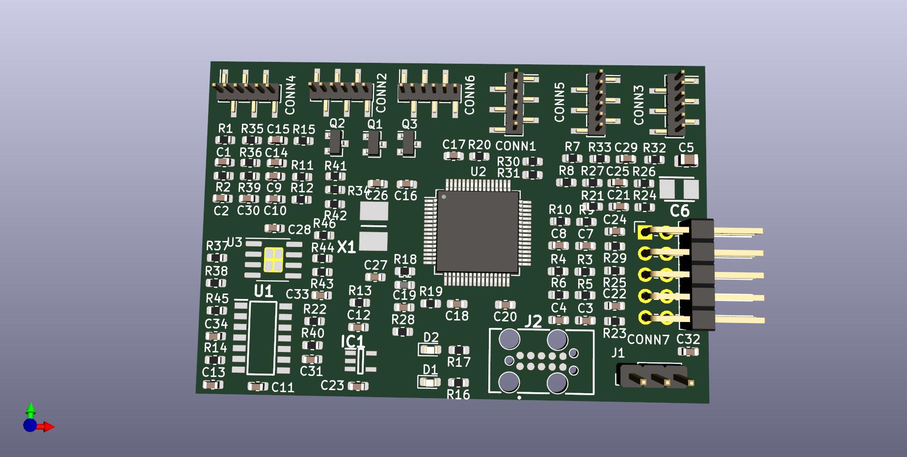

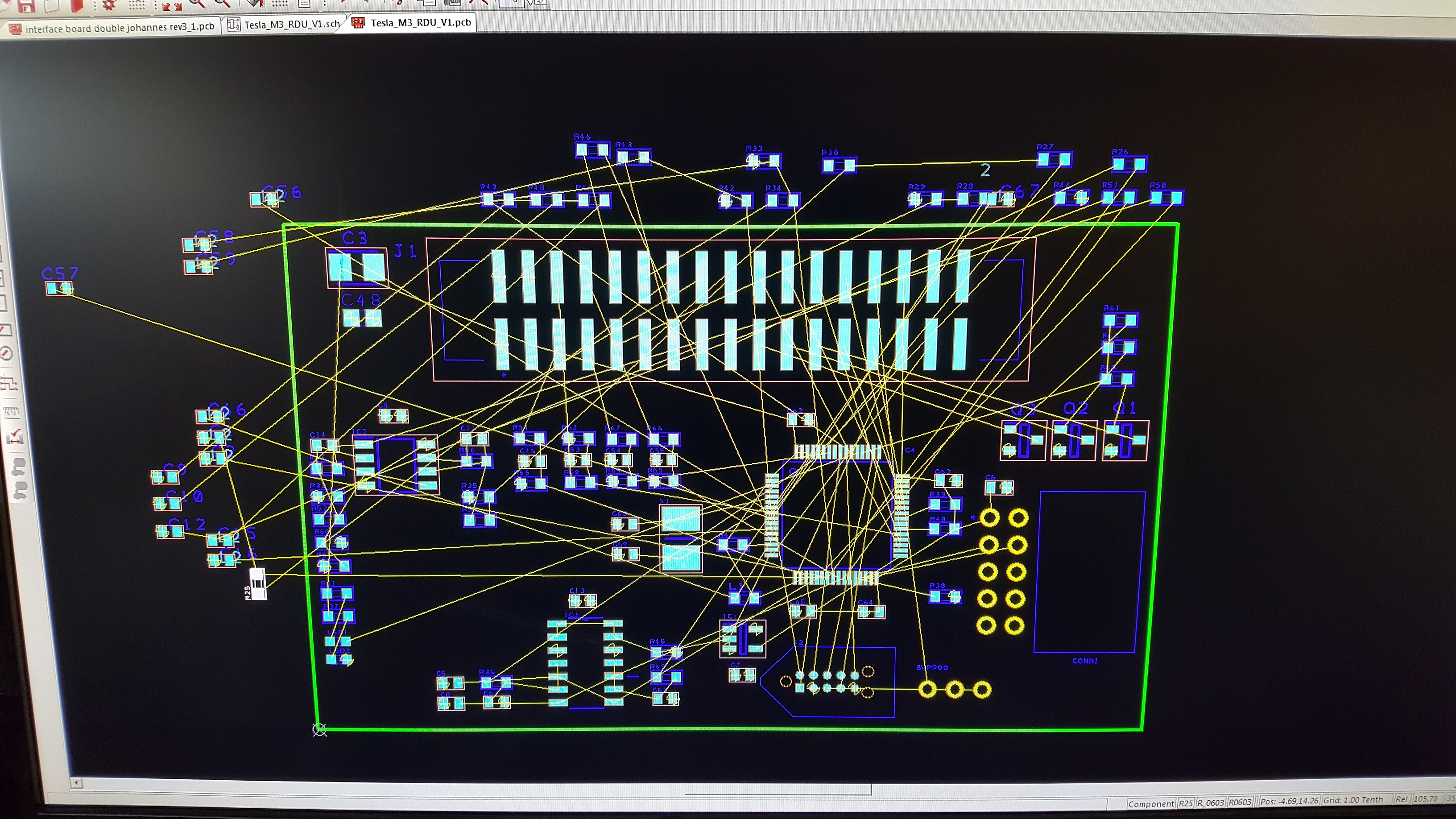

Decided to take the plunge and give Kicad a go for the model 3 modchip. Intermediate schematic attached. Still need to add a few things like changing Uart2 to LIN for oil pump control etc.
M3_RDU_V1.pdf
(151.39 KiB) Downloaded 683 times

Drive unit made it home. Next up is working out the LIN for oil pump control then its closed loop running time. Boards should be done and in manufacture at JLC after that.

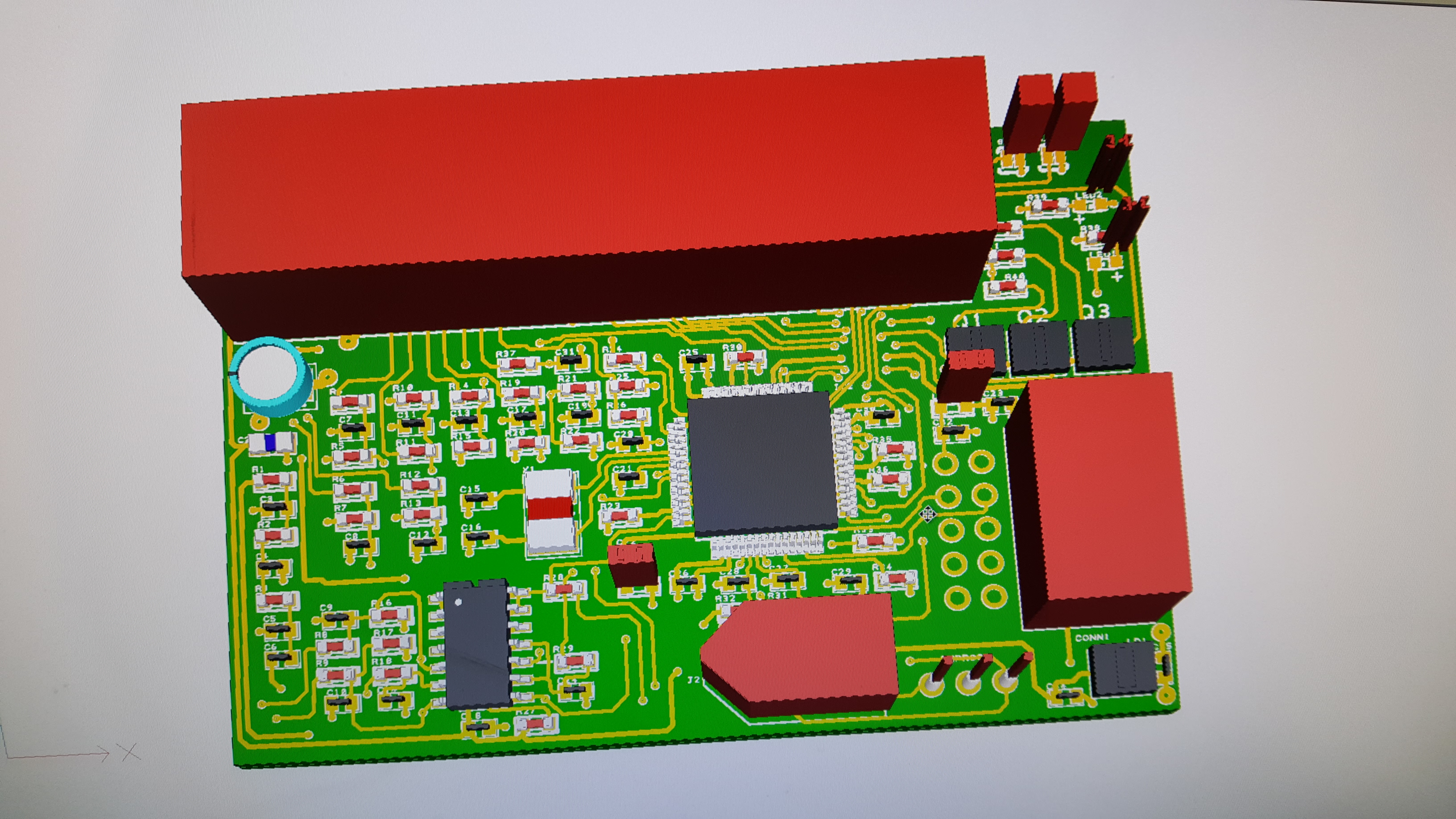

All components placed. Board size 60mm x 40mm 4 layer. All 0603 passives.
Posts: 4007
Been thanked: 1138 times
The all important rear view.

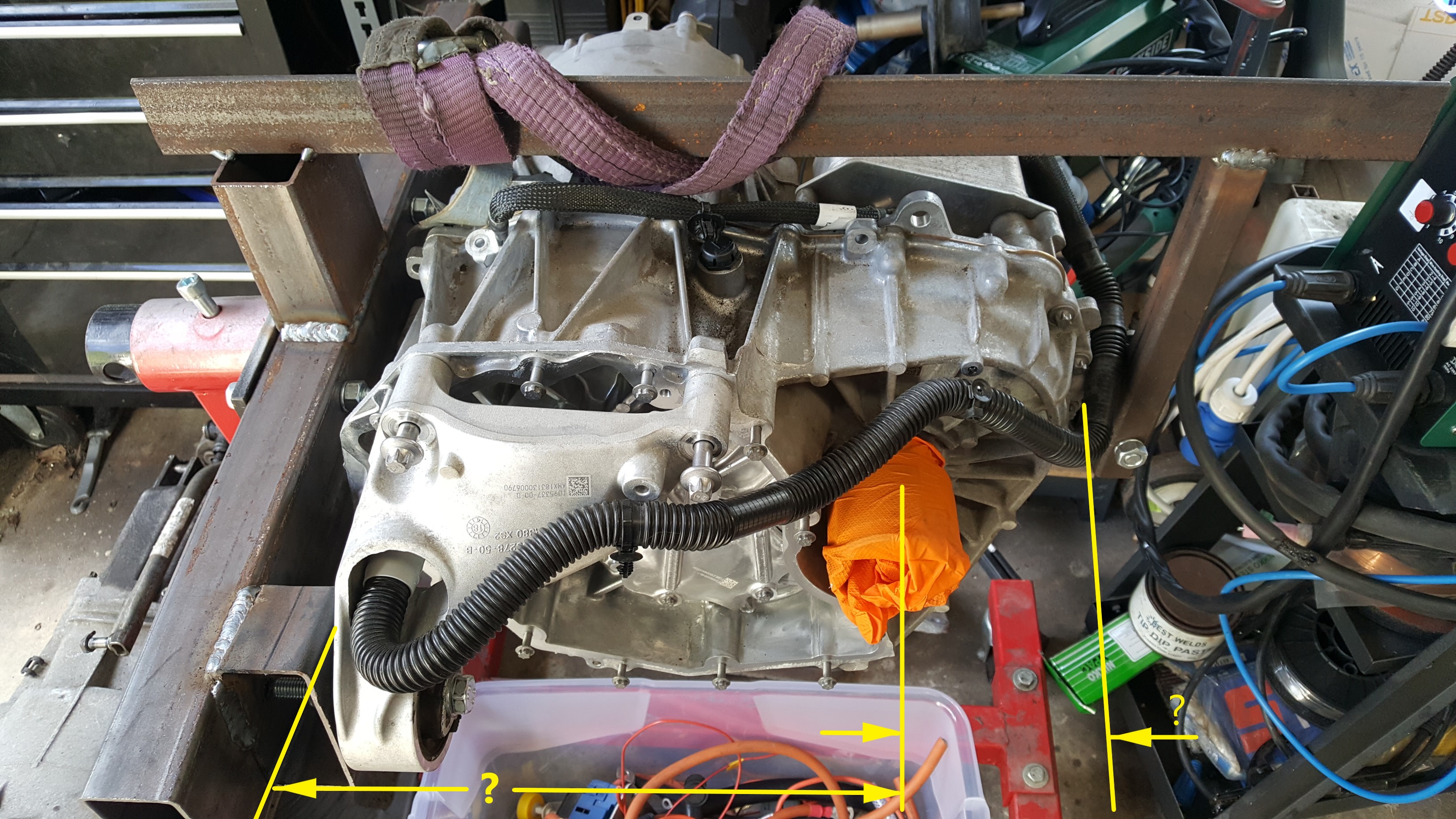

JeanVapeur wrote: Sun Mar 01, 2020 7:00 pm Hi Damien,

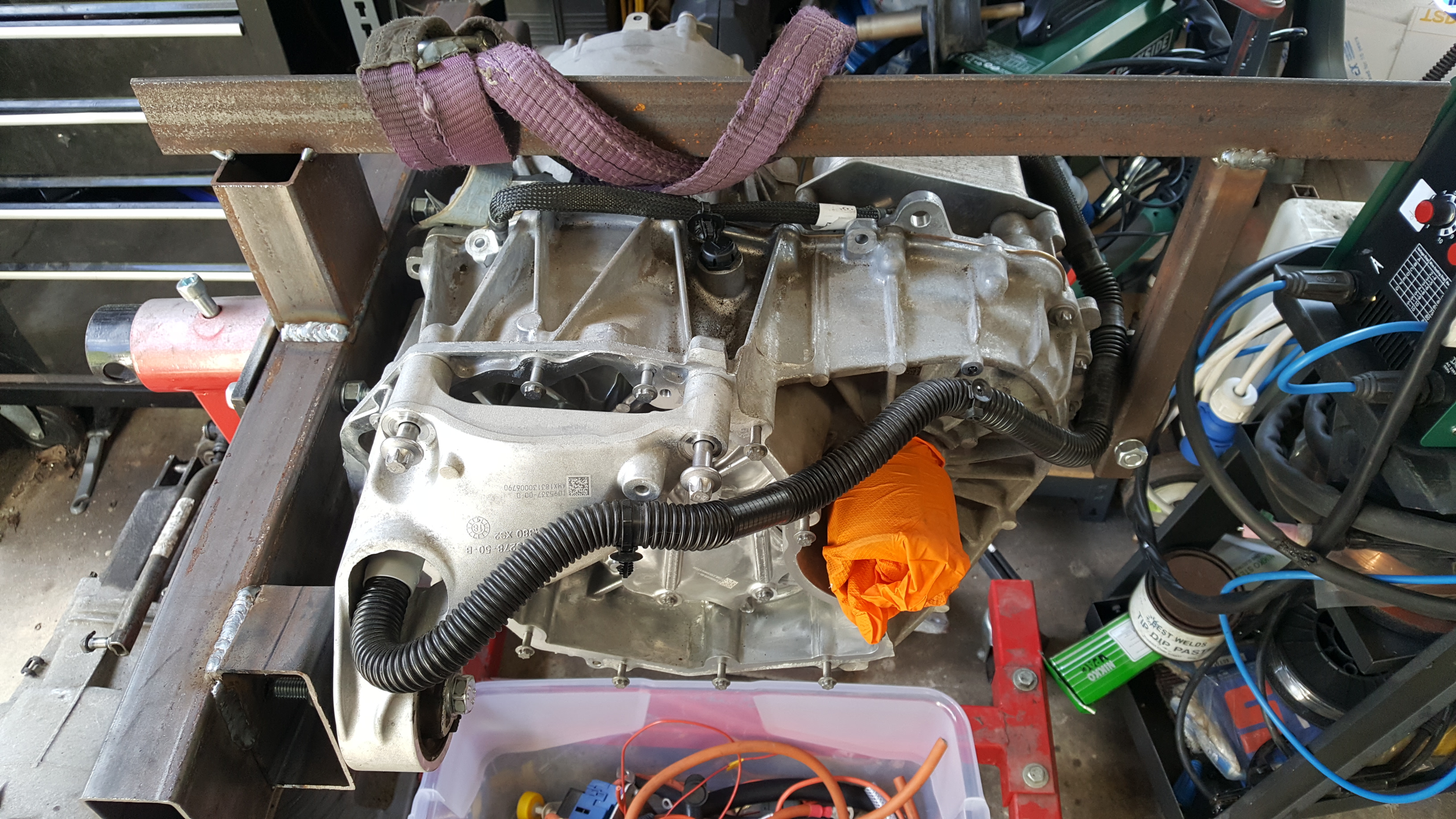

can you do me a favour and make a raw drawing/video (L x W x H x D) of the dimensions of the 2 Model 3 DriveUnits.
Ony for a rough placement check.
Thank You very much!
Peter
Until we have received a 3D Scan crowdfunding, I will politely asked again,
if somebody can tell me the dimension in the picture?
Thank you and happy Easter! :)

JeanVapeur wrote: Sun Apr 12, 2020 2:32 pm if somebody can tell me the dimension in the picture?
Why not ask Sandy Munro? He's desperate for cash and will answer a question for $50 8-)
https://munrolive.com/access-%2F-shop/o ... take-aways

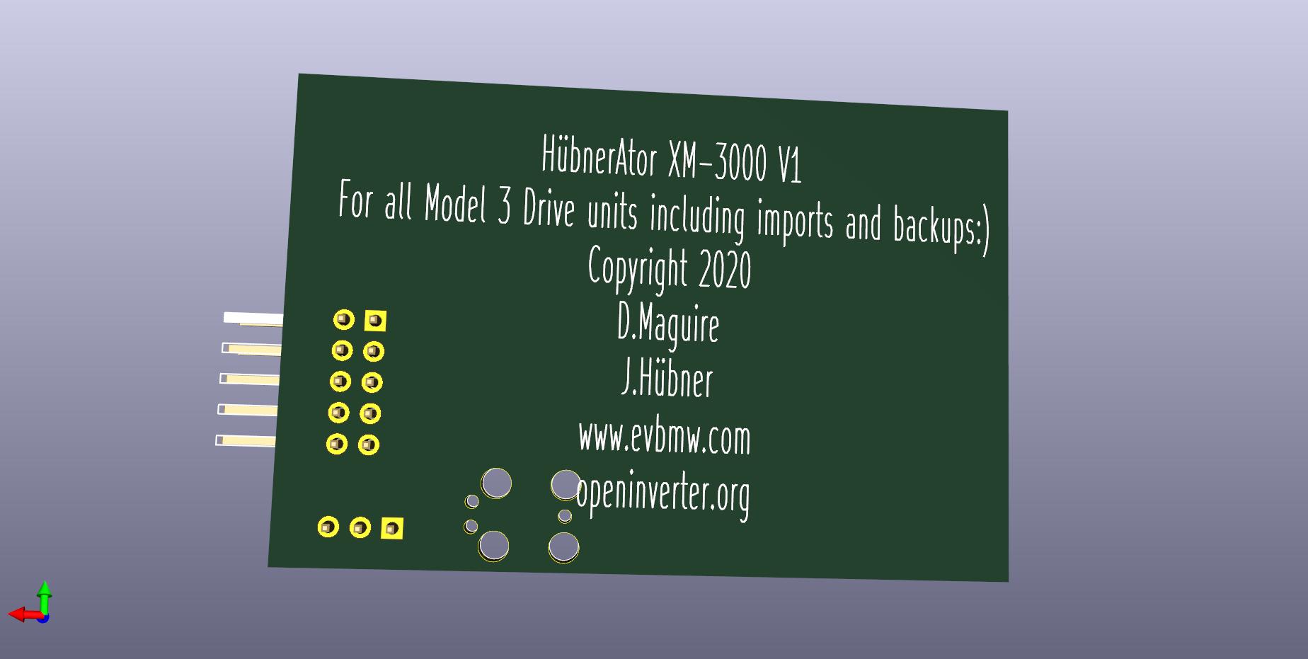

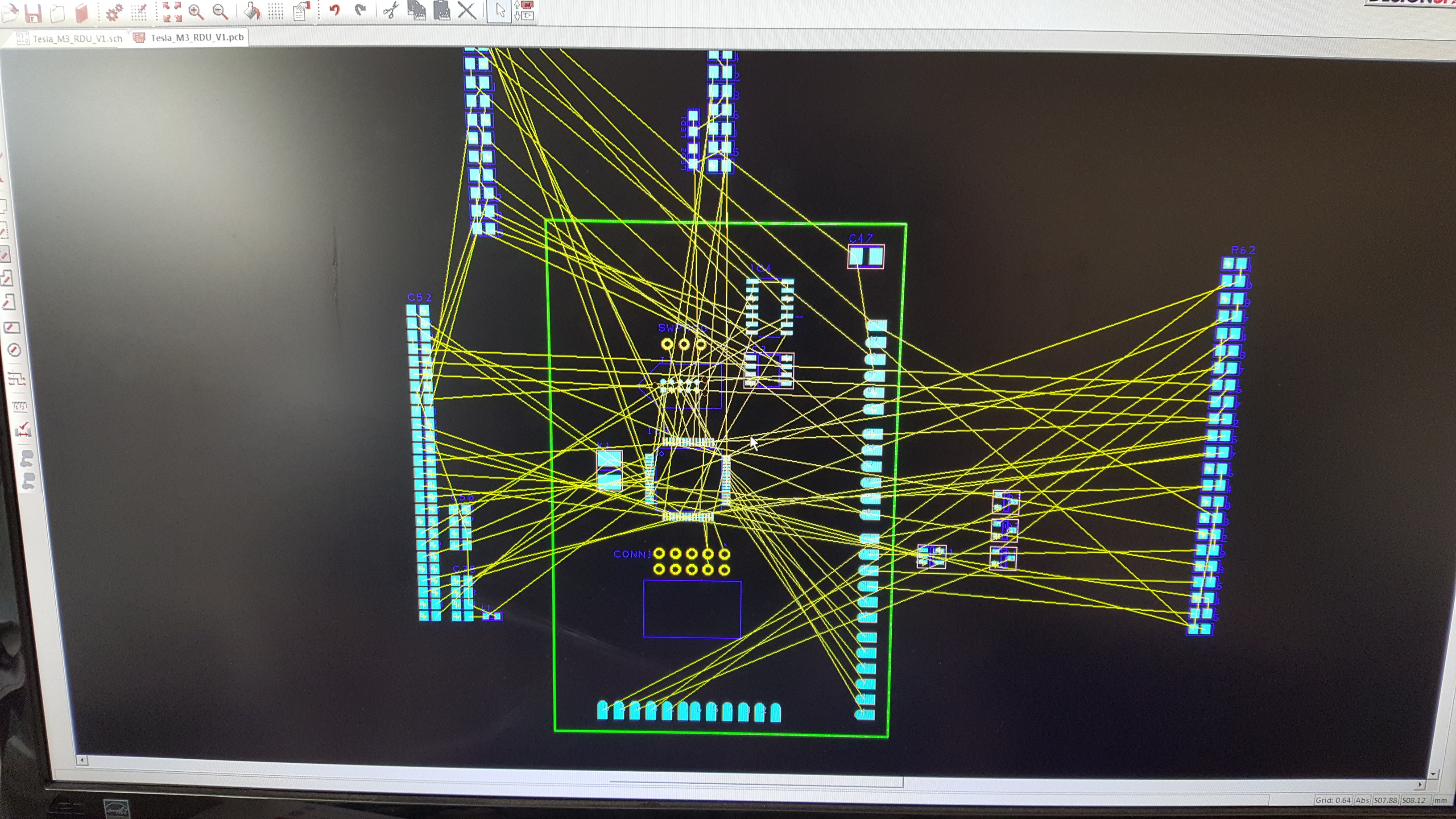

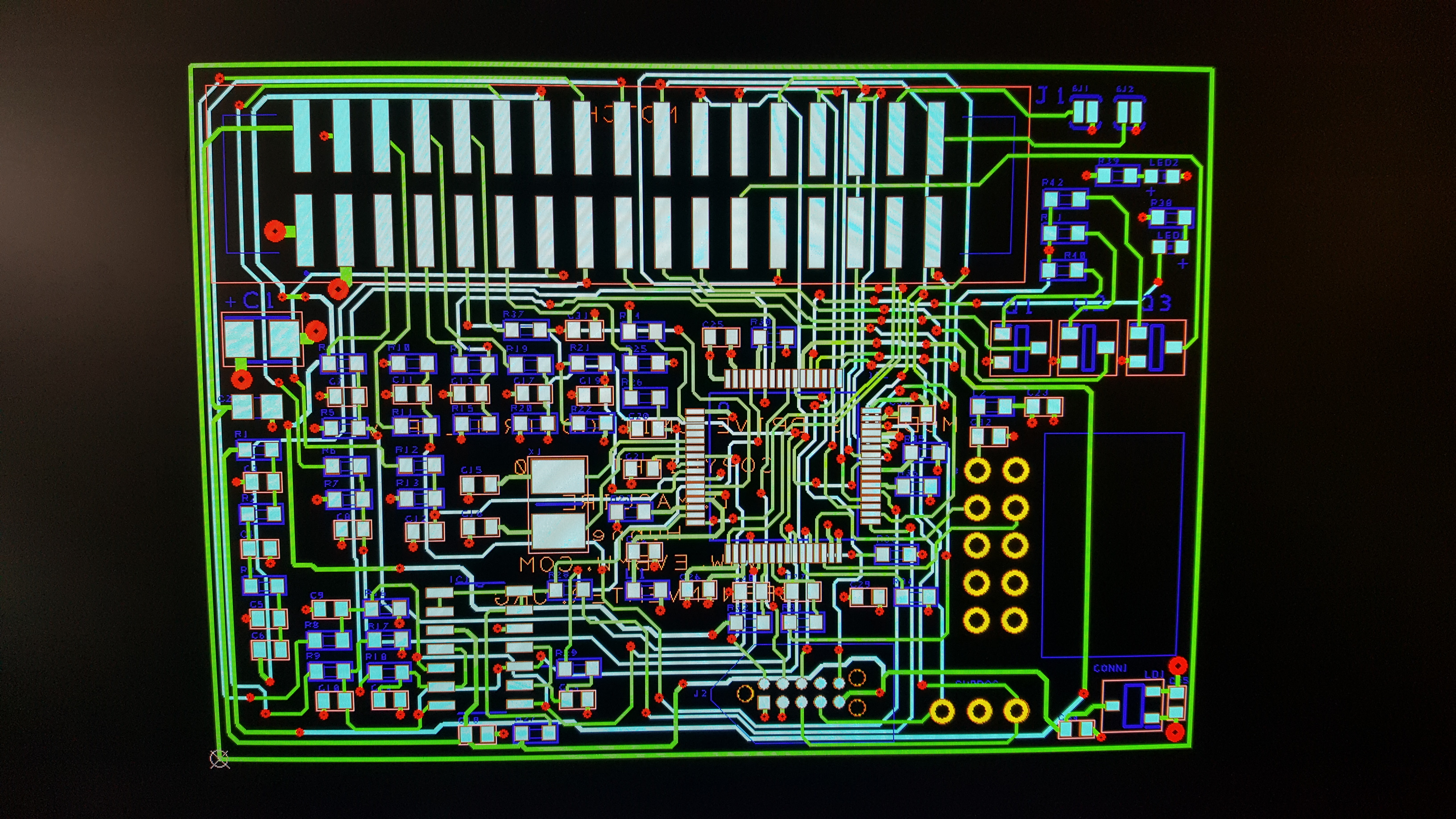

I was unhappy with the way the board layout was going particularly around connecting to the existing drive unit logic board so I went away for a while. New attempt is looking much healthier. One 34 way IDC connector and ribbon cable handles all connections from logic board to drive unit board. Using multi colour ribbon will enable easy signal id and provide a stranded wire for each connection.
There will be two versions of this board. One for the model 3 drive units will utilise a smd idc header as we don't want a through hole connector with pins sticking downwards when mounting onto an existing board. A second version will use a standard 2.54mm pitch 34 way header enabling its use as a micro inverter logic board for other projects by use of a male header mounted on the rear of the pcb. Current board dimensions are 80mm x 45mm using 0603 passives.
Posts: 4007
Probably the smallest openinverter board yet. 65mm x 45mm.
