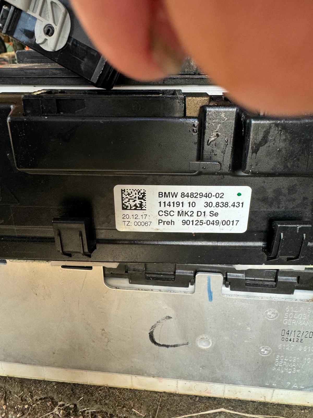

andybpowell wrote: Mon Feb 26, 2024 1:32 pm do you have a picture of one ?
it's a close up of the info panel - best i have to hand

From photos here viewtopic.php?p=61468#p61468 your rear pack is gen2. Gold coloured covers on modules and white cmc on the module marked "6".

Yea you really need to decide if they are all black or not as shown in the picture, I'd hope BMW would have keyed the connectors so they are not interchangeable but you never know and plugging the wrong modules in could prove costly

I'm guessing from the picture you supplied earlier that you have gen1 on the 1.5kwh modules since it's dated 2017 and gen 2 on the 2kwh

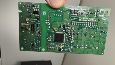

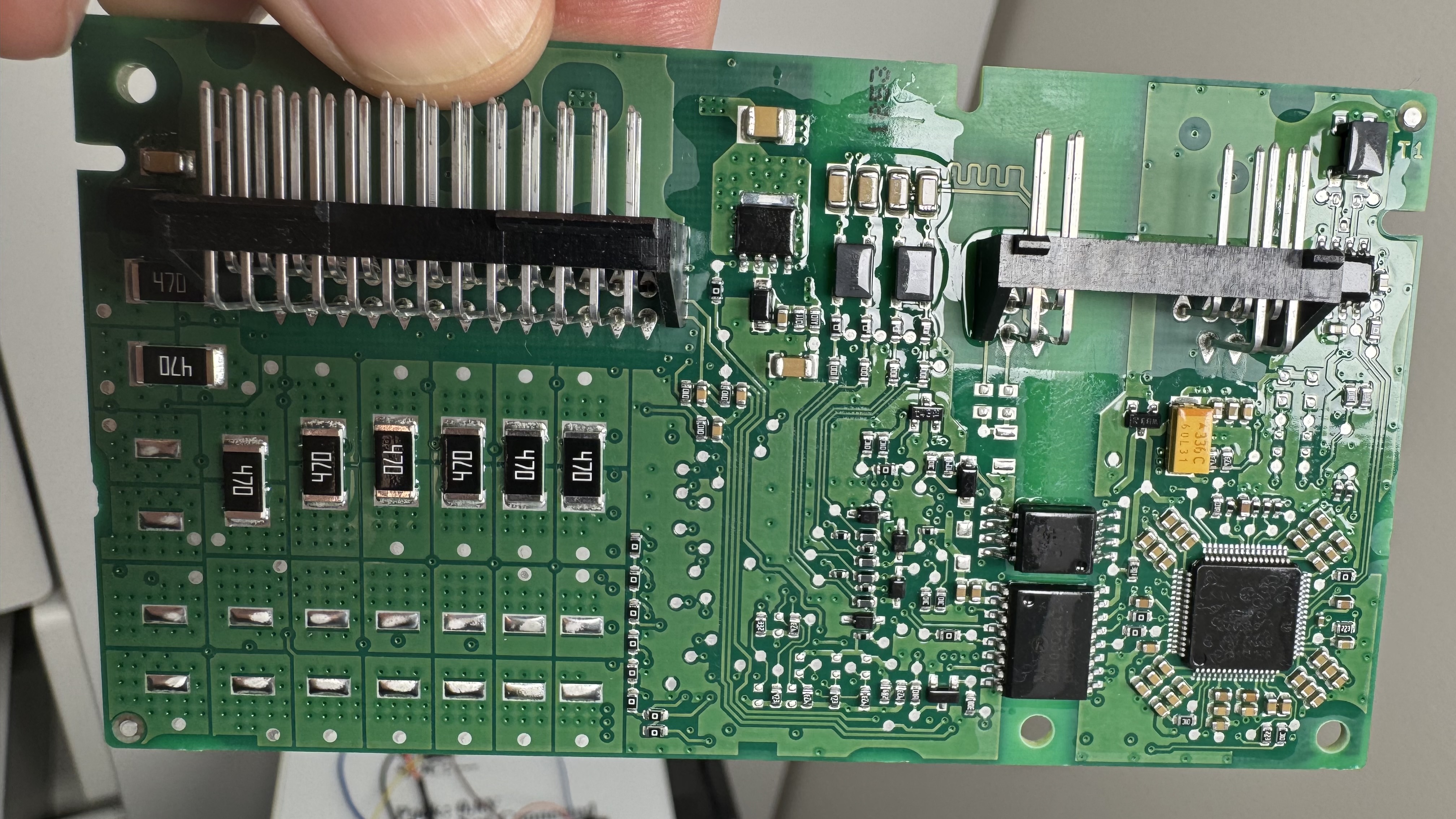

I’m unfortunate to join this thread. I accidentally gave 12V for the master slave (gen2) and now it won’t respond
to can messages anymore. It pulls power about 0,6 amps and about 1A when giving interlock 5V. Can bus shows steady 2.5V all the time but won’t respond to any messages. I think I might have fried something but when looking at the card, I can’t see anything burnt or smelly. It’s X5 pack with 12 modules, master is white and others are black. Now I wonder what to do. I don’t think bmw sells these from the counter?
Here’s two pics of the board.
Any ideas? Anyone have one to sell?

Oh! BMW sells these separately! https://parts.bmwmonterey.com/p/Bmw_202 ... 69525.html
I wonder will they work with existing slaves.
Posts: 2753
Location: Bristol
Has thanked: 264 times
Been thanked: 717 times
Re: BMW BMS modules
Most likely needs coding in a full pack and possibly car before its happy.

Got lucky and my local BMW dealer had that exact same master csc with same part number (200€). So I plugged it in and can-bus is back alive. Now testing with SimpBMS, I can see all 12 modules appear, but voltages and temps only for first 6 modules.
BMS Status : 1 Ready     48
Out:0000 Cont:0000 In:0000 Charge Current Limit : 30 A DisCharge Current Limit : 30 A
Modules: 12 Cells: 48 Strings: 1  Voltage: 177.380V   Avg Cell Voltage: nanV  Low Cell Voltage: 3.691V   High Cell Voltage: 3.699V Delta Voltage: 8mV   Avg Temp: 11.583C

I never tested the original CSC master with more than 4 modules, so now I'm not sure if this is something in SimpBMS code that I need to fix or is this something related to that new master "slave" card.
Any ideas?
