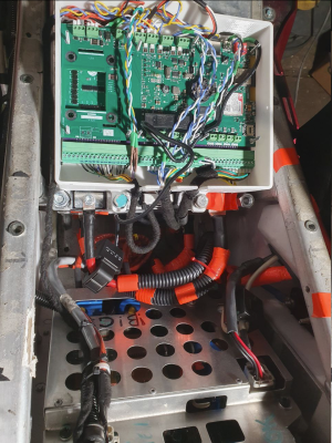

Hello openinverter community,
I would like to share my progress with hopefully providing another alternative for a somewhat useable Vextrix VX1 scooter BMS integration.
Vectrix VX1 is a maxi scooter which is highway capable and very suited for automotive battery integration. It was made for a few years in a few thousand unit run, most frames are almost 20 years old by now. Originally they shipped with nimh batteries, which died not long after on most units.

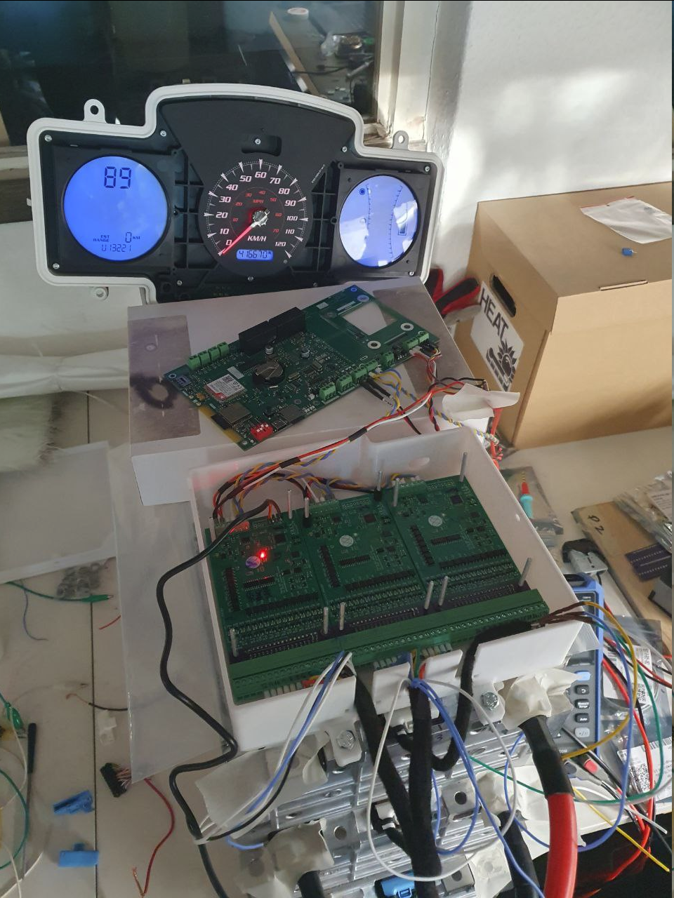

I have forked Johus Flying ADC BMS firmware, ESP web tool and CAN bootloader to better suit vehicle integration. VX1 runs on 250k baud, so need forks for all of these:
https://github.com/skrubis/VX1-stm32-CANBootloader (250k baud migration)
https://github.com/skrubis/FlyingAdcBms-VX1 (added vx1 integration)
https://github.com/skrubis/VX1-esp32-web-interface (migrated fully to platformio, made friendly with 250k baud)

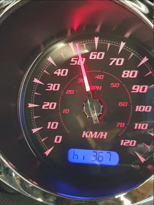

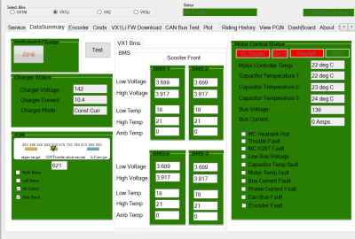

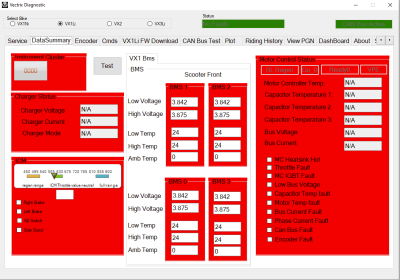

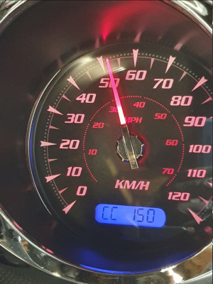

Current status: shows bootscreen stats, shows errors on odometer from any node, allows custom temperature or udelta warning on telltales and display. Shows various stats on clock display if so desired by the user.
Should be receiving motor controller speed, current and voltage PGNs for plotting/logging and most notably kWh/100km calculation as my brain breaks in Ah calculations used for the scooter throughout.

VX1enCanMsg - enable can messages to the vehicle
VX1BootLCDMsg - show "OI FLY / BMS" on odometer at boot
VX1enBootstats - show "utotal, udelta, soc, soh, tempmin, tempmax on odometer at boot
VX1msgInterval - how often to send can messages to vehicle
VX1paramMsgCount - how many times send config messages to vehicle, not yet implemented
VX1LCDClockStats - 0=Off, 1=Always, 2=Idle - shows stats on clock display
VX1LCDClockStatVal -0=soc, 1=uavg, 2=udelta, 3=tempmax, 4=power, 5=idcavg, 6=kWh/100km
VX1ErrWarn - show if any module has any error in shorthand on odometer + turn on telltale
VX1TempWarn - show temperature warning on telltale + current tempmax on odometer

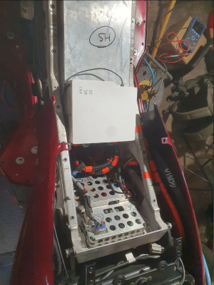

How to use:
  • you will need jlink, st link or similar programmer for the boards.
  • You may want an external current sensor, I am using HSTS016L 200A from aliexpress, as I want to monitor external eltek flatpack charger directly on battery bypassing motor controller.
  • either use command line tool (viewtopic.php?t=2907) for config or esp32 board with canbus, i.e. lilygo esp32 can
  • do a bench test for bms assembly with external power supply

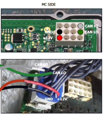

  • Install in vehicle, possibly you want a small 3S li-ion battery or 4S lifepo4 battery fed through a schotky diode + about 4 ohm resistor to the battery and same 12V from vehicle through a schottky diode to the master BMS enable pin to allow for the BMS to balance cells while bike is off.
Tap vehicle can and power on the motor controller here, preferably fuse the power feed:

Added rudimentary BMS emulated messaging, now reports cell min/max, various faults, should be able to do at least a part of original "Li+" bike model comms to allow oldest original nimh bikes to have bms feedback. Not yet tested.

Post by skr »

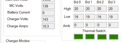

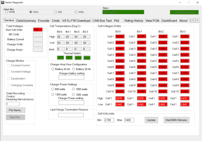

now seems to be fully working on the bike side - charger sees messages, charges depending on BMS data. A non Lithium bike has been turned to lithium and works as intended from charger point of view. Firmware still needs a lot of fixes and cleanup, but base messaging is there. Bike just passed inspection with 0 advisories, now just have to tackle a 200mV delta in the pack, not sure how many months it will take to balance it out. Imo a very valid alternative for cheapskates like me to turn ancient nimh bikes in to lithium with proper feedback from bms.
Still have to tackle the bike PGN reading, it is broken now, I'd like to log temperatures, speed, current, voltage for motorcontroller from Web interface to SD card.
