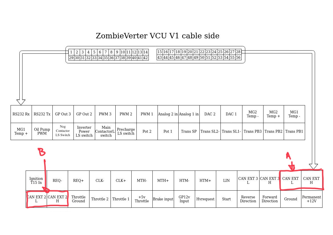

Re: ESP32 CAN Web Interface <-> Zombieverter
Well, I'm not having any joy. It's probably user error on my part, which I'm sure is exasperating for the old hands on here because once you know, it's obvious
When you say CAN1, do you mean A or B in the picture below? I know I have seen posts on here that mention that the references change sometimes.
Further assumptions that I am making:
1. Both of these CAN interfaces have a terminating resistor in the Zombieverter
2. The ESP32 does not have a terminating resistor.
I think I am on 2.17, but I lost the Olimex webui when toggling between 2.05, 2.15, 2.17 and 2.20 trying to get a stable connection. Are there any other Node IDs that were used?
If I fail at this I think the next step will be to pop out the Olimex and reflash it manually. Either that or spend some $ to 'phone a friend'
So I got out my multimeter to test out assumption (1) above. Turns out that:
1. I get 120 ohm across my IVT shunt CAN lines - it has a resistor in it according to the specs, so this is expected.
2. I get 0 ohm across the Zombie CAN EXT (A above) lines
3. I get 0 ohm across Zombie CAN EXT2 (B above)
4. I get 120 ohm across my USB Can Dongle, which has a resistor built in.
5. When I make a 2 node CAN network including the IVT shunt and one of the Zombie can connections (either one), the resistance on that network is 120 ohm.
6. When I make a 2 node network including the IVT shunt network on one end and my terminated dongle on the other end, the resistance is 60 ohm.
This leads me to conclude that the Zombieverter CAN connections to not have a built in resistor, which really surprises me since I have been happily reading voltages off my IVT shunt for precharging!
The conclusion I am forced to reach is that somehow the CAN network worked fine with just one terminating resistor for the special case of just 2 nodes. As soon as I add another node to the network it all breaks.
This explains so much - I have been really struggling to get anything else communicating on these CAN lines, and now I know why. I will reconfigure CAN 1 (which I assume is A above unless corrected) to be properly terminated and then see if I have any luck.

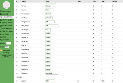

Although I no longer need to get the ESP32 communicating with the ZombieVerter because my Olimex is back up and running, I feel honour bound to try answer the original question because I couldn't find an answer when I was looking, and others will probably land on this forum post when they want to connect the ESP32 to the ZombieVerter.
So. I have:
1. A ZombieVerter on firmware v 2.20A.
2. An Olimex on the latest commit
3. Precharge is working with CAN1 as the selected Shunt CAN interface.
4. The STM32 is connected on the same CAN line as the IVT Shunt.
5. Node 3 is selected, speed is 500k
On the Olimex/ESP8266 I get full comms with the Zombie. On the ESP32 I get no comms.
Is there anything I have missed?
Thoughts:
1. Perhaps my CAN network topology is messed up - although the Zombie reads shunt values fine.
2. Perhaps CAN1 in the interface is not CAN1 as described by johu above?
3. Perhaps I need to somehow enable SDO comms by setting a parameter on the Zombieverter?
4. Perhaps there is something I need to set up in the ESP over and above setting Node ID 3 and speed 500k?
Attached my existing parameter file (most stuff I left default, just the udc params have been set)

I have managed to successfully connect the ESP32 to the ZombieVerter. In the end, I changed nothing from my last post. For clarity, here is the configuration that works for ZombieVerter V2.20. A lot of this is documented in many places, but I'm repeating it here anyway.
1. Connect the ESP32 to CAN1 of the ZombieVerter - that is the CAN lines closest to the 12v/GND pins on the ZombieVerter pinout.
2. Make sure you have the right resistor termination. That is, when powered down, the resistance between CANH and CANL must be approximately 60 ohm. If it's 120 ohm, you only have one terminating resistor, if it is under 60, then you have too many.
3. Power to the Zombie and the ESP32 are the same 12v lines.
4. The WIFI network will be something like ESP_xxxx, no password
5. The web interface is 192.168.4.1
6. The only things I needed to set were Node ID 3. Speed is 500k, which is the default. I select these values by pressing the up button a few times in the box and then hitting 'Enter' for good measure.
How did I connect?
Well, firstly, try different browsers. I had no luck with Safari - and even the inbuilt Zombie web interface is flaky on Safari. Chrome worked better. I did not test Firefox.
Secondly, I think perhaps there's a bit of a startup issue. I powered up and joined the wifi network and went to the web interface in Chrome, and initially had not connection. I waited a bit, toggled the auto reload a few times, refreshed a couple of times and voila! It worked. SO I think patience is sometimes a virtue.
Here is a screenshot of the CAN parameters that I have right now, in case you are wondering.
How did I connect?
Was just going to reply to your questions
Will anyway
Probably noScrappyjoe wrote: ↑Thu Mar 13, 2025 6:42 am Perhaps my CAN network topology is messed up - although the Zombie reads shunt values fine
Maybe.. just try the otherScrappyjoe wrote: ↑Thu Mar 13, 2025 6:42 am Perhaps CAN1 in the interface is not CAN1 as described by johu above?
NoScrappyjoe wrote: ↑Thu Mar 13, 2025 6:42 am Perhaps I need to somehow enable SDO comms by setting a parameter on the Zombieverter?
NoScrappyjoe wrote: ↑Thu Mar 13, 2025 6:42 am Perhaps there is something I need to set up in the ESP over and above setting Node ID 3 and speed 500k?
