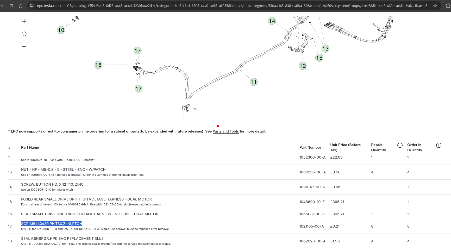

Does anyone know the size of the bolts that hold the HV cables to the motor at the Rosenberger connectors for a front drive unit?

phillipschip wrote: Wed Nov 06, 2024 8:12 pm Hi,
Thanks!

Perfect thanks!
