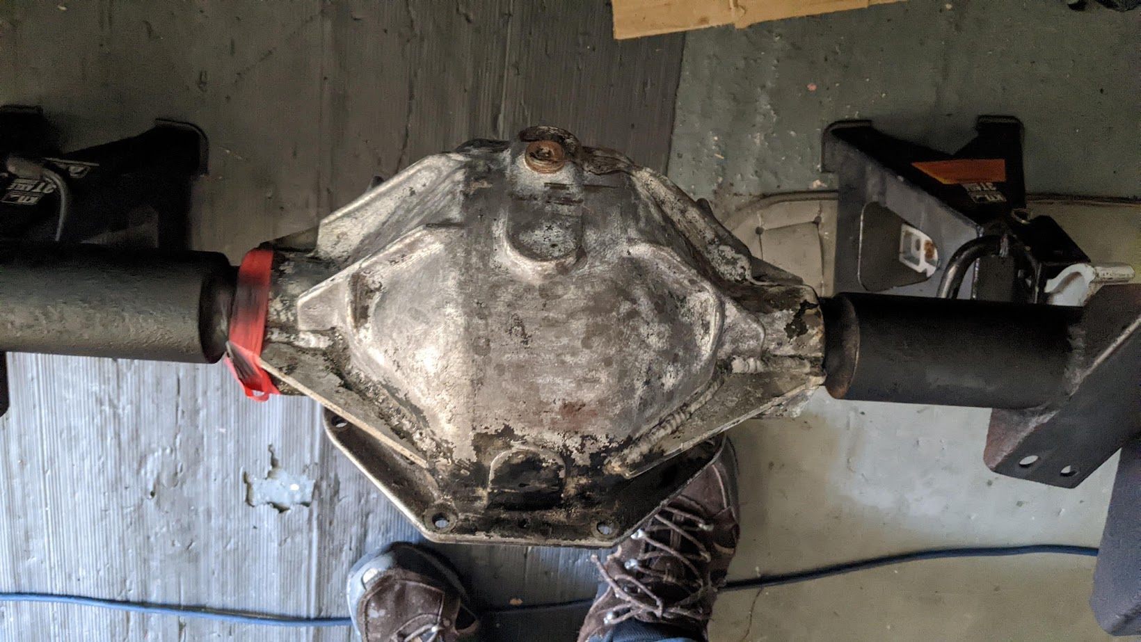

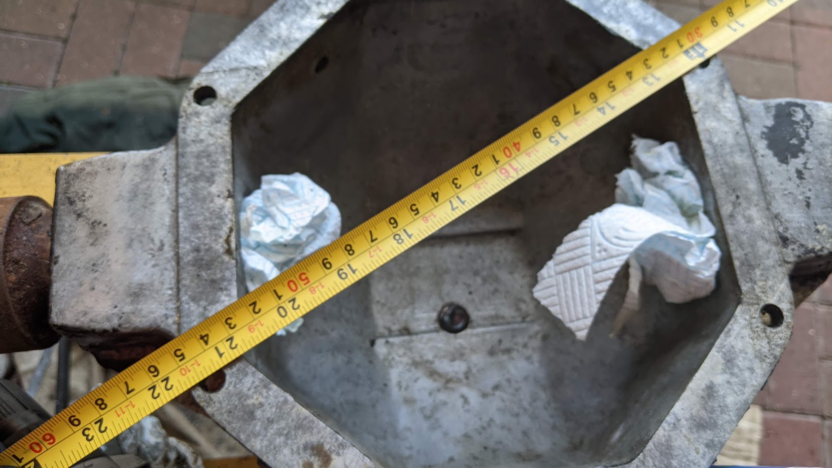

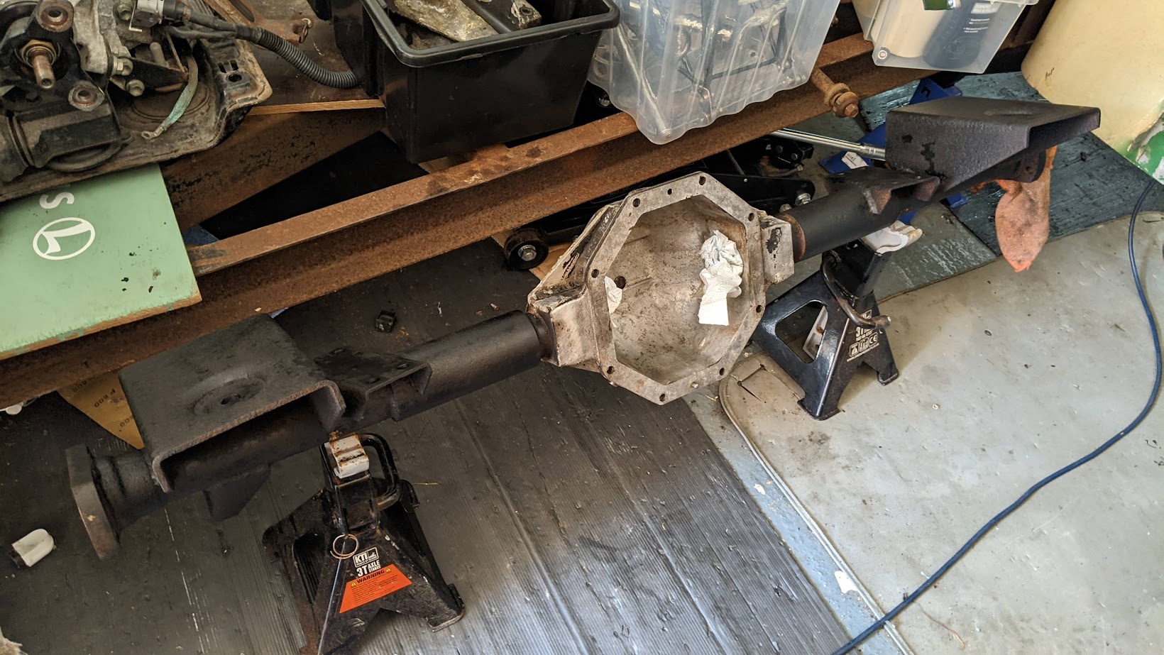

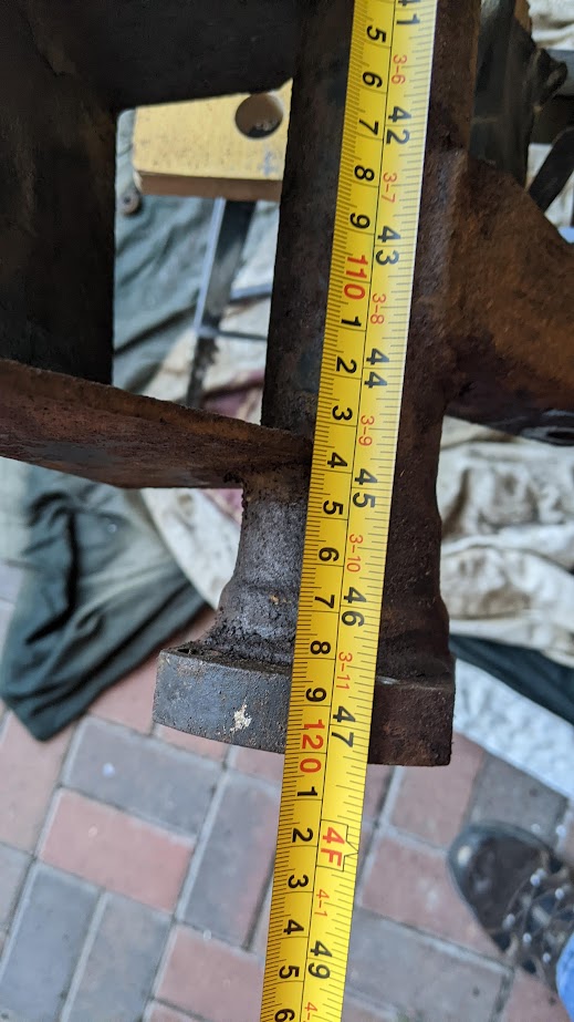

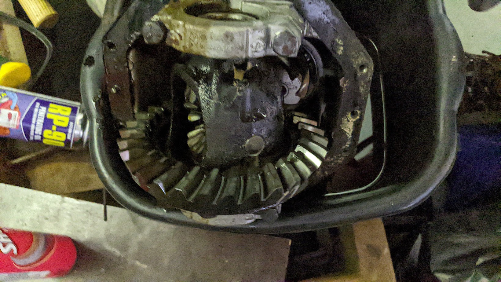

I'm still working on the Otis, got the rear end stripped down, does anyone know what Dana axle this is??
I've looked and I can't find anything about it, I don't know if it's going to be strong engough for my lead foot!!
The axles are 10 spline and 1.15" thick, they have ford 4.5x5 brakes and it's quite narrow
The ratio is 5.125:1 and it has an aluminum center section
What do you think? Swap it out for an 8 inch or risk it!
