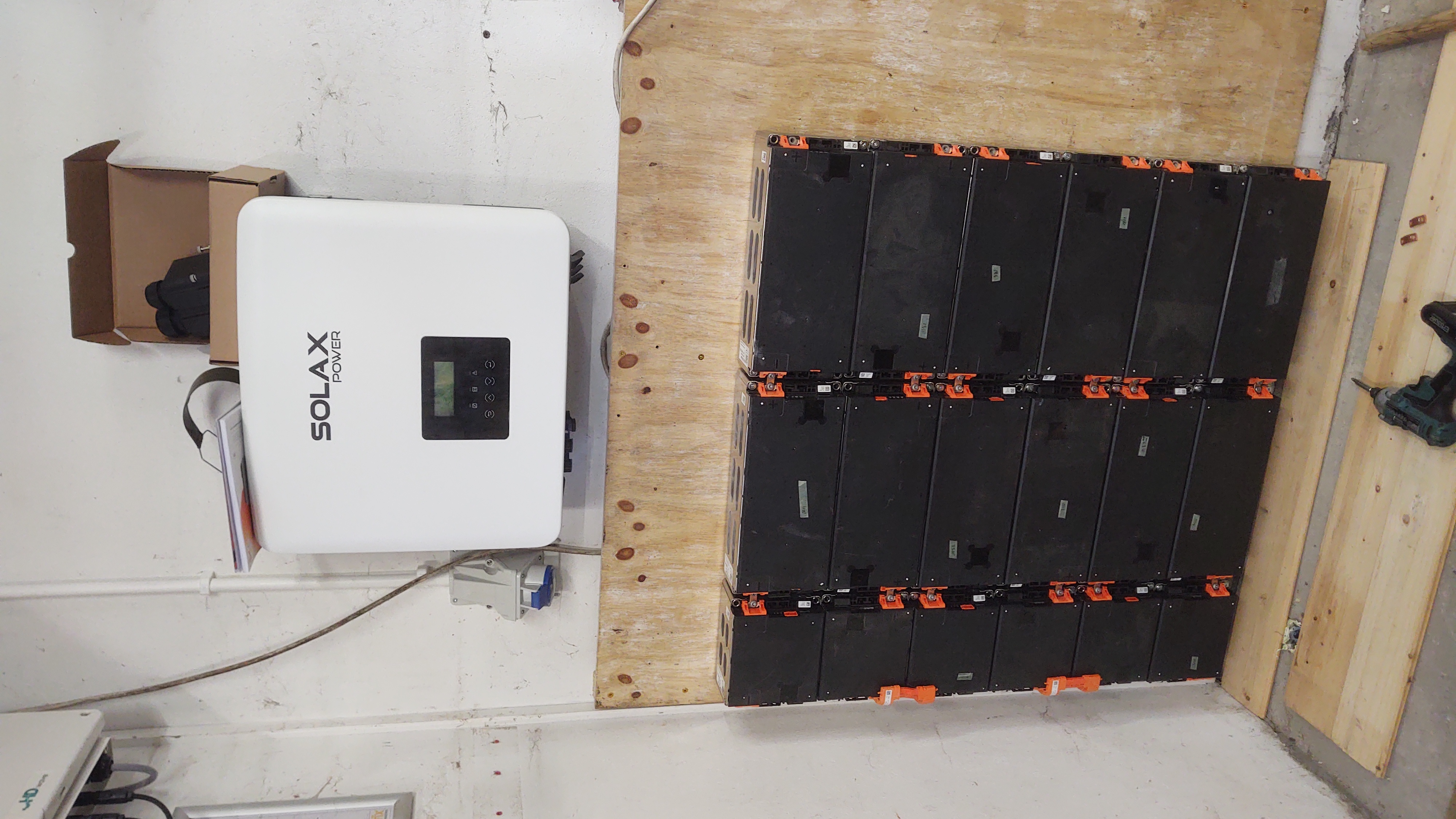

If you have been following my EV conversion you may remember a couple of years ago I bought a second eGolf battery pack. I only needed a couple of the modules from this pack for my EV so I had a lot of modules waiting for a new project.
Well this is it!

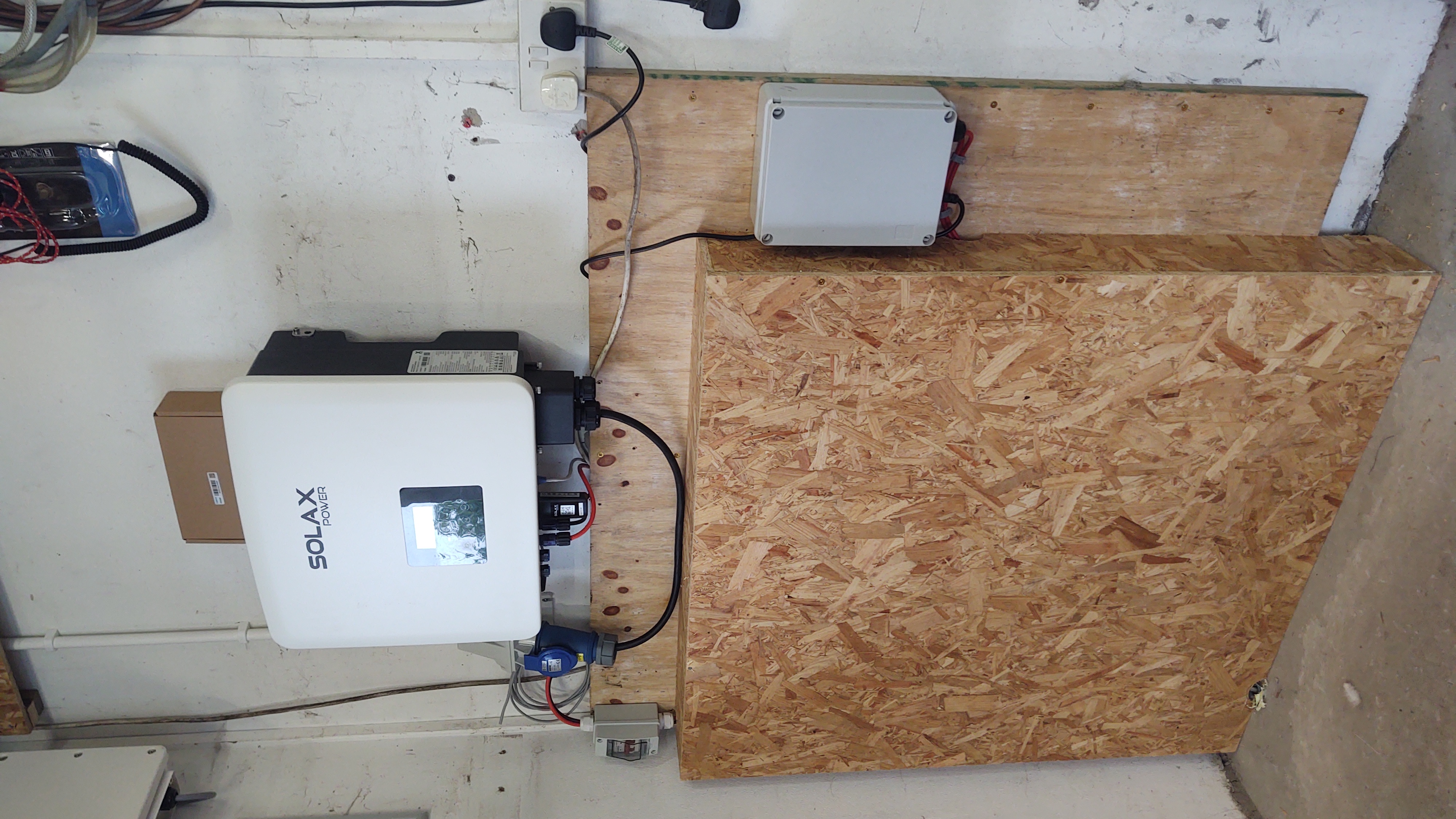

In early 2022 I had Solar panels installed by a professional company. They installed a 4kW array with a Solaredge 3.68kW inverter (the max I was allowed to export without applying for a bigger export) and a Solar iBoost controller to give us hot water. This setup has worked perfectly since then but things change and I now have an MG5 EV as well as my Freelander conversion so have switched to a cheaper night time tariff and I wanted to use the batteries from the 2nd eGolf pack as a powerwall.
I wasn't sure what the best plan was to integrate with my current setup or even if it would be possible to use another inverter along side it but eventually plumped for a Solax X1 G4 5kW Hybrid Inverter which I bought cheap on Ebay even though it was brand new in box. I wanted to be able to charge the Freelander (it only has a 3kW charger) and run the house at the same time so I figured the 5kW inverter would work for this plus there are times we have cooker, kettle and other stuff running so 5kW was the minimum that could cope with such loads. It might not cover everything 100% of the time but I have no intention of going off grid so it's a fair compromise.

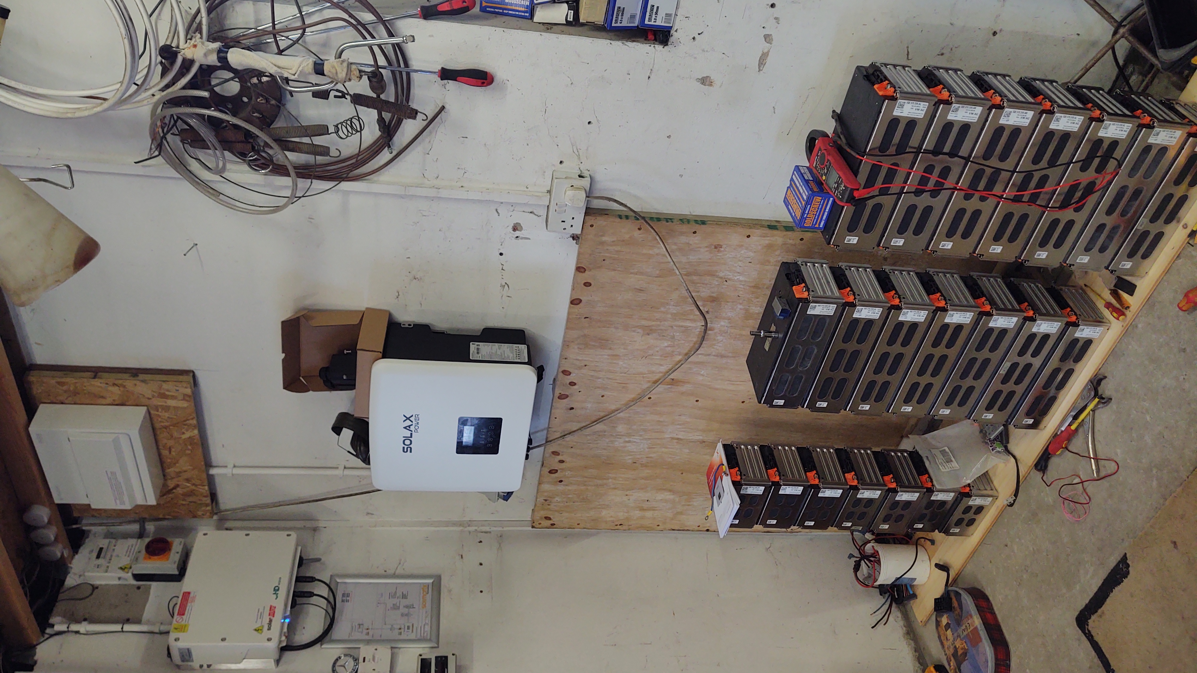

This is the inverter mounted in my garage And here the battery modules are mounted and partially connected My plan was to use it to charge the batteries using night time cheap electricity and run the house off it during the day but I wasn't sure what would happen with the excess power from the panels and how it would work with the Solar iBoost controller. The current sensors for the iboost and the inverter are now beside each other and as best I can tell they seem to be sharing the power from the solar panels and I don't think much if any is being exported. At least not since it was installed as the weather has not been that sunny.
From a financial point of view it doesn't matter much anyway as my export income is similar to the night time tariff at around 15p per kWh.
If you're in England on Octopus you will probably pay half that but sadly there is little competition here and the price for leccy in NI is stupidly high.
If anyone is concerned I have the export function of the Solax inverter turned off to prevent the leccy board from complaining. It would only be worth exporting if the night tariff was more than the export income anyway.
For now I have no BMS for this pack so am keeping the max voltage low at 3.9V per cell and min voltage at 3.6V per cell and will monitor the cell voltages to ensure none of the cells get out of balance. Hopefully I'll be able to sort a BMS soon.
For this reason I have to run the inverter in Lead Acid mode which is not ideal but should be OK with the voltages being somewhat conservative.
So I still need to monitor the setup and confirm how it will work long term but for now it seems to be working well. I am completely new to Solax inverters so if anyone has any tips or advise please share.
It would also be nice to install some solar for this inverter to save on the night time charging but that is for another day.

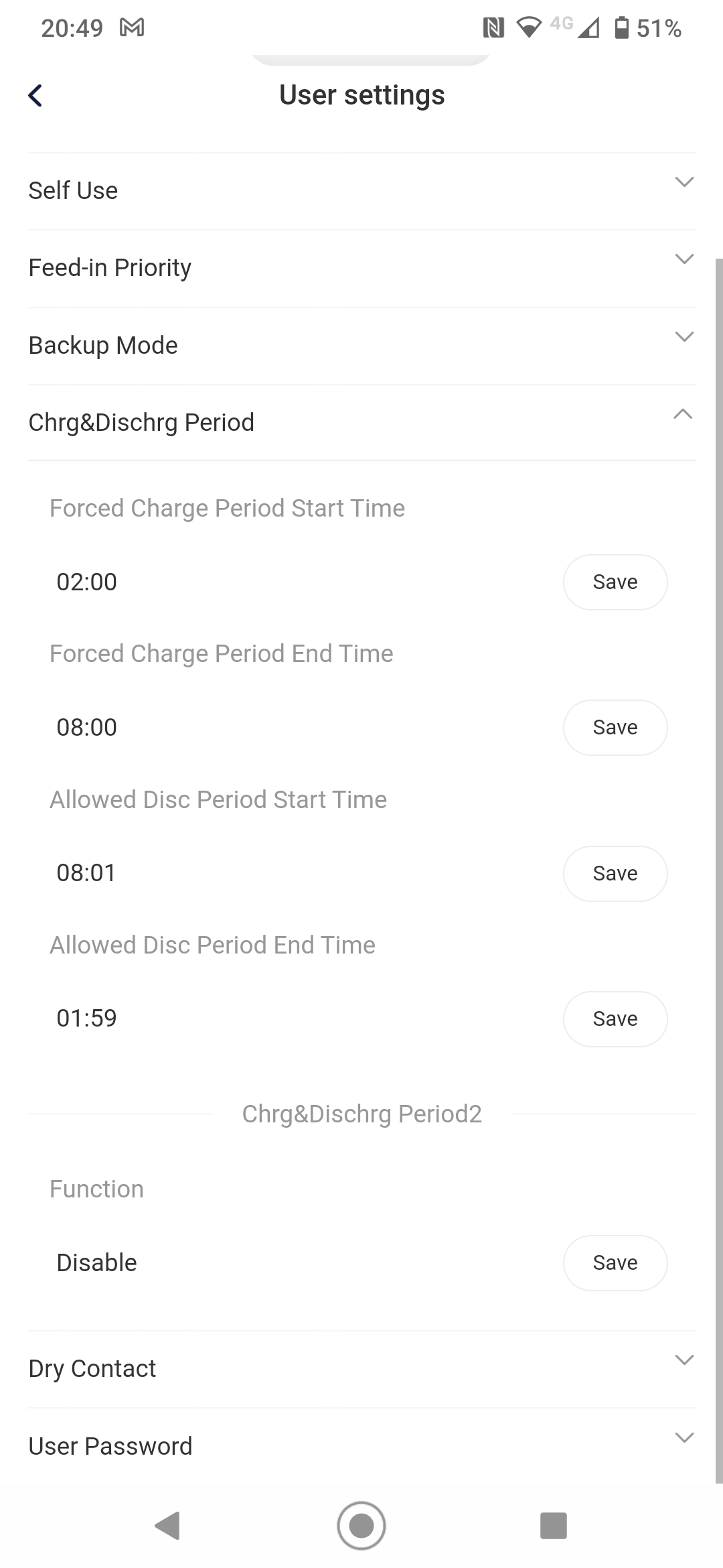

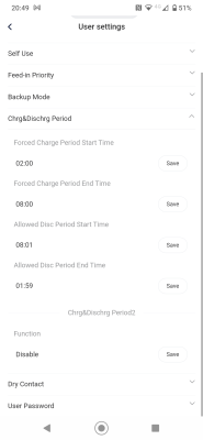

Thanks for the replymuehlpower wrote: ↑Sun Aug 18, 2024 2:01 pm I have a system with 2 Solax X3 G4 inverters and a triple power battery. Everything works as it should for me. Have you set the charging and discharging times correctly?
I think so, Forced charge time starts at 02:00 and ends 08:00
Discharge starts at 08:01 and ends 01:59
It seems to charge OK but like I said sometimes gets into a funny state where there is solar being exported to the grid from the Solaredge inverter and it's not until I reset the Solax that it grabs that power and puts it into the battery. I need to confirm what will happen if I don't intervene. I'll keep an eye on this and report back.

Why do you use charge/discharge times? I have only set priority self-consumption.

The price I pay for night time is similar to the price I receive for export so it is better to have the battery fully charged every morning.
Also many days my Solar is not sufficient to charge the battery fully.
The cheaper electricity is from 1am to 8am in the winter and 2am to 9am in the summer, so to save me having to change it twice a year I set it to charge from 2am to 8am.

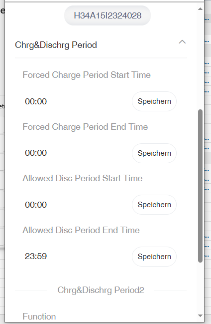

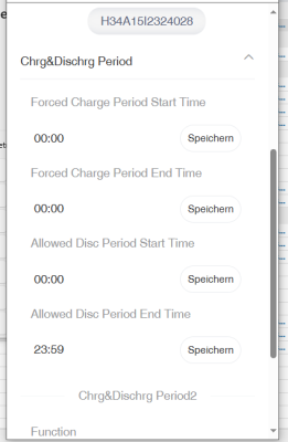

Your discharge time is over midnight, or the end time is less than the start time. Have you tried splitting it up from 8:00 to 23:59 and 00:00 to 1:59?

I see what you mean.
I'll set the discharge to end at 23:59 then use the 2nd charge discharge option to start discharge from 00:01 until 01:59 and see if that works.
If not I'll just forget about 00:00 to 02:00 as there will be very little drain then anyway.

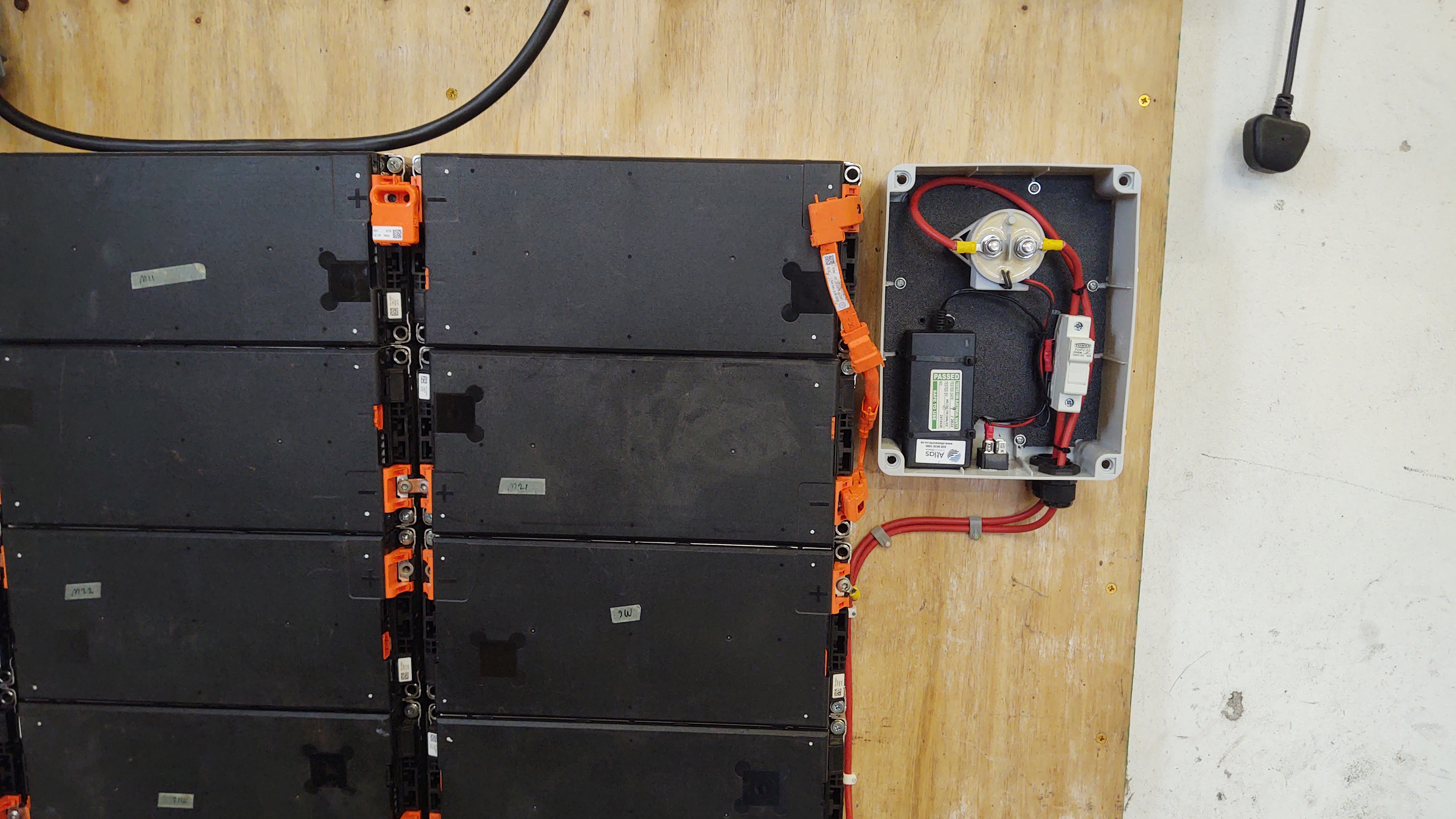

Hopefully things are a wee bit safer now I've added a 25A fuse and contactor to the middle of the pack and a box to cover the modules is in production.
I'm just waiting for an emergency off button so I can kill the output from the pack easily by cutting the 12V to the contactor. It's a 300A contactor so should easily be able to cut the DC current in an emergency. If there was a runaway condition drawing loads of current then the 25A fuse will blow. I also plan to build a wooden cover for the pack today to make it safer.

The box is pretty much sorted now.
x
x

Nice fire risk. I hope your garage is not attached or built into your house. You could at least have used some materials that would appear to be fire retardant, not that a lithium fire would really be stopped by anything just contained for a little while.
I doubt any insure would touch this if the worst were to happen.
Have you check on your cell balance recently? How far are you from installing a BMS?

The balance was good last week. The modules all came from a car with only 10k miles, the current is at most 25A, the max full charge cell voltage is 3.95V and minimum discharge cell voltage is 3.5V.tom91 wrote: ↑Wed Aug 28, 2024 7:32 am Nice fire risk. I hope your garage is not attached or built into your house. You could at least have used some materials that would appear to be fire retardant, not that a lithium fire would really be stopped by anything just contained for a little while.
No it's not ideal running without a BMS but I'm not overly worried and am hoping to have it sorted soon.
