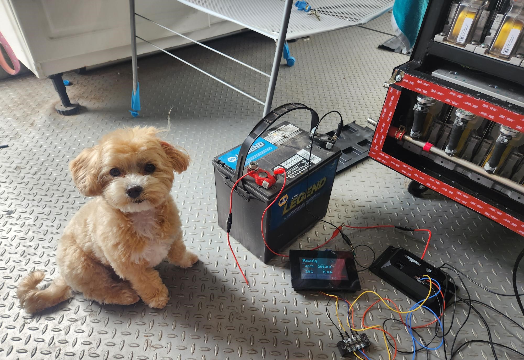

Got the module back into the pack and rewired things up. All cells now reading as normal.
Needed my little emotional support animal to comfort me through this ordeal :D

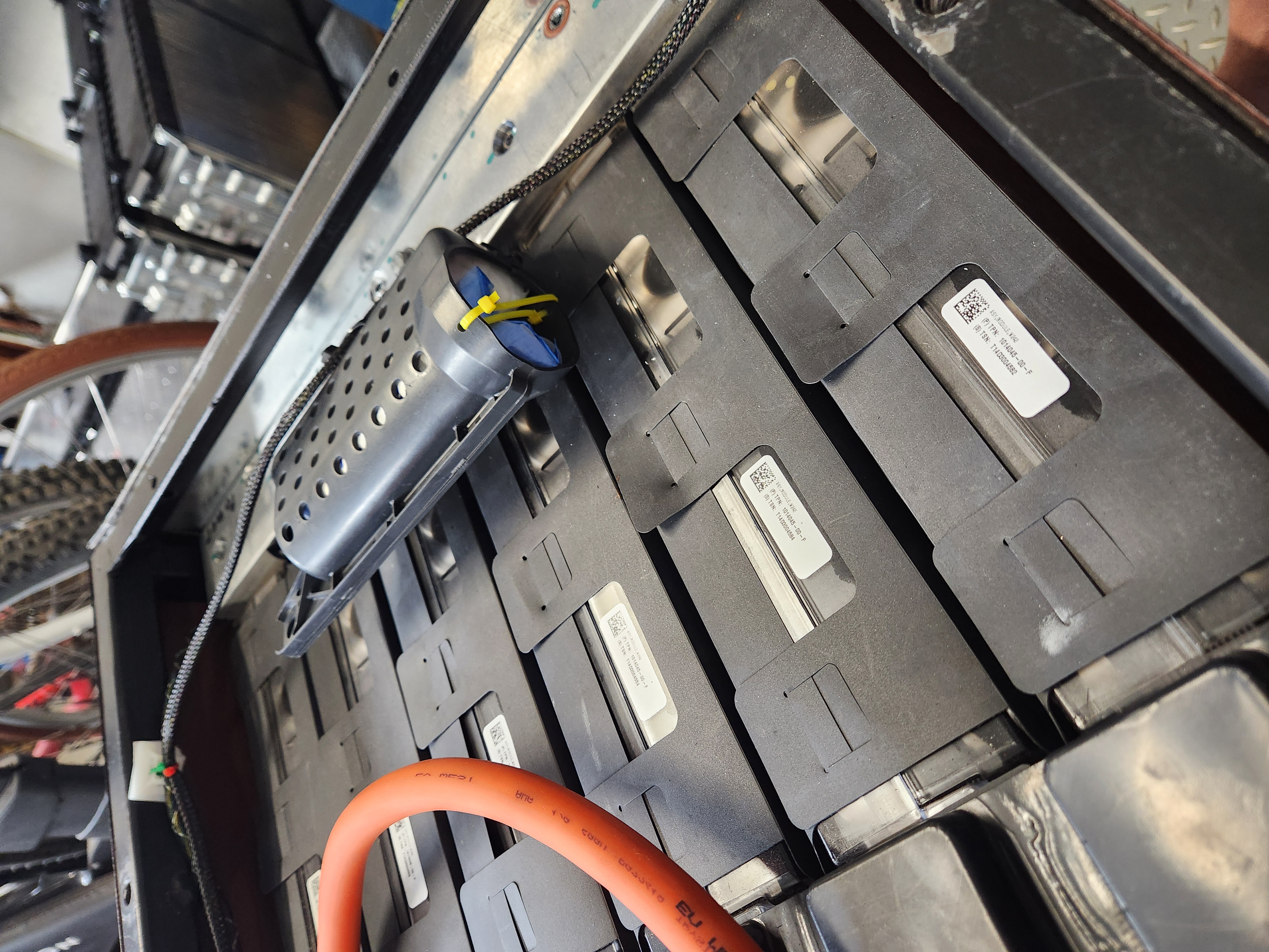

Grafted on the pressure relief parts from the original pack
Cut down and rewelded the Tesla cover plate

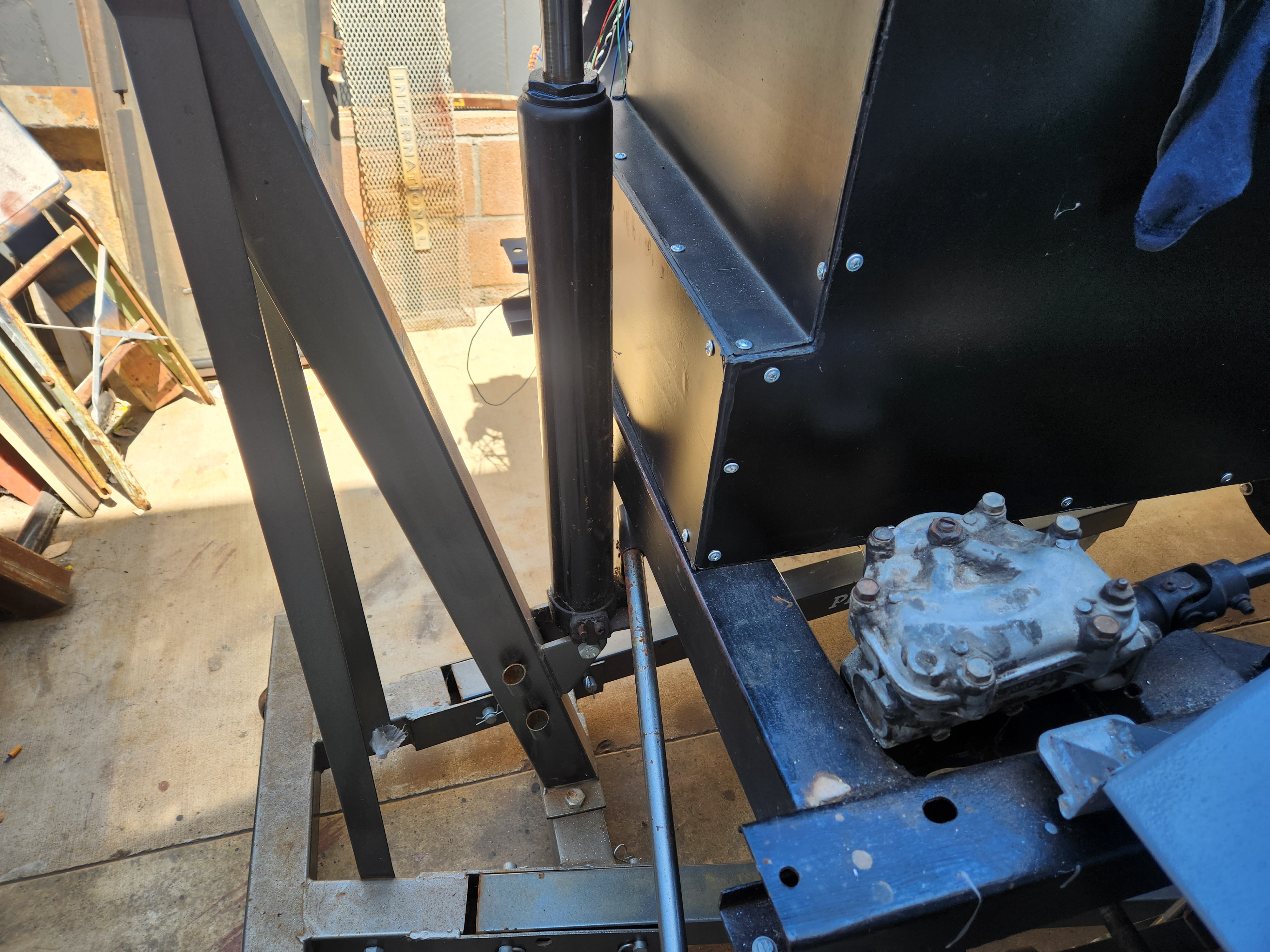

With the battery pack out of the way for now I am back on the truck. Got the brakes mostly sorted. It's a completely revamped setup with new calipers and pads up front, new cylinders and shoes on the back, and all new brake lines throughout with a residual pressure relief and adjustable proportional valves to control the rear. I have a Gen 1 iBooster from a Chevy Volt. Powered it up and seems to work well. I know some have reported issues with a juddering at end of travel from the Gen1 iBooster in a classic car disc/drum setup, so far I have not seen this issue, so fingers crossed. The Volt looks like a larger bore master cylinder than others, maybe this helps. Seems like I do have some air still in the system that needs to be addressed even after bench bleeding my master cylinder a 2nd time but I'm going to take a brake :D from this for a while and let my grazed knuckles recover

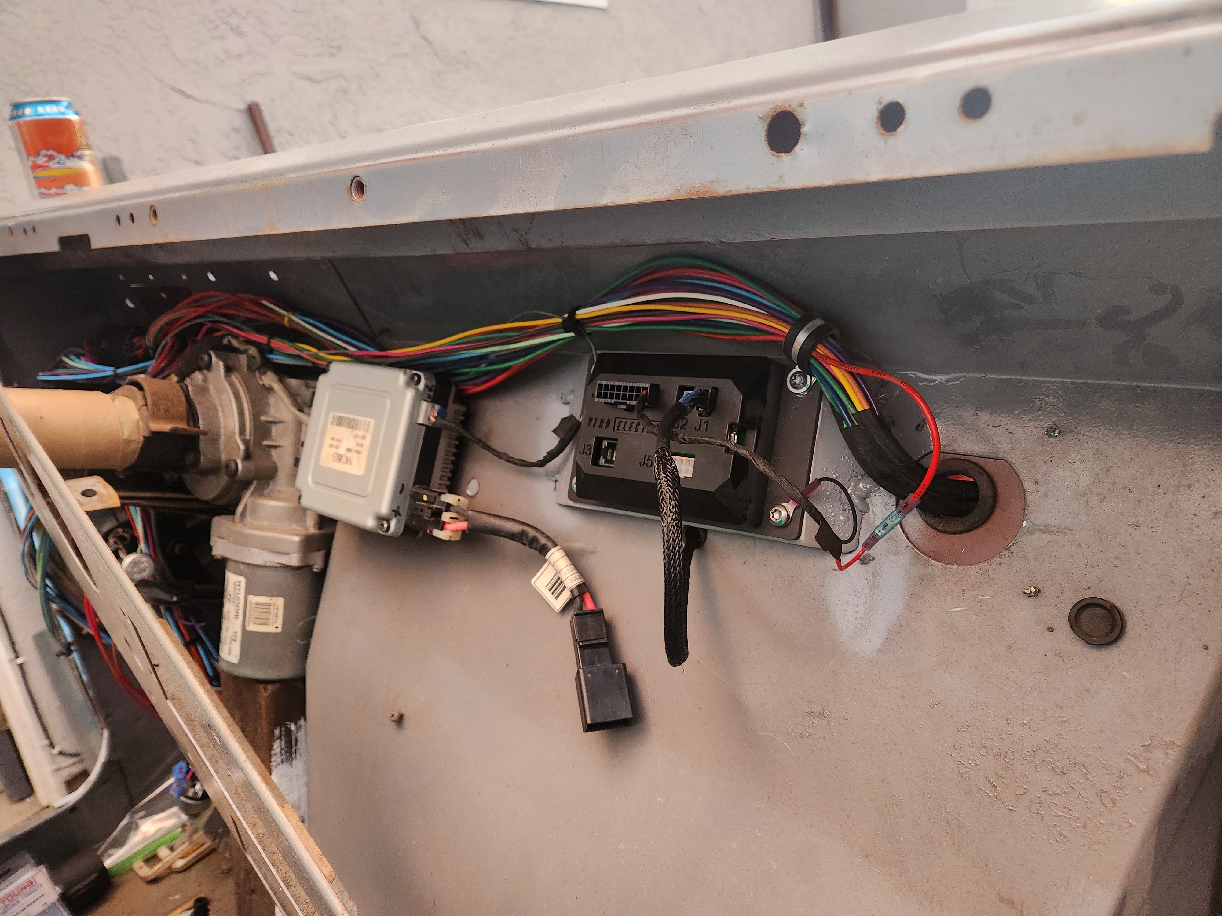

Wiring, wiring. I want to try and get as much wiring and plumbing done as possible before the battery goes in as the access is so good. Starting with the transmission wiring to Zombie and inverter to Zombie. The pre-wired Zombie connector from AliExpress is great, but the downside is that there is a ton of wire from the get-go which gets unwieldy to manage vs. doing one circuit at a time.
My original harness from the LS600H is pretty long, I'll start by coiling it behind the inverter and may thin it later, I want to get things spinning again like I had on the bench before changing anything.

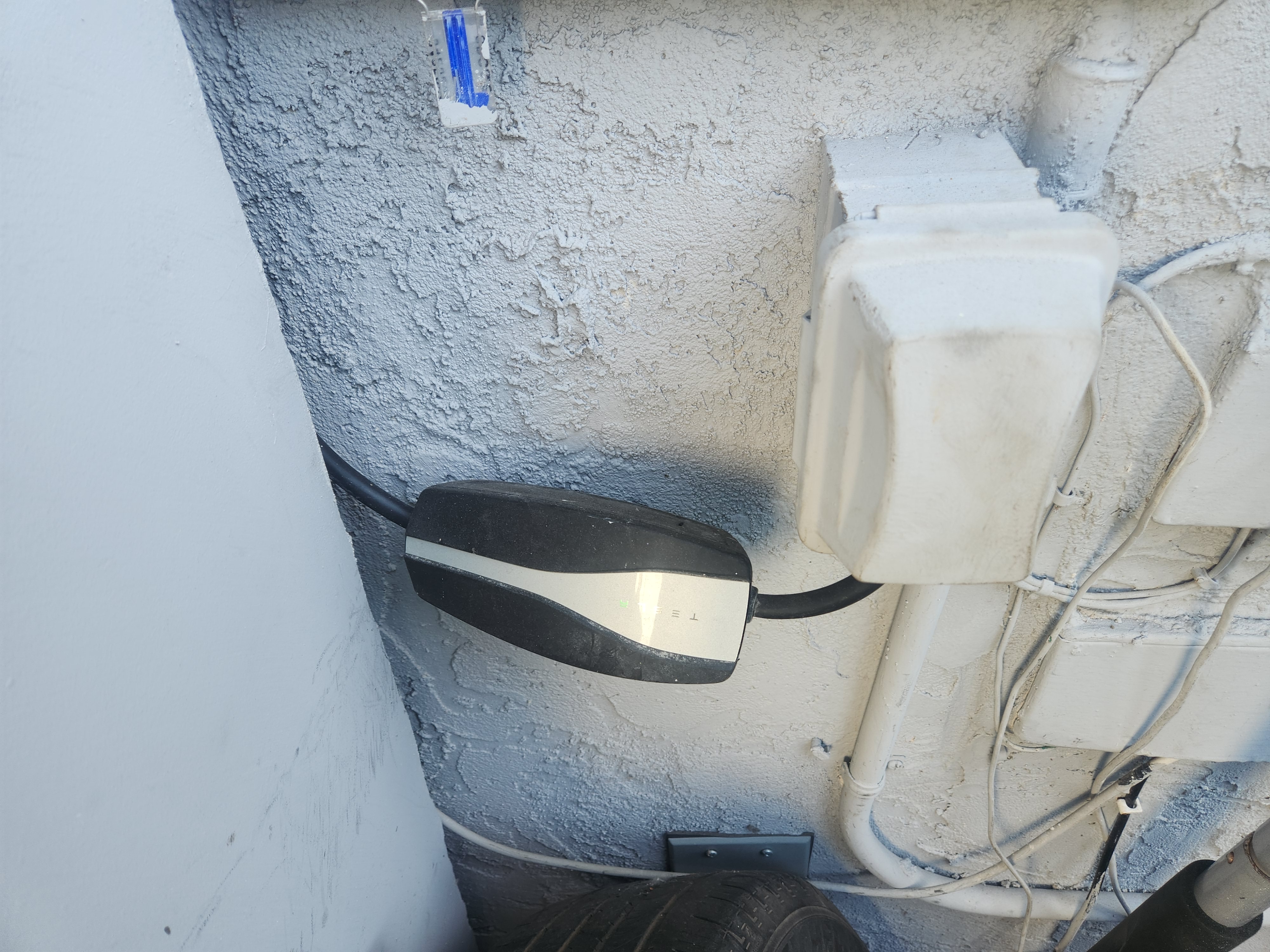

Got the transmission spinning again, this time on HV from the battery pack. Wow, it has a lot more kick than my bench top spin using a 30V power supply!
Time to tackle the charging. My using the Outlander combo charger/DCDC, imported from eBay seller on ebay since they are not readily available here in the US. This is how it arrived, absolutely no packaging material whatsoever. I hope Mitsubishi passed all their ISTA drop testing requirements!
Bought a pigtail connector from AliExpress for the low voltage power/comms plug. Got a lot of help from some folks here on finally getting everything all setup. Used an Arduino UNO + Can BUS Shield to read the can messages and got help decoding these to tell me that I didn't have a valid CP signal
Tried using the oil pump PWM signal, to no avail. Then I tried my wife's Tesla mobile charging connector with a NACS to J1772 adapter, connected CP wire from charging cable to the charger and voila, heard the relays close inside the Tesla charging unit!
'All circuits are busy' :D :D :D Huge relief for me to get this running. Big thanks to all that helped me!
