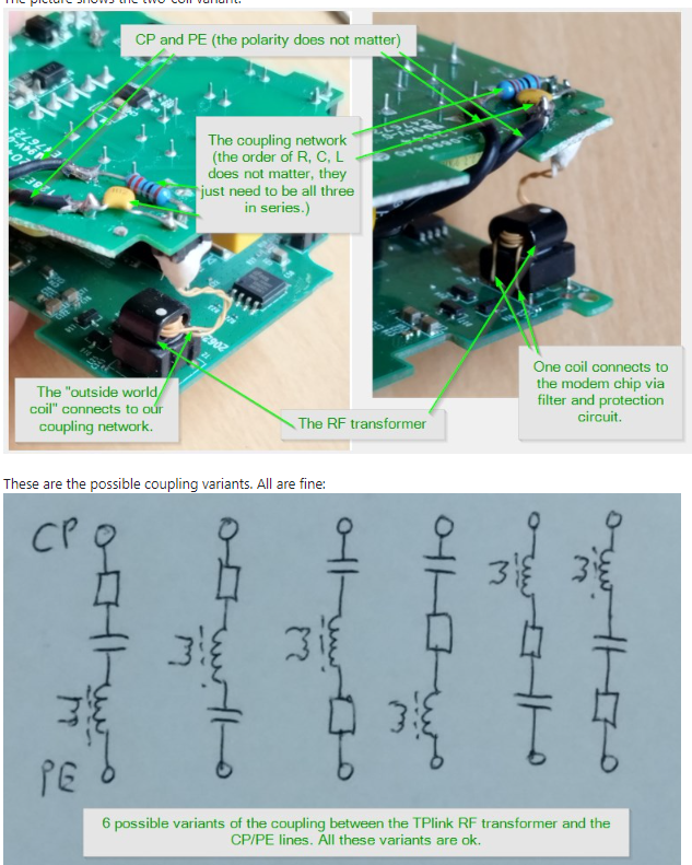

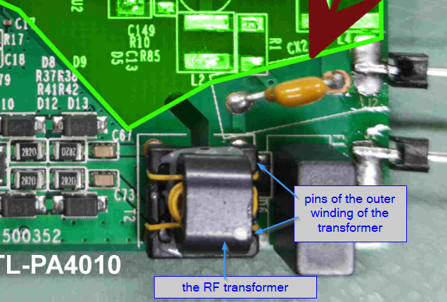

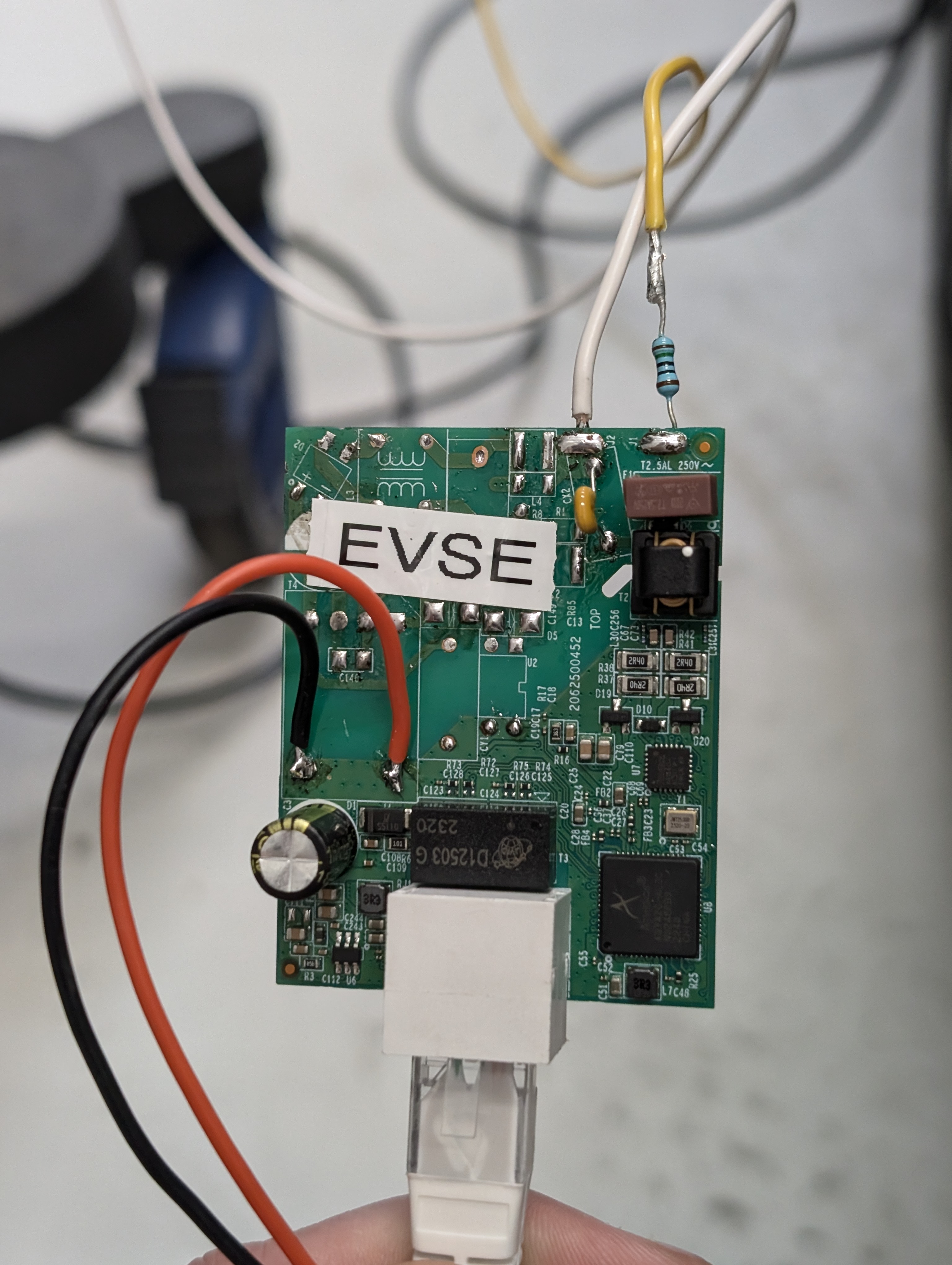

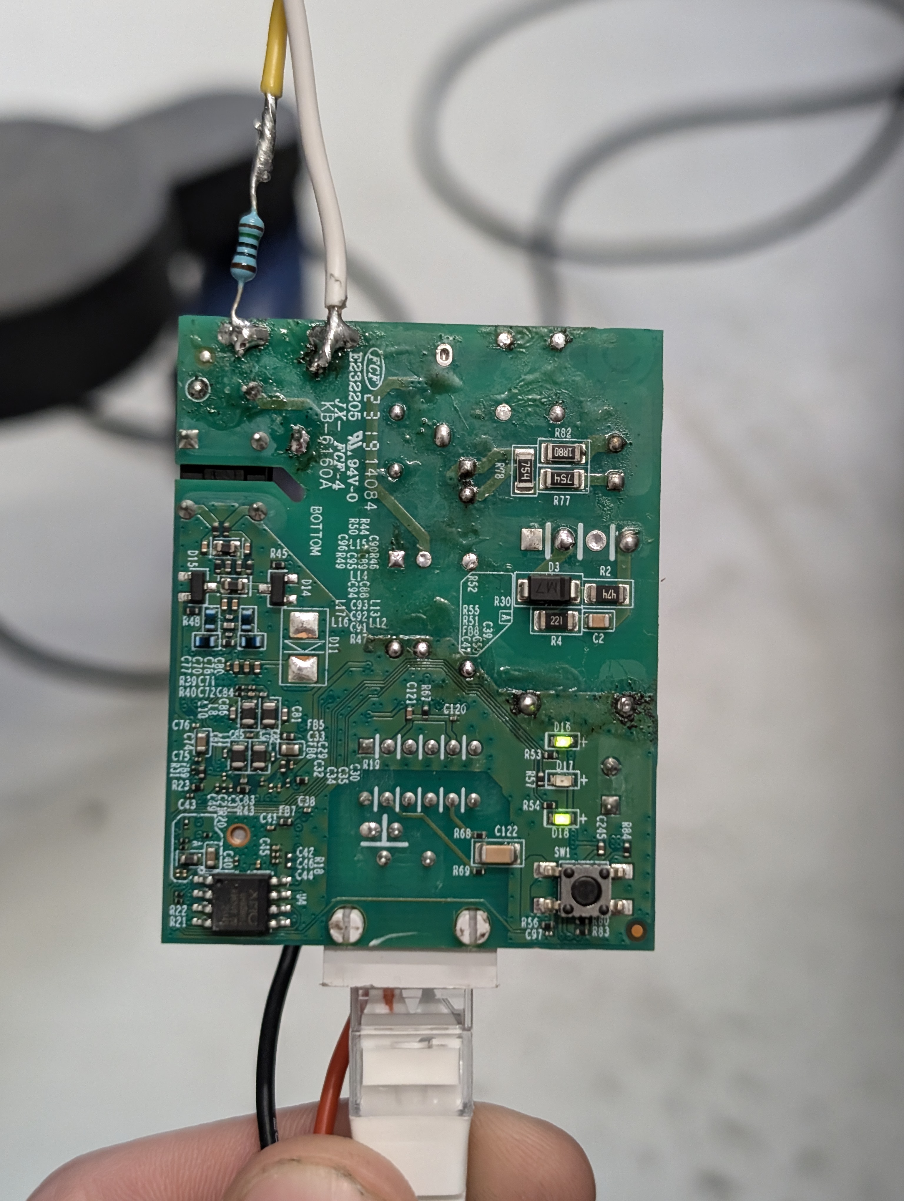

p477d343 wrote: Wed Jun 19, 2024 10:25 am Hello, I have a same board as yours(TP-PA4010). I have some problem when I try to do the hardware part. Do you remove all the crossed off unit on the board and finally work? Can I take a look at your board and see how do you wire CP and PE on the board? It would be a huge help! Thank you!
I have used the PA4010 As well.
The capacitor i placed at CX2 is 1nF and the resistor is 150 ohms.
I have made a report of the steps we have taken to discharge a vehicle; this is a little snippet on how to flash the PLC adapter:

  2. On the raspberry Pi, the LAN port configuration needs to be changed for supporting this adapter. See guide: https://github.com/uhi22/pyPLC/blob/mas ... ernet-port
  3. Download the original and customized firmware that is able to route SLAC packets from LAN to RF and vice versa: https://static.tp-link.com/TL-PA4010%28 ... 160316.zip
    https://mega.nz/file/ocNDhYzK#xuSQXd-b6 ... MjZX5WEWHc
  4. Find the mac address of the PLC module: plcstat -t -i eth0
  5. Take a backup of the original PIB (this is the unique parameter configuration for the module, containing things like the MAC address): plctool -ieth0 -p original.pib <mac address>
  6. Copy over the PIB Block: cp original.pib evse.pib
  7. Modify the PIB Block:
    • setpib evse.pib 74 hfid "EVSE"
    • setpib evse.pib F4 byte 2
    • setpib evse.pib 1653 byte 2
    • setpib evse.pib 1C98 long 10240 long 102400
  8. Write the new firmware to the PLC Adapter:
    plctool -i eth0 -P QCA7420-WallAdapter-HomePlugAV_CE-ClassB_us_401030.pib -N FW-QCA7420-1.5.0.0026-02-CS-20200114.nvm -R <mac address>
  9. Write the configuration to the PLC Adapter:
    plctool -ieth0 -P evse.pib <mac address>
    Now the PLC Adapter should route SLAC messages from RF to LAN.

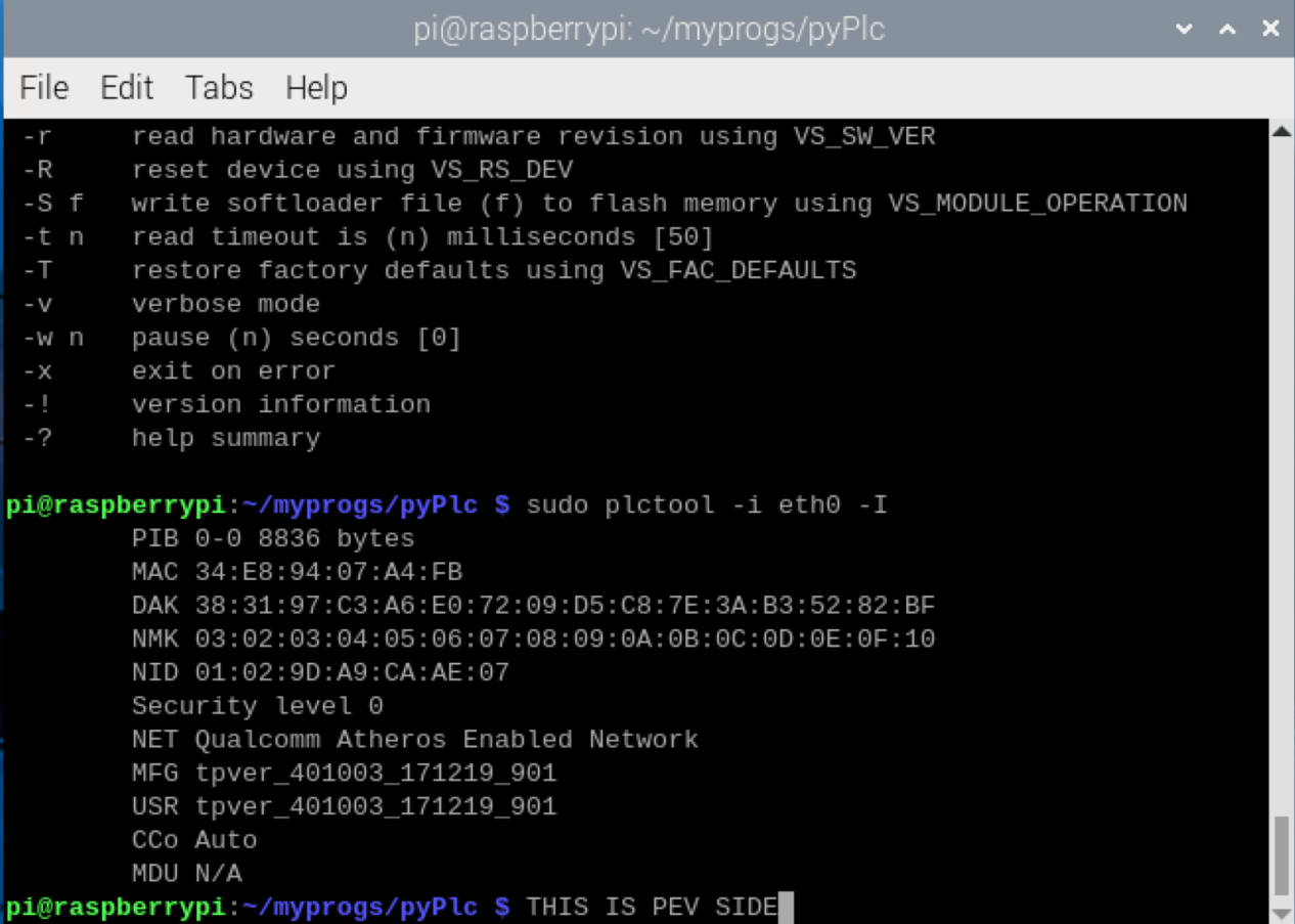

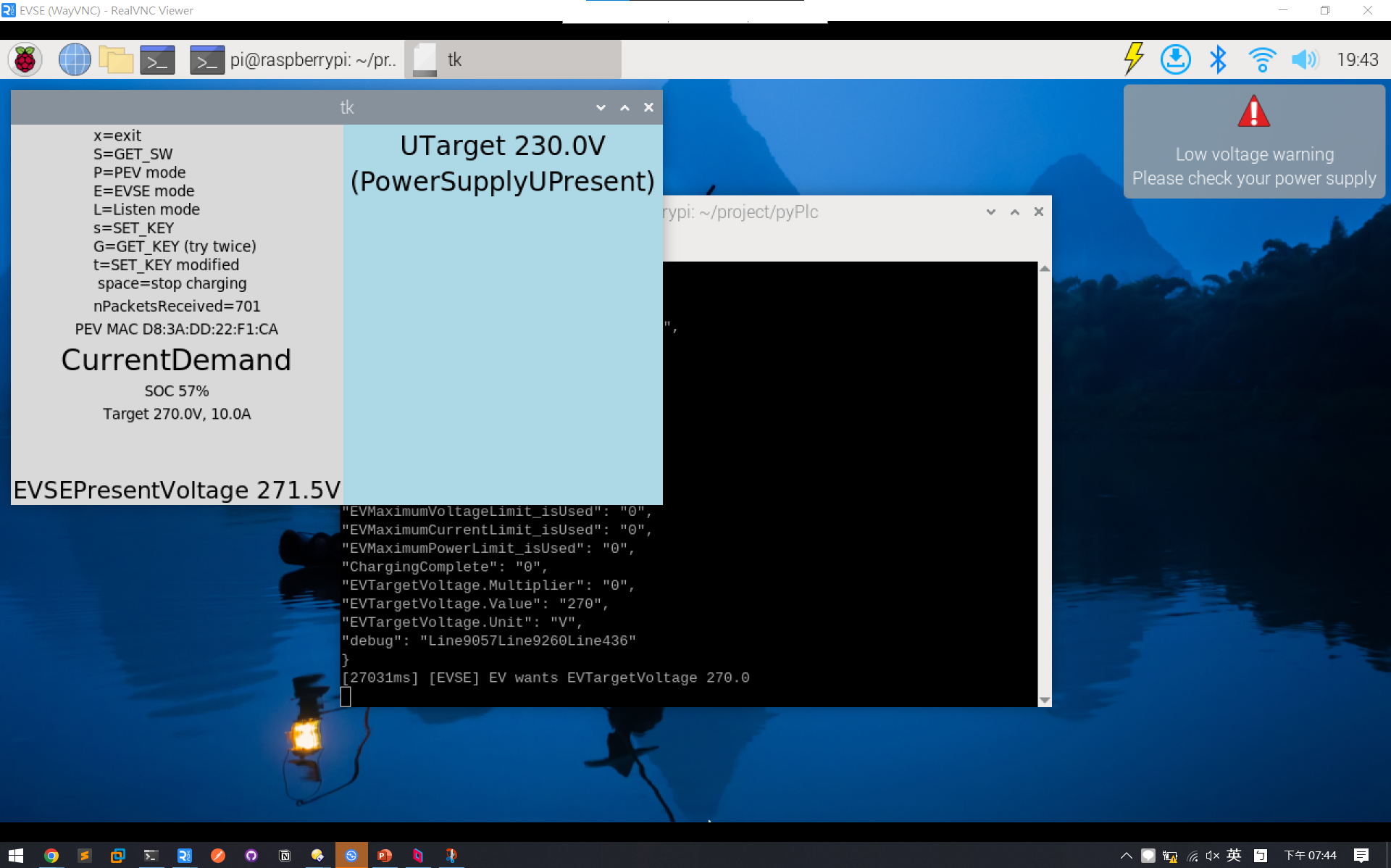

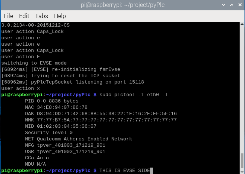

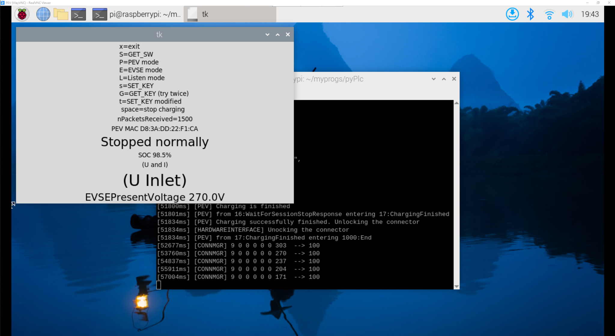

Final update:
After reflash pib file on EVSE and PEV side. And reboot rasbpery pi on both side. Then running pyPlc.py E and P mode on both side. It finally blink 3 leds on and charging successfully.
So I tear down parts and connect EVSE's modem and PEV modem only. Power by 5V 18650 battery. When I power up. The mid led was not blanking at both side. So I check both with command
sudo plctool -i eth0 -I
and find out my USR on both side is not EVSE and PEV as it should be. Is this meaning that I not flash the right pib to both modem?
Quick update.
I flash pib again and it shows up EVSE and PEV now. I press the reset long enough to reset. It will show 3 leds light up and I run pyPLC.py E ans P mode on both side will give me following error. And by pressing the reset button. It will reset my the USR from EVSE and PEV to USR tpver_401003_171219_901. And NMK would be different.
My EVSE side:
pi@raspberrypi:~/project/pyPlc $ sudo python pyPlc.py E
starting in EvseMode
initializing pyPlcWorker

My PEV side:
pi@raspberrypi:~/myprogs/pyPlc $ sudo python pyPlc.py P
starting in PevMode

EVSE modem info after flashing to EVSE.pib
pi@raspberrypi:~ $ sudo plctool -i eth0 -I
	PIB 0-0 8836 bytes
	MAC 34:E8:94:07:86:78
	DAK D8:94:DD:71:42:68:8B:55:38:22:1E:16:2E:EF:5F:16
	NMK 77:77:B7:5A:77:77:77:77:77:77:77:77:77:77:77:77
	NID 01:02:03:04:05:06:07
	Security level 0
	NET Qualcomm Atheros Enabled Network
	MFG tpver_401003_171219_901
	USR EVSE
	CCo Always
	MDU N/A
And EVSE modem info after pressing reset button.
	PIB 0-0 8836 bytes
	NMK 77:77:94:B3:77:77:77:77:77:77:77:77:77:77:77:77
	Security level 0
	CCo Auto
	MDU N/A
PEV modem info after flashing to PEV.pib
	PIB 0-0 8836 bytes
	MAC 34:E8:94:07:A4:FB
	DAK 38:31:97:C3:A6:E0:72:09:D5:C8:7E:3A:B3:52:82:BF
	NMK 03:02:03:04:05:06:07:08:09:0A:0B:0C:0D:0E:0F:10
	NID 01:02:9D:A9:CA:AE:07
	Security level 0
	USR PEV
	CCo Never
	MDU N/A
And PEV modem info after pressing reset button.
pi@raspberrypi:~/myprogs/pyPlc $ sudo plctool -i eth0 -I
	PIB 0-0 8836 bytes
	NMK 50:D3:E4:93:3F:85:5B:70:40:78:4D:F8:15:AA:8D:B7 (HomePlugAV)
	NID B0:F2:E6:95:66:6B:03
	Security level 0
	CCo Auto
	MDU N/A
uhi22
Posts: 1116
Location: Ingolstadt/Germany
Has thanked: 204 times
Been thanked: 611 times
Post by uhi22 »
I never used the button. On my original housing, the button is labelled "Pair", not "Reset". So it seems to set the CentralCoordinator setting to "Auto". This is not what we need here. Just flash the correct PIB on the correct adaptor and do NOT use the button at all. The expected behaviour is:
- PEV has CCo = Never
- EVSE has CCo = Always
These settings are done with downloading the correct PIB. Not with the button.

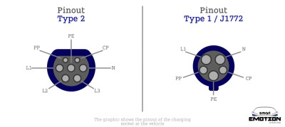

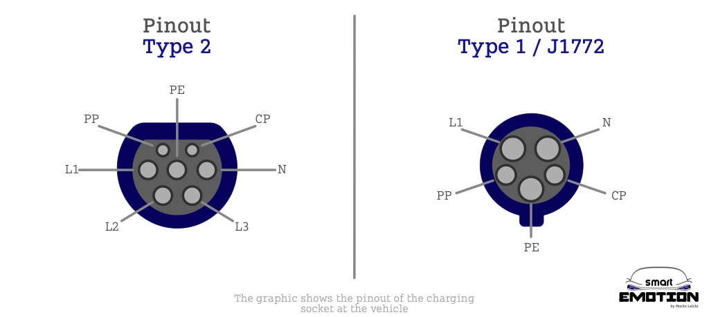

What I mean is in a j1772 charging cable. The real car and EVSEs will connect N and L1 to send current and starting charging without real communication. And miniEVSE will connect to the real car via CP, PP, PE that I separate manually from the j1772 charging cable. And in the other side. The miniPEV(modem only) will connect to the real EVSE via other CP, PP, PE that I separate from the cable from other side.
So what I intend to do is to use miniPEV identity(EVCCID) that I customize myself to charge my real car(not the same identity in miniPEV).
uhi22
Posts: 1116

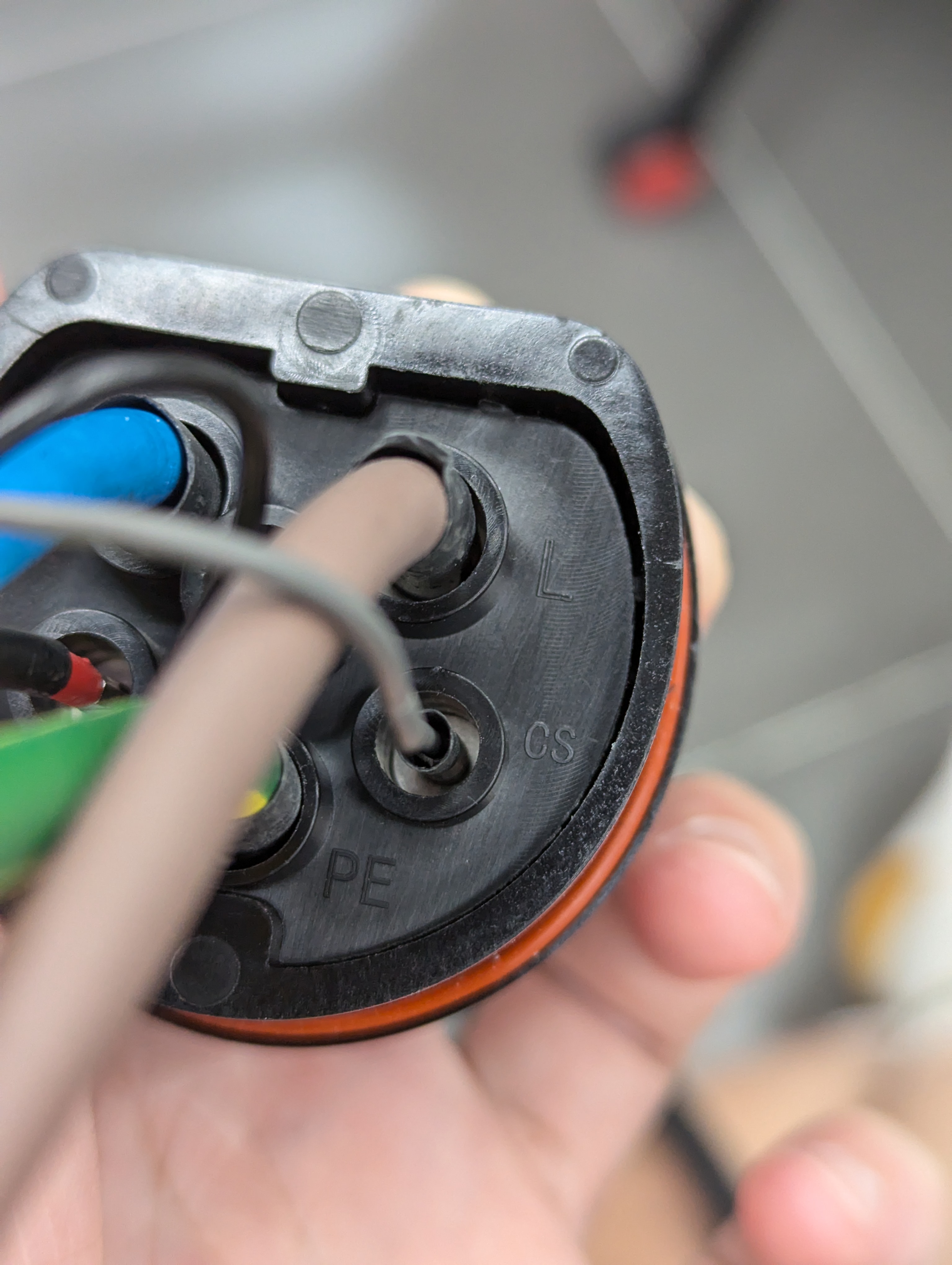

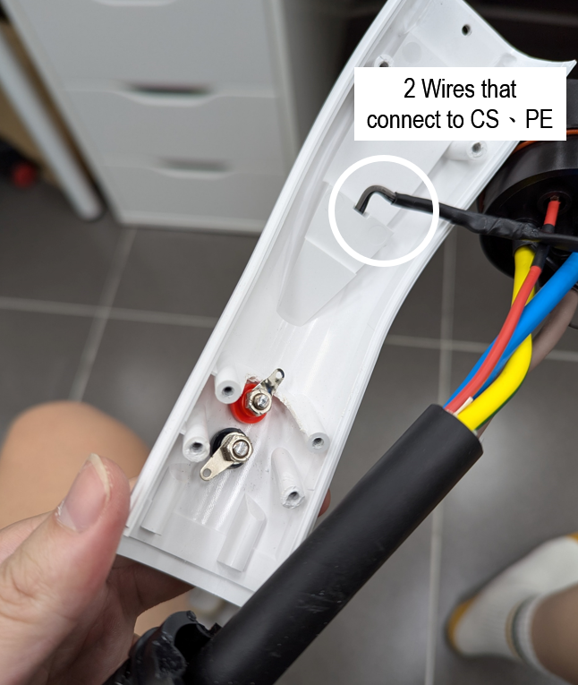

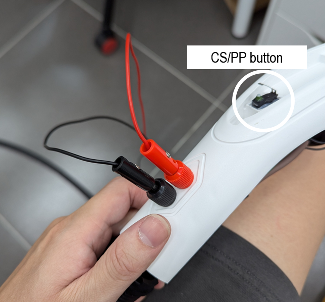

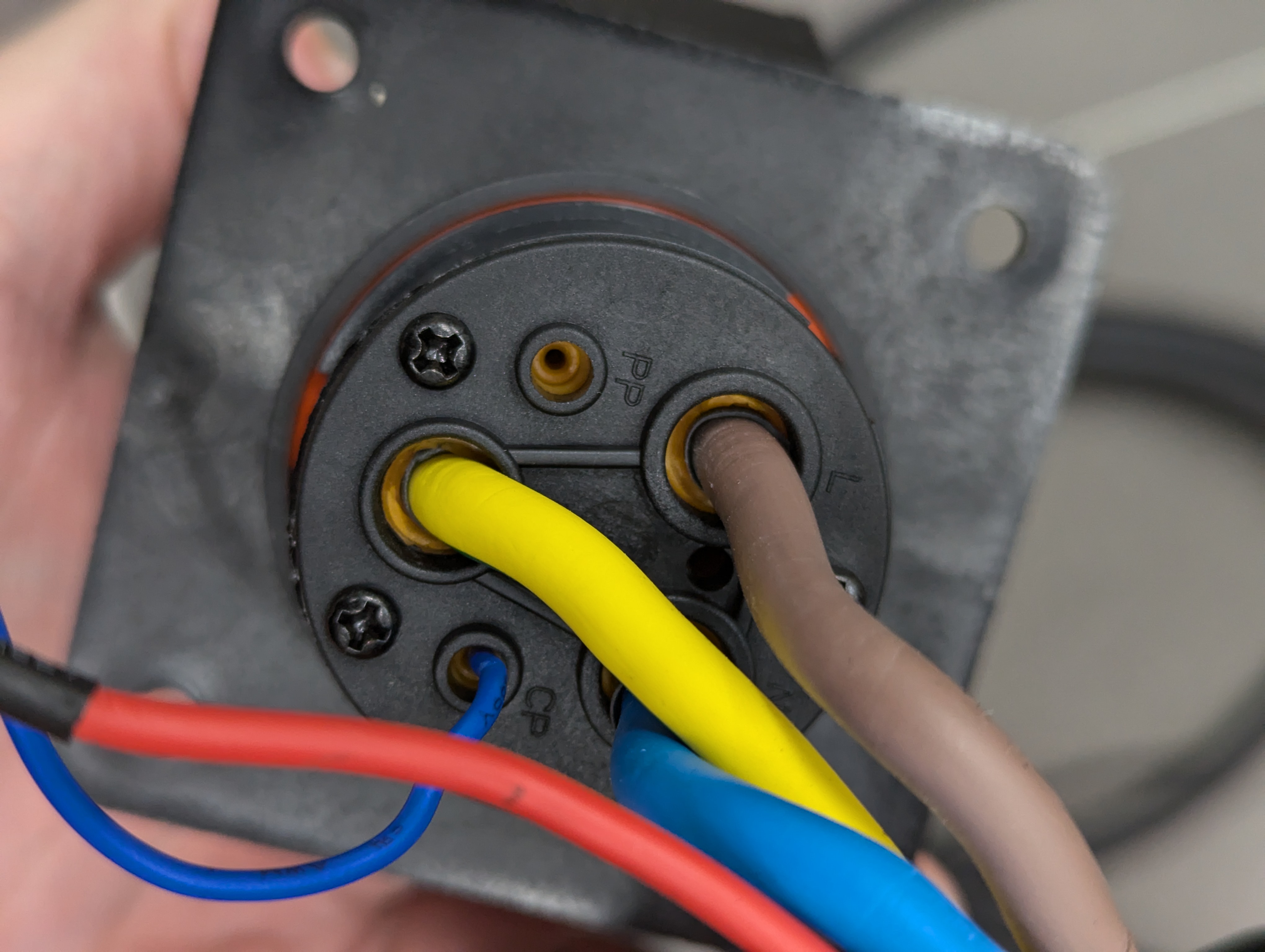

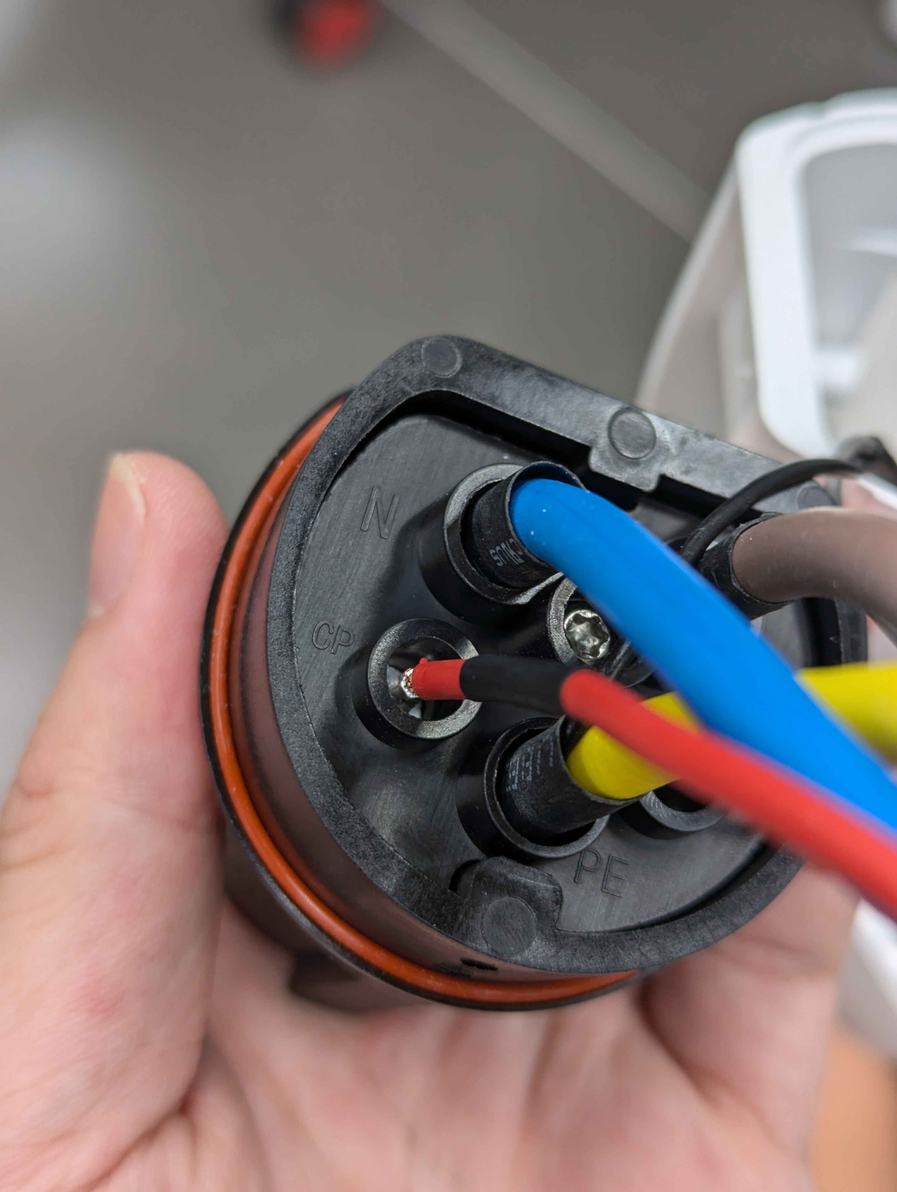

Assuming the 3 conditions to make this work is ignored. So right now. I am doing the cable wiring stuff. I find out the J1772 AC cable I bought last week has N, L1, PE, CP, CS (Control Status) on male side. So CS is as same as PP and control by the CP/PP button on the charger. Did I need to connect CP wire from the cable to my red female plug and CS or/and PE from the cable to my black female plug? Corresponding to miniEVSE's CP and PE plug.
In that case. How did I connect miniPEV to female plug wiring? The PP wire is empty on the cable. In order to connect miniPEV and female cable. Did the PE needs to be like Male cable side that has two wire to connect to the PE plug?
Male cable side.
Female cable side.

There is a misunderstanding regarding the PP and PE I guess. The miniEVSE and miniPEV needs their ground tied to PE. This means, the PE (the green/yellow wire) needs to have a connection to the miniEVSE / miniPEV ground. The second 4mm socket of the miniEVSE/miniPEV is the CP, which carries the powerline communication, and ALSO carries the 12V PWM. And there is a third pin, the PP. This needs a 1k5 resistor to PE at the miniEVSE, and needs a pull-up to 5V on the miniPEV.

uhi22 wrote: Mon Aug 12, 2024 12:19 pm Not sure what you want to do. It sounds like a man-in-the-middle setup, where you route all communication via miniPEV and miniEVSE, and connect the power pins directly from the realEV to the realEVSE.
Yes, we are conducting MITM attack testing on one of our country made EV to make sure its security issue. The goal is to use the legit EV's EVCCID to impersonate its identify, which leads to free charging on the attacker's EV.
uhi22 wrote: Mon Aug 12, 2024 12:19 pm You need to decide whether you want to use this for AC charging or DC charging. Mixing AC and DC does not work physically. So if you want to go the DC way, you need a DC inlet that connects to the real DC EVSE, and you needs a DC plug that plugs into your DC EV inlet.
If you want to go the AC way, you need to extend the state machines and the exi decoder to support the AC specific things, and you need to have an EV and an EVSE which supports AC charging via high level communication.
So I am not trying to mix AC and DC charging together. It's because I only have an AC plug right now. How can I start if I want to change state machines and the exi decoder to support AC high level charging? If not, does it mean DC charging is practically support by most of the EVs? Then I might have to buy another DC charging cable to do this.
uhi22 wrote: Mon Aug 12, 2024 12:19 pm There is a misunderstanding regarding the PP and PE I guess. The miniEVSE and miniPEV needs their ground tied to PE. This means, the PE (the green/yellow wire) needs to have a connection to the miniEVSE / miniPEV ground. The second 4mm socket of the miniEVSE/miniPEV is the CP, which carries the powerline communication, and ALSO carries the 12V PWM. And there is a third pin, the PP. This needs a 1k5 resistor to PE at the miniEVSE, and needs a pull-up to 5V on the miniPEV.
So it might look like this? Both miniPEV and miniEVSE needs to connect their PE wire to cable's PE socket(With origial green/yellow wire). And also the CP wire. And the PE pin need 1k5 resistor to PE on miniEVSE and 1k5 with 5V to PE on miniPEV?
AC charging
realEVSE ---(CP1, PP1(1K5 and 5V from PE), PE)----miniPEV----(Ethernet or WLAN)---miniEVSE----(CP2, PP2(1K5 from PE),PE)-----realPEV
realEVSE ---------------------------------------------------------------(N, PE,L1)----------------------------------------------------------------realPEV (AC Cable)
DC charging
realEVSE ---------------------------------------------------------------(DC+, PE, DC-)----------------------------------------------------------------realPEV (AC Cable)

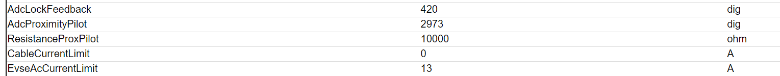

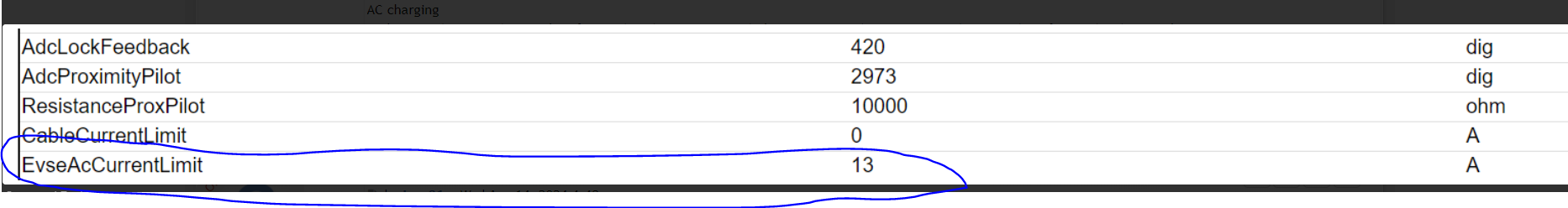

PP calcs are broken for some reason.
So the reported AdcProximityPilot updates but it does not change the resistance correctly. Code snippet shows comments for ppvariant 2 like:
 /* Todo: verify on hardware */
EDIT
U_meas = U_refAdc * temp/4095 * (47.0+47.0)/47.0; /* The measured voltage on the PP. In this case the ADC gets half the PP voltage. */
The math yields 4.79V
if (U_meas>(U_pull-0.5))
        /* The voltage on PP is quite high. We do not calculate the R, because this may lead to overflow. Just
           give a high resistance value. */
        R = 10000.0; /* ohms */
And this is why it then fails to update. Upull = 5.0

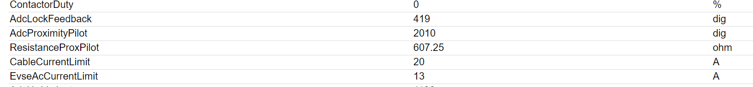

EDIT 2:
Measure the voltage and it is 4.88V with the 680ohm resistance across it from the plug. I pull it out it goes to 12V. Will get on look at what is going on.

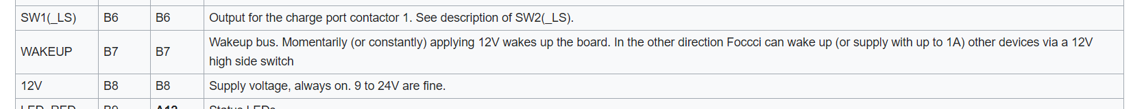

It seems the cpu switches off the keep-on pin which has the secondary function of shorting the 12v pullup for wake up. Try supplying 1kHz to CP and check again
Posts: 2393
Location: Bristol
Has thanked: 207 times
Been thanked: 563 times
johu wrote: Wed Aug 14, 2024 6:20 pm It seems the cpu switches off the keep-on pin which has the secondary function of shorting the 12v pullup for wake up. Try supplying 1kHz to CP and check again
Note the EVSE AC current limit filled in this is with an powered on granny lead and 12V into wake up line. Would a constant 12V in on the wake up cause issues?
EDIT:
I guess the wiki about the Wake-Up is not right saying you can have a constant signal.
EDIT 2:
As soon as wake up is not constant 12V this seems to be working better.
