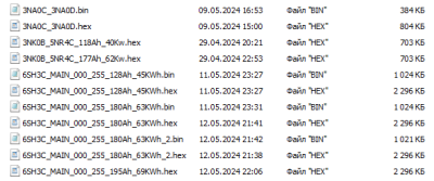

Reprogramming the unit is necessary, otherwise the factory firmware will only process 22KWh, and this is in the case of a wear data reset.
BMS 40KW sees a maximum of 115Ah, and requires a different current sensor.

I modified the firmware of the BMS unit of all generations of Liaf, chip 70F3236 70F3382, in order to expand the range of their operation to the required battery parameters, the most popular CATL 115Ah 120Ah 180Ah..., there is an example of standard BMS30 firmware adapted for BMS24 (3NR4C_BLINK-OFF.kwp).

The 24 kWh BMS current sensor does not need to be changed, only the software is changed.
Unfortunately, it is almost impossible to do this now (RU).

I would also like to use the leaf BMS with bigger and new cells, from a diffrent car.
Marat, or anyone else with the knowledge, could you please descripe how to modify the leaf BMS (which hardware and software is needed to do so)?
I dont understand this: "there is an example of standard BMS30 firmware adapted for BMS24 (3NR4C_BLINK-OFF.kwp)". Where is the example? How can I get the needed files? Which hardware and software is needed to modify the BMS?
