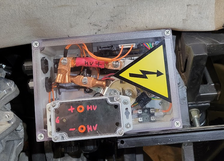

The funny thing about the dcdc wiring is that since I used 14 ga wire, it has to be shielded. But it's only got a 10 amp fuse so I could just replace it with 16 ga wire and then it wouldn't need to be shielded. Lol.
The charger is a little more complicated. Looks like I'd have to disassemble it to replace its wiring. But it's only 3kW and I'd been wanting to upgrade anyway, so I got my hands on a 10kW Tesla gen2 unit. I'm not exactly sure how I'm going to install it yet, but I'm toying with the idea of using it for offboard charging so I'm not carrying the extra weight on track.
So far I've installed the new control board and printed an adapter that will allow me to use 20mm cord grips in place of the old connectors which wouldn't be allowed. It would be kind of neat to give it its own small, self contained coolant loop, so all I'd have to do is connect an HV plug and a LV plug for 12v power and BMS communication. Any suggestions for a small water pump and radiator? I'm wondering if a PC water cooling system would be enough?
Adapter: Untested beyond checking the fitment
And this is the only wire I have found that seems compliant: https://www.iewc.com/catalog/wire-and-c ... 0032129622

Been working on the junction box I need to add to the rear of the car, while also pulling out the old HV cable to replace it with shielded cable (required by the SCCA rulebook). I think I could use some opinions on where to locate my new CCS charge port. I think I have it narrowed down to two options but I'm not thrilled about either.
First, here's the new junction box. Basically the wires from the contactor box come in from the left side, terminate at the posts (which are at different heights), then exit through the bottom of the picture to go to the inverter. The contactors in this box are for the CCS port. The black box in the upper right is the insulation monitor. The cable from the OBC will enter through the cable gland at the bottom middle, where one leg will go through the fuse block and the other leg goes to the live side of the negative CCS contactor.
The random loose plug you see in the above image is for the insulation testing system. The regulations state that you need to bring your HV+ and HV- through some 10k resistors and terminate at a pair of 4mm banana jacks which have a separate cover over them. To test the system you need to connect a cable with one more resistor that will bridge either the HV +/- together or to chassis ground, and the insulation monitor must detect the fault and open the main contactors within a few seconds. Here you can see how I added those ports. I am thinking about 3d printing a cover that looks like a household electrical socket and then making the test cable look like a fork.
And here's a zoomed out photo of the whole boot, showing where the junction box is. The OBC gets mounted to the bracket just below it.
Now for the tricky part, where to mount my CCS port? I had the old J1772 port mounted at the base of the roll bar on the left (see old photo below) but I'm not sure I can fit the CCS port there. If I do, I will need to bring all the wiring across the back of the car and that would be a bit tight, but doable. I would also need to relocate the 12v battery, more work but totally doable. I'm also a bit worried about whether a big CCS plug would clear the roll bar brace. I may have to mount it at an odd angle.
