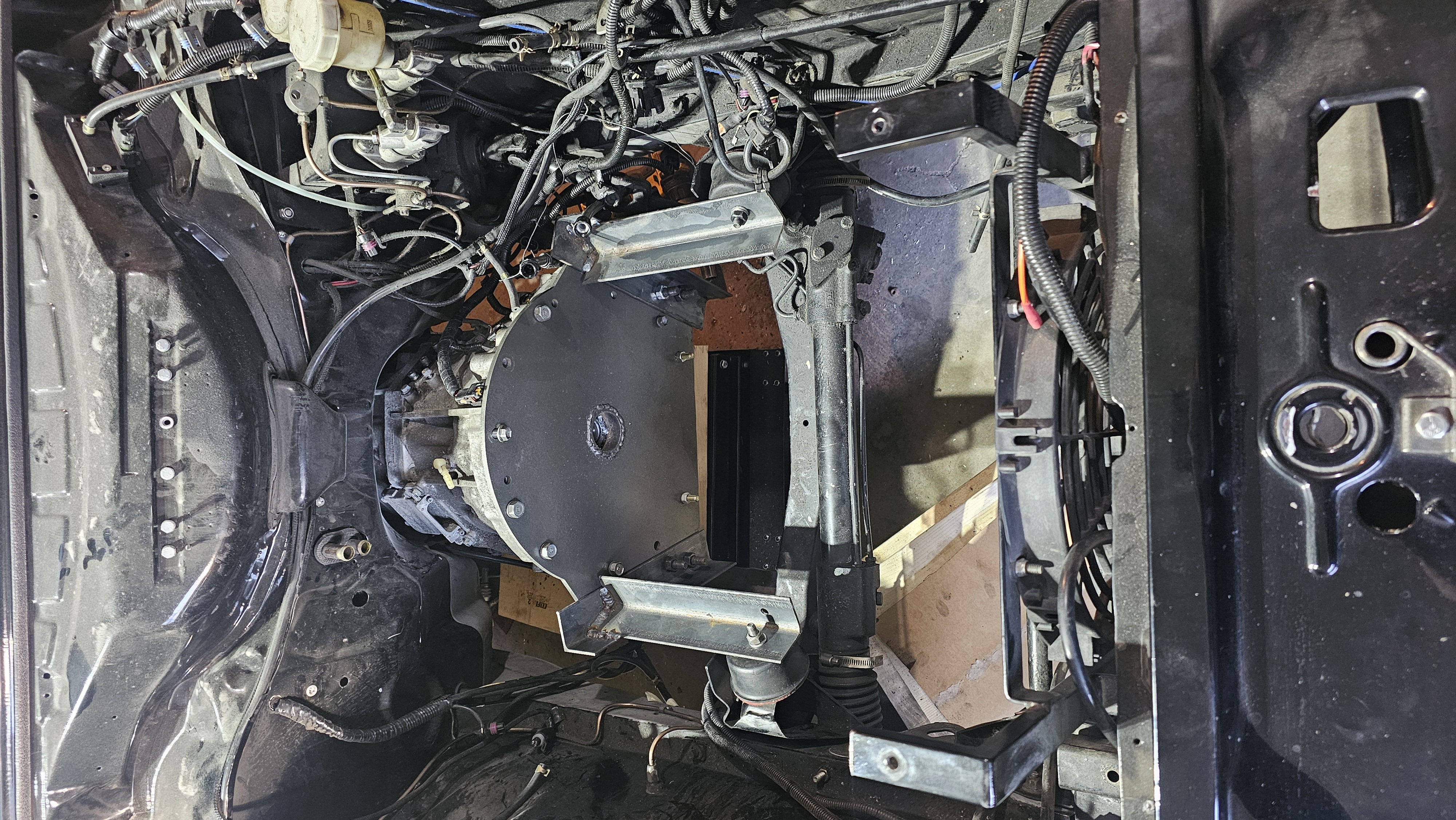

I'm guessing the transmission will not fit, I have a built T5 in there that needed the tunnel modified to fit.
As I'm not limited to a shifter hole I should be able to keep moving it forward until I get the desired elevation and driveline angles.
As I have an 8.8 solid rear on leaf springs I'm considering using the lexus drive but then putting the sliding yoke assembly to the rear of the car on the "pigs head" flange to take up the axle movement, that should technically work fine, its just not sealed from dirt like it would be inside the transmission tail shaft.

Does that pic appear sideways on everyone else screen too!!??

Re: WIP 1974 Ford Capri + GS450H
Not a lot to report.
Got front plate cut, 3d printed some stuffs.
Zombie arrived!
Comparison pics of the 450h vs a T5.
Got oil pump bearings too.
Zombie arrived!
