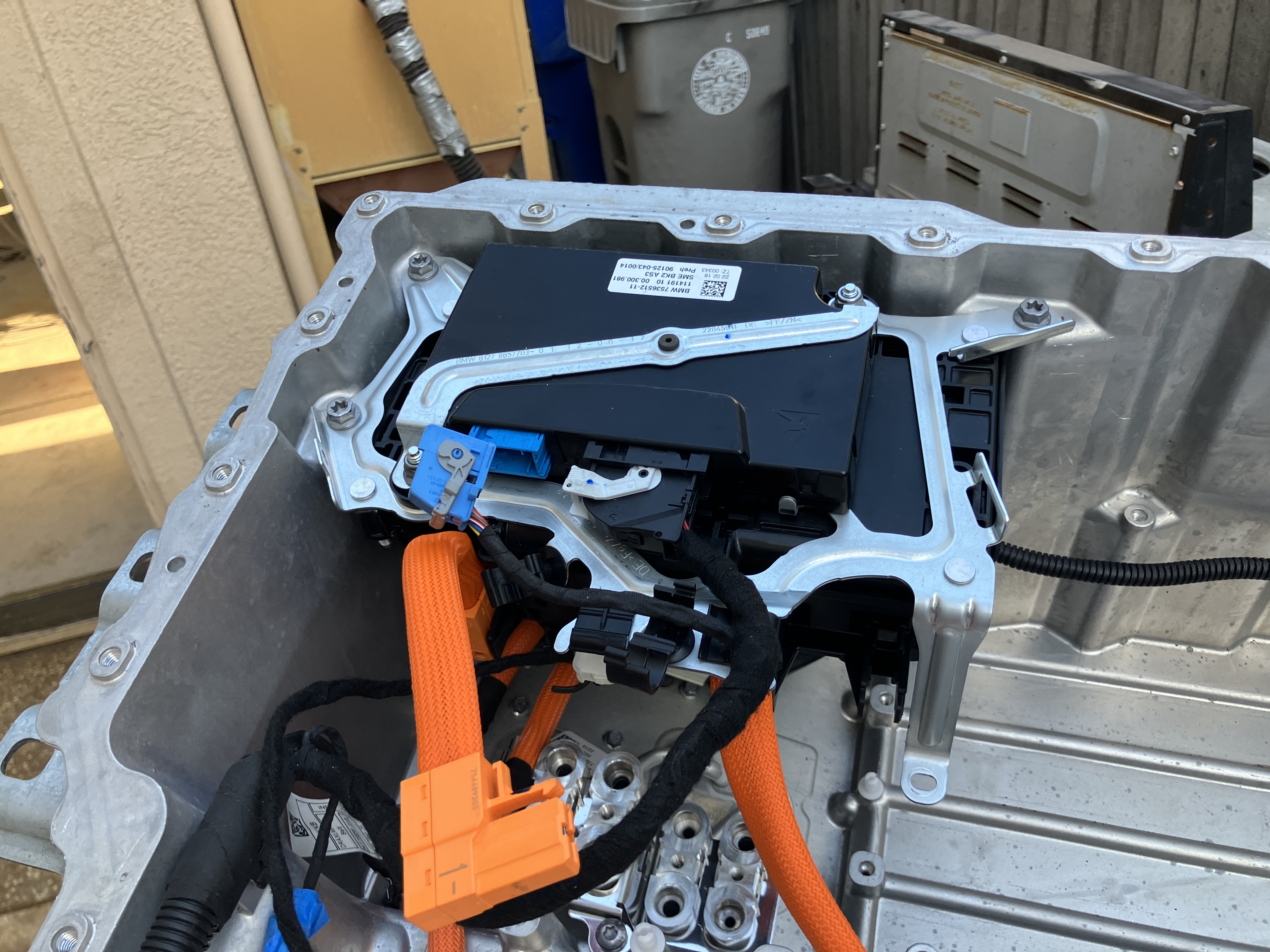

BMW 330e External Connector
if we gonna use the OEM BMW battery box we might as well use the OEM low voltage pig tail

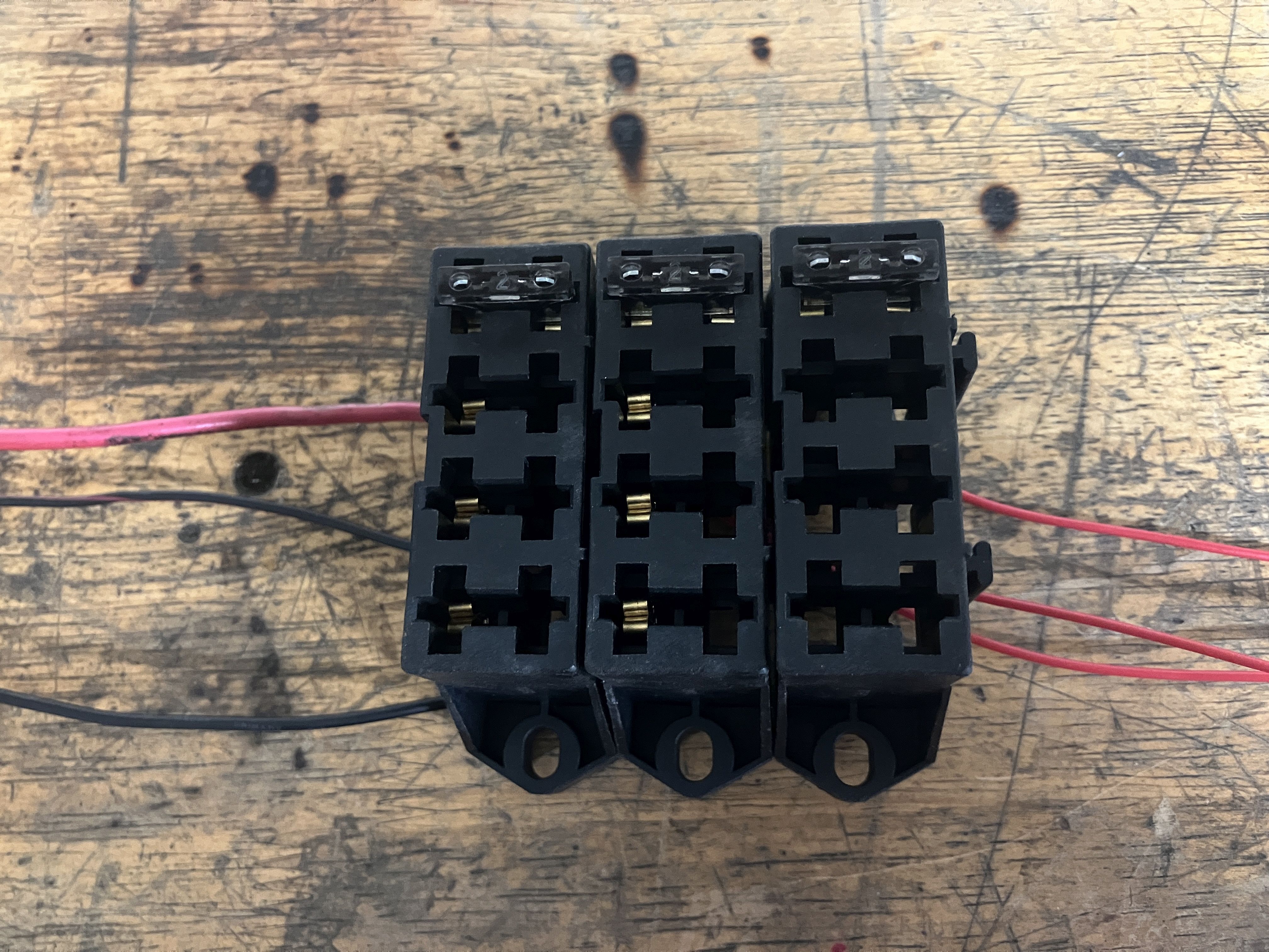

84 VW MK1 Rabbit DIY Wire Harness 1 - Roll Your Own Fuses & Relays 1
so from this:
to that:
KISS: Keep It Simple Stupid
so from this:
to that:

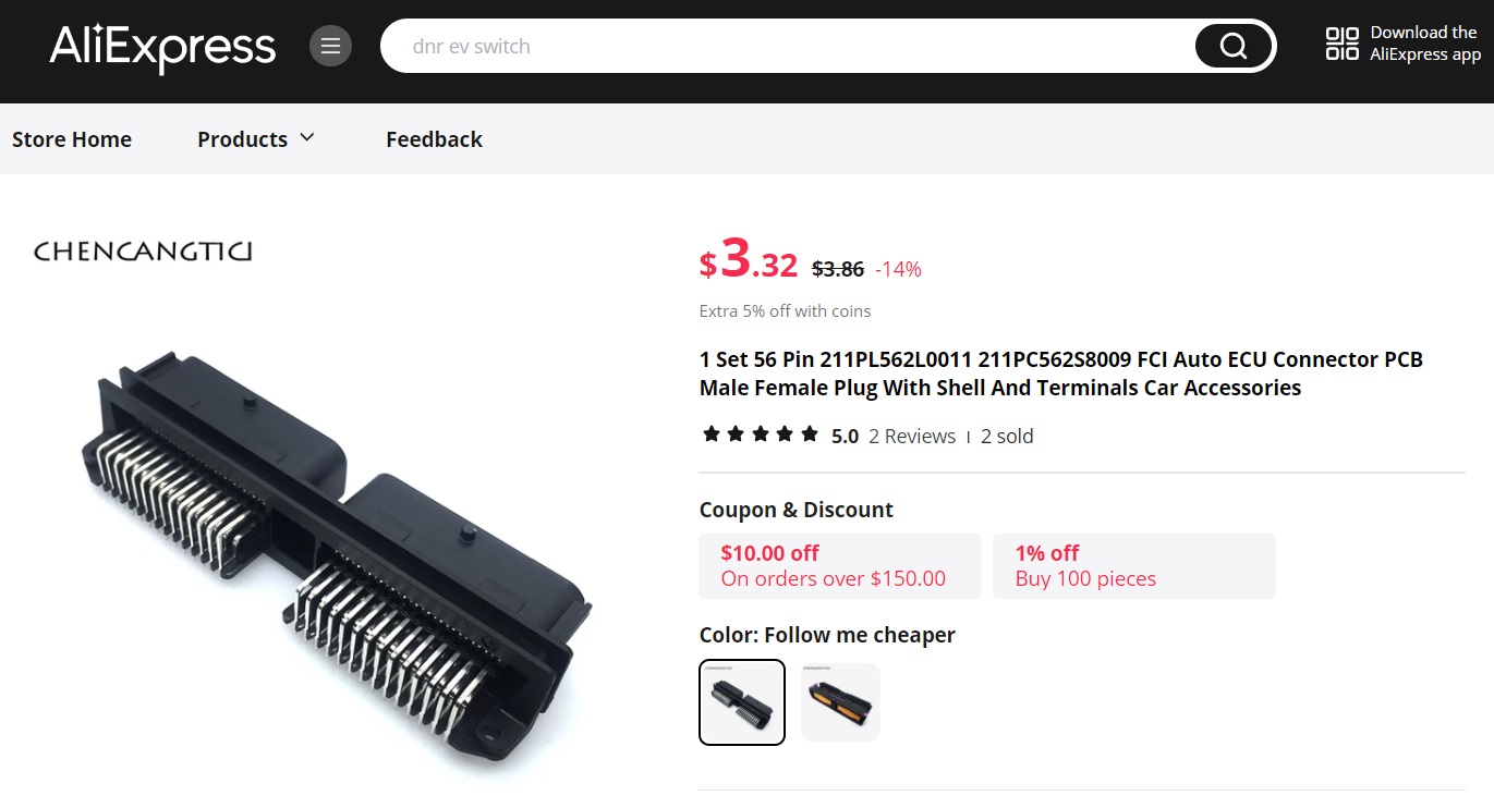

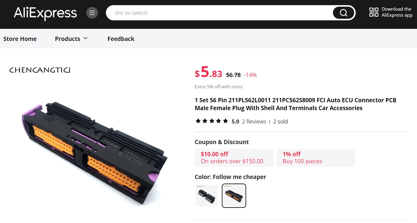

EVBMW ZombieVerter VCU Header, Connector, Wire Harness
- Gregski
- Posts: 2344
- Has thanked: 359 times
- Been thanked: 477 times
56 Pin Header (Male) - Part # 211PL562L0011
https://www.aliexpress.us/item/2255799870142865.html]
56 Pin Connector (Female) - Part # 211PC562S0009

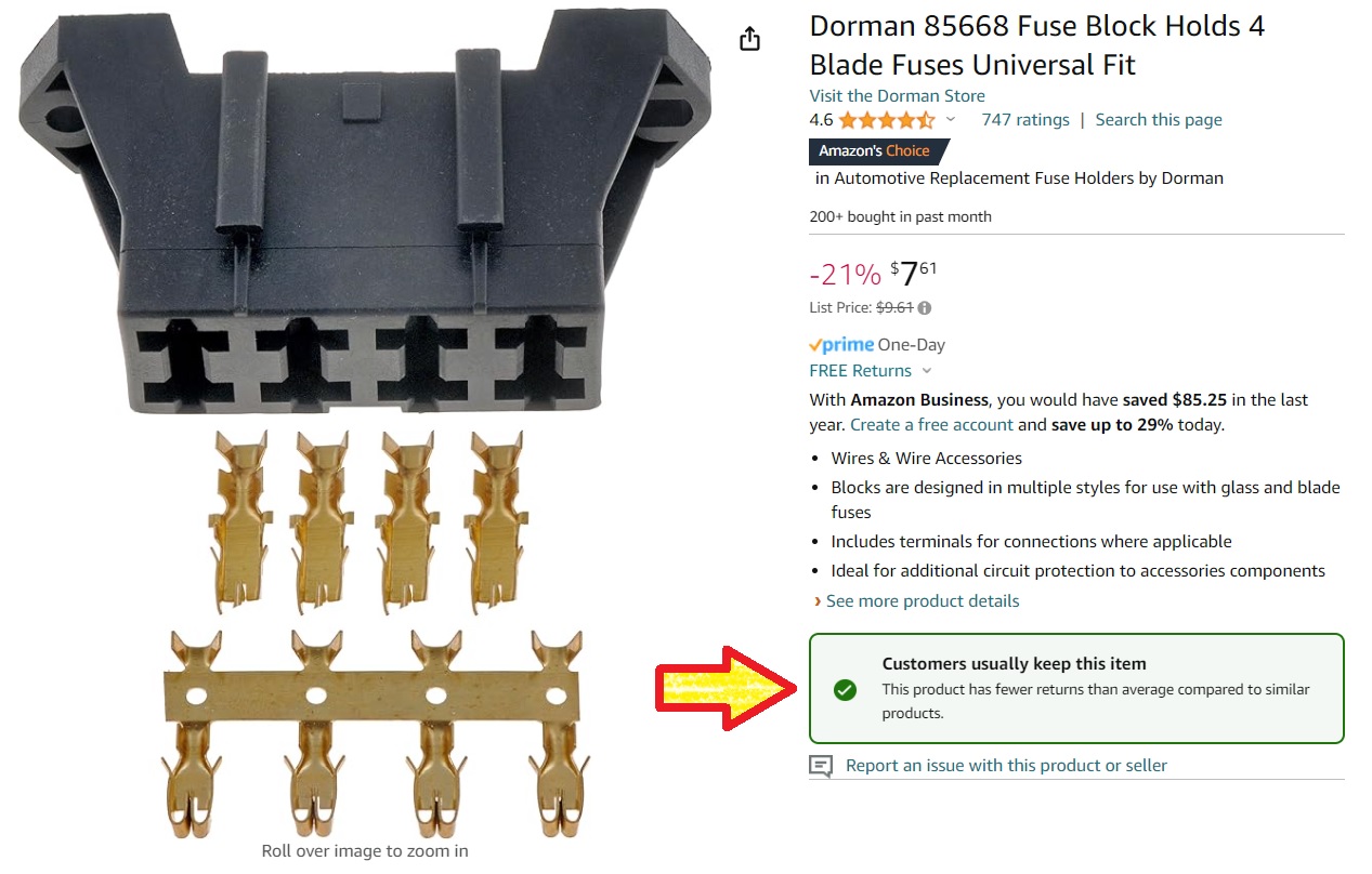

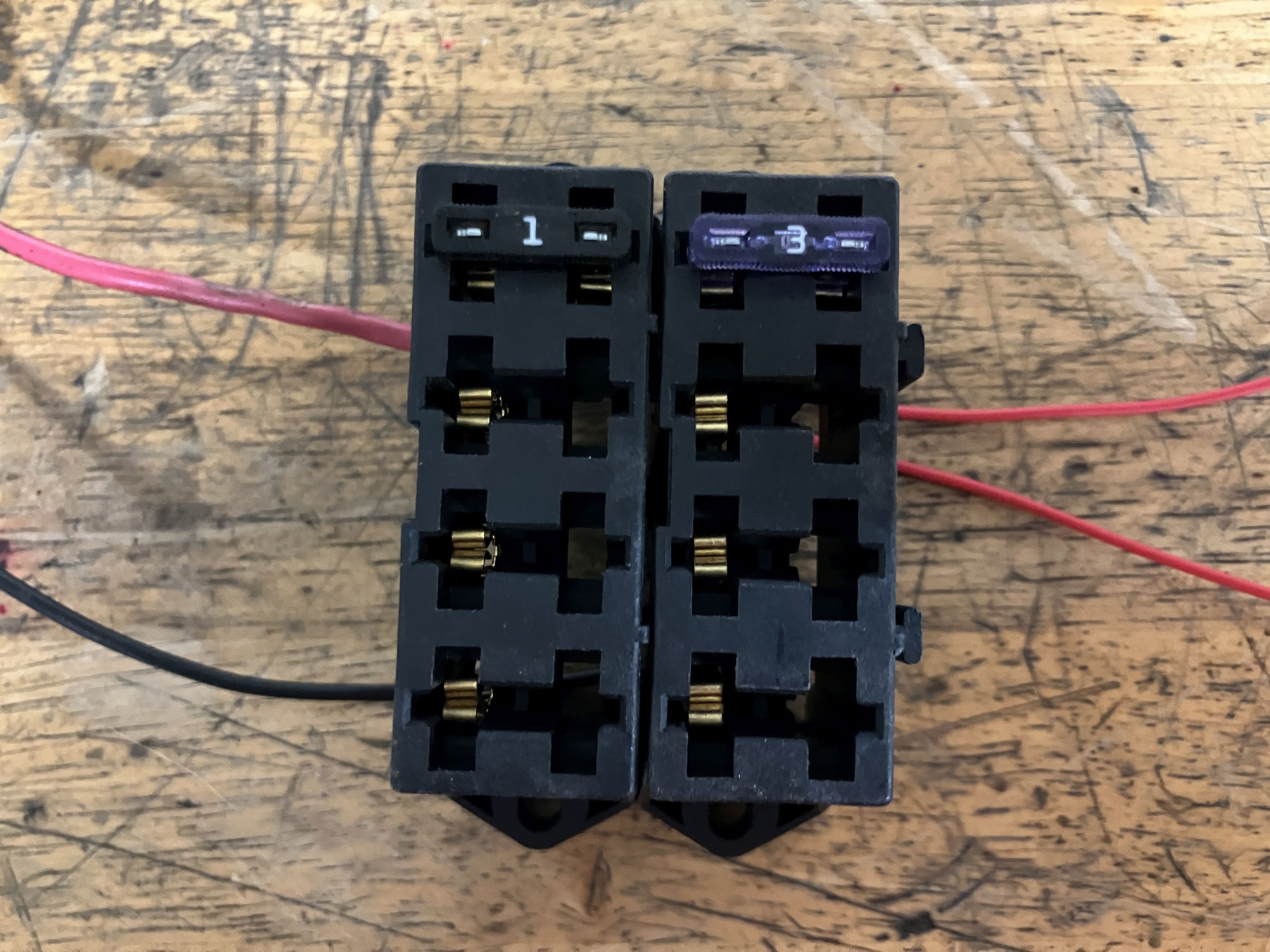

84 VW MK1 Rabbit DIY Wire Harness 2 - Permanent Power Fuse Block
here we add a four fuse block for anything that will require permanent power like the ZombieVerter VCU and brake lights

84 VW MK1 Rabbit DIY Wire Harness 3 - Ignition Power Fuse Block
the one where the Greg adds a second four fuse block, this one gets it's power when you turn the key in the ignition to On
The man responsible for the ZombieVerter tells us about Pin #15

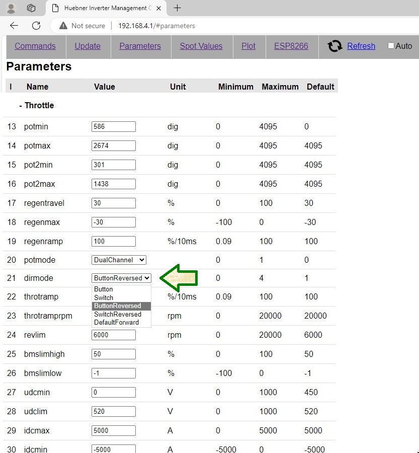

ZombieVerter VCU Forward & Reverse
These two pins are used to set Direction
- Pin 53 - Reverse
- Pin 54 - Forward
- Gregski
- Posts: 2344

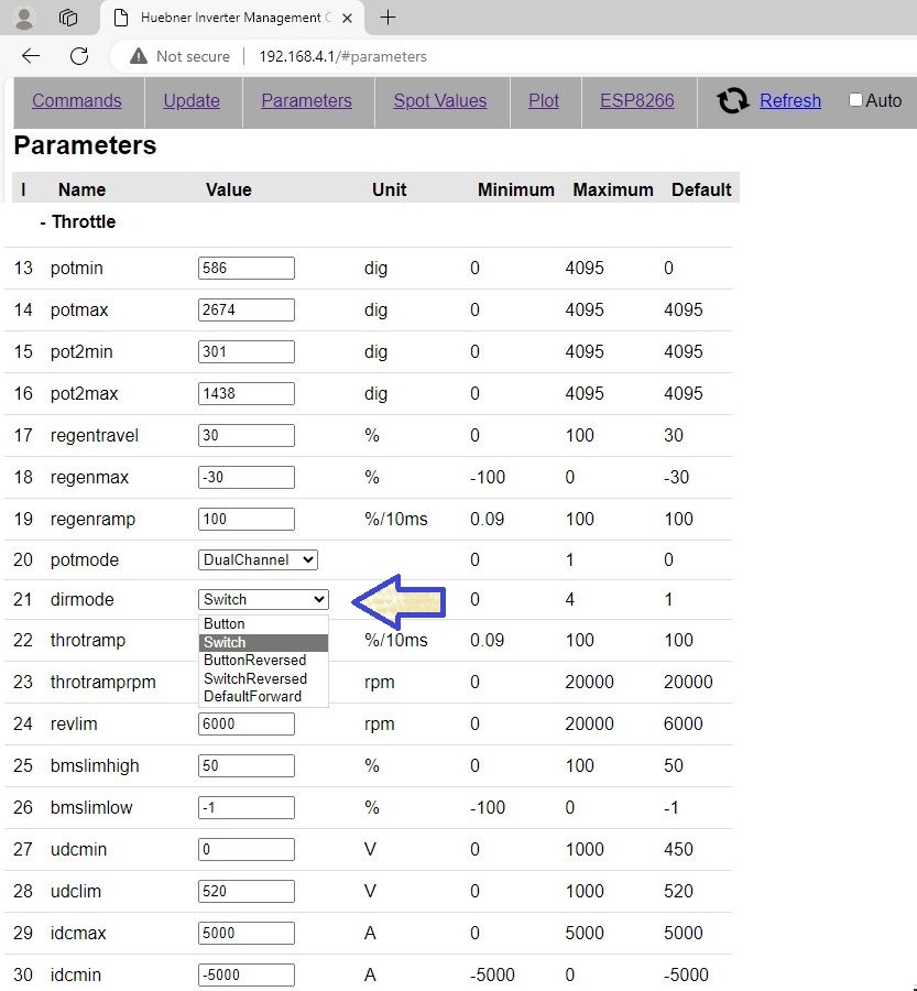

just want to share some screen shots with those who are still waiting on their Zombies to arrive
we find the dirmode [direction mode] under the Parameters aka "Settings" section in the Open Inverter web interface for the ZombieVerter VCU accessible via WiFi
Button is our first choice. This option is designed for one or two momentary press buttons to put your car in either Drive aka Forward direction or Reverse. The way this works is you press a button and you are in that mode until you press the other button
- Gregski
- Posts: 2344
Switch is our second choice.
- Gregski
- Posts: 2344
ButtonReversed is our third choice. You would use this if say you took a rear motor from an OEM vehicle and flipped it to install it in the front of your new vehicle. The default forward direction would now spin your wheels backwards, so ButtonReversed takes care of this situation.
- Gregski
- Posts: 2344
SwitchReversed is our fourth choice. You would use this if say you took a rear motor from an OEM vehicle and flipped it to install it in the front of your new vehicle. The default forward direction would now spin your wheels backwards, so SwitchReversed takes care of this situation.
- Gregski
- Posts: 2344
DefaultForward is our fifth choice. This setting tells the VCU that as soon as we turn the key to the Run position we are ready to Drive, without any signals, buttons, switches going to Pin 53. This may be all you need for the Lexus GS450h rear wheel drive transmission as it has a traditional internal reverse gear inside the transmission so you just use the floor shifter to manually put it in Reverse. The motor still spins forward but it is the counter gear mated with the reverse gear that makes the car go backwards. So no wire on pin 54 needed to go in Reverse.
