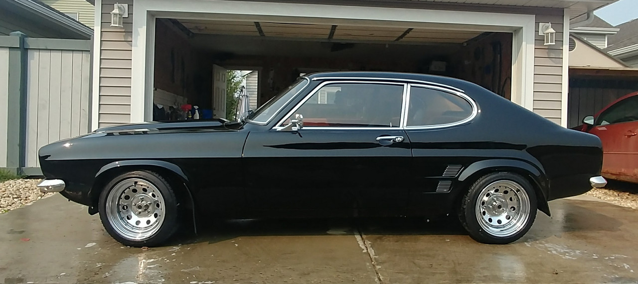

Heres a pic, my first and last paint job...
As I'm not limited to a shifter hole I should be able to keep moving it forward until I get the desired elevation and driveline angles.
As I have an 8.8 solid rear on leaf springs I'm considering using the lexus drive but then putting the sliding yoke assembly to the rear of the car on the "pigs head" flange to take up the axle movement, that should technically work fine, its just not sealed from dirt like it would be inside the transmission tail shaft.

Does that pic appear sideways on everyone else screen too!!??

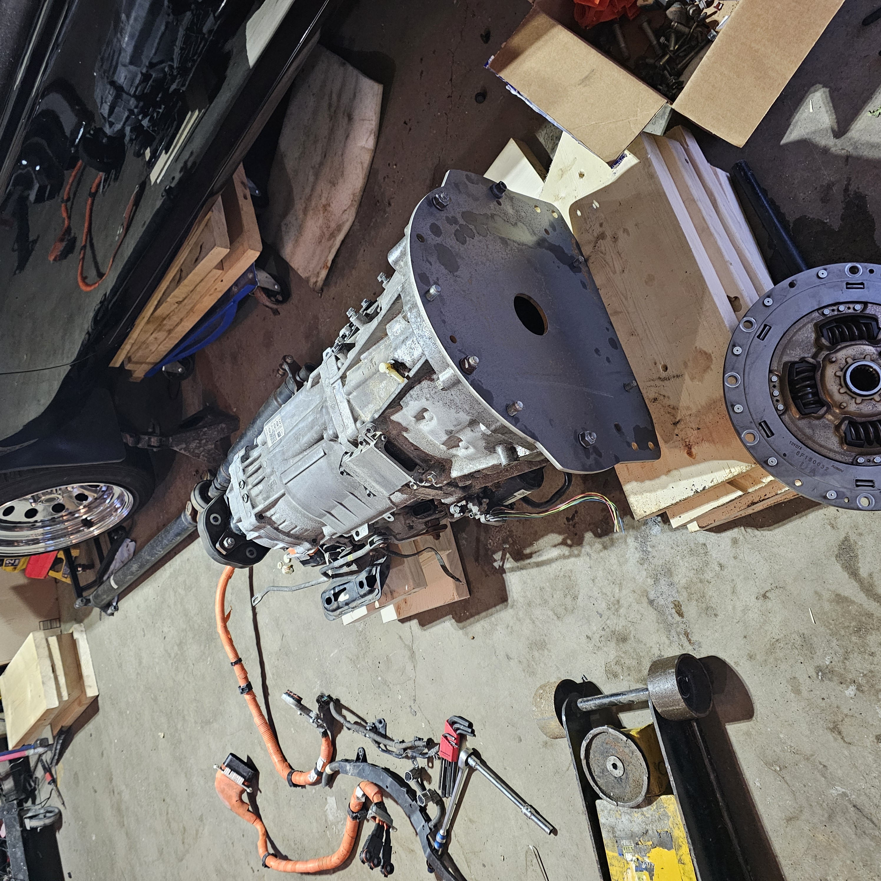

Got The transmission out..
That was a little challenging in my tiny garage with the car 1' off the ground. Started off so methodical, ended with a Sawzall!
Some other pieces to get before it's scrapped.
Got The oil pump controller, inverter, all loom plugs and wiring.
Need the splined sleeve and I also seen a little water pump

Splined sleeve? For locking the input shaft? That's just a cut down clutch disc. Not sure on the water pump though, I suspect people just use whatever is available to them and cheap.

Grab the flywheel/flexplate and "clutch" saves finding a clutch plate from something else it also gives you the option of mounting the complete clutch assembly to your locking plate to provide some cushioning to the driveline.

I tried mounting the whole damper minus the flywheel obviously and it made things worse in the 300h (l210) had to take it out and weld it solid but the 450h transmission may react differently you can only try
