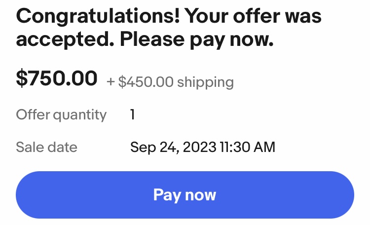

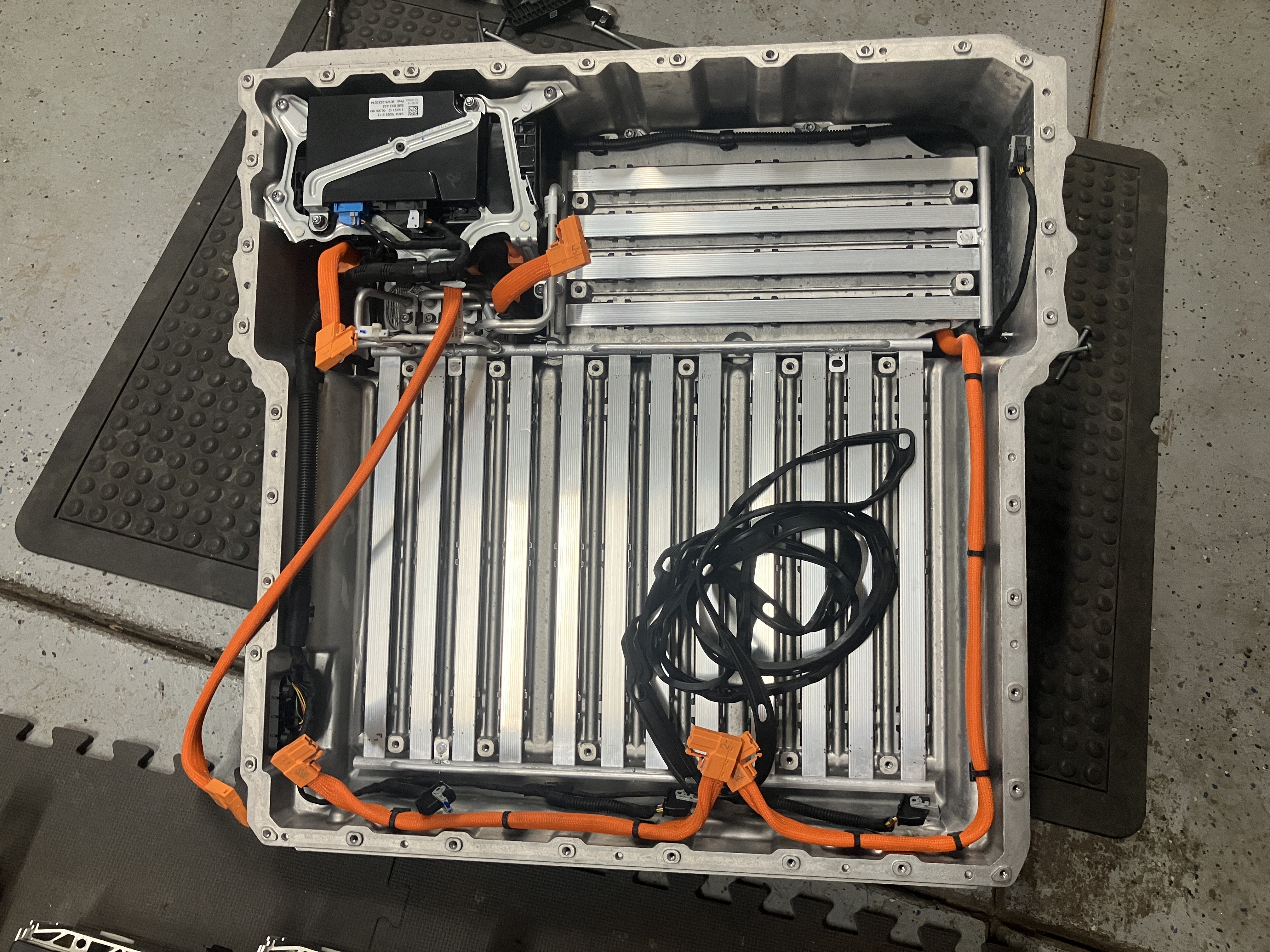

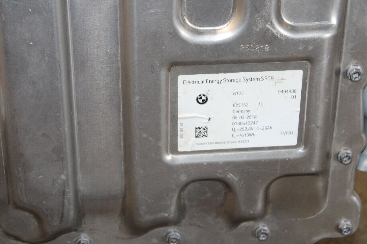

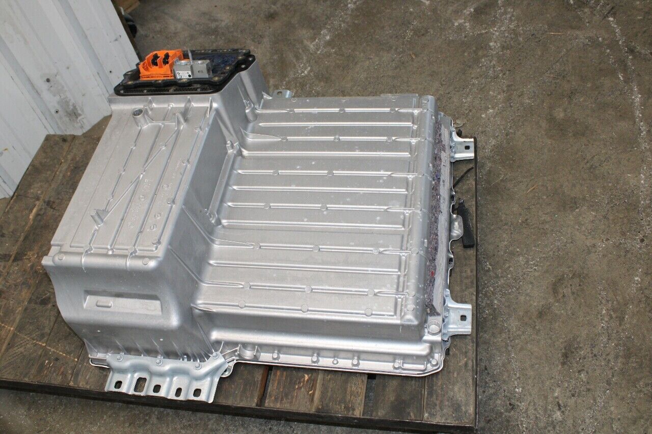

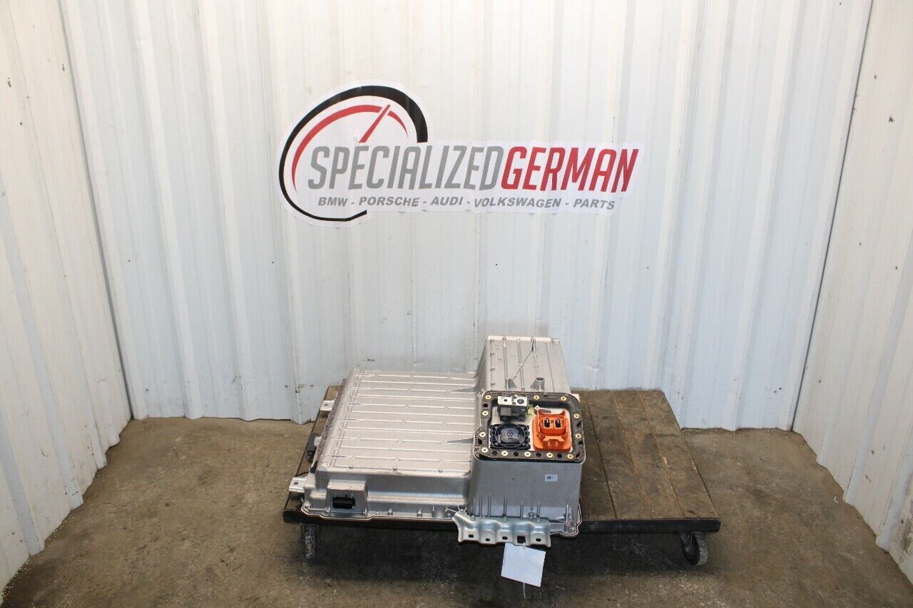

let's just say I thought about calling this thread: When Lowball Offers Go Wrong! or maybe Right? I needed a third battery pack (having owned two 530e packs already) like a hole in my head, but left alone unsupervised on eBay I saw one local to me and thought I would save $450 on Flat Rate Freight.
and here are two real reasons why I bought it
1. The first one I am embarrassed to tell you so I will click bait you later
2. the 530e "saddle bag" or Siamese Kidney hard shell design lends itself only to fit in the [ wait for it ] BMW 530e and absolutely nothing else unless of course you strip it and roll your own, so I thought lets give this squareish rectangularish shape a go, and yes I know it sports one module less, but we have a plan for that (a bad idea opportunity up ahead)

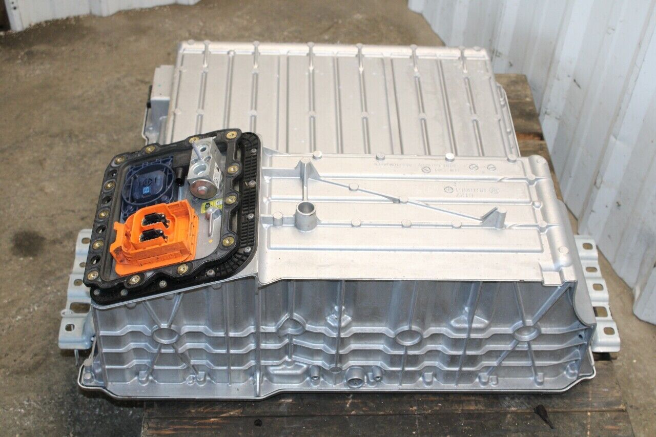

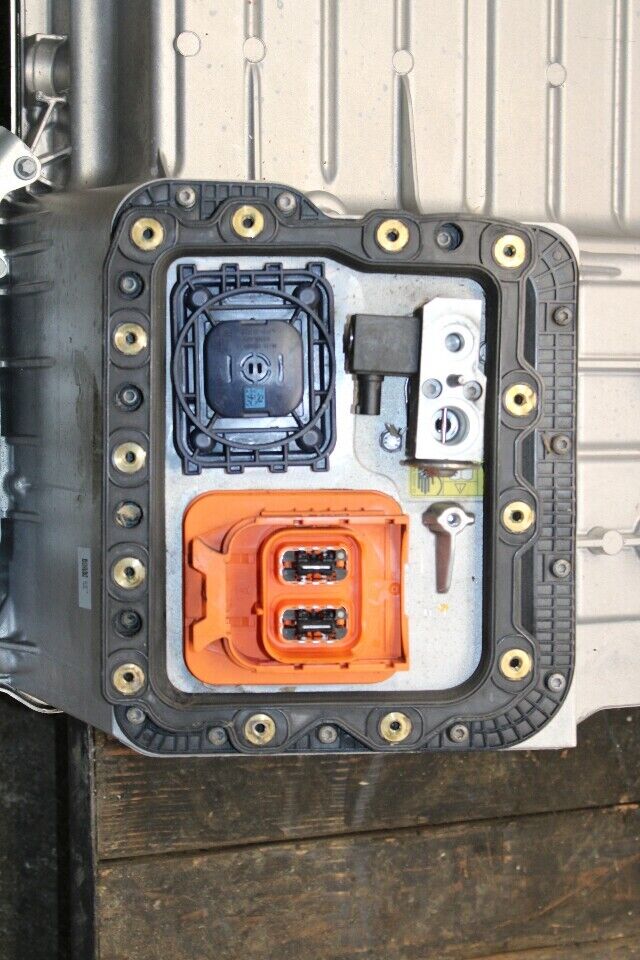

as listed on eBay

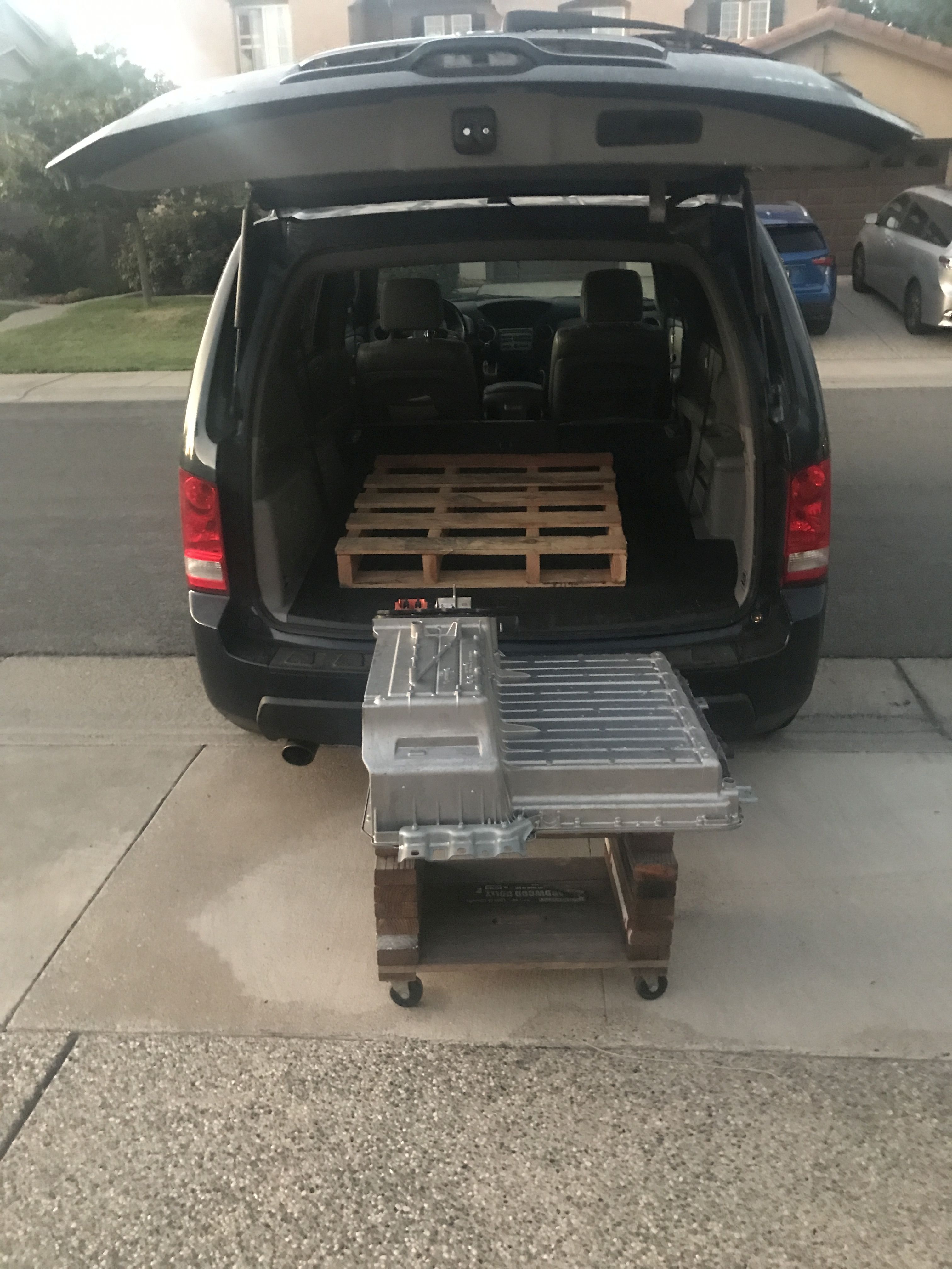

The Hybrid Battery Pack Rollermatic 3000 ™ HBPR3K

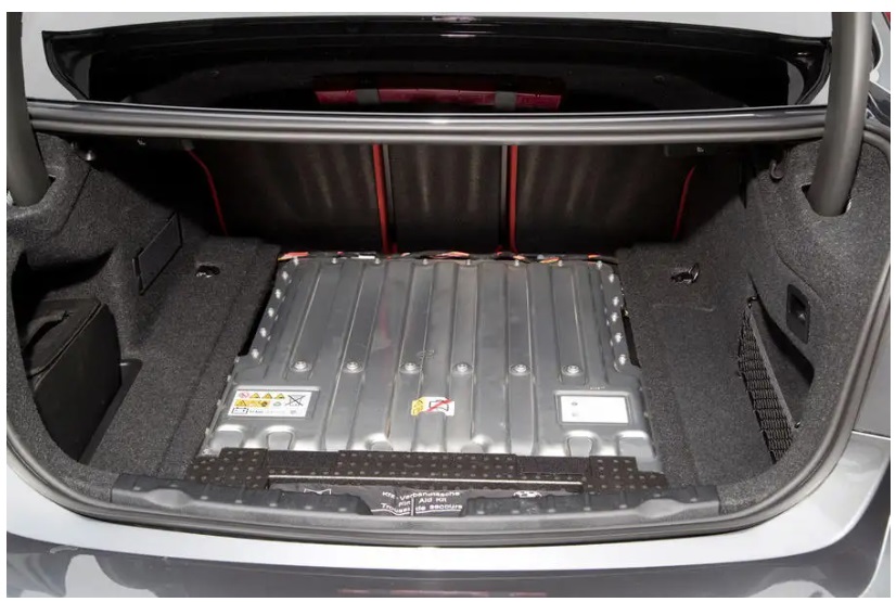

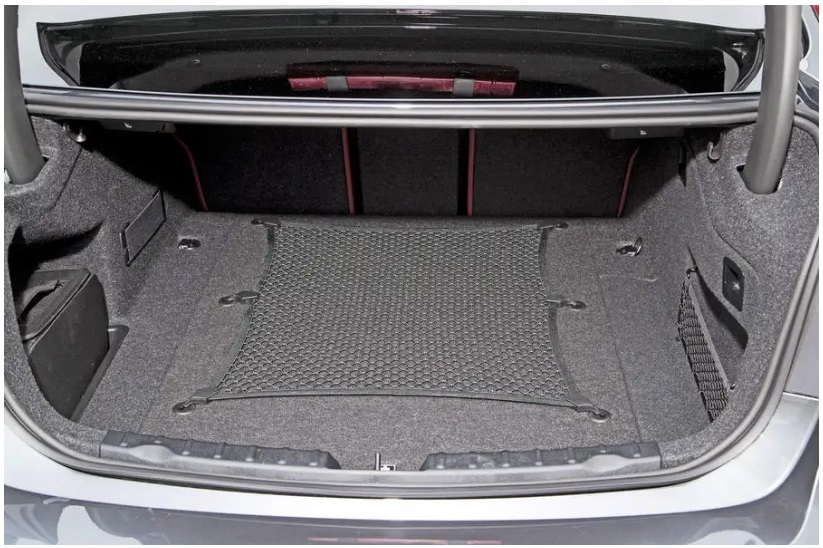

so here's the sexy BMW 330e that these packs sit in the truck / boot of

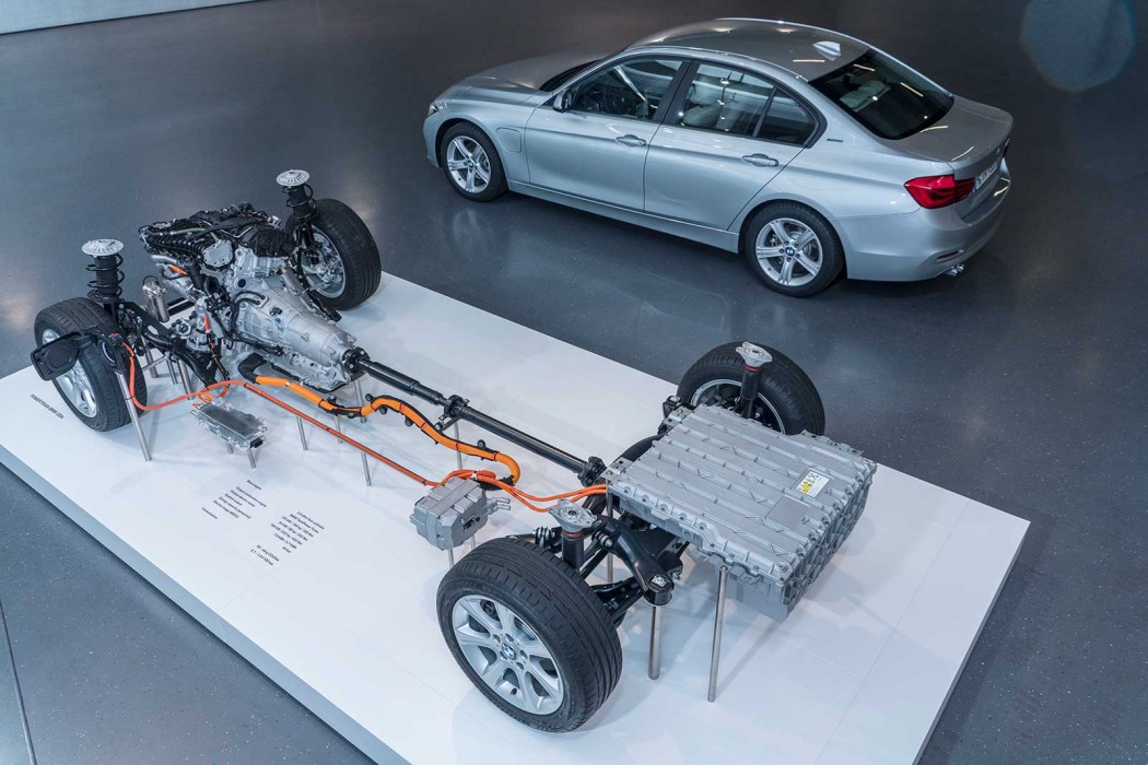

found this pic of the 330e drive train

Have you found any info on it's power capabilities?
AMP3R
Posts: 47
Has thanked: 10 times
Been thanked: 6 times
Re: I bought a BMW 330e hybrid battery pack - Now What?
Post by AMP3R »
jrbe wrote: Fri Jan 12, 2024 12:15 am Have you found any info on it's power capabilities?
The same as 530e 26 Ah pack.
Max. power (discharge) 83 kW (short-term)

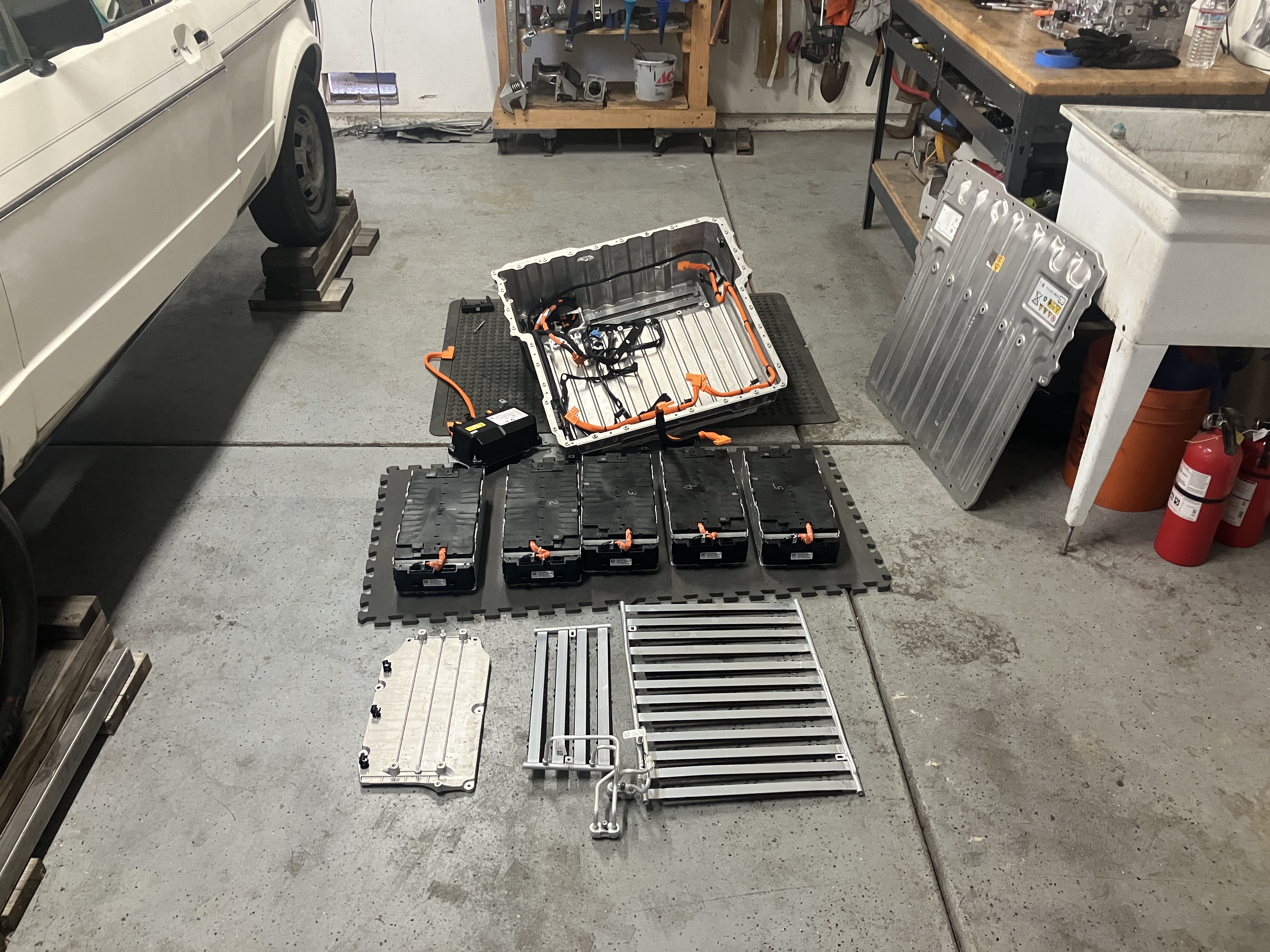

BMW 330e PHEV Hybrid Battery Pack Tear Down
Gregski
Posts: 2342
Has thanked: 356 times
Been thanked: 475 times
Post by Gregski »

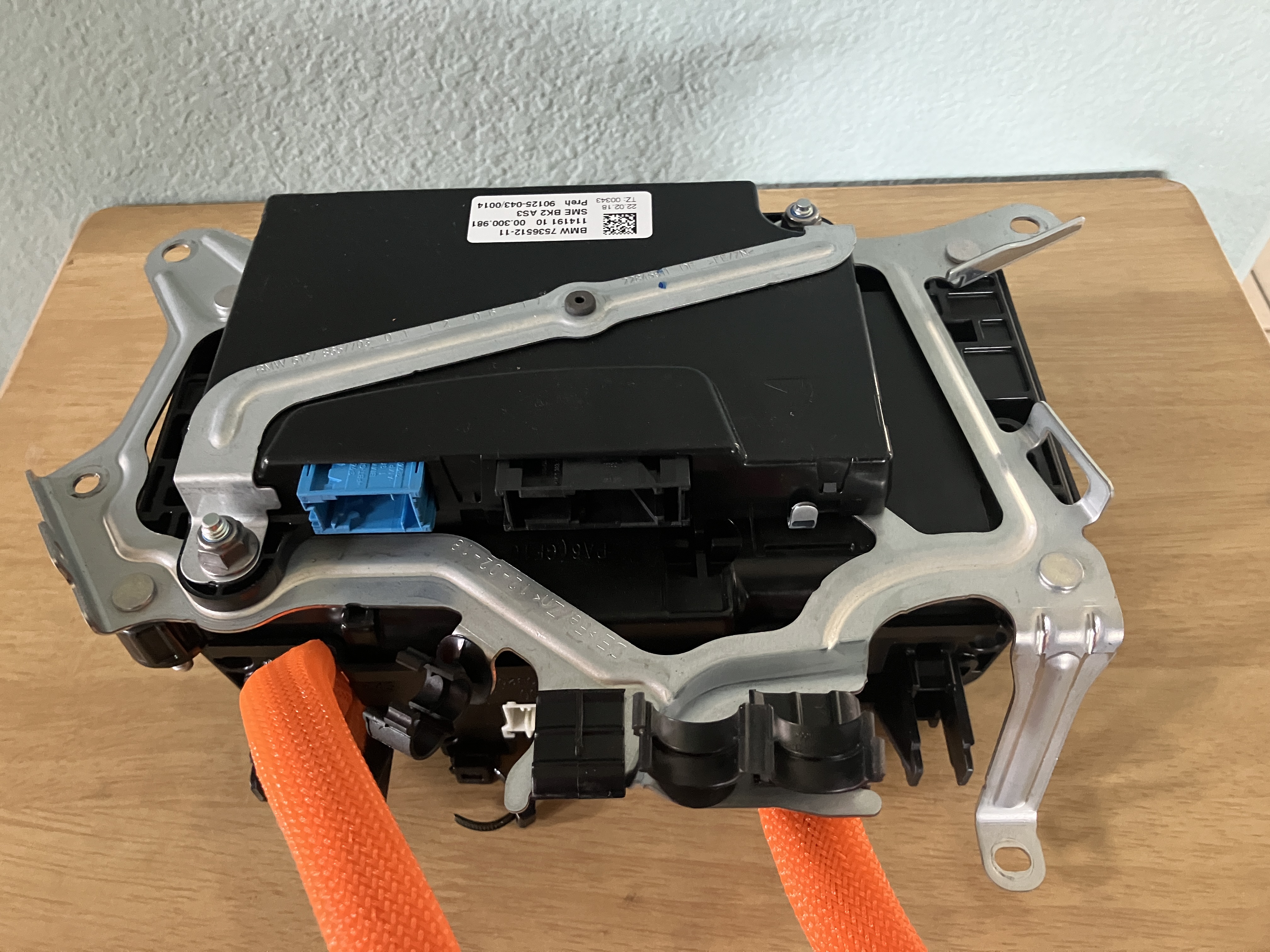

BMS thingie

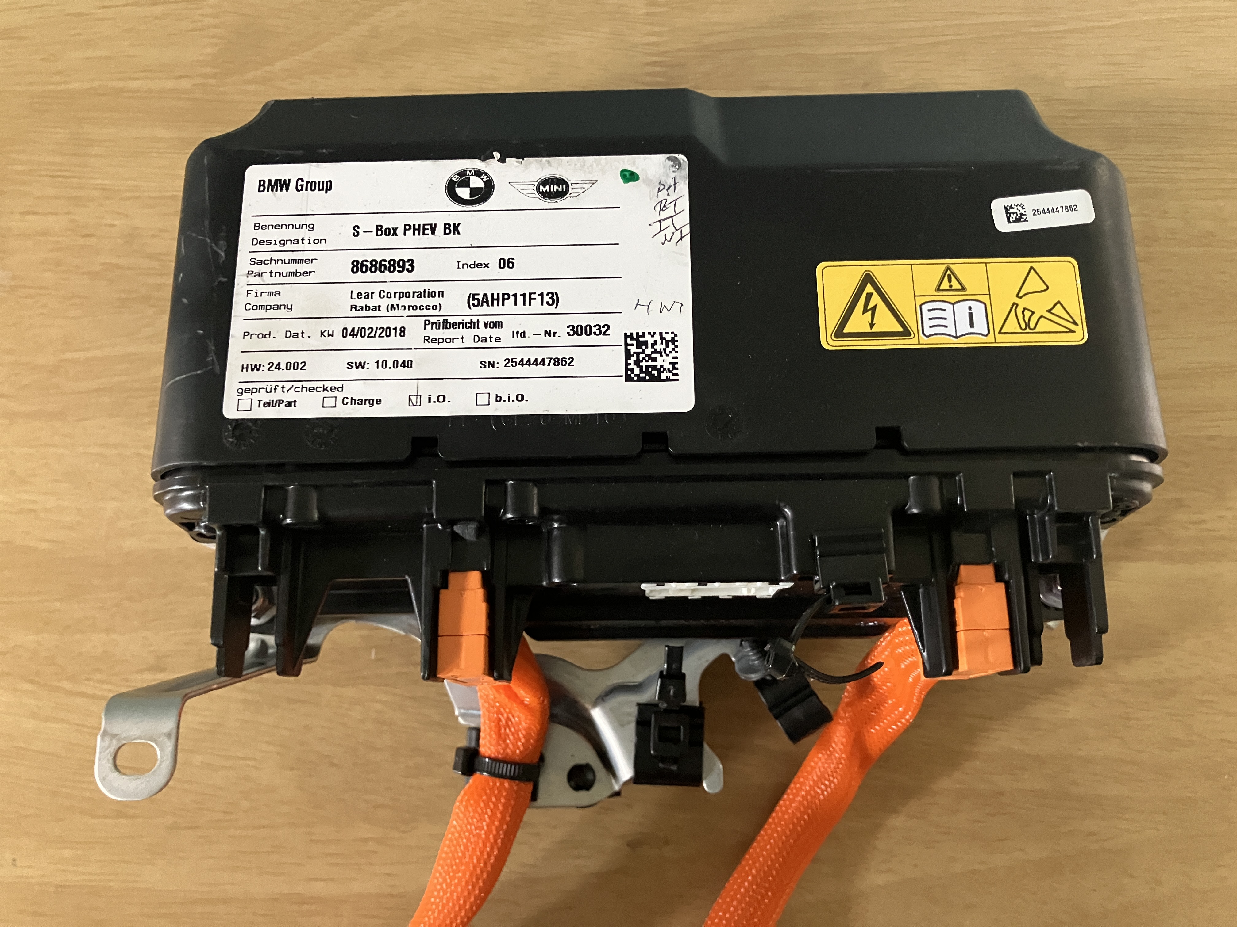

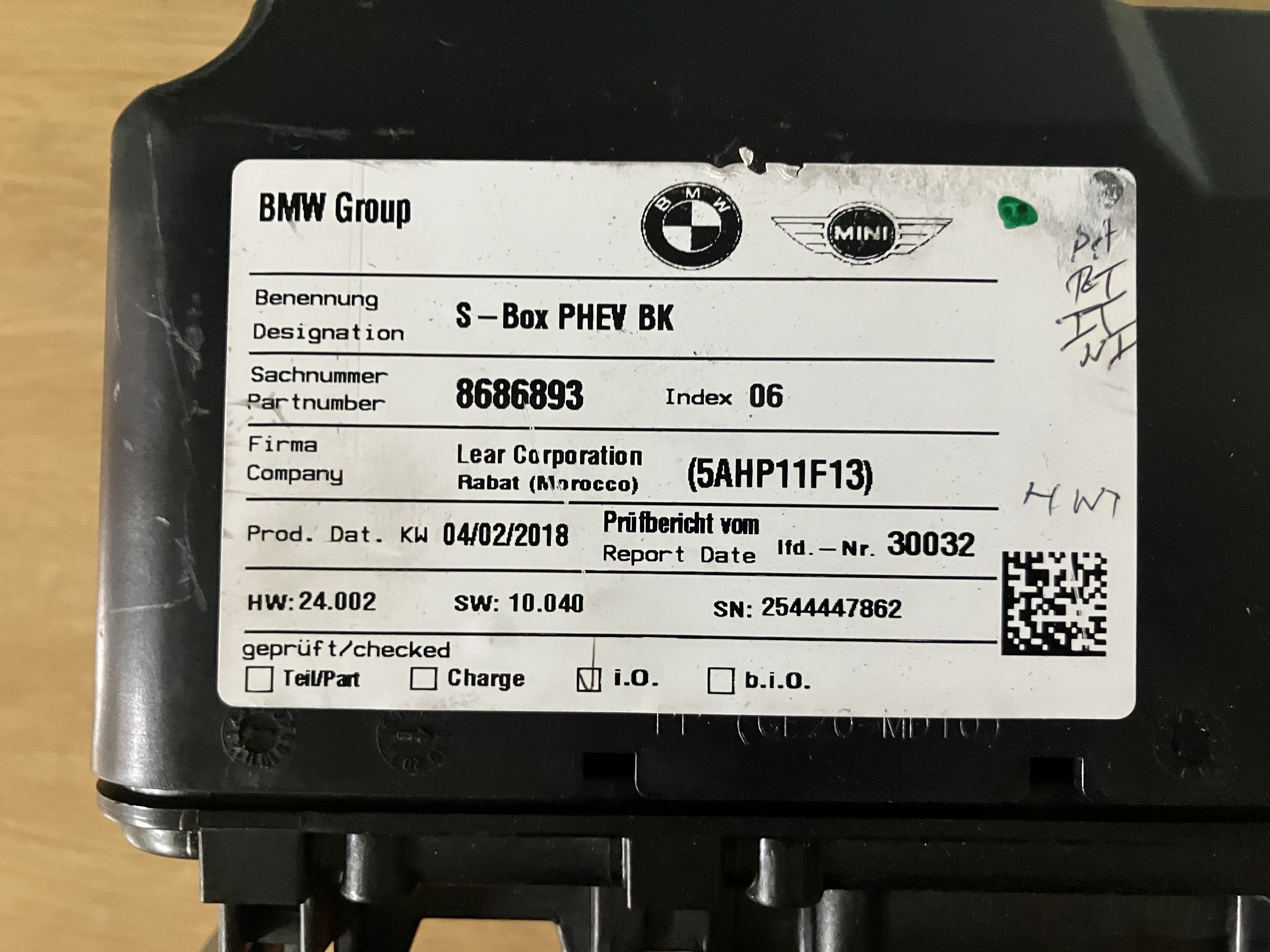

The Safety Box is the same exact part number as the one out of the BMW 530e
Part # 8686893

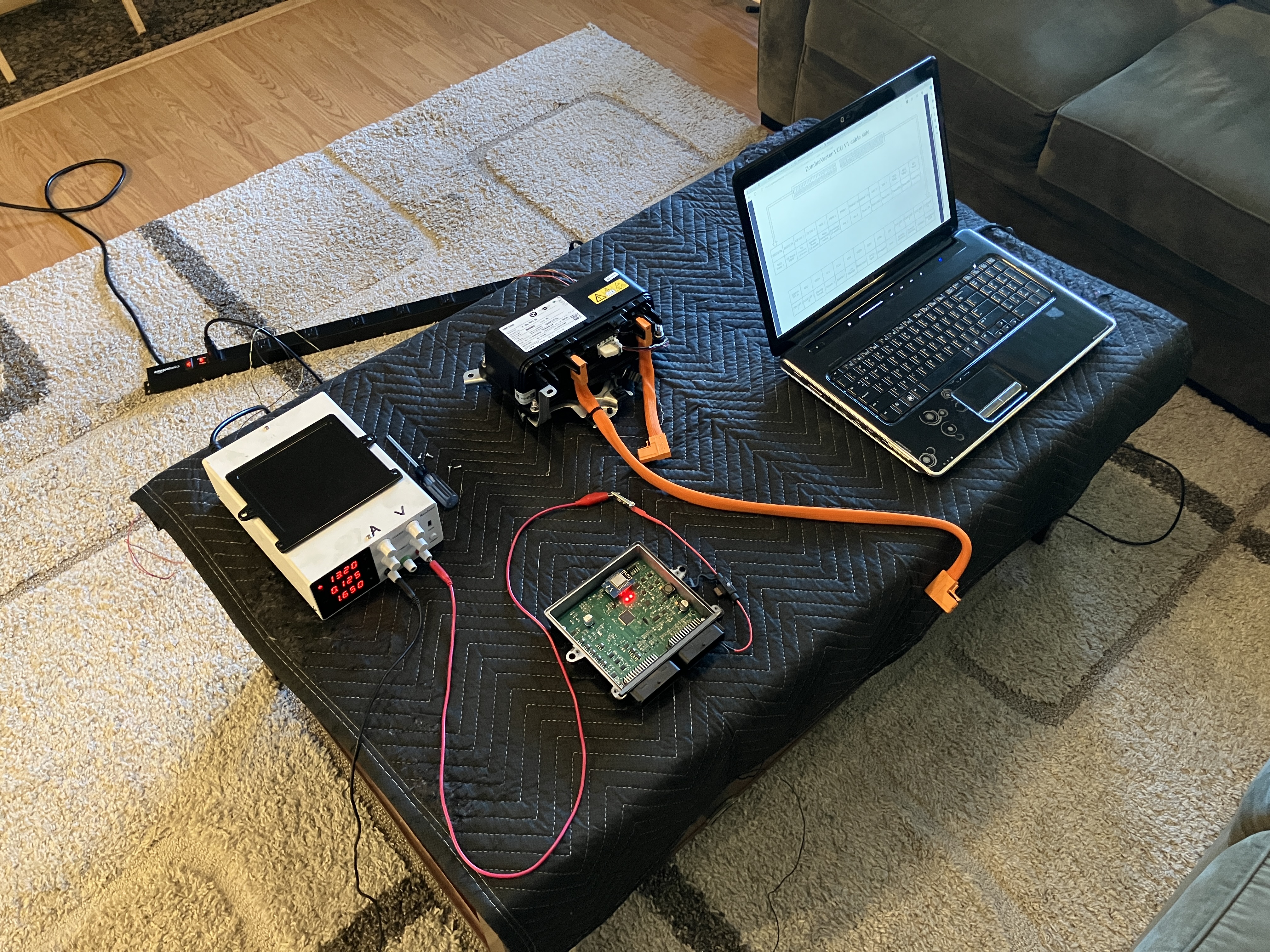

ZombieVerter VCU BMW Safety Box Control Part I
Gregski
Posts: 2342
Post by Gregski »
ZombieVerter VCU BMW Safety Box Control Part II
things weren't working, so T-Bone my trusty assistant, suggested we plug more skinny wires into the Zombie
and that did the trick
