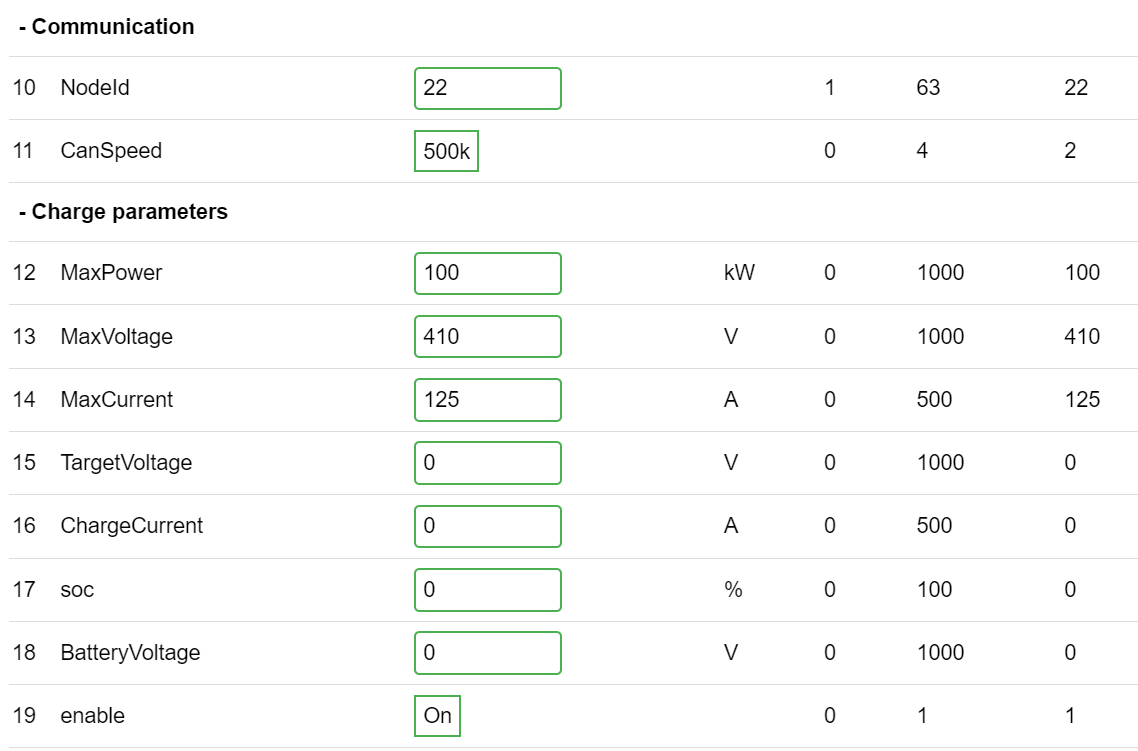

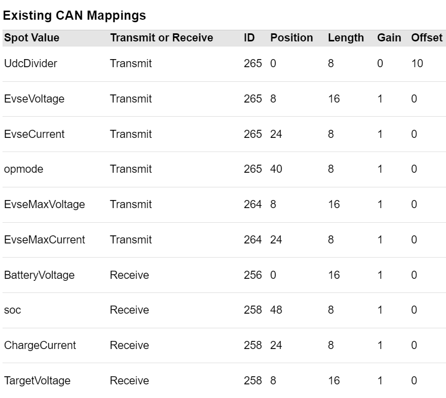

Can you post a screenshot of CAN mapping and Parameters page? And tell us the values you are sending and where

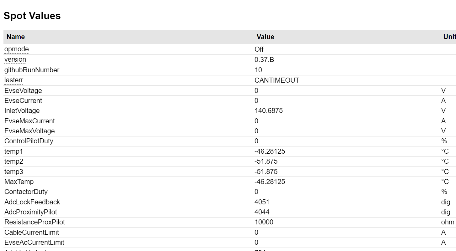

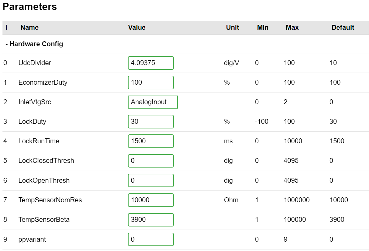

Screenshots attached. HV was off. Inlet voltage from sense board(charger side of contactors) reads correctly when contactors are closed and HV on via test. CAN messages batvtg, targeting, chargecur, SOC are being broadcast to the addresses mapped by my Orion2 and are being ready successfully by my datalogger.
- Posts: 5799
- Has thanked: 160 times
- Been thanked: 1033 times
Re: QCA7000 Foccci+Clara User thread
looks correctly mapped. Are you seeing Clara messages in your CAN logger also (0x108 and 0x109)? Suspecting a physical issue

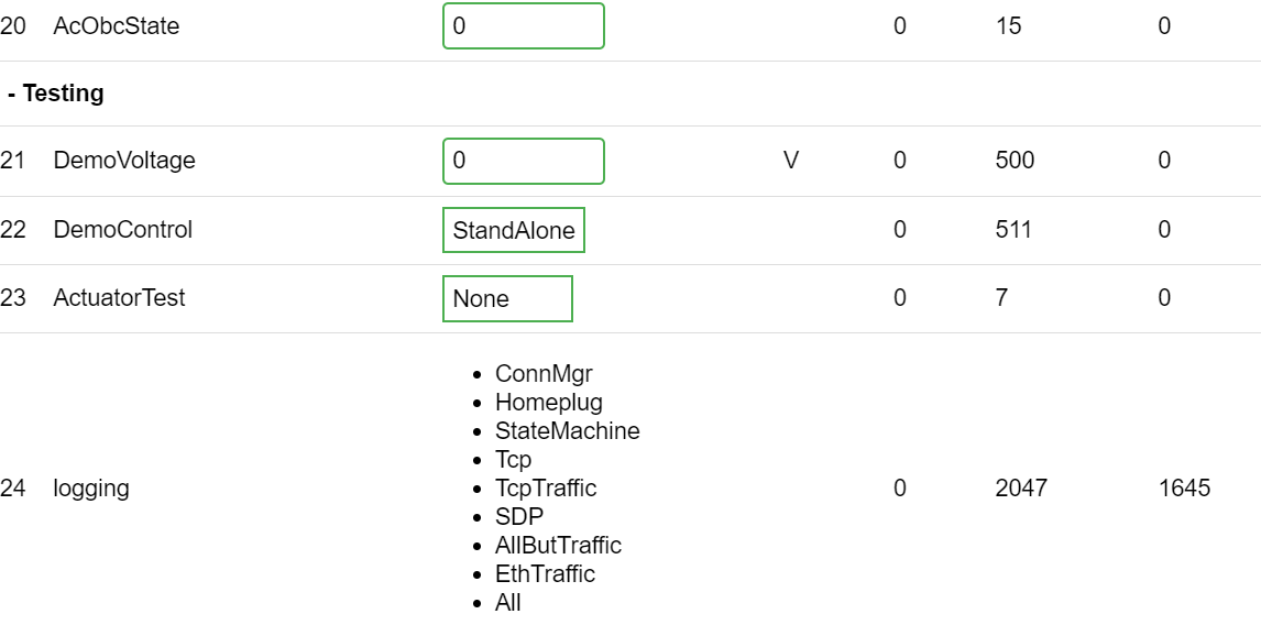

You configured demomode to standalone, this leads to ignoring CAN Input.
- Posts: 5799
Overlooked that. But it wouldn't actively suppress reception (and display)?

CAN communications are now working! Spot Values are updating and there are no time-out errors! Just a case of faulty troubleshooting on my part....! I'm ready to attempt a real charge session now.

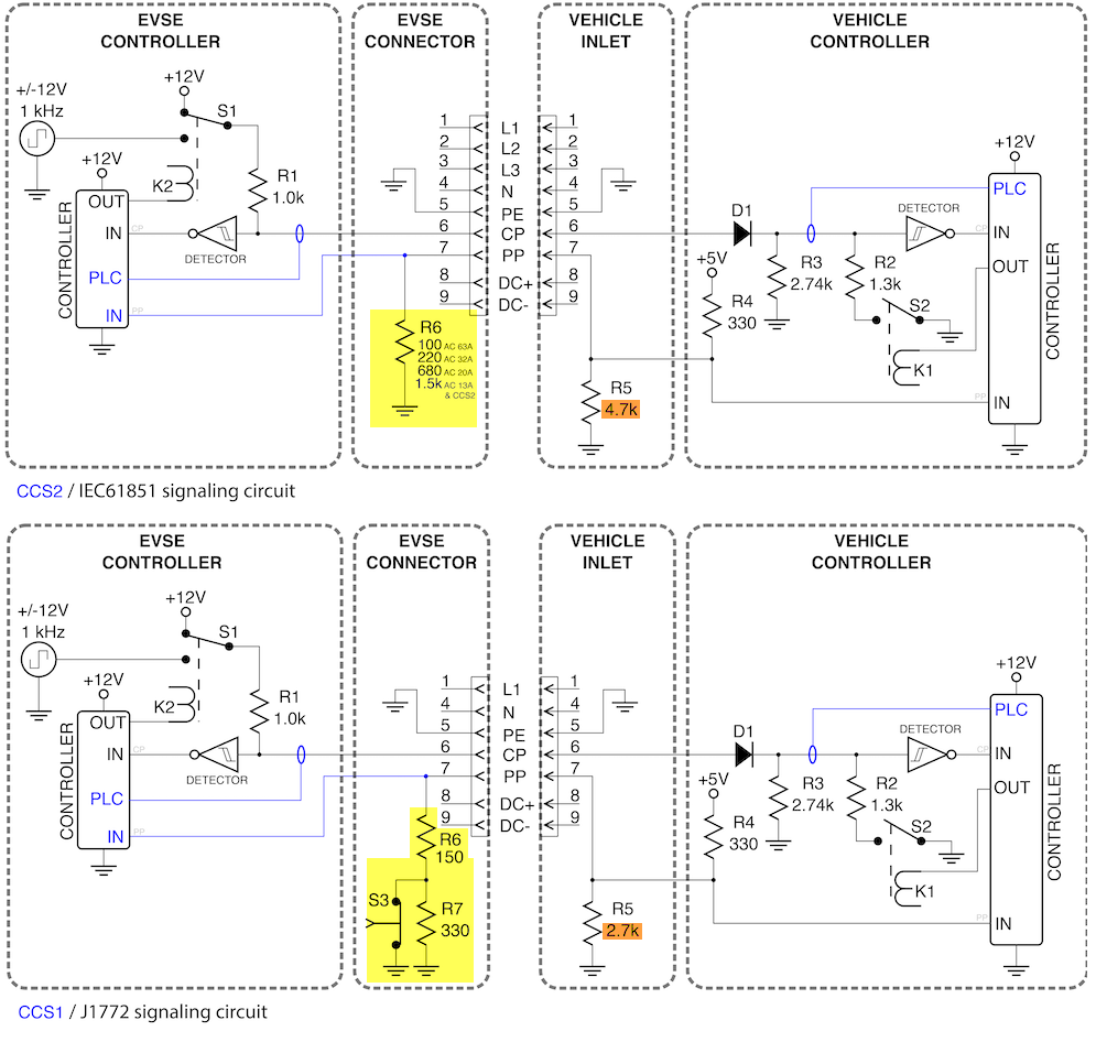

I suspect that it is the PP line. I'm in Canada and it sounds like the PP requirements are different between CCS1 and CCS2. I will try changing the pullup on PP to 330 ohms and 3.3V with a 2.7K pulldown to ground. I also so some other discussions on the forum about another 47K to ground? I don't understand the purpose for this and where it should be placed. Do I need to change parameters?
The connection attempt was repeated many times and the results were the same. Unfortunately, I do not have the luxury of trying a different station as I have a non-street legal race and need to connect to the PhiPhong charger at the track. If it's any help, I know that a Tesla M3 using a Tesla adapter charges at that station on a regular basis. I'm not sure if this is relevant, but the 1st time I connected, the charger reported EVSE Max Amps as 140 amps. For subsequent connections EVSE Max Amps was 32A.

Did more testing today, but no success. I modified the PP circuit to add the 330 ohm pull-up to 5V and a pulldown to ground (tried a couple of values in the 2.2 to 3.2k ohm range). The charger faulted out very quickly. The Opstate stayed at 0 and SOC was not displayed on the charger. I did not receive any EVSE values. I confirmed that the charger had a 150 ohm resistance between PP and PE and 480 ohms when the release button was pressed. What value of ppvariant should I have been using? What does this variable do?
No communication this time, undo last change...
ppvariant is just relevant for calculating cable capacity for type 2 cables. Can't be the culprit. Have you checked your port contactors that they are not stuck? Iso resistance of port? Does CP measure fine seen from the port? Test also with ActuatorTest=StateC

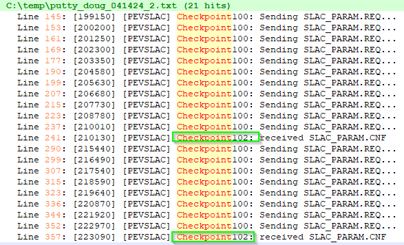

In this log, the best checkpoint number what we see is the 102, this is at the very beginning of the SLAC procedure.
This is much worse than the other test, were the high level communication was established and we ran until the cable check.
Some ideas to check:
- ground connection from Foccci to the PE of the CCS inlet
- CP connection from Foccci to the CCS inlet
- Are all wires of Focccis RF transformer still correctly soldered?
- Is it possible to "reset" the charging station, maybe it denies a new connection if the old was not correctly finished?
- Do you see the 5% PWM in the webinterface?
For me this looks like that the communication on the CP line is nearly impossible, we only sporadically see a response from the charger.This is much worse than the other test, were the high level communication was established and we ran until the cable check.
Tests OK
Measures 2.7k to ground
Yes, checked with meter
I will have to see if I can gain access to the main breaker.
I did not check if we are seeing the 5% PWM signal on the web interface.
Tests OK
