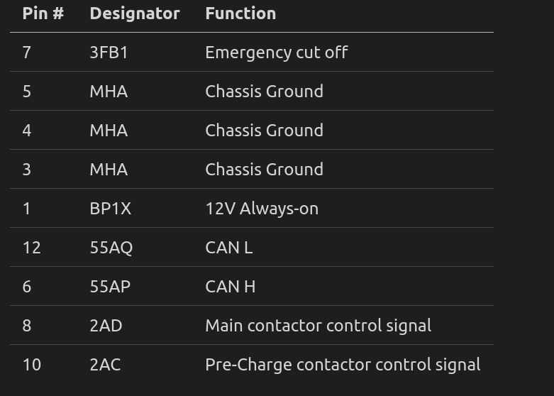

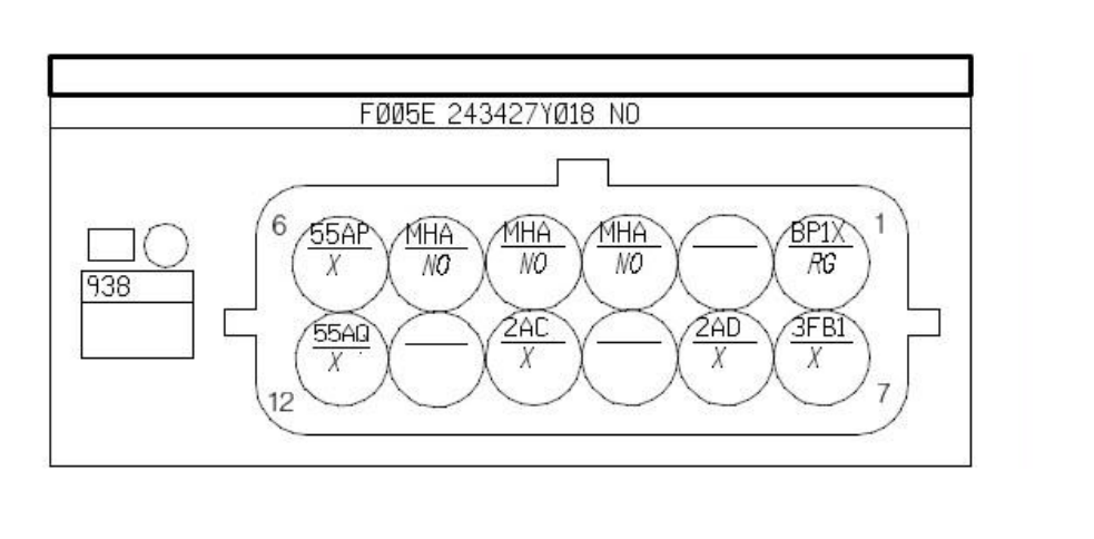

Hi wizo, here you go:
The connector is made by Yazaki, part numbers are 7282-8854-30 for male and 7283-8854-30 for female connector sides, respectively.
You can get them on a lot of online shops, cheapest is probably AliExpress, e.g. here:
https://de.aliexpress.com/item/4000174903780.html
I hope these infos are something you can work with!
